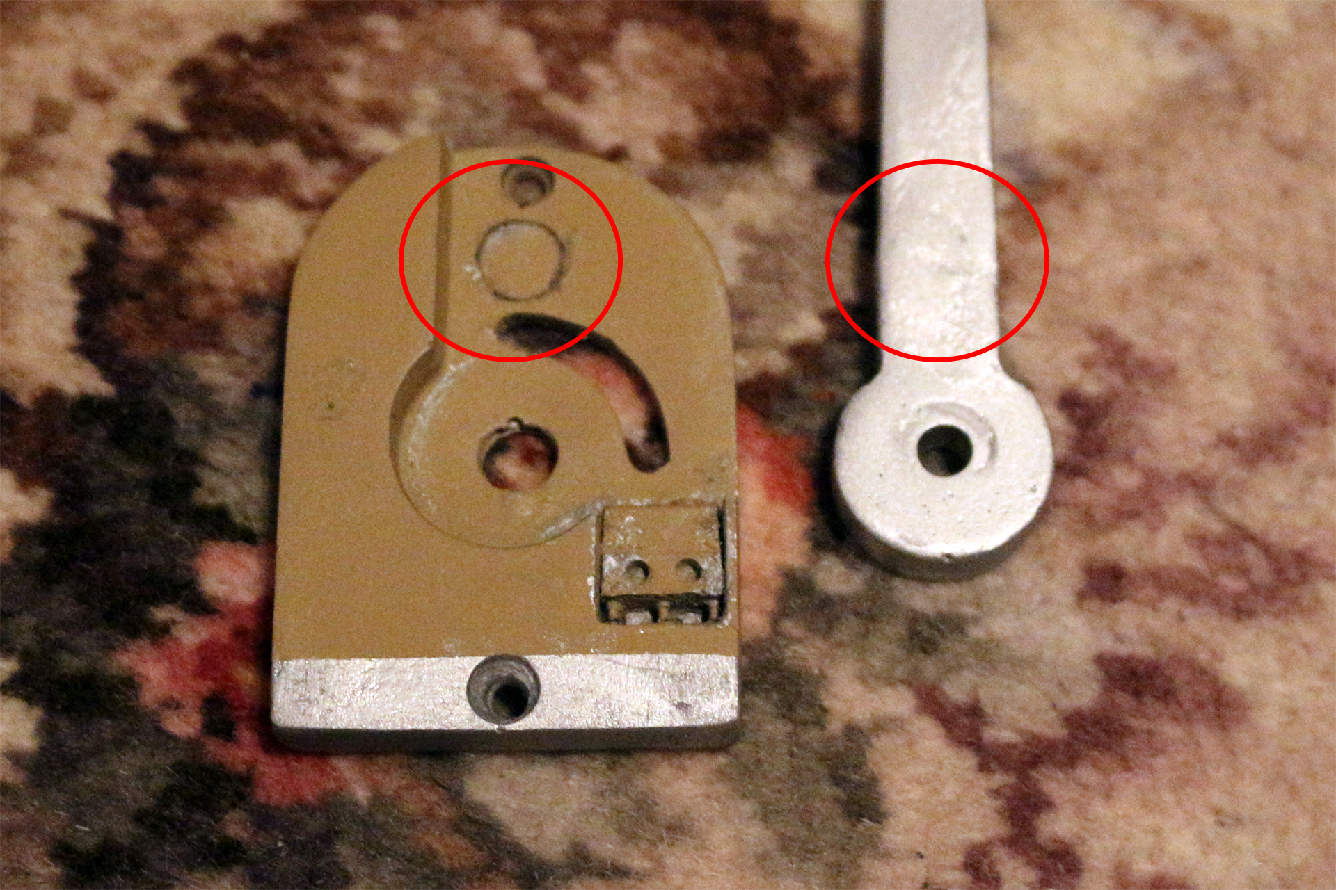

You'd need to use two small n52 magnets and drill a space the size and depth of the magnet into the ear housing and the stalk so that they line up (being careful not to drill too far if you have a hollow RF stalk with the RF light wire in it, you don't want to cut through those wires. Then match the polarities and glue the magnets in place. I'll get you a picture of my setup when I get back from work.

Here's where you want to install the magnets. They can be bigger or smaller than the one I've got, but they'll have to be pretty thin to accommodate the thinness of the ear and stalk. You'll also want to be pretty accurate with the magnet placement because the magnet will pull the stalk out of alignment if you're off. Its easier if your ear is removable.
What I did the drill and glue the magnet in the stalk first, then I place it in the correct upright position then turn it around and let the second magnet find the other magnet on the back of the ear. I circled it with pen and drilled out the resulting mark which worked out pretty well.
