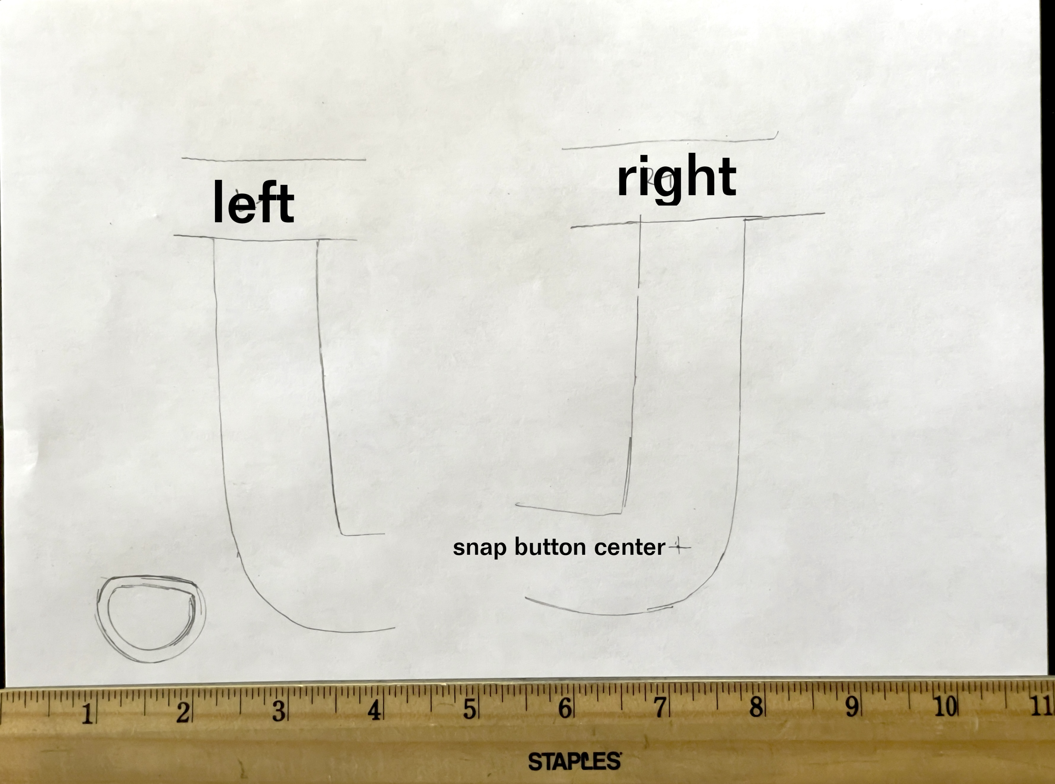

Here is the basic pattern for the artificial leather material (this image is set to print out at 1:1 scale):

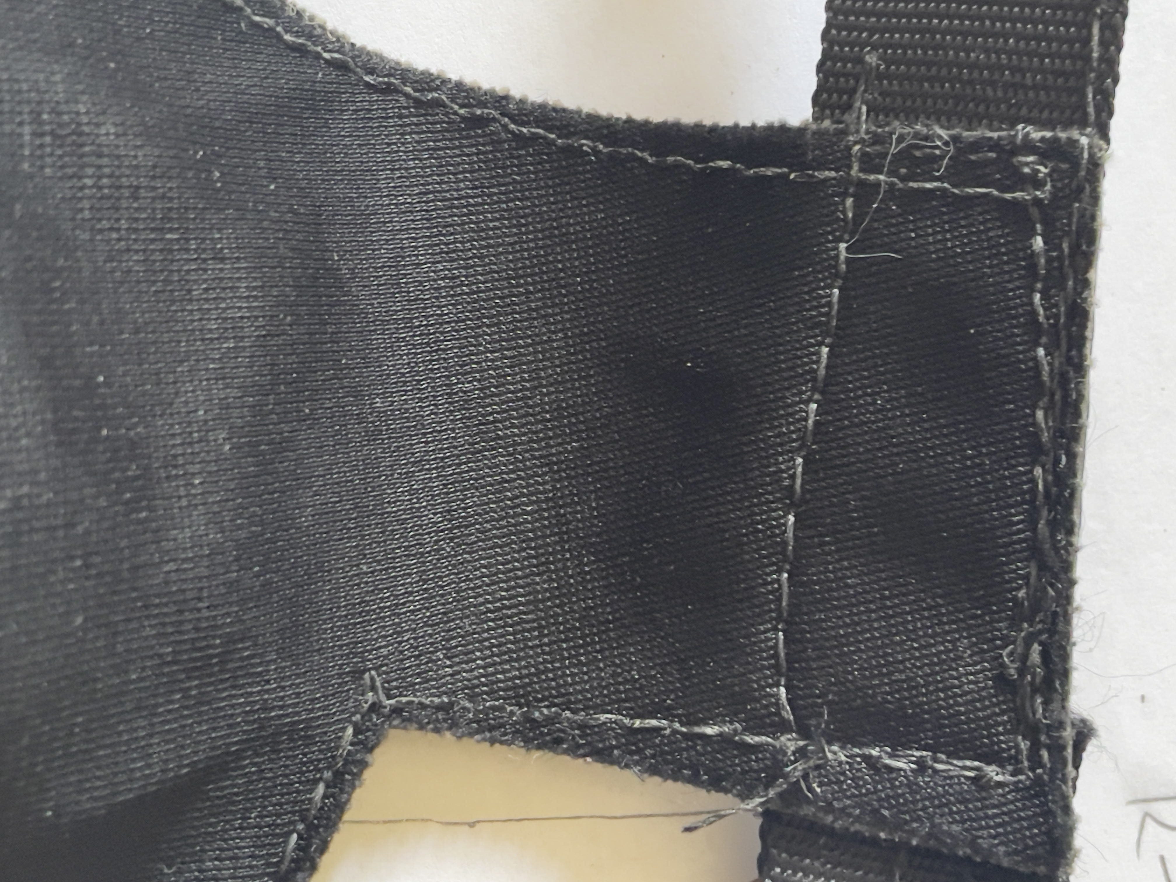

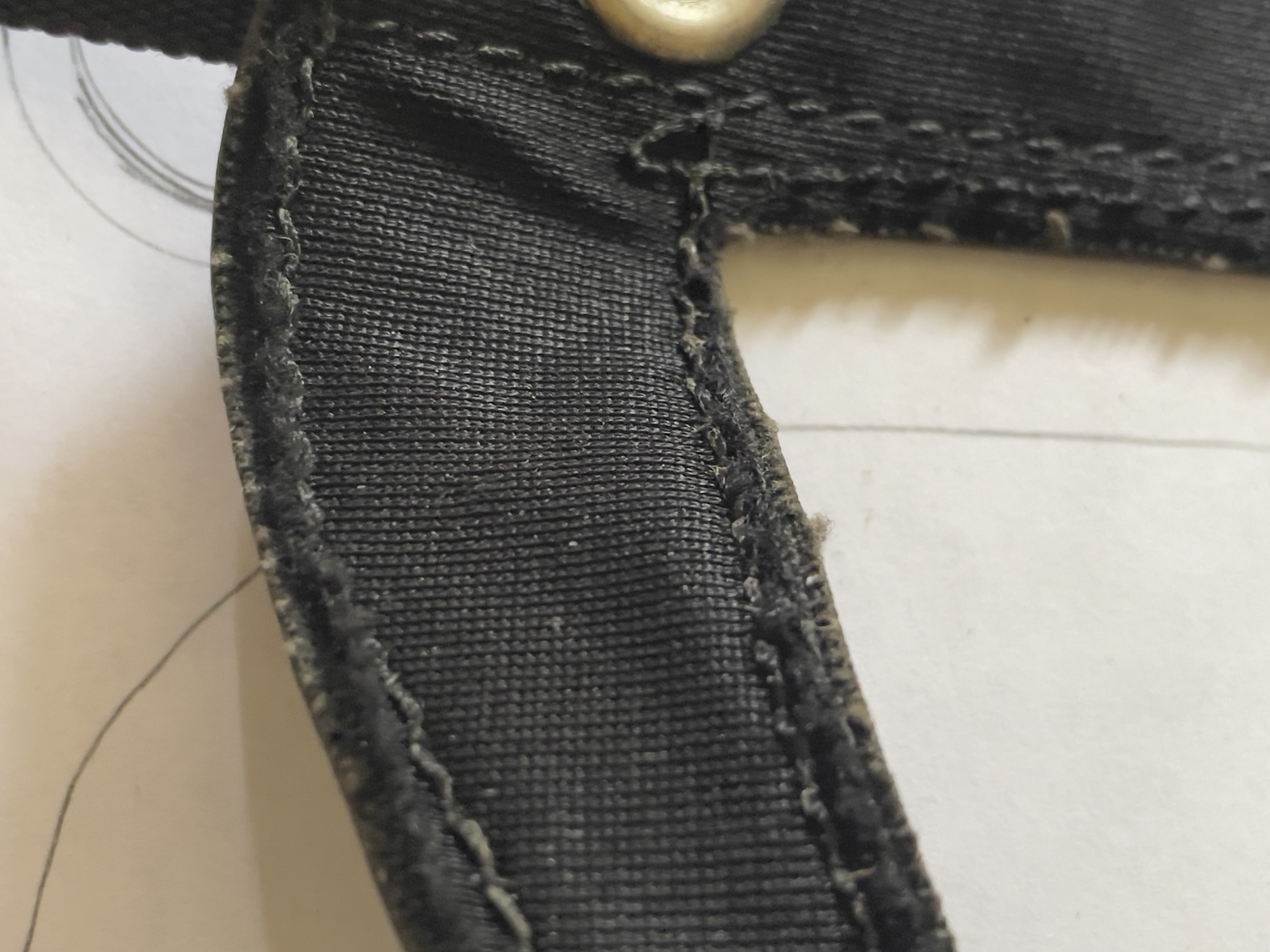

The backside of the artificial leather is covered in a black fabric:

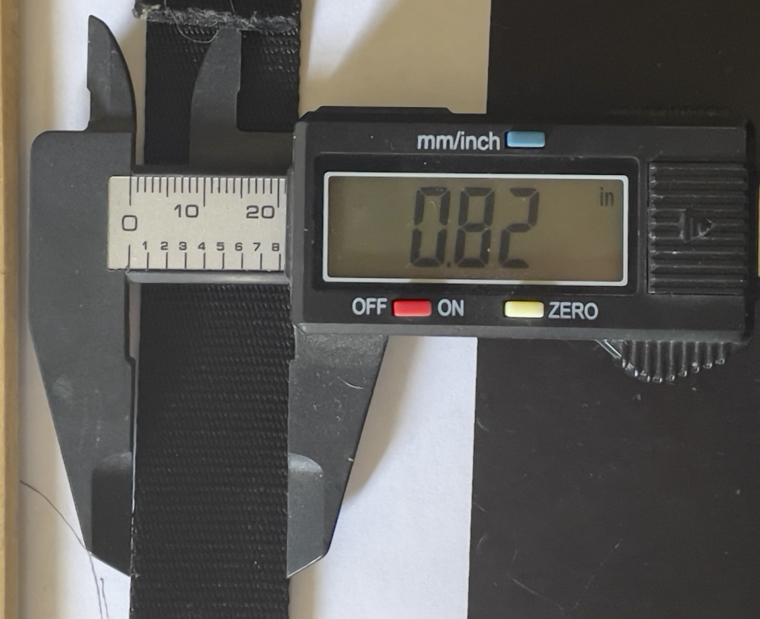

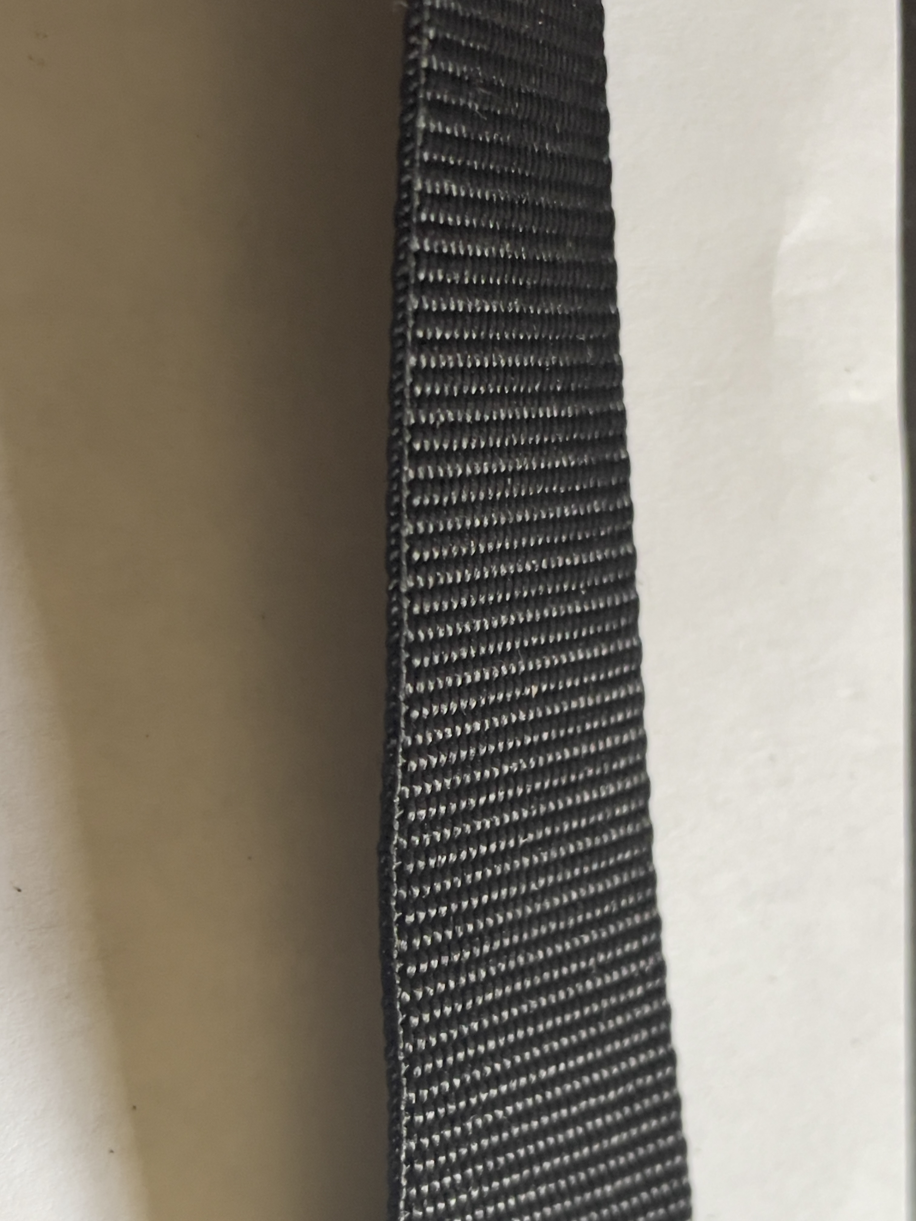

The webbing is quite unique. Haven't found anything quite like it other than on Everoak products, although there is plenty of similar stuff out there. What makes this different is its quite stiff and not soft. Its a very tight weave. IIRC it's nylon:
Here is the backside of the right strap:
Backside of left strap:

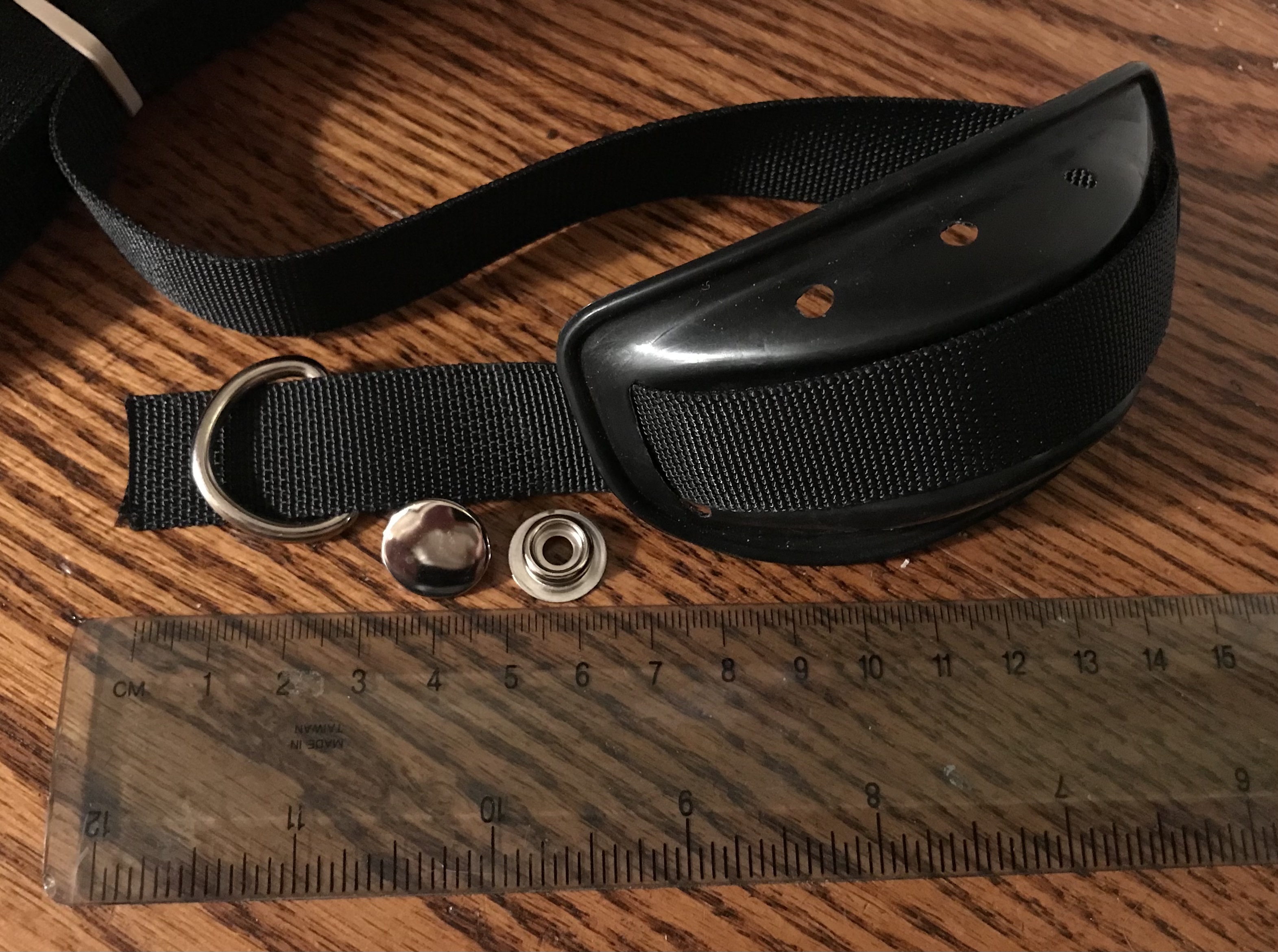

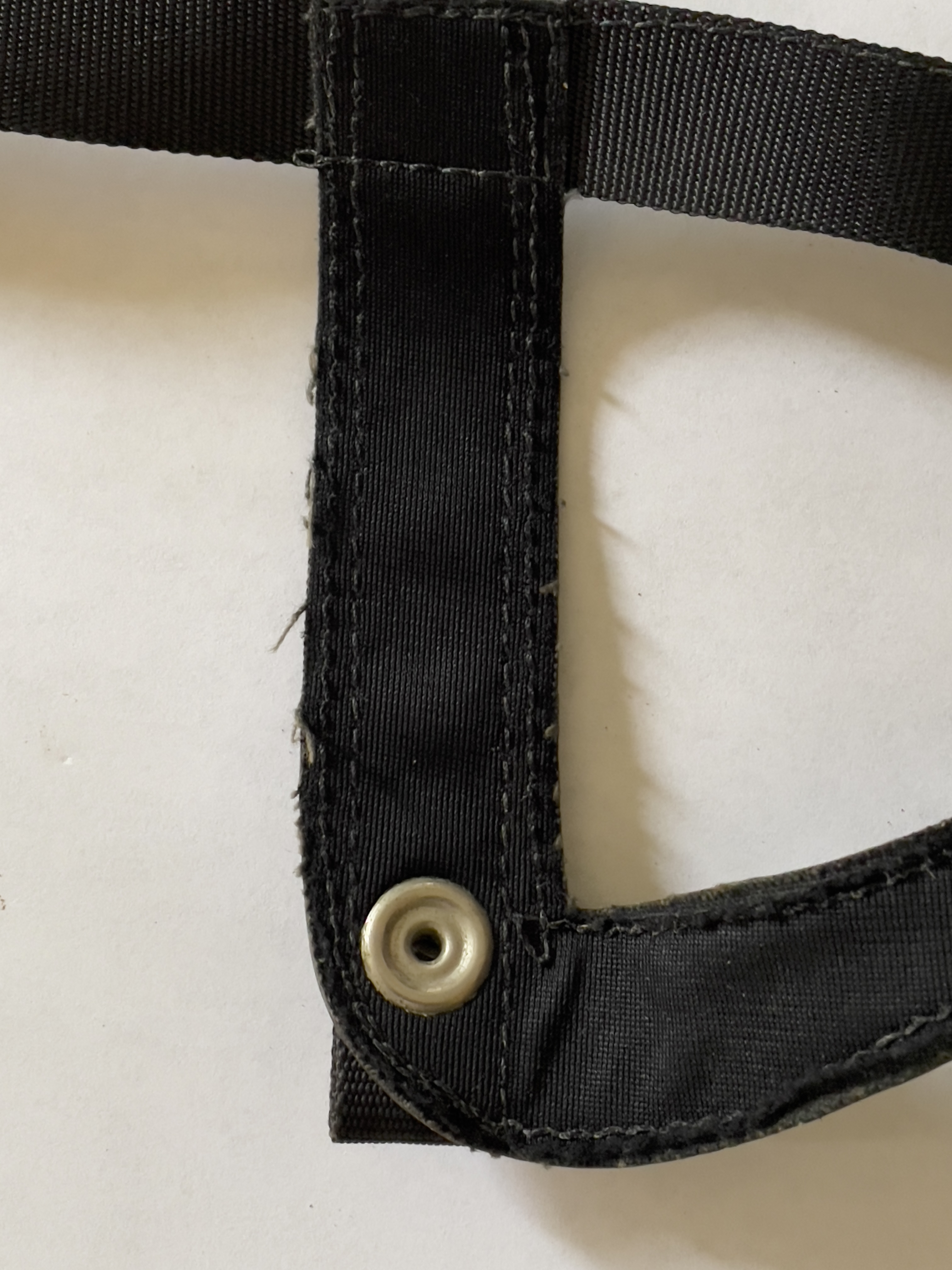

I know the temptation here is to get 1/2" for the snap button, or popper, because thats an easy size to find. But that's not the right size. These are slightly bigger. So far, I've not found anyone making this size anymore. So maybe 1/2" will have to be the way to go, though it looks suprisingly smaller than these.
close up of snap button area with stitching pattern:

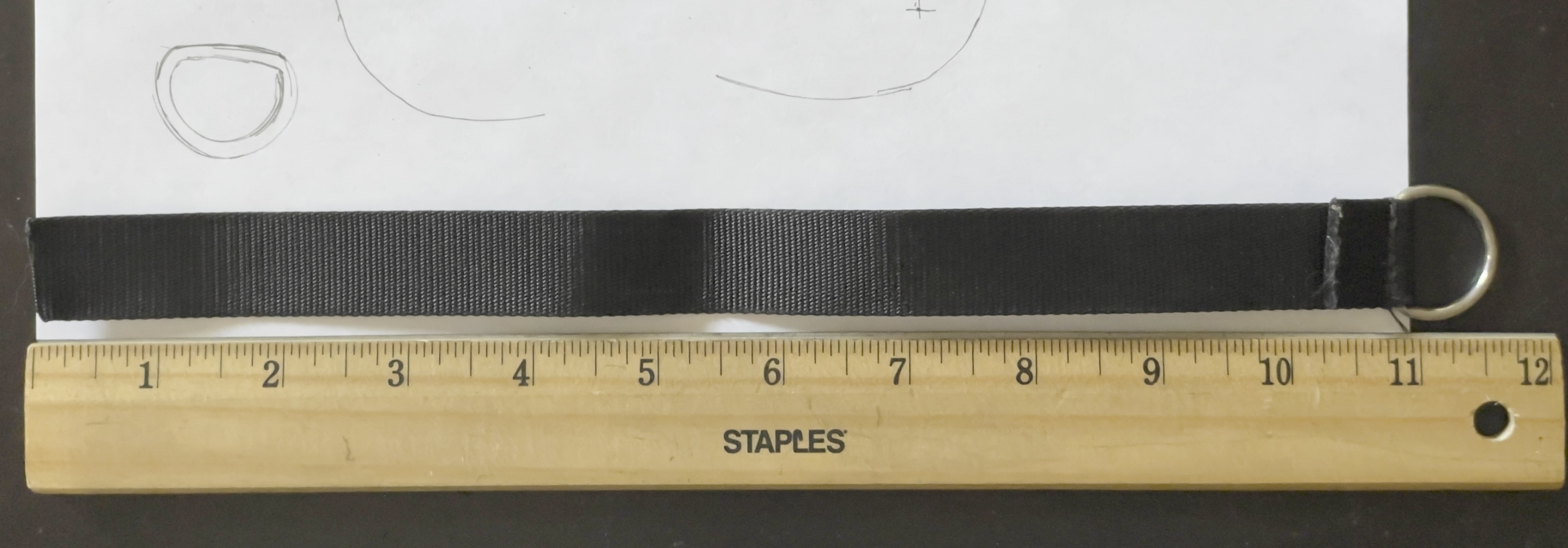

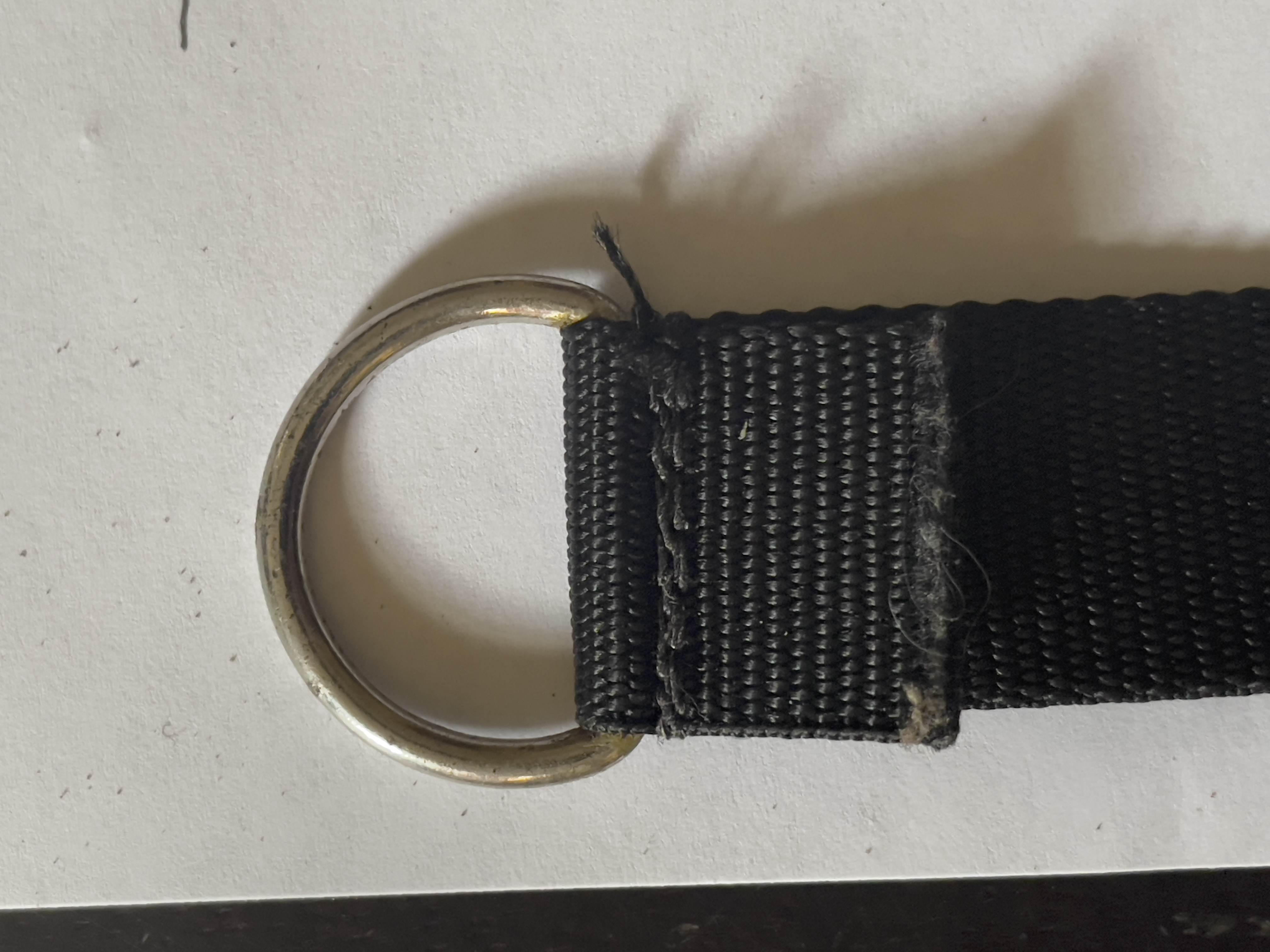

Chin strap is roughly 11 inches long:
D-ring thickness is 2.5mm. Pretty thin.
Frontside of D-ring on chin strap:
backside:
Hopefully that's enough to get somebody started.
