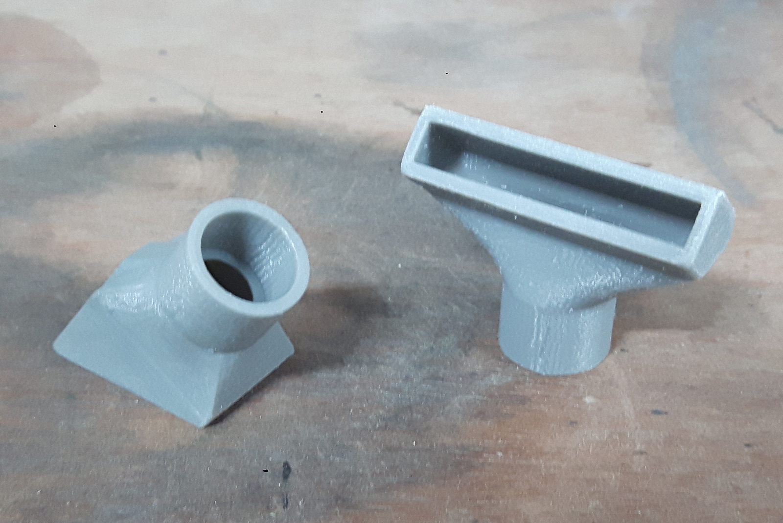

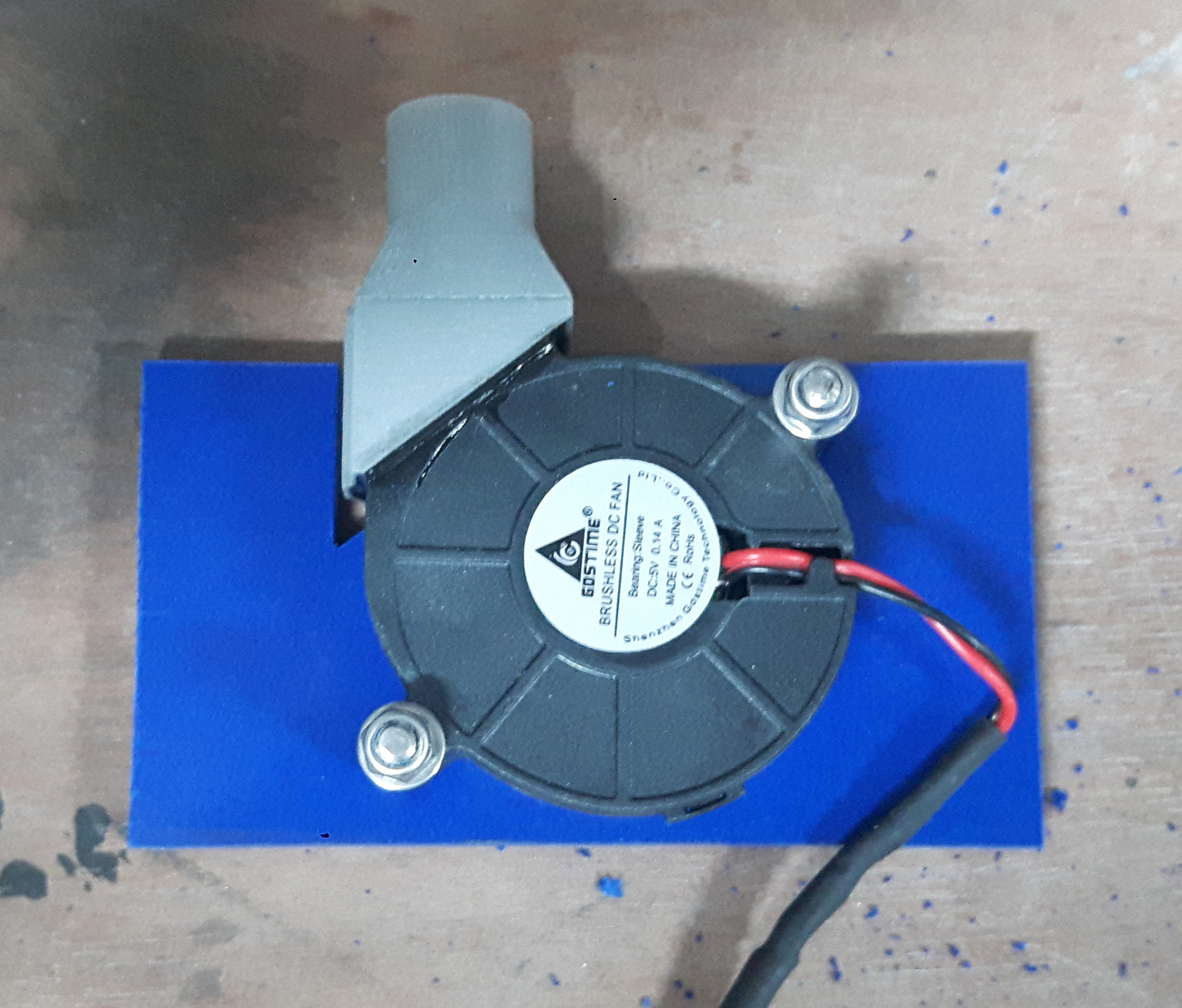

Today I attempted to tackle Jango's heat issues... Quite successfully if I do say so myself!

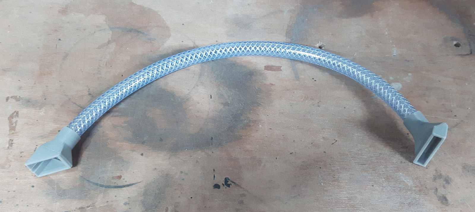

I drew up and 3D printed some parts to fit the Blower fan I have.
These parts attached to each end of some spare Boba Fett gauntlet hose I had.

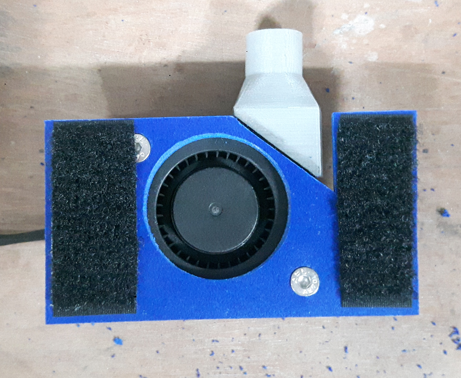

One of the 3D printed parts was glued onto the blower fan and sealed round with silicone.
I mounted the fan onto a piece of Foamex and stuck on some Velcro. I wanted all the mechanical parts to be easily removable just in case they ever need maintenance.
The fan was Velcroed (Is that a word?) behind the vent in the back of the helmet and covered in foam for a bit of sound insulation. The hose, luckily, fit nicely between the head harness and the helmet and was Velcroed into place. The 3D printed part on the other end of the hose was to spread the flow of air across my face a little better. The fan was then connected up to a switch and then to a powerbank. These were also attached with Velcro.
The end result was pretty successful, I now have a nice cool breeze blowing around my face!

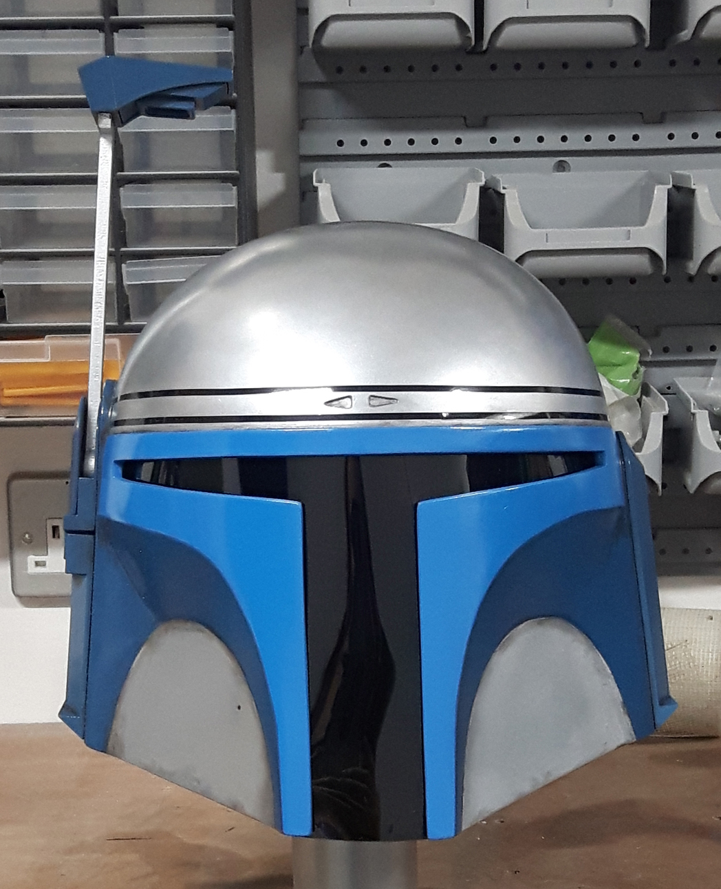

Tom, Your Jango Looks AWESOME!! You've done a fantastic job!!!
I was wondering about your helmet, to me it looks a tiny bit short. Maybe it's the lighting???
Thanks a lot! (y)
I think perspective plays a big part in this, but I think you're right... It's made from one of my Boba Fett helmets so I expected the measurements to be a little off for Jango (who seems to have a taller and thinner helmet). I've been thinking about doing another cast and trying to add some height, but doing so would mean i'd have to remake all the ear parts etc... For now it will do, haha! :lol:

Upon closer inspection, it seems the helmet is relatively the right size (the visor section at least). The dome could do with a little more height, the cheeks are too wide and the sides of the helmet need to taper less. I feel this could all be achieved fairly easily. Sigh... I'll add it to my list... :lol:
View attachment 195686 View attachment 195687 View attachment 195688
Fairly easy?!? This would mean an entire new helmet cast, wouldnt it?
You are right though... The dome is most notable, to me and the width more reflects a Boba.
Your pragmatism and solution-oriantation again only leaves me astonished!

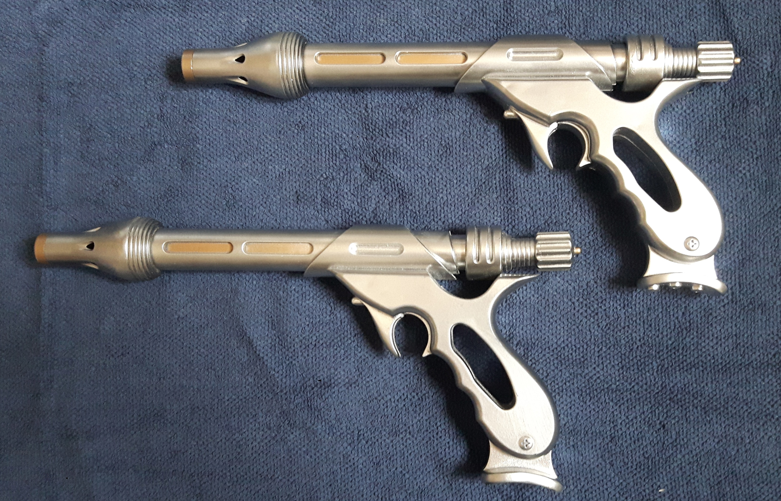

I revisited the blasters and decided to repaint the handles. I used the same Alclad II paint that I used on the rest of the blaster.

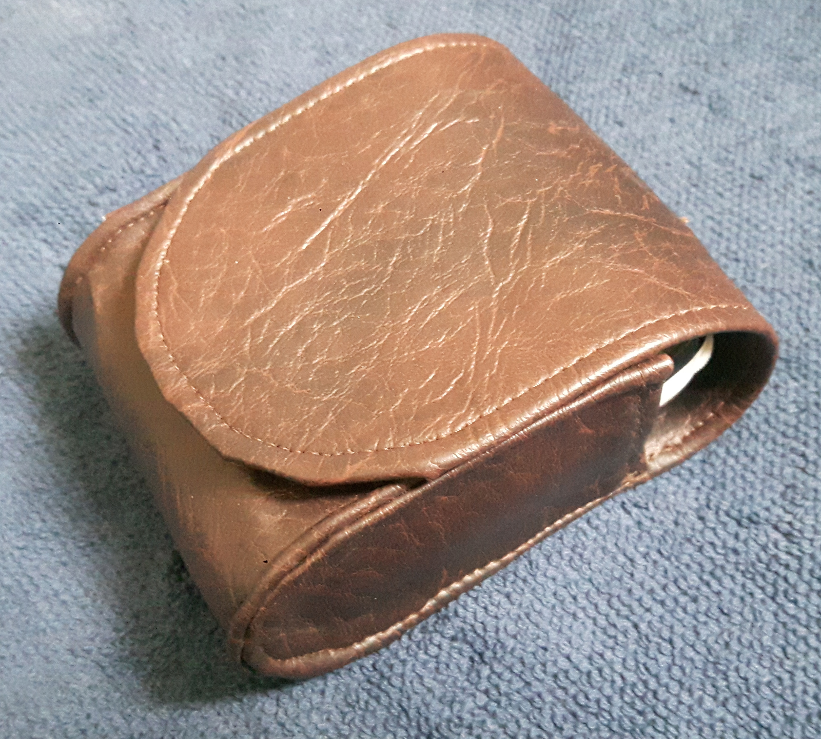

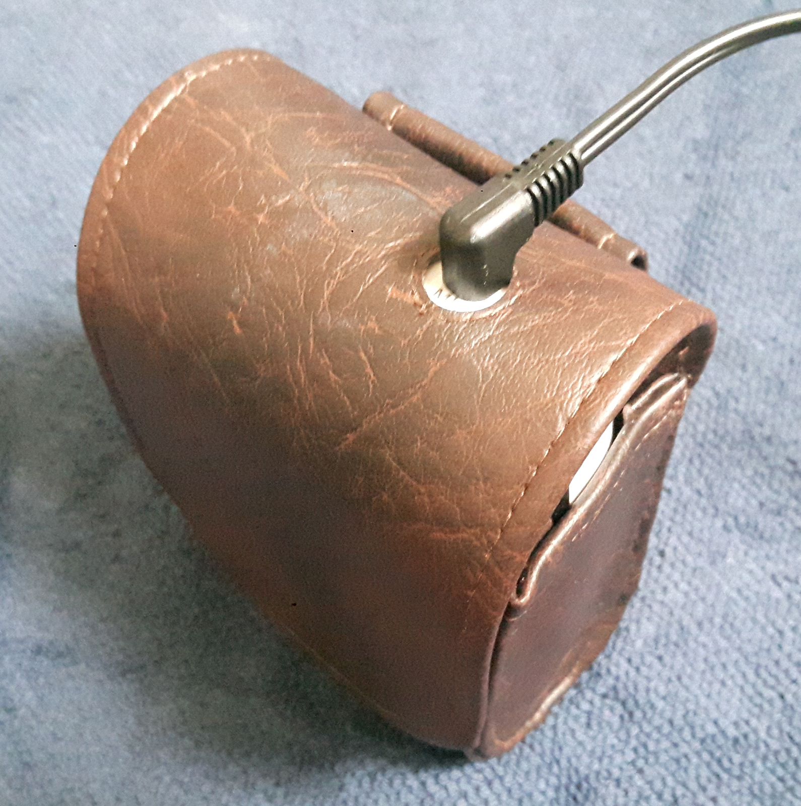

I also needed somewhere to put my voice amplifier. So I decided to make a pouch that was in-keeping with the rest of the pouches on the belt.
The mic cable plugged in through a small hole and was tucked into the girth belt and fed up through the flight suit. Once set up, the pouch could be slid to the back of the belt so it was more or less out of sight.
Also here's a quick Photoshop I did... (Which is now also my desktop background). If anyone can do a better one, that'd be great! :lol:
That's great. Could you share the 3D file for the blower adapter?
