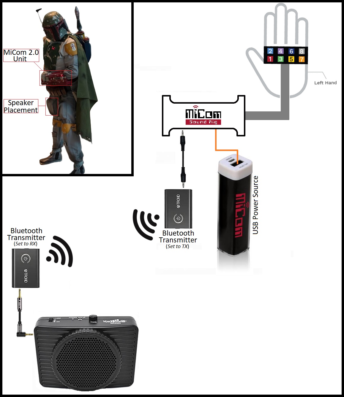

So after our talk yesterday I think I found the solution. I ordered a few parts anf im waiting for the pieces to come in the mail...I'll keep you postedHey ya Fett's!

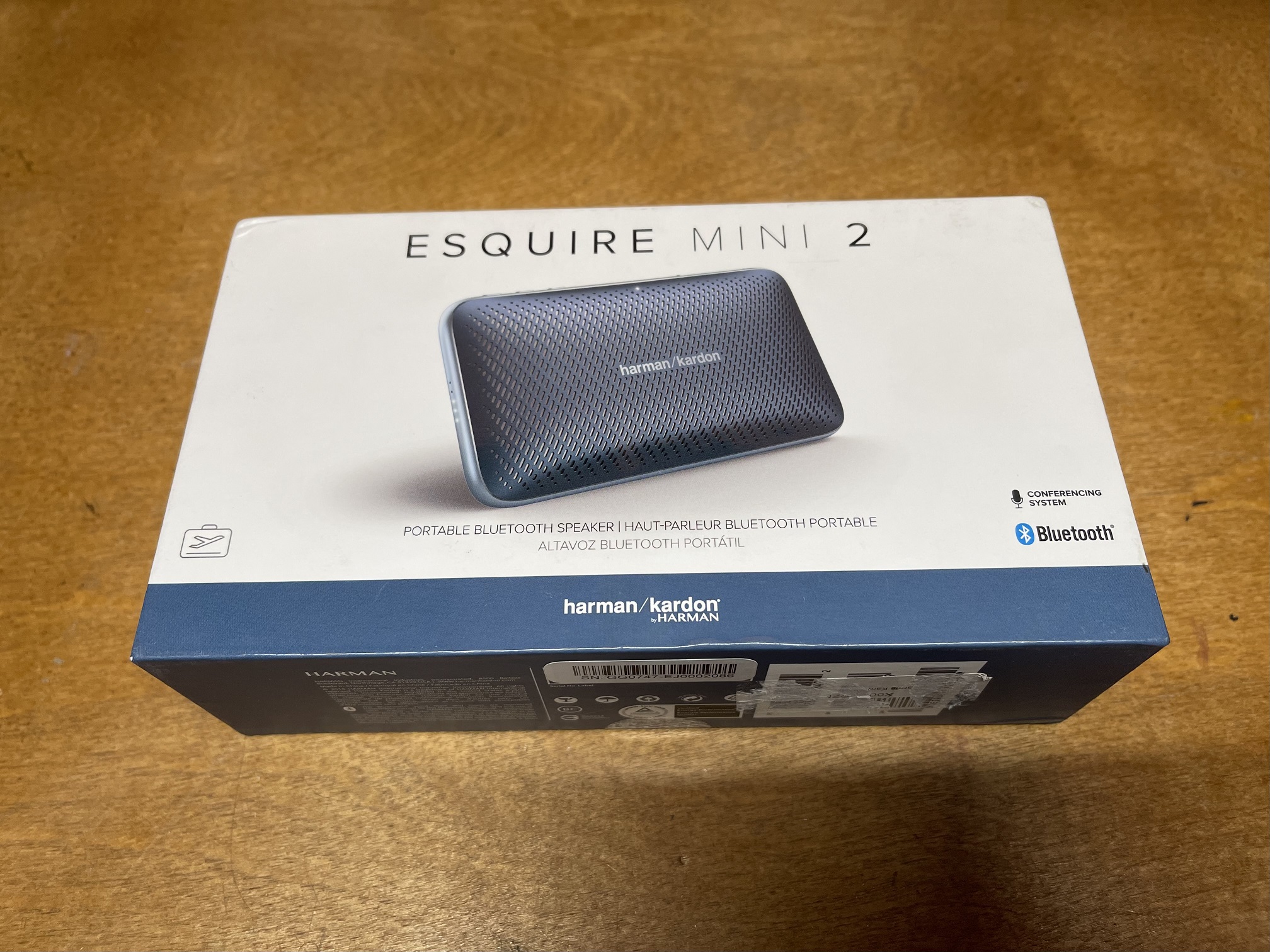

Been a few minutes, but I thought I would provide an update to the MiCom situation. I attempted with using a low profile speaker called the Esquire 2 by Harmon Kardon.
This is an 8 watt speaker that I strategically placed right under the abdominal armor. It was very discreet, but what I found was that in noisy settings (e.g. a very large con) it was difficult for people to hear the voice. In an outside setting with few people it worked great, it also worked great inside my home. My local community center has a large reception/lobby area where many people gather before events. And in that setting, again, found that folks could hardly hear me.
And so.....time for a speaker upgrade. I searched high and low for that low profile, yet powerful speaker but had no luck. I turned to VoiceBooster and picked up the MR2300 - which is a 20 watt speaker.
Another thing I kinda liked about the Harman Kardon Speaker was the fact it had built in Bluetooth (V4.1), which I used for the MiCom. On the MiCom side I used this as a way to push the audio.
The cool thing about this device is that it has a slider switch to enable either TX or RX (Transmit or Receive) This Bluetooth device is very tiny making it ideal to conceal inside my Boba Maker Gauntlet. In fact, the entire MiCom kit is inside my Gauntlet. Since the VoiceBooster MR2300 Speaker is not Bluetooth capable I bought another one of these devices to go along with it.
Sadly, I couldn't place the MR2300 speaker under the abdominal armor. I thought about the hip pouch but it just felt weird having the voice projected outwards from my side. So in thinking about it, I thought why not use the front thigh pouch? Sure, it's a low speaker placement but if it's loud enough I didn't think it would sound too bad.

...is coming up here in the next couple weeks so I thought that may be a good time to give it a test. But last weekend I was summoned once again by the community to suit up to help promote the upcoming events for 2023 including the annual Halloween event. Since it was going to be in that reception/lobby area that is quite noisy, I thought why not try it out there. I will say it is much improved, having the power of 20 watts is just what I needed. In fact, it wasn't even at full blast the little amp still had more to power to push out if needed. I did find it nice that if an adjustment was needed it was a simply matter of lifting the flap and having the volume controls right there.
I will say that the speaker is not as big as the thigh pocket, so to overcome that I used a little bit of foam cut in such a way so that the controls were at the top of the pouch. Also, I know it looks bulky, but it honestly doesn't weigh all that much and when walking around with it in my thigh pocket didn't even notice a big difference.
In short, here is a diagram to my current setup...
And so far, I'm pretty happy with it!

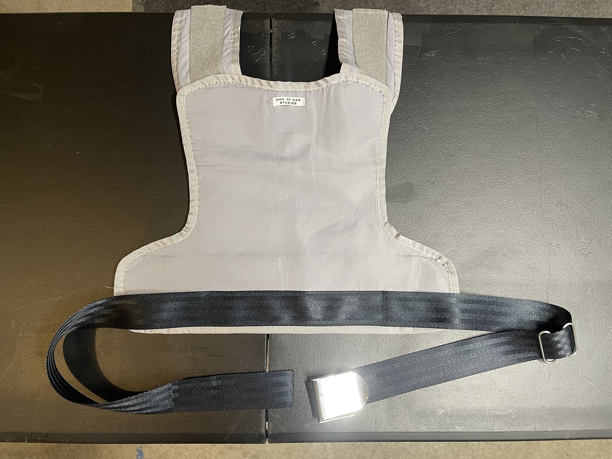

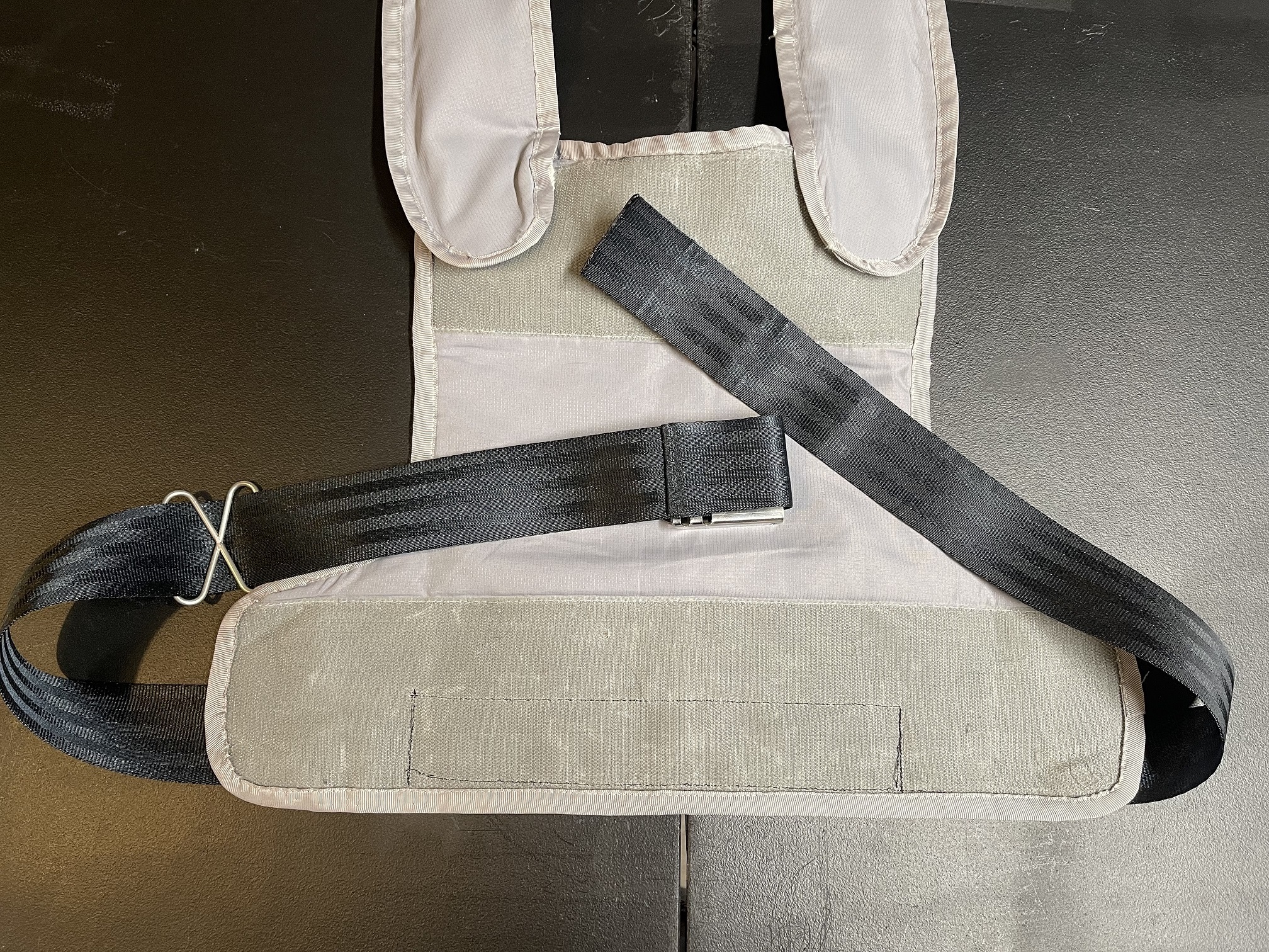

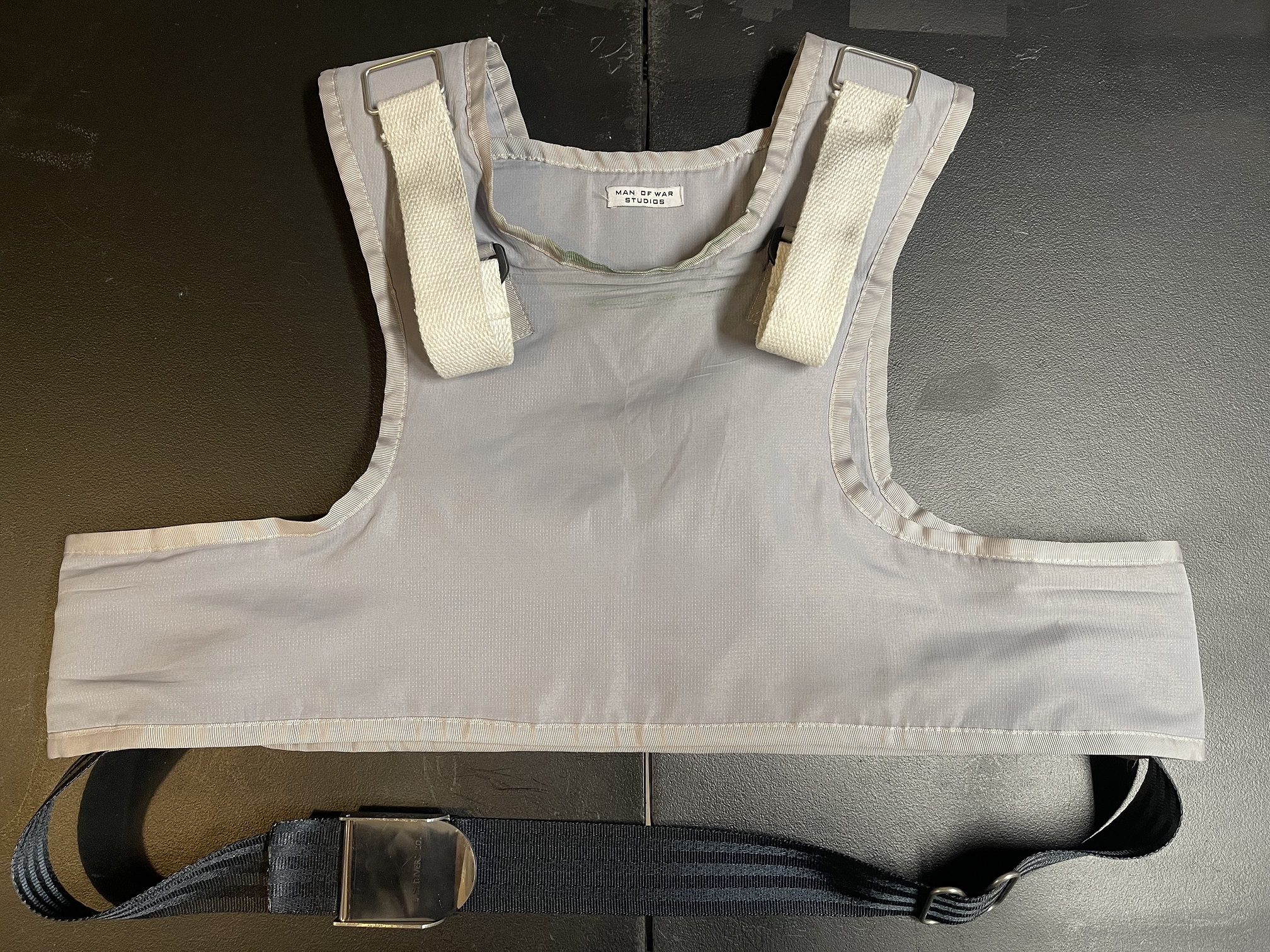

It looks waaaayy more comfortable than my scuba harness hahaha**UPDATE**
Since I have more than enough seatbelt material I decided to go ahead with attaching it to my older MoW Studio Jetpack Harness. I picked up an extra Full Metal Fett US Divers Buckle and X-Shaped Tri Glide Adjuster for my Big Dane Harness. Which I hope to get into this year just as soon as I can ditch some of the winter weight that was put on - hehehe!
In the meantime, I got a neighbor lady to assist with the sewing. Here is what was done:
1) The Seatbelt material was sewn to the inside of the MoW Studios Jetpack Harness.....

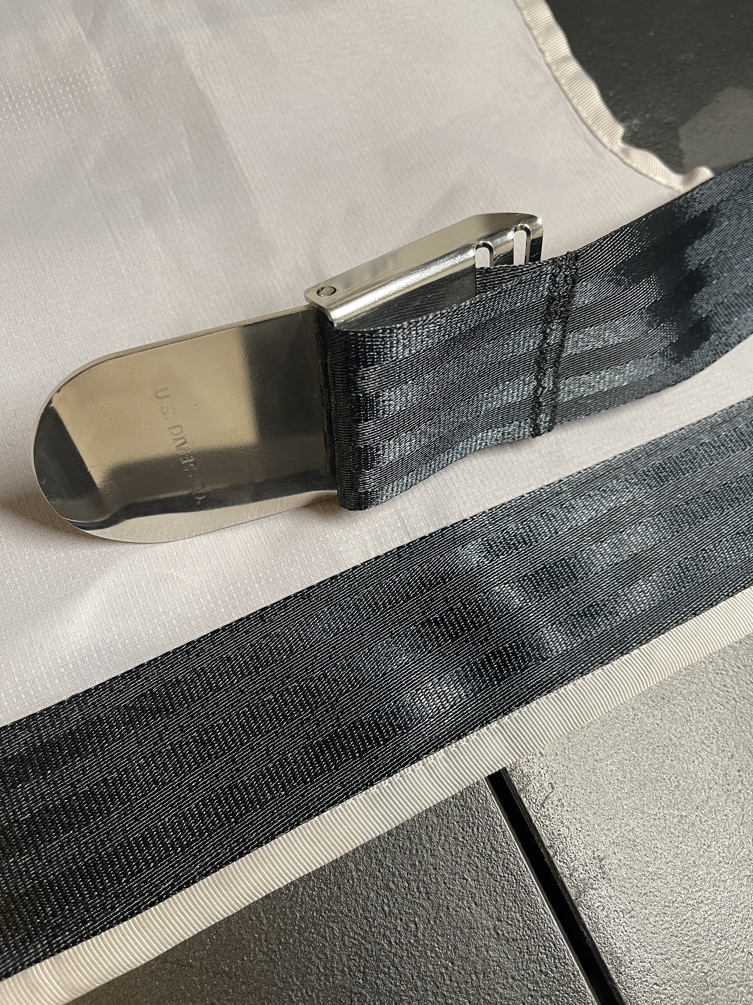

2) The Seatbelt material was sewn directly to the US Divers Buckle. I know typically these are not sewn on but I simply did it for convienience....
3) And here is what it looks like together....

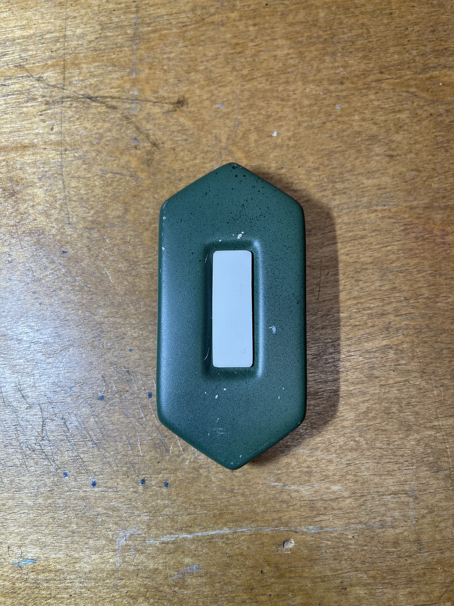

The weight of the buckle pulls it down slightly and with my vest of armor on, it peeks only about halfway out, which is what I was aiming for! The X-Shaped Tri Glide Adjuster was put on just for visual and is not functional - I just slide it to where it needs to be, which is off to my left hand side.
