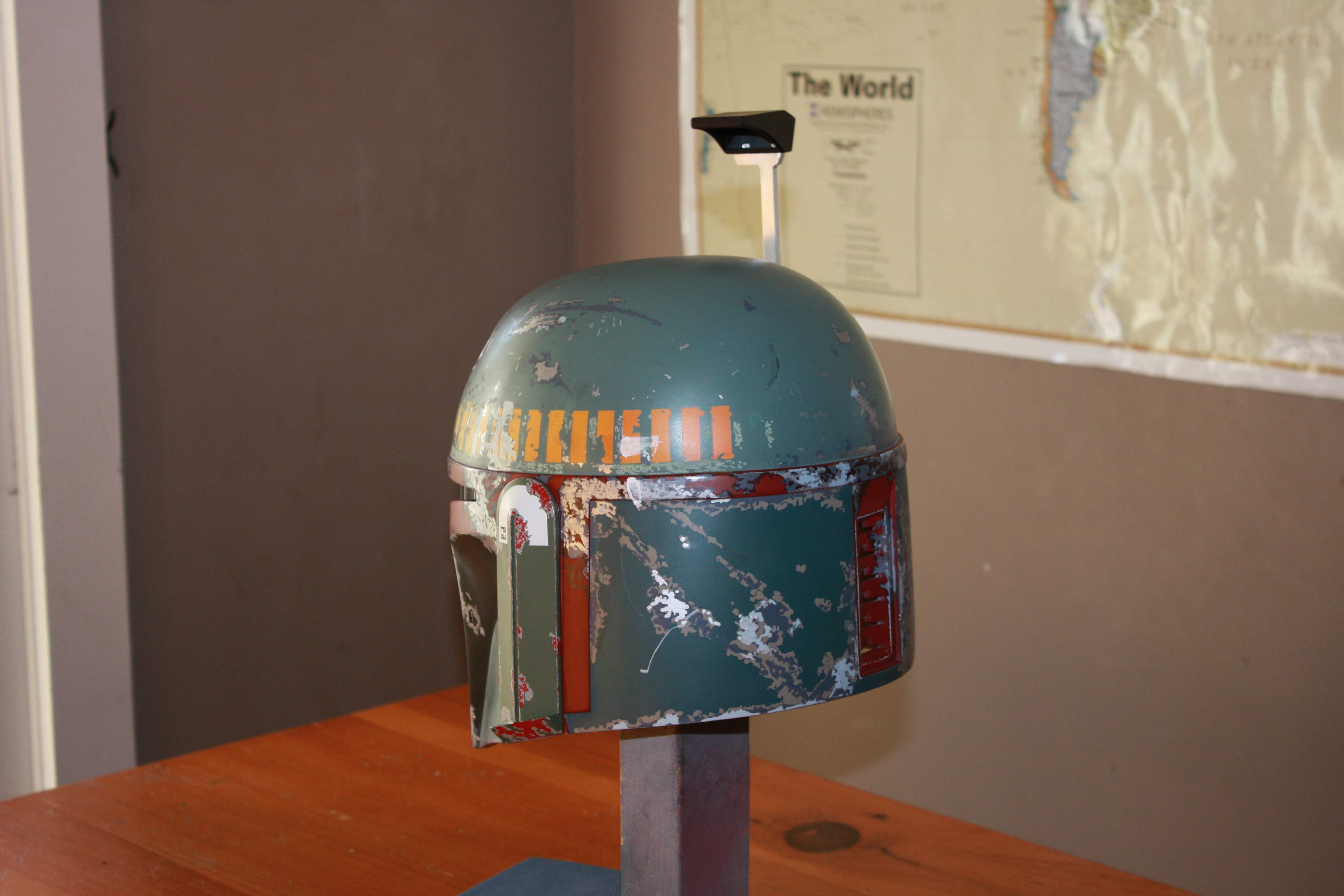

Killstripes look great! How well is hand-brushing the silver and gray area turning out? Are you going at it in one shot or using several thin layers? I am planning on using a similiar method with Humbrol paints.
Geez you guys are too kind!
All I can say is I had to go through a few different types of silver before I landed on one that would apply without being too thin or gloppy. I tried model masters acrylic silver and vallejo model color silver, both of which were a fail. Model masters chrome silver enamel was a winner. Since the humbrol silver 11 is enamel it may work well for you. As far as number of coats is concerned I really didn't need much more than a little retouching. It's all just very time consuming to get it looking right.
I didn't have the same issues with the gray acrylics, but the technique to spread it on was a little different than what I expected. It just doesn't spread like it should so I had to dab it on a little, then spread it.

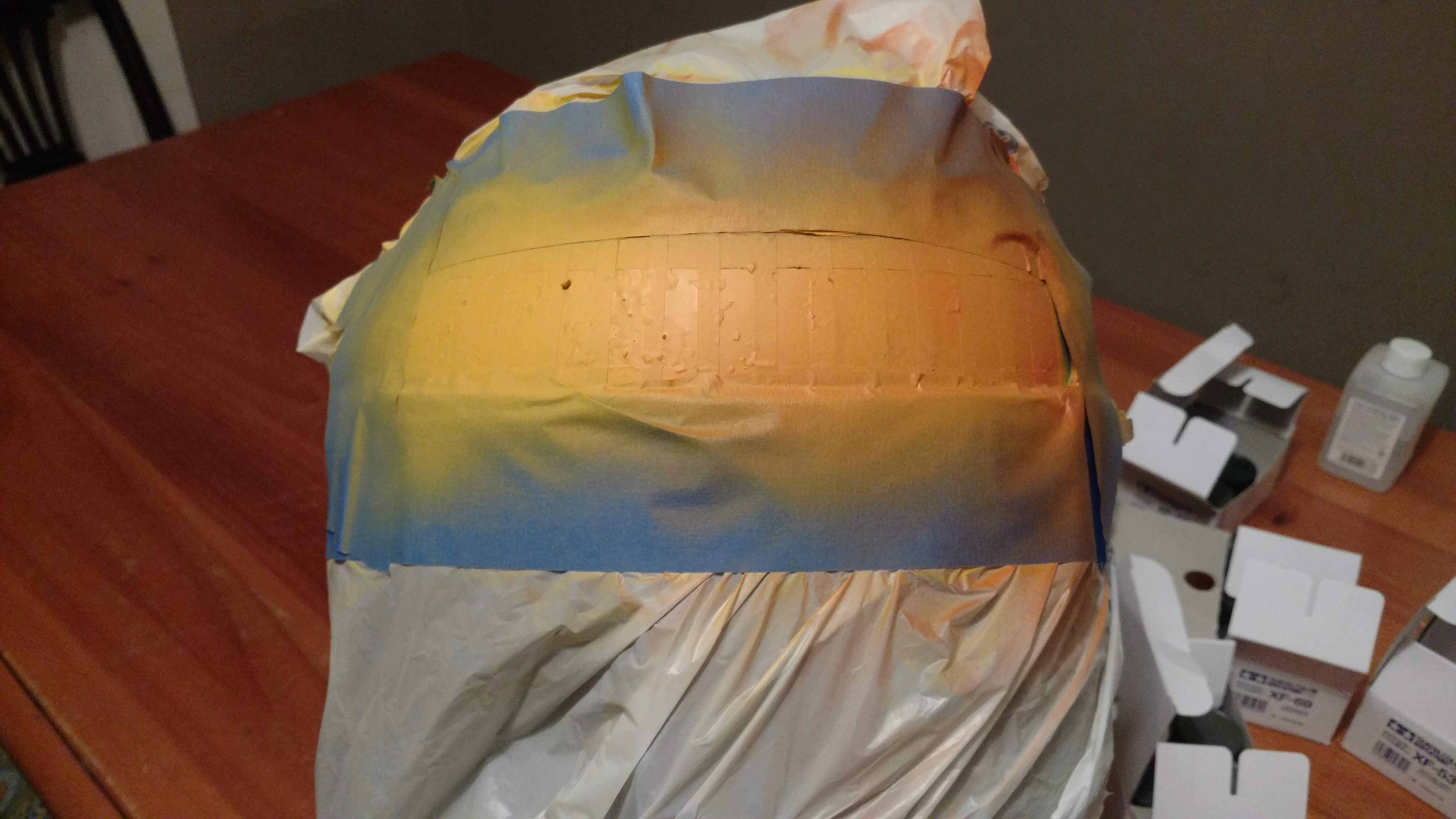

A little out of order, but I forgot that I had taken these.
Both acrylics, model master international orange and tamiya xf-3. I added a couple drops of the orange to the yellow. It was just a shade bright to me, but it probably would have been fine after I breezed over with the orange. I'm sure any similar orange would be fine. MM is just what I had lying around from my son's PP1 kill stripes.
I don't remember if it was mentioned before or not and I didn't notice any, but did you add any physical damage to the helmet? Other than that beautiful dent, that is.
I added the physical damage after casting. It's not built in the mold. I figured that way it could be used for rotj or whatever.

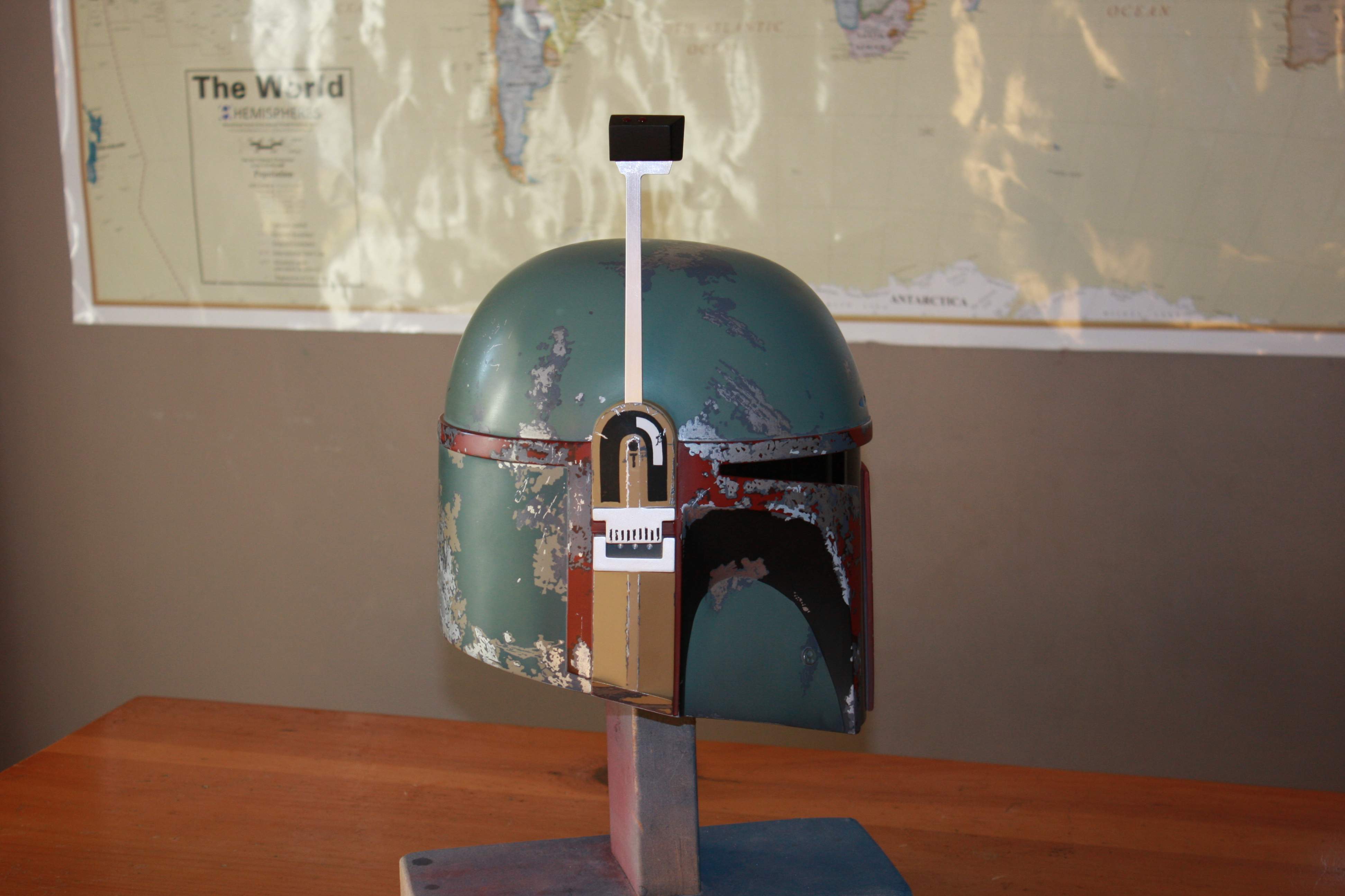

Enough evidence that this is clearly a great fan cast. So nice it almost appears not to be fan made. I've given enough complimentary feedback, so my constructive "needs work" feedback is add the 1% more weathering, don't forget the ears....
Thanks so much...seriously kind words.
syllander I see some brown splattering on the right side and ear...also maybe a little dark gray airbrushing, but I can't figure out if there's anything happening on the left side.
Just needs to get a little dingy looking on the ears to take out some of the new paint look. Maybe a little winded/acrylic paint mix at very low levels to turn up a bit of grime.
Ah gotcha. I'm definitely going to do that.

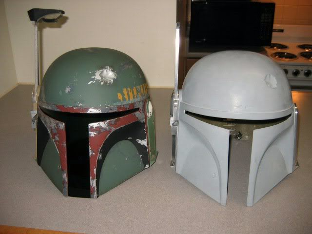

Soooo, how's that master mold coming along?! I like the flair, the paint, everything!
Thanks brother. I'm about ready to start pulling some casts. The last month has been consumed with getting a paint-up complete. I'd like to tweak a few things on my ear cap mold, but it's really not too bad as it is.
