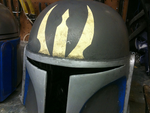

The mold came out great!
For the casting, I tried something new... Smooth-On's Cast Magic Silver Bullet. It's a powder you brush on the inside of the mold, and it gives a metallic finish that's embedded into the resin. Sort of a "light" version of cold casting.
I'm really happy with it! It's not as shiny as rub n buff, but it's about as good as your average silver rattle can. A $4 container of it will probably do 6-8 helmets, so it's a trivial cost. It adds about 15 minutes to the casting process but that's not much really.

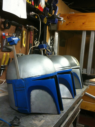

Anyway, less words, more pics! Here's a raw cast with the visor area trimmed and a T-visor.com visor fitted into it. I had to trim the visor down a bit to get it to fit, but nothing major.

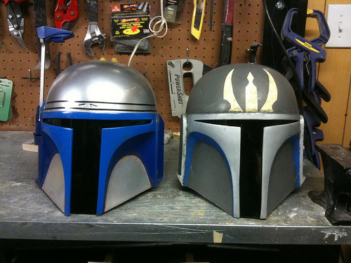

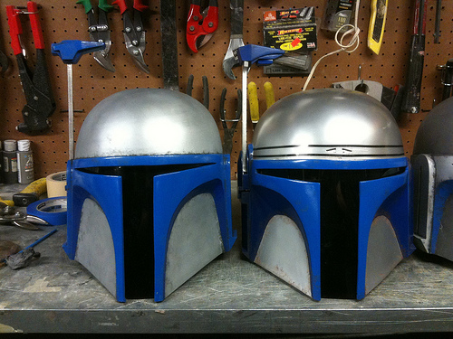

Here's the first cast I made today, painted up as Pre Vizsla:
And the second cast as Jango. This one isn't quite done yet, but it's 2AM and I have to go to work in a few hours ;)

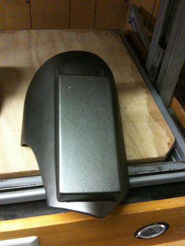

Working on the backplate now.

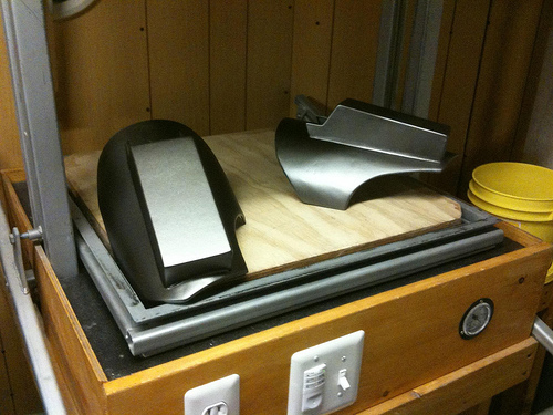

Armor is carved out of MDF / Bondo like my clone, then vac formed out of 0.080 HIPS.

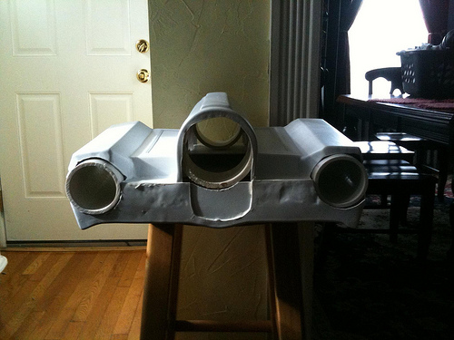

prototype is assembled!
i mangled the bottom in assembly... over trimmed, over glued, etc...
but it will still be workable. i'm going to start in on the addon parts this week, and hope to have the pack knocked out by the weekend.
now i just need to learn how to use my lathe!!

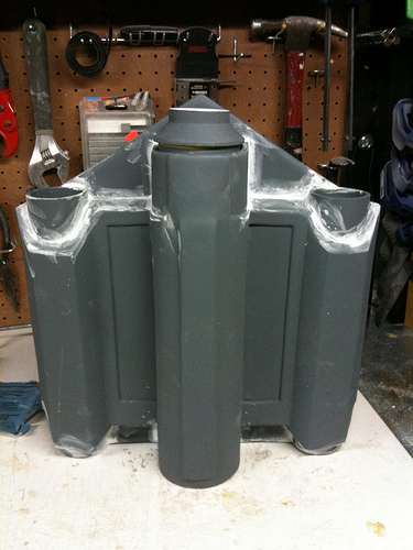

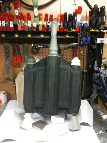

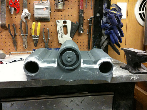

primer and final filler down on the body.
you can see there that i've also made up the base for the rocket assembly. it will be cast in resin ultimately, so for now the original is just loosely fitted into place.

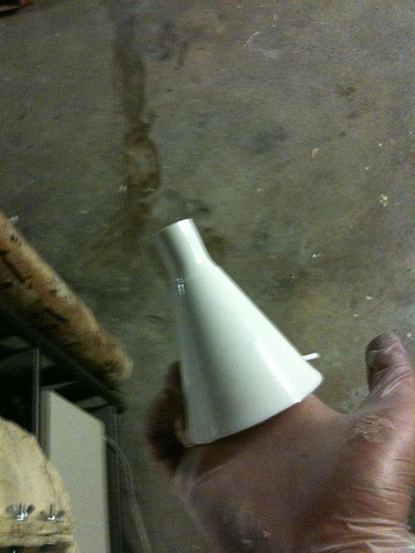

i also made up the bottom vent/thruster/whatever for the center tube. it's not particularly accurate since i only had a couple of fuzzy shots of that part. it's good enough for me though! it will also be cast in resin.

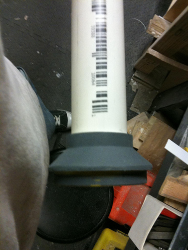

the rocket base will be 1.5" PVC... it should plug right into the resin socket. i hope :)
hopefully randy will be able to help me out with the lathe and get the rocket made. i could do it by hand, but it would be nice to have it more precisely crafted.

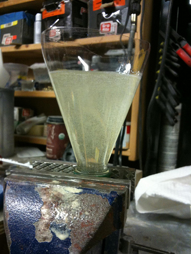

Boy, building jetpacks is thirsty work...

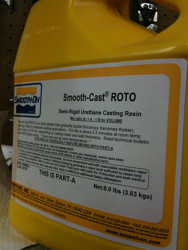

Let's just pour a nice, refreshing cup of Smoothcast ROTO!
Hrm... this isn't tasty at all!
But it does make a pretty awesome base for the thrusters!
I'll just have to do a bit of detailing on the underside and make the base to mount it to the pack. The final ones will be made with Featherlite rather than ROTO, since ROTO is heavy.

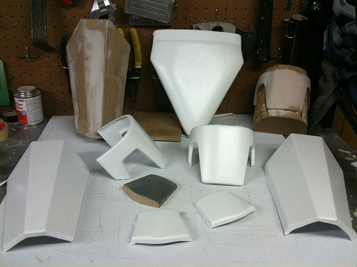

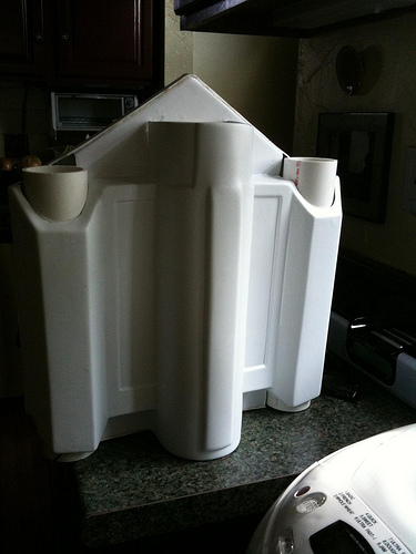

Since last I updated here, I've finished the sculpts for the jetpack, molded the resin parts, cast them up, and assembled my pack:

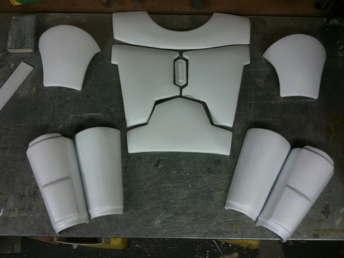

I made the thigh armor:
And last night did the hands, cod, knees and shins:
The shins might be flared out too wide. They looked good over my jeans, but I'll need to see them over the suit with the right boots to be sure. If they are, it's easy enough to sand the mold down a bit and re-pull.
Now it just needs some sanding and paint.
