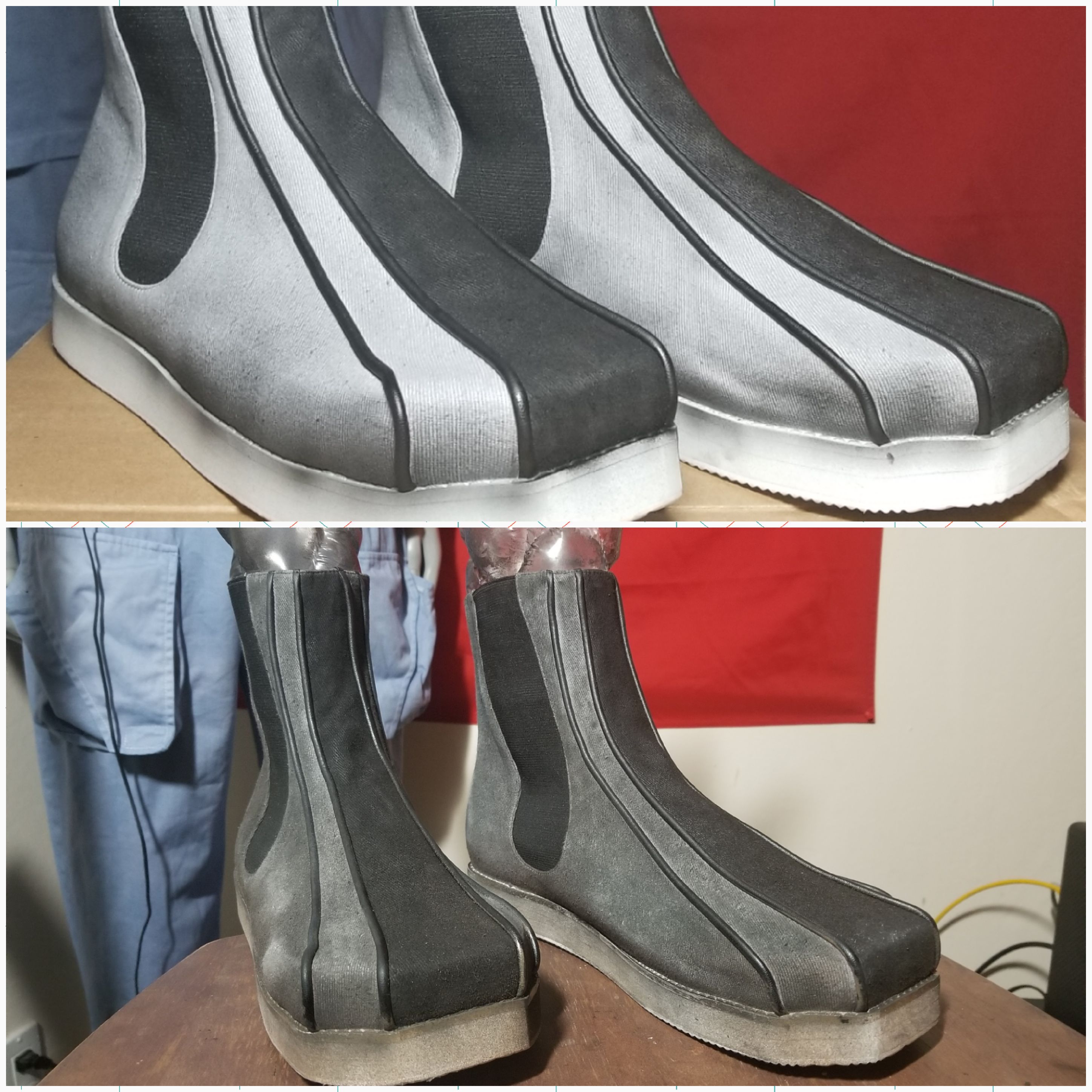

Also decided it was time to put some weathering on the Man of War boots! Taped off the middle stripe and airbrushed thinned black enamel paint. Airbrushed the base with black, then followed up with a thinned dark gray for the rest of the boots. You'll see the stock color is a light gray, the dark is more in line with film references. Took some light sandpaper to the surface and roughed up the boots a bit. Likely revisiting this before completion, but it's in a good spot.

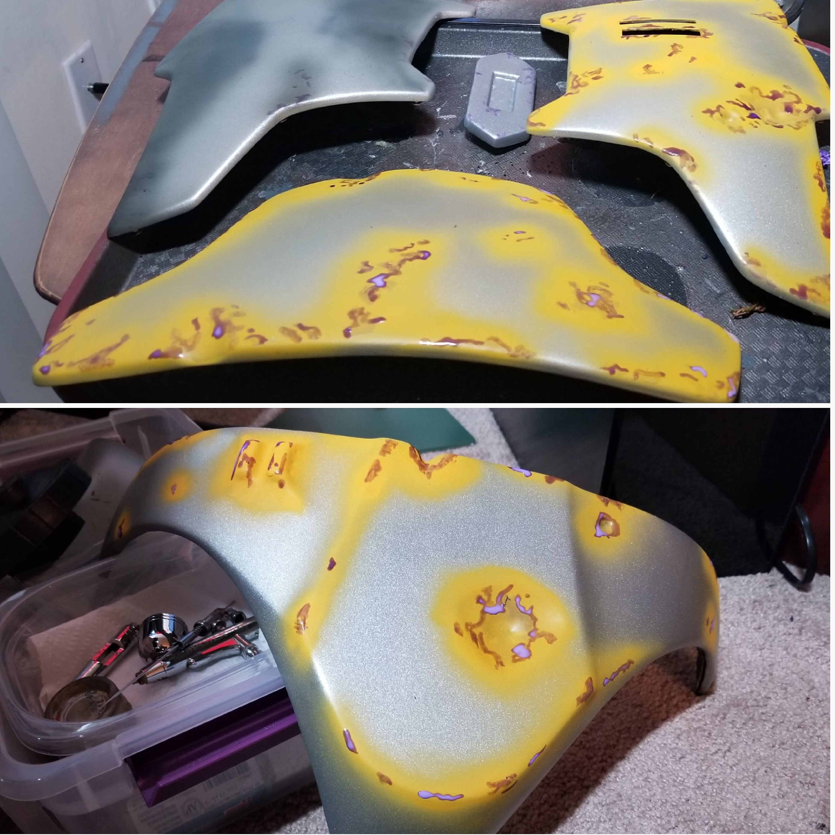

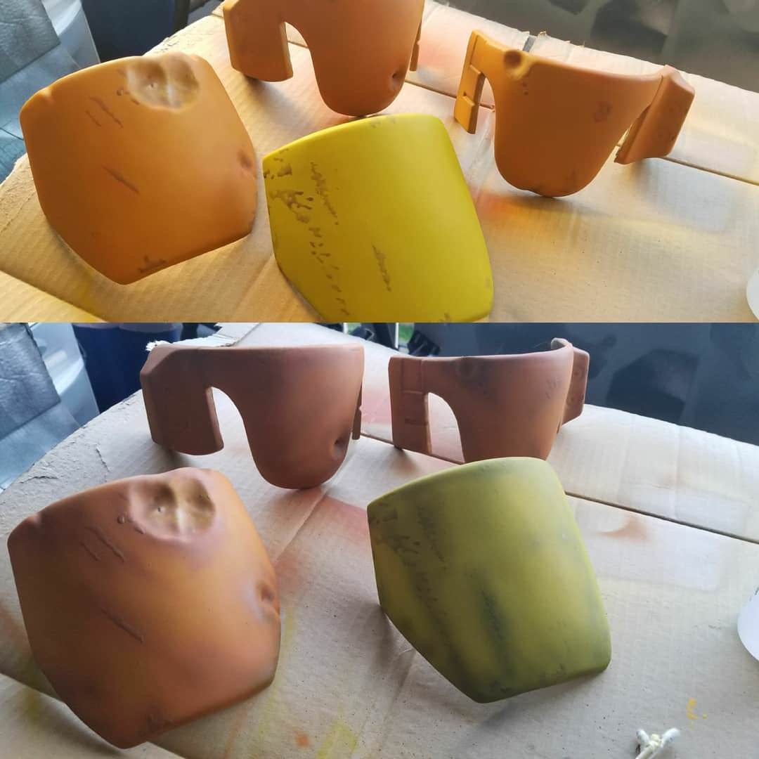

Quick update: Masked all the armor and then used an airbrush for the first time and kind of knew what I was doing.
Put on a light layer of yellow then masked the next layer, prepped for greens.

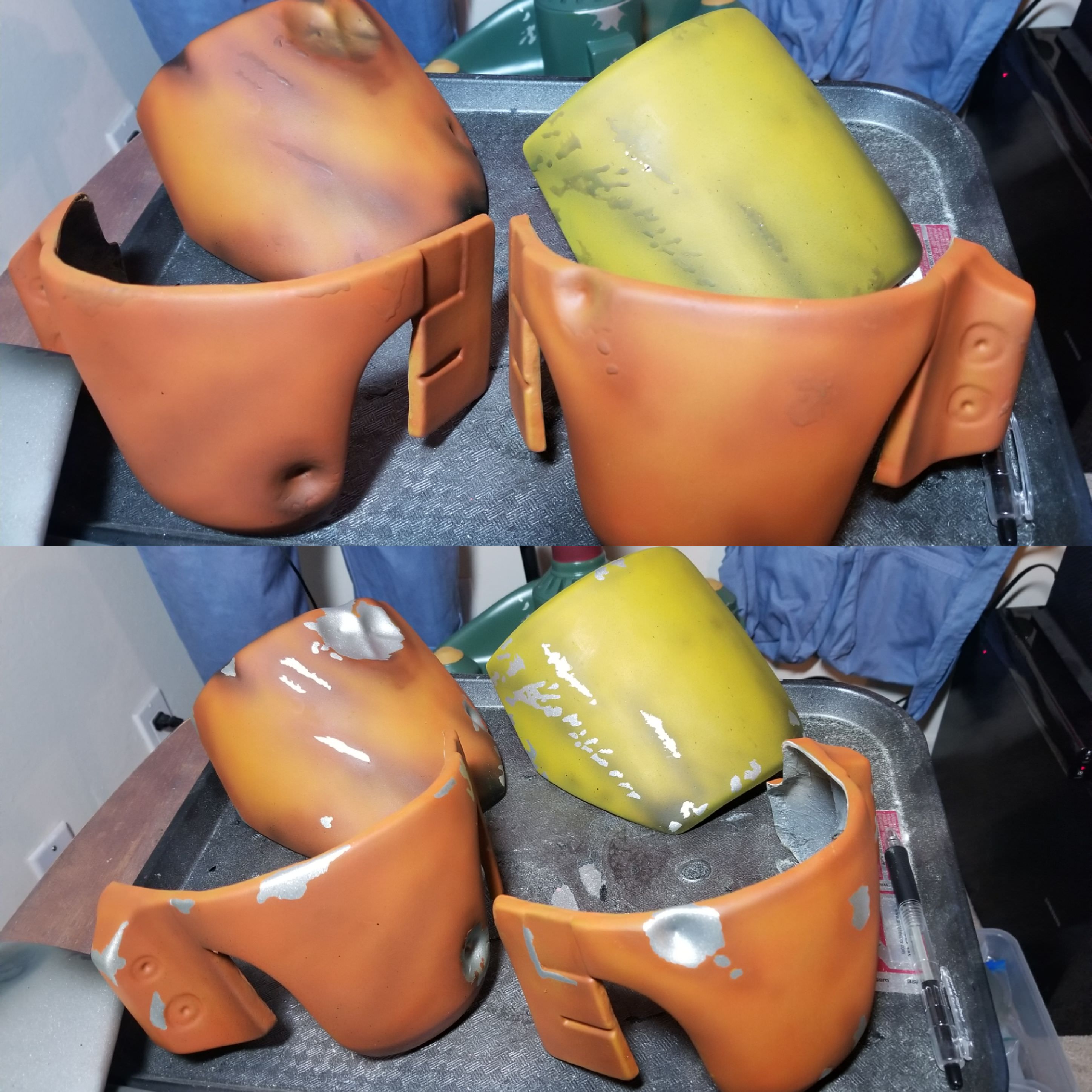

Put down a yellow layer on all of the armor, then went over the knees and shoulder with an orange/yellow mixture.
At the end of each color, I added a bit of black to darken the shades a bit and went over the damage areas to bring out some color variation. I may End up revisiting the left knee to add some more yellow in, and likely revisit everything in the end with some black.
Pretty happy with the way things came out for the airbrushing attempt.

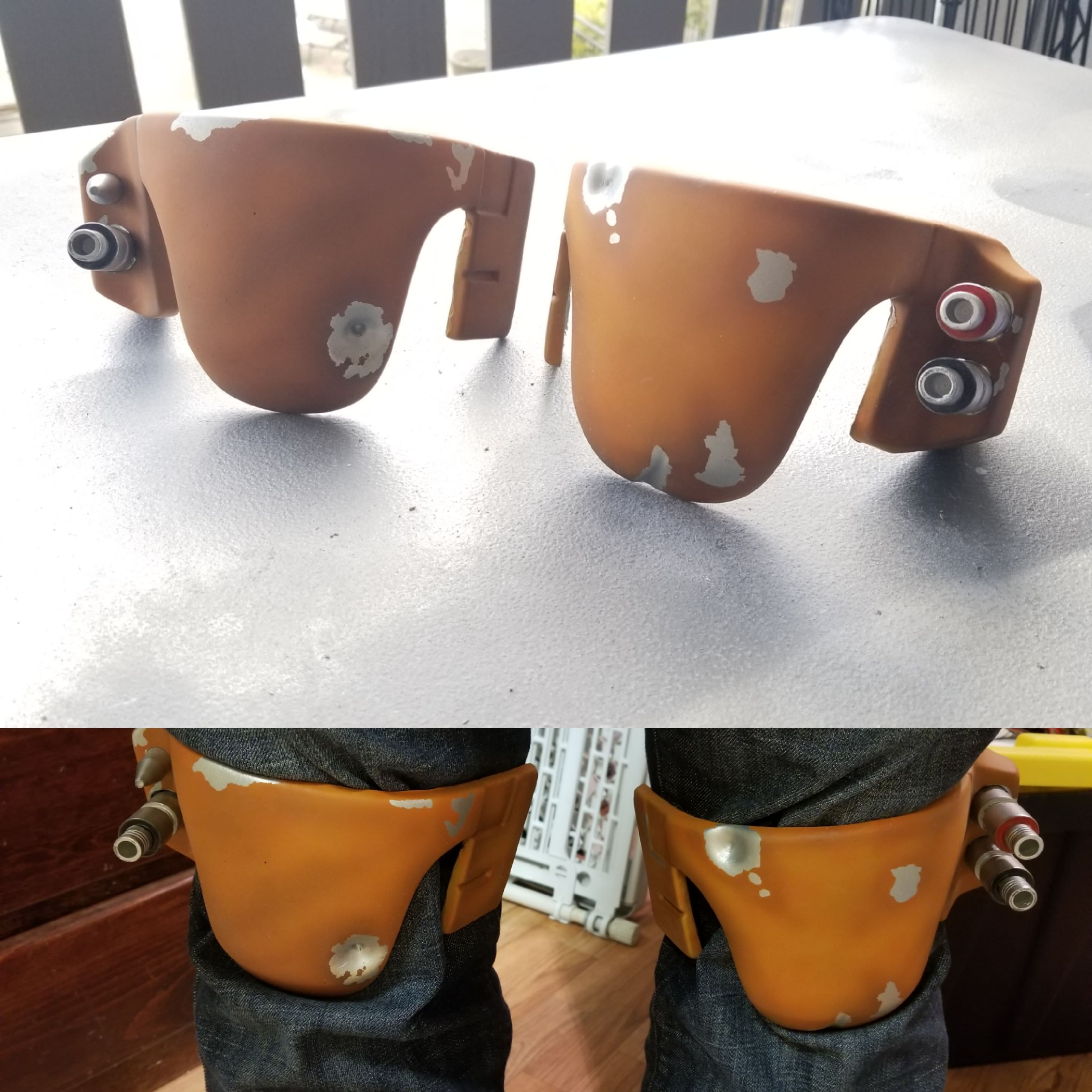

Eventually cut into the knees and popped in the dart launchers after the tips got painted up. Put on the white elastic attached with snaps mounted to a piece of komatex.

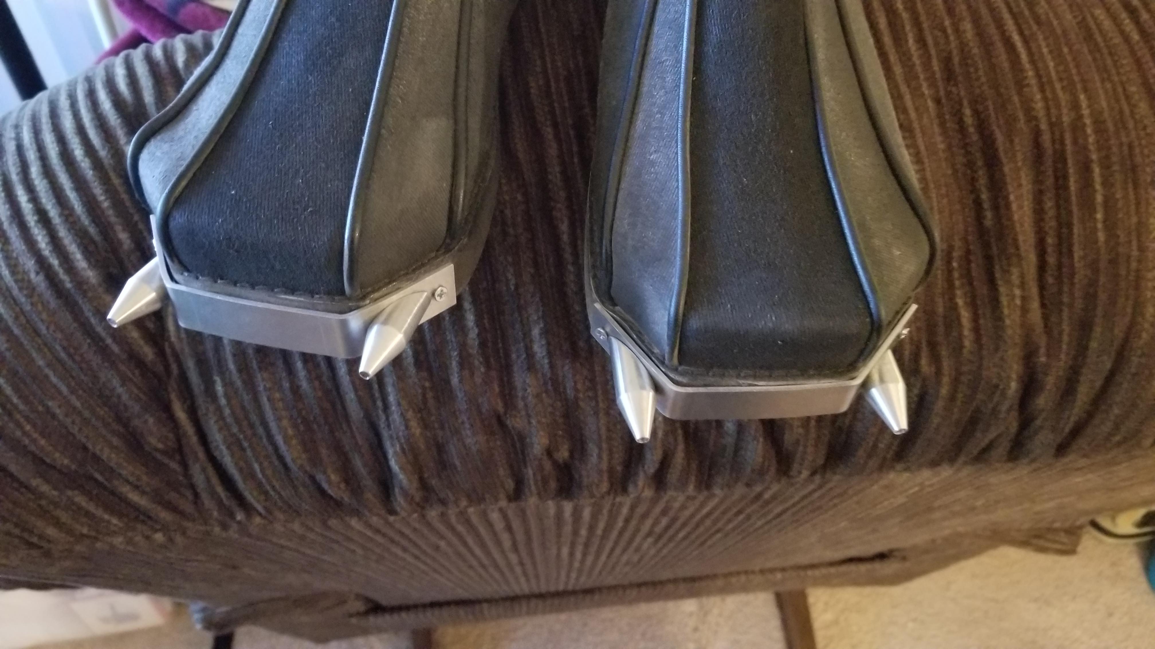

Boot spikes from Machine Craft Replicas were put on the boots. Weathering to come later.

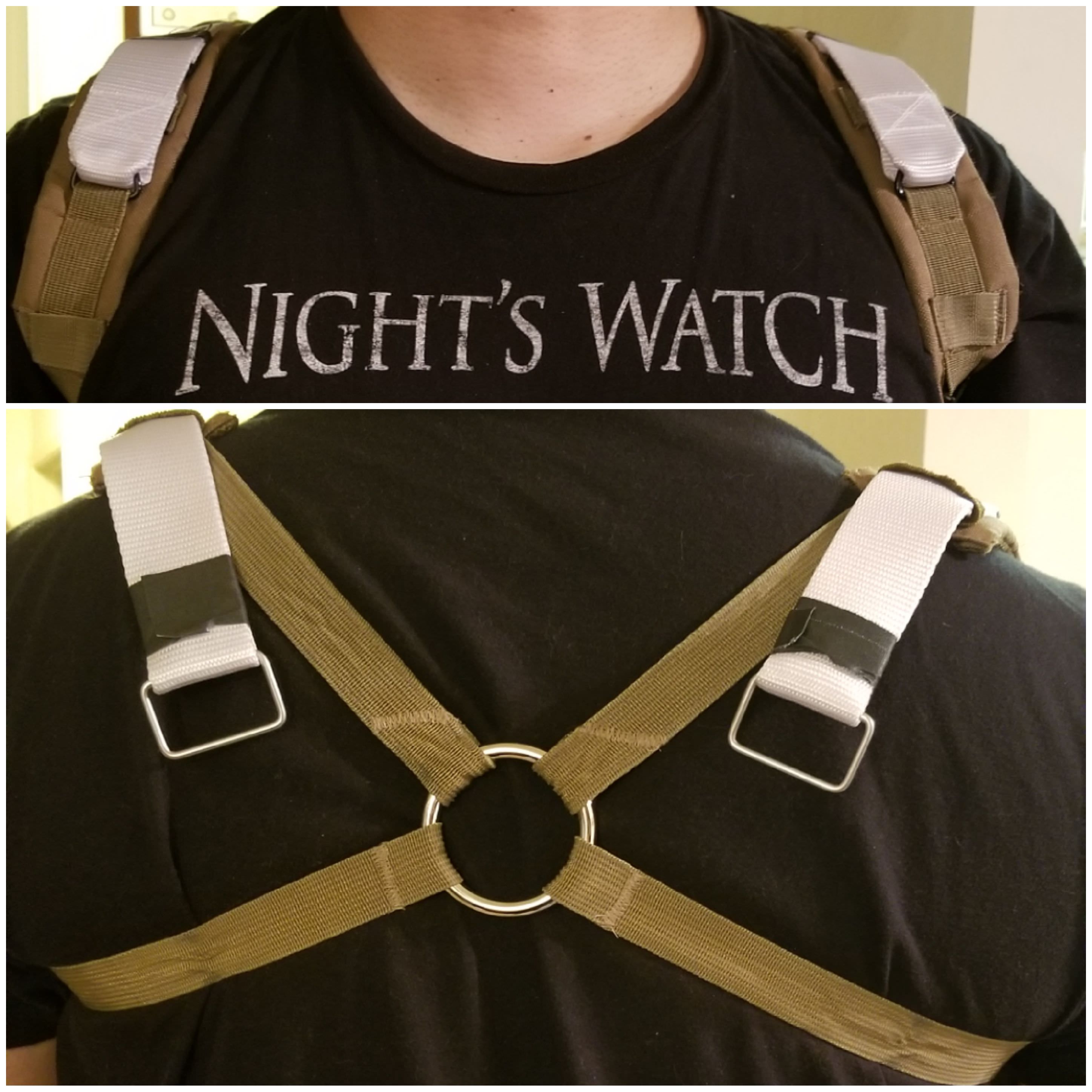

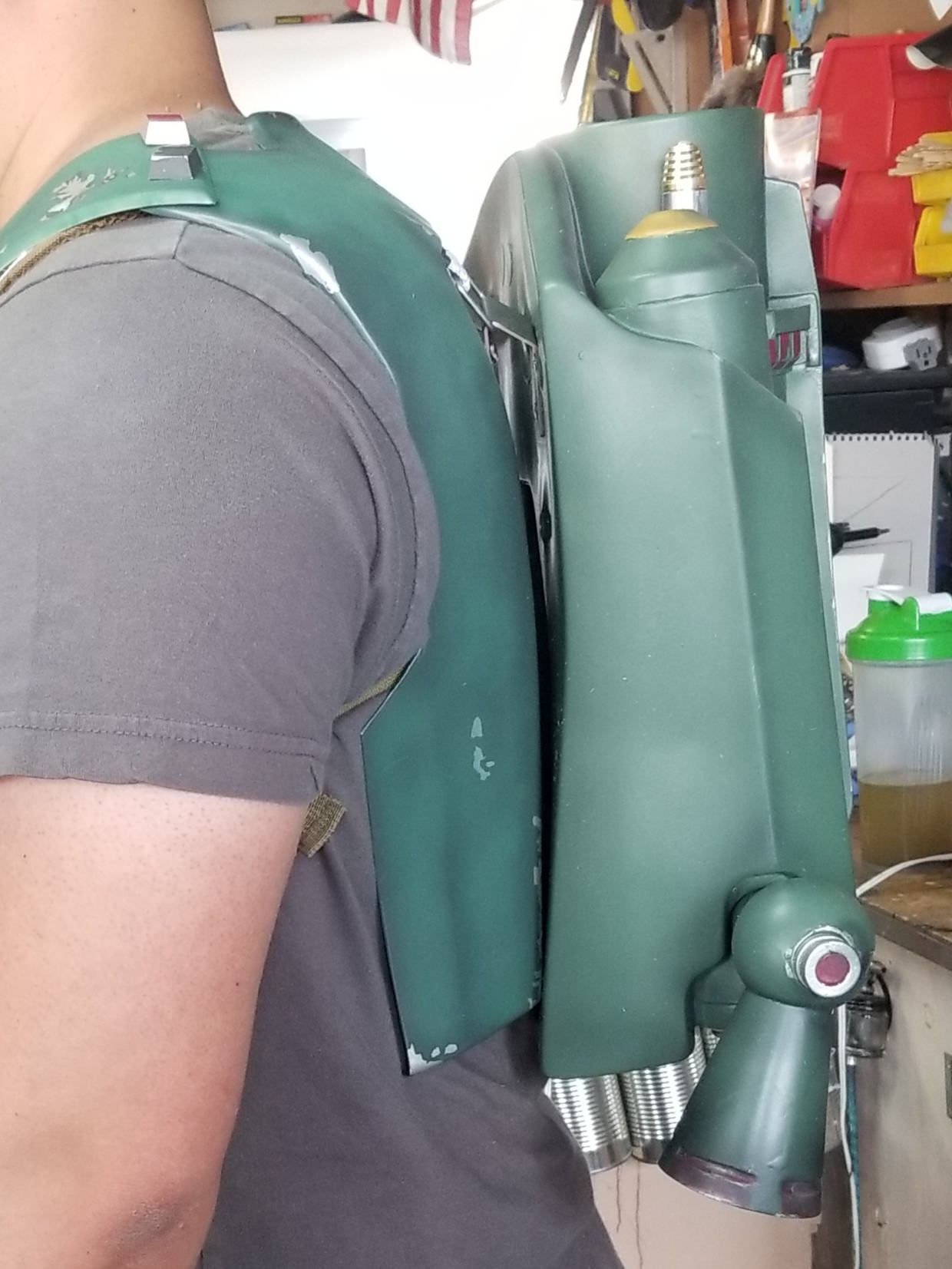

In the interest of time, I ended up fashioning an old backpack strap, metal ring, and 1.5 inch white nylon strapping to make my jet pack harness. The gaff tape is temporary until I could judge how long the straps needed to be relative to the jetpack, hooks, and backplate.
Turns out my estimation was spot on, just needed to cinch the backpack strap a bit to level the pack. I also got the vest marked for button holes for the straps to feed through. Setting the hooks on the jetpack, measuring the height to the backplate and accounting for the weight it held, was a chore. I can see how the dive harness would steady the jetpack vs. the makeshift, but it will do for now :D

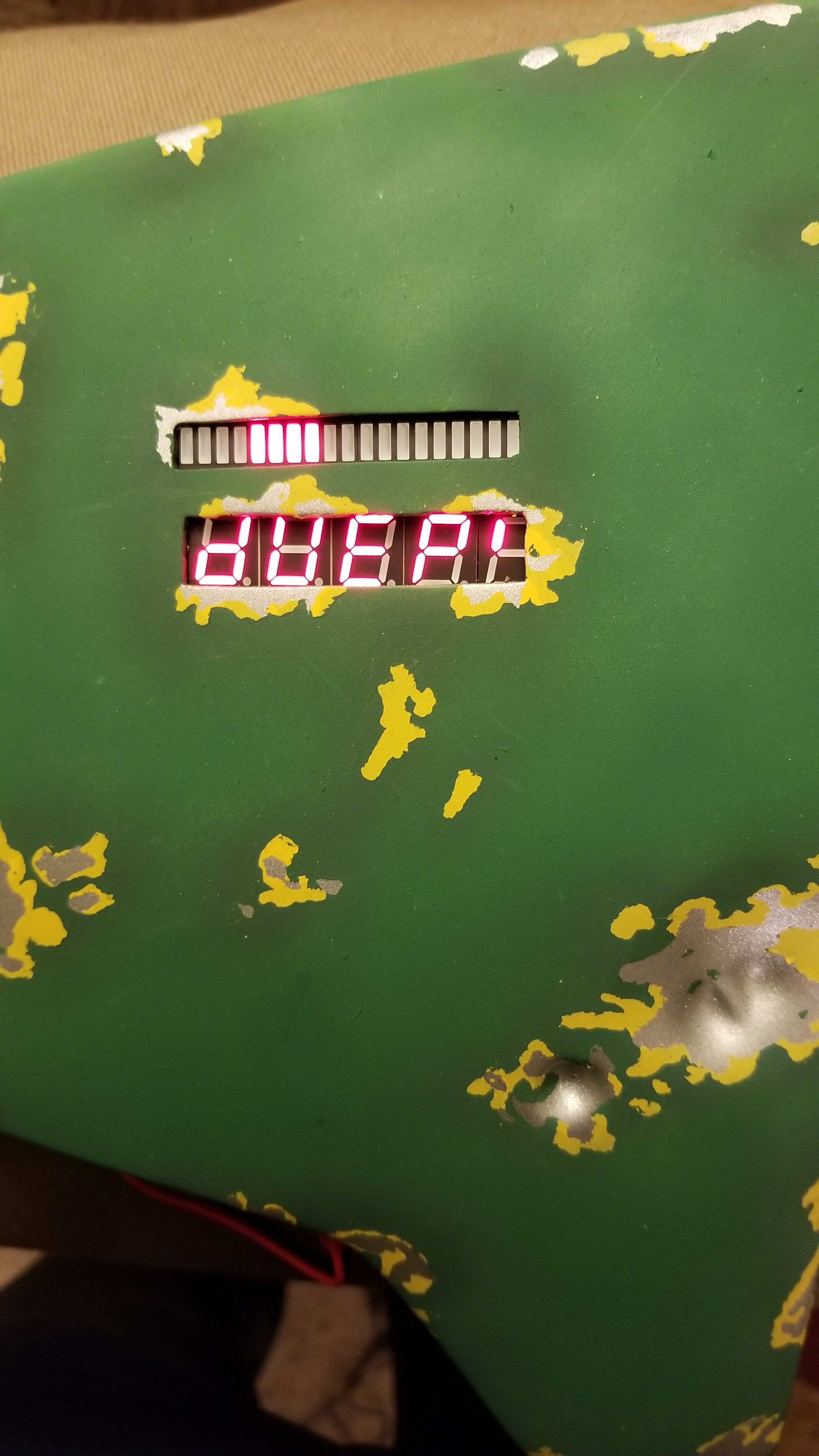

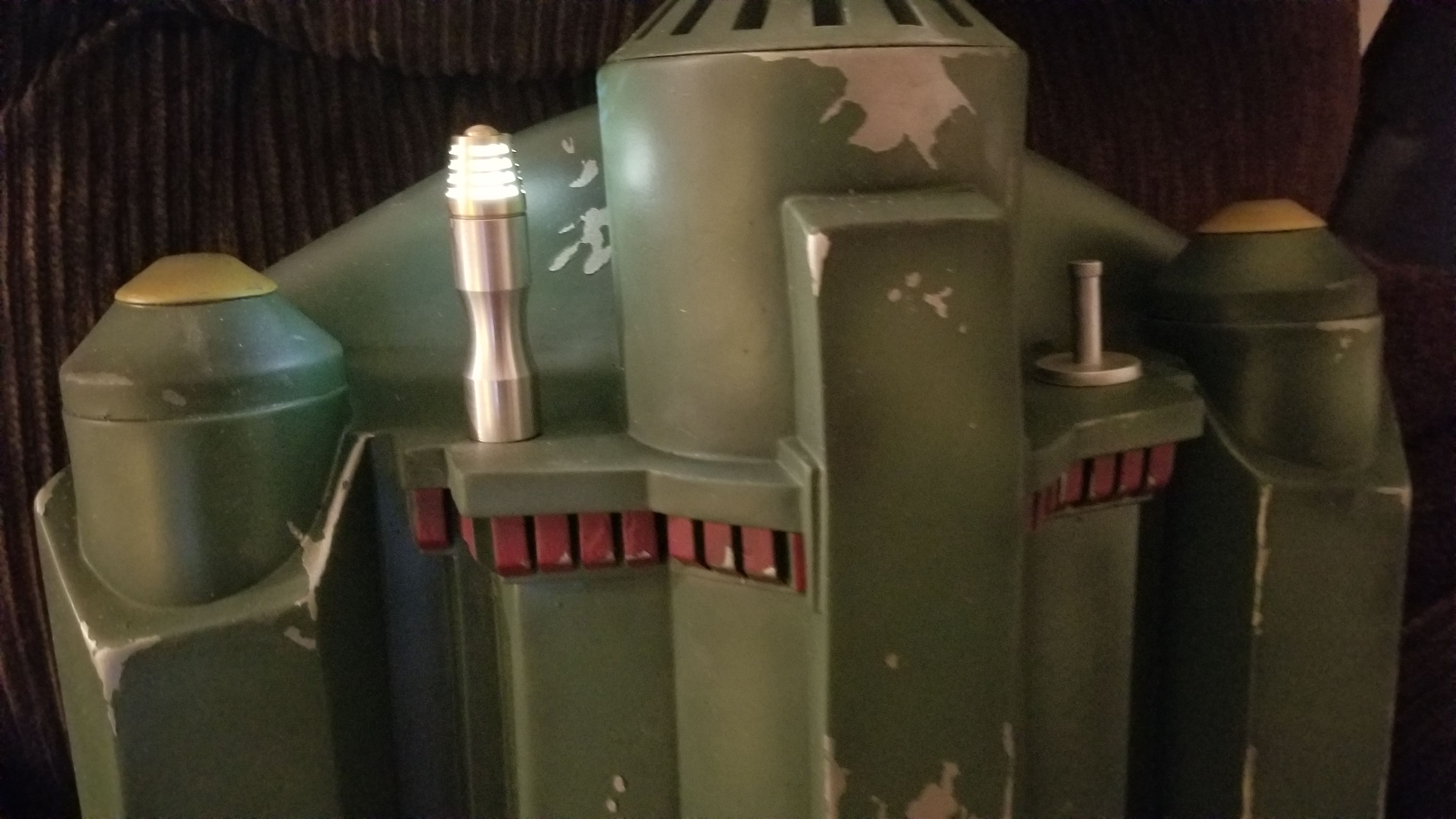

Also! Jetpack beacon by Machine Craft Replicas. I put in two white LEDs running on a 9v battery attached to the inside of the jetpack. It doesn't flash, but hey, the beacon is lit! Mandalore calls for aide.
I'm missing the white dot, a decal on the back, and I just acquired a Silver dental file that I'll paint blue, donated by Syper. Cause, I don't have that stuff laying around like he does, haha.

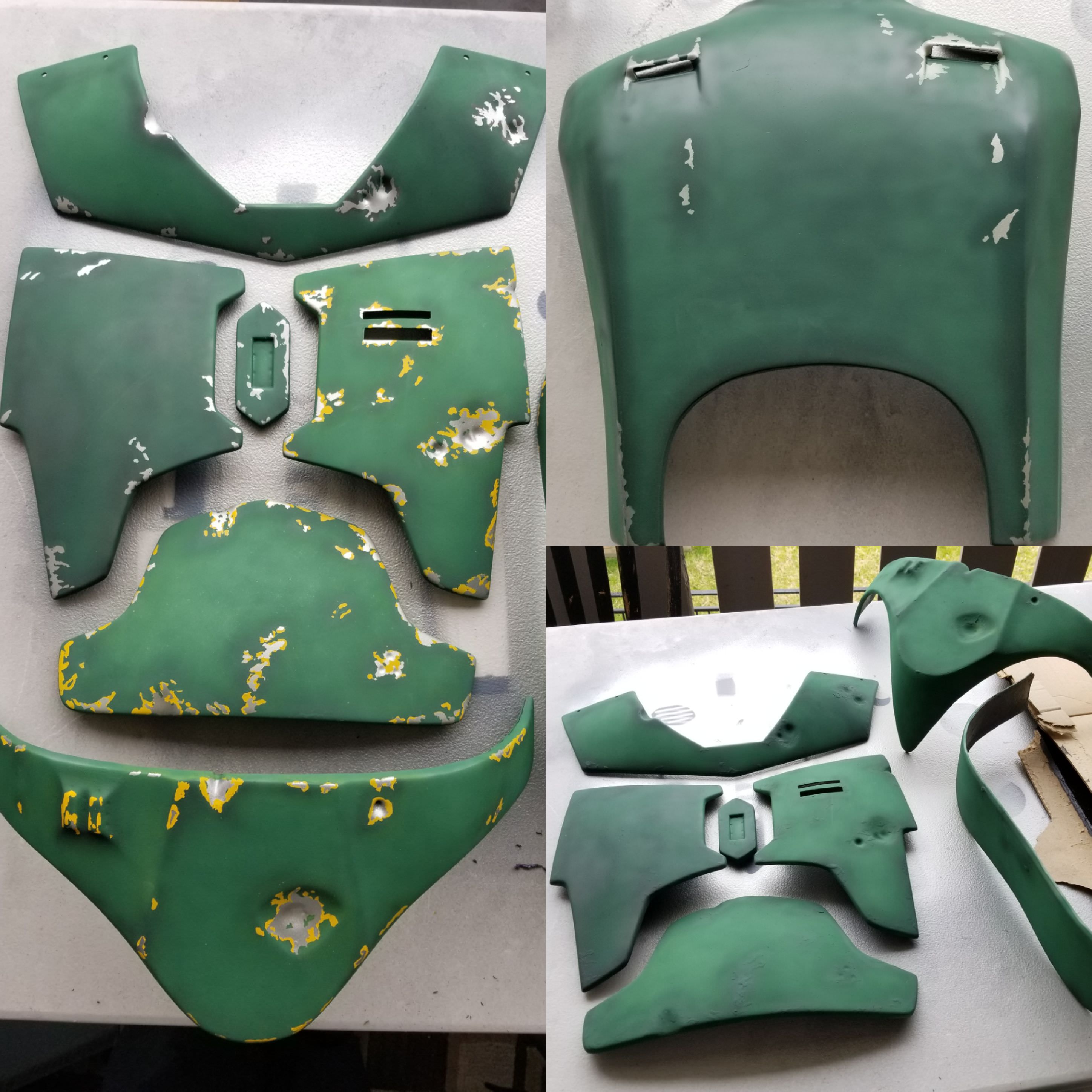

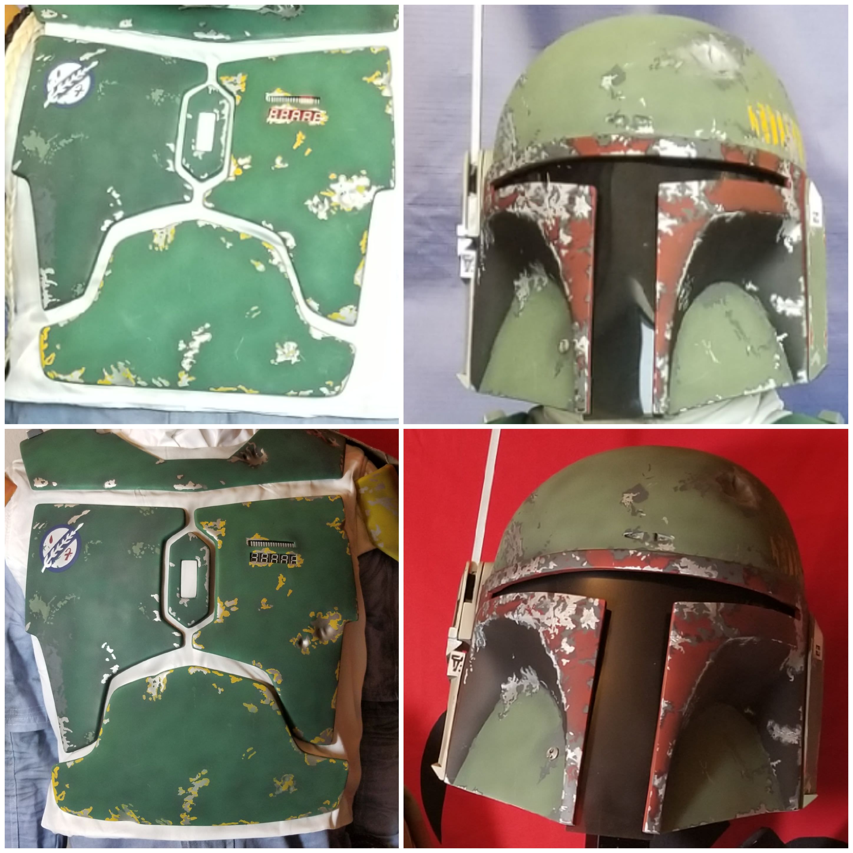

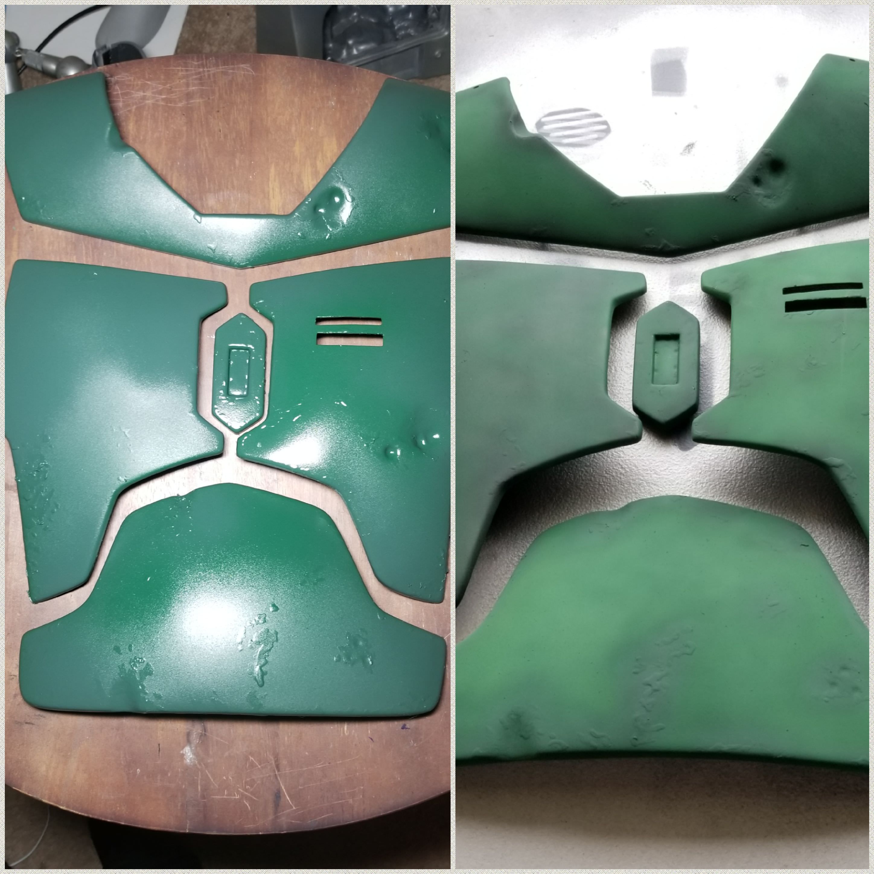

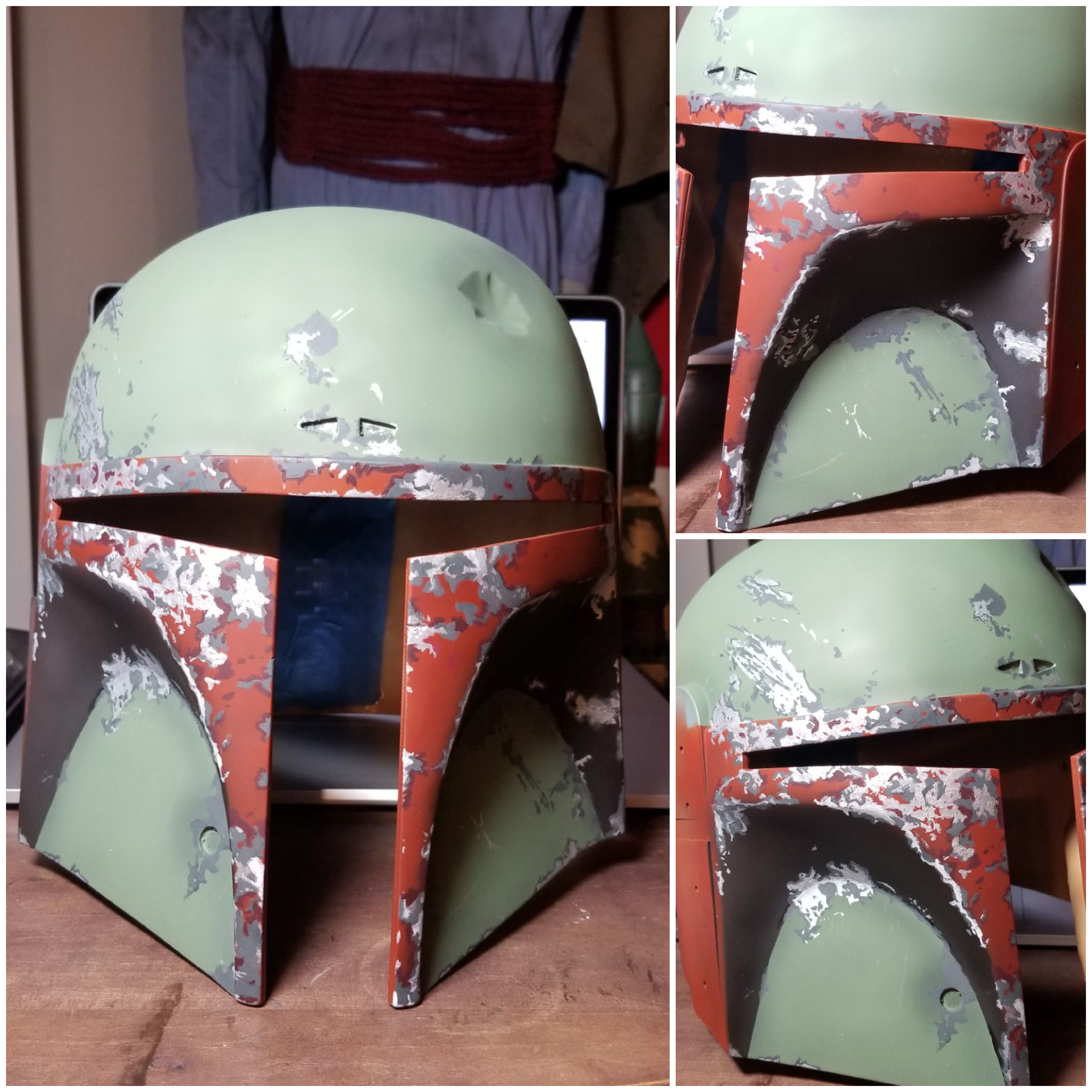

Big news! Here's my before and after paint job, Rattle Can vs Airbrush Humbrol colors.
I suppose I could have kept the darker green and airbrush the counter shade (I learned a lot about airbrushing, really fast) but decided, if I'm going to airbrush some of it, might as well do all of it. So here's the masked and painted kit, all free handed using RafalFett's stencils.
I temporarily installed the chest LEDs so I can at least admire it. Final placement for another time. Any suggestions on how to mount this to the back of the plate? I'm unsure how to approach it.

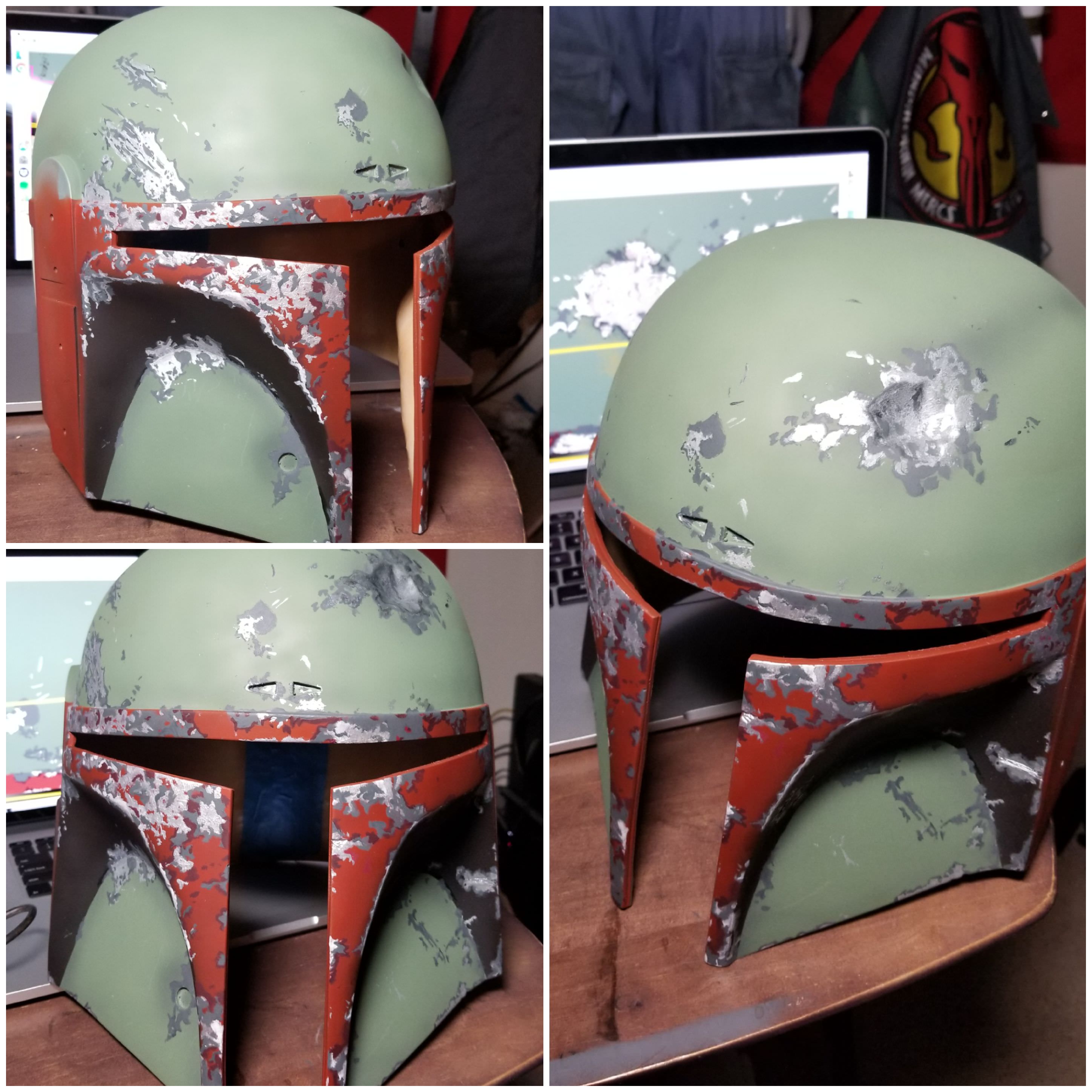

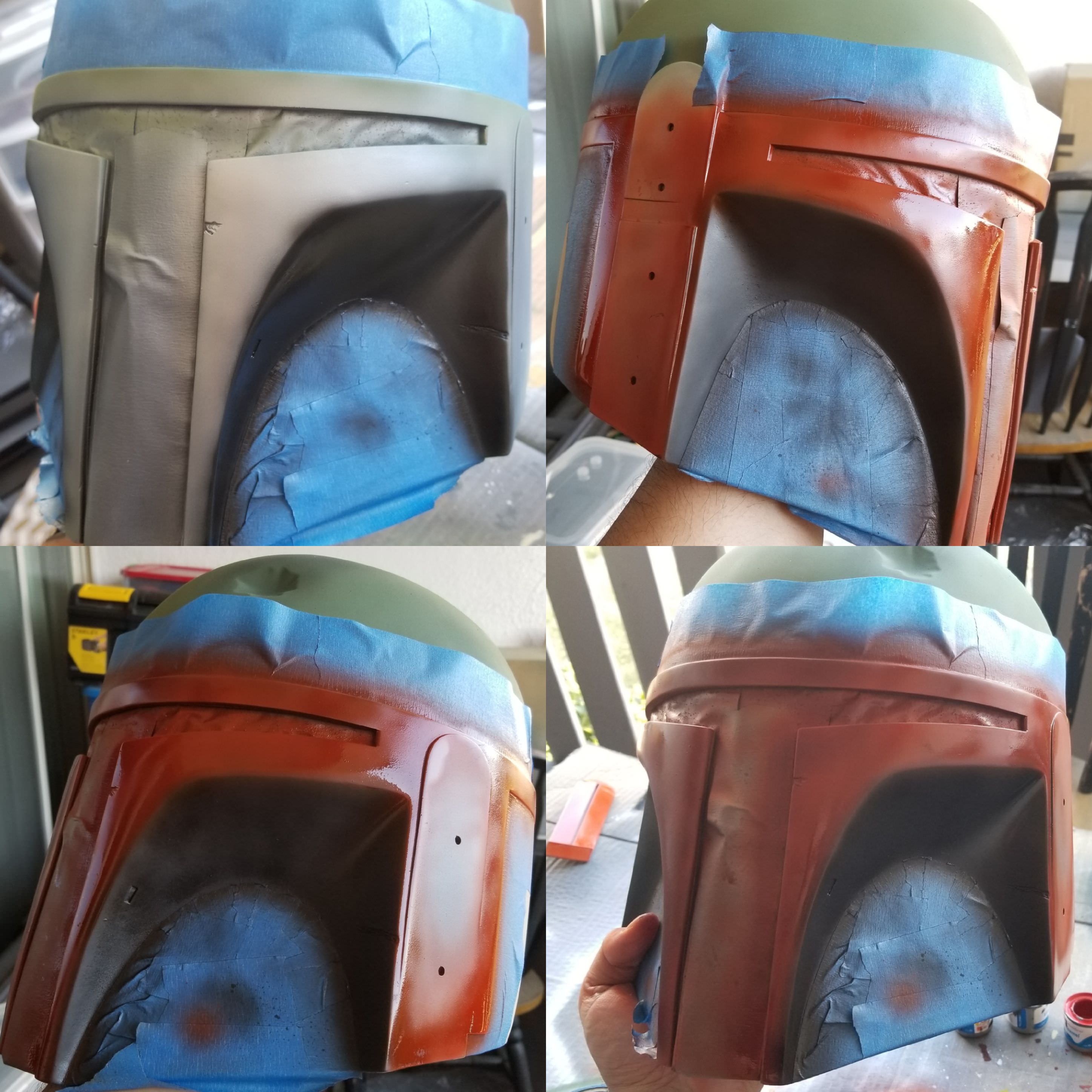

My most recent work has been on the helmet. I got it sanded, primed, laid down the base coats.
The back panel will get masked, then airbrushed the blue-green it needs, but that will be all the masking on the helmet, except the killstripes.
I finally broke down and decided to topically paint the helmet, despite my initial desires to mask. I feel the helmet has too much detail and capturing that in a mask would require a tremendous amount of work that I'm really not patient enough to do, haha. I was staring at the silver base coat ready for masking for a few days and knew I couldn't move forward until I masked the whole thing, and I found myself scrapping the mask and starting over. Ain't got time for that. So I just base coated the primary colors and will move forward with a topical application and it'll be great.

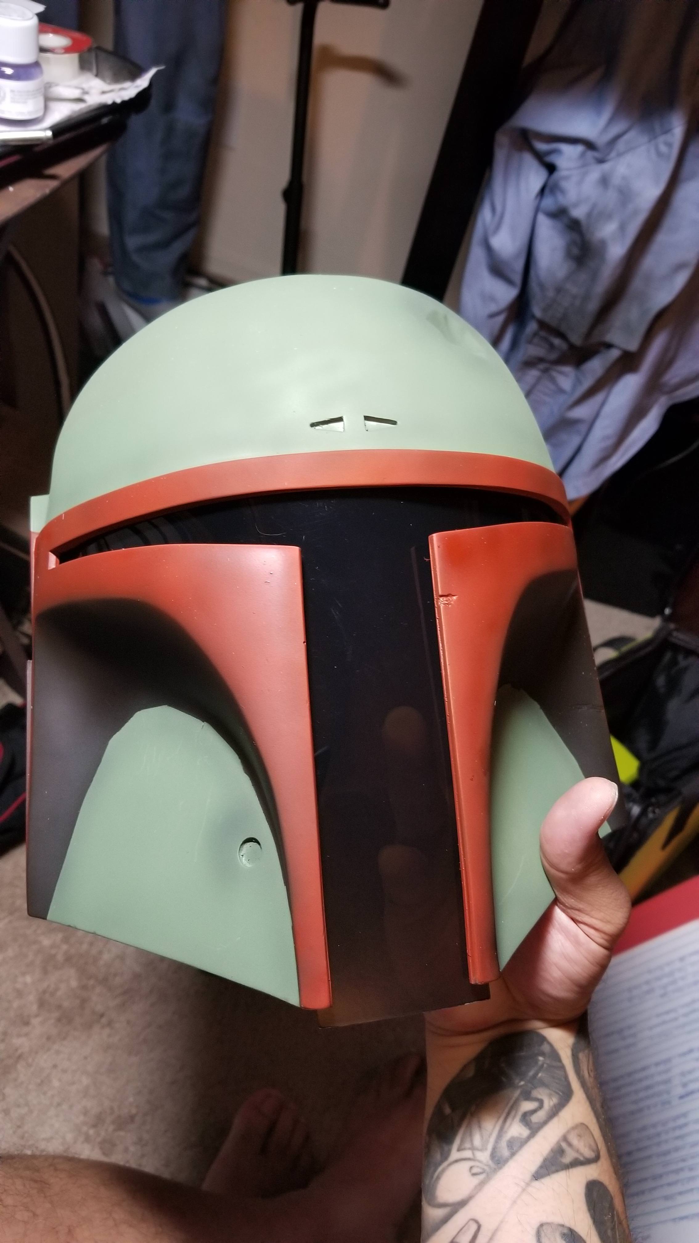

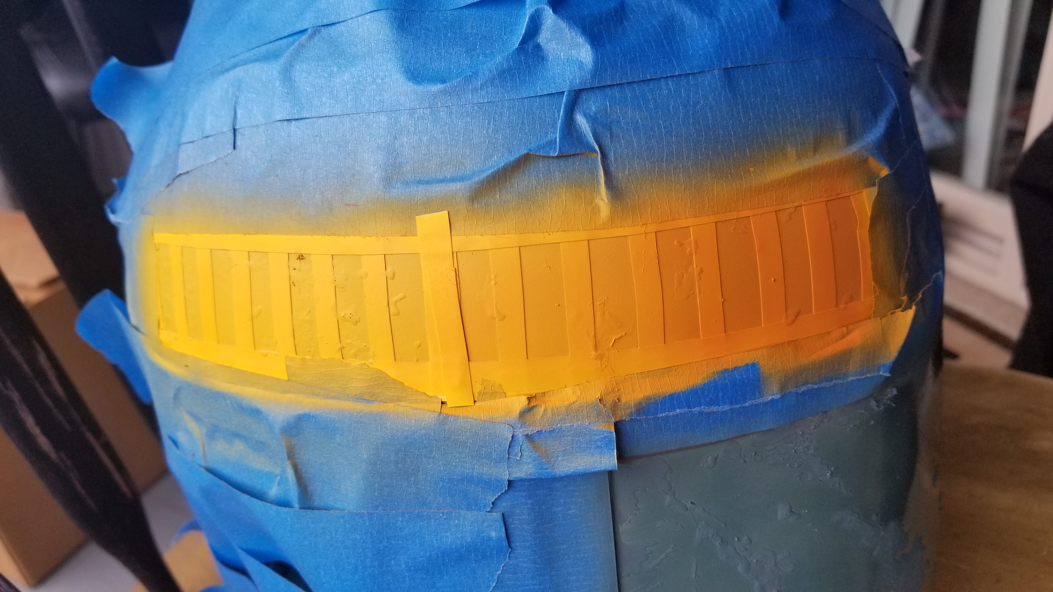

I decided to do a topical paint job. I really wanted to do the masking because i like the way the layers look. Unfortunately I don't have the patience to mask everything as I had originally planned. I kept looking at the helmet knowing I needed to mask, but couldn't find the motivation. But to pick up the airbrush and lay down base coats for topcial? I could get behind that.
I spent a good deal of this build fretting over the helmet. Dreading the day I would have to paint it. To be honest, the helmet is probably the most enjoyable and satisfying thing in the whole kit. It even required the least amount of prep compared to the armor and resin kits. And now, all I want to do is get home to paint.
I did the left cheek first, then the right, then the left half of the visor in one paint session. I'm using reference images and free handing the paint job using locations as a "landmark" where to put paint down. I think it took about 6 hours, 2 per section.
I got home after work and put down the right visor and cat scratch leading to the top of the dome. Took two hours to get that part done. I'm pretty happy with this so far.

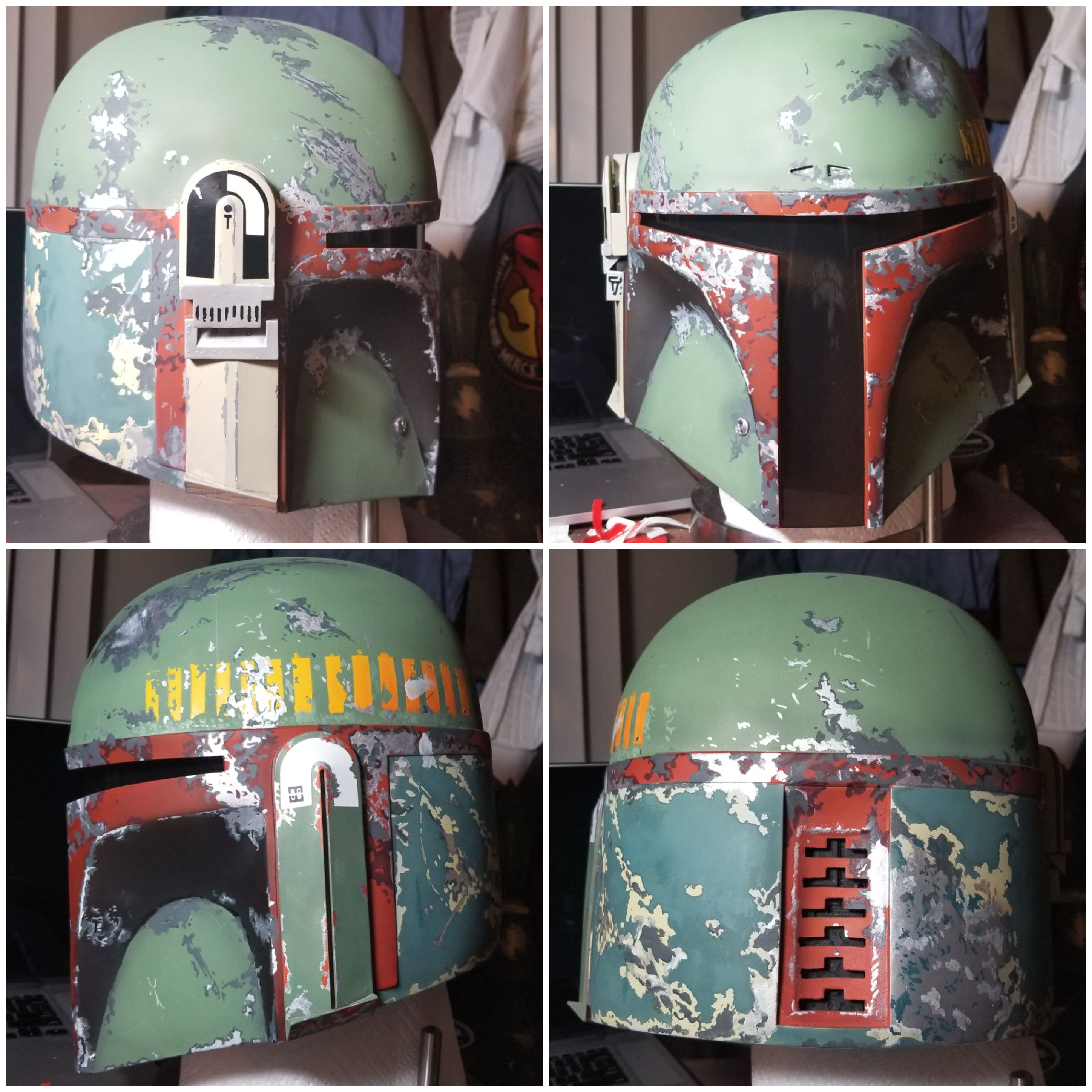

Here is my final product. I still have to sort out washing the helmet or matte coating the helmet to pull all the colors together. The original colors are very vibrant and will take it for a test run as is before deciding the next step.
This is my first helmet, definitely not the last. After reading about painting level of detail, I think this is somewhere past 'costume', but a ways off from 'archival' o_O

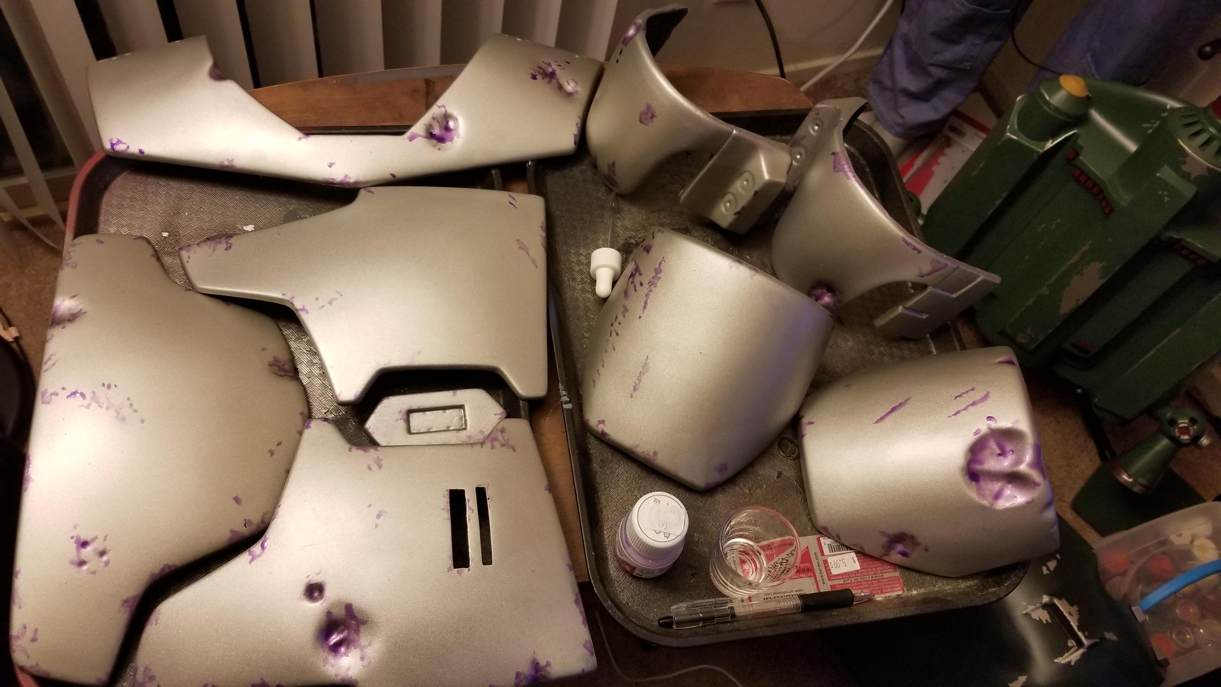

First update was to subdue the colors by airbrushing a black shade (Citadel's Nuln Oil). No thinners, just right out of the bottle to the airbrush. It acts as the black wash, allowed for light shading, and after a few coats it cleaned up surface scratches, muted the colors, and helped blend the battle damage and topical paint job.
Top two are from the con, bottom two are subdued after the shading:

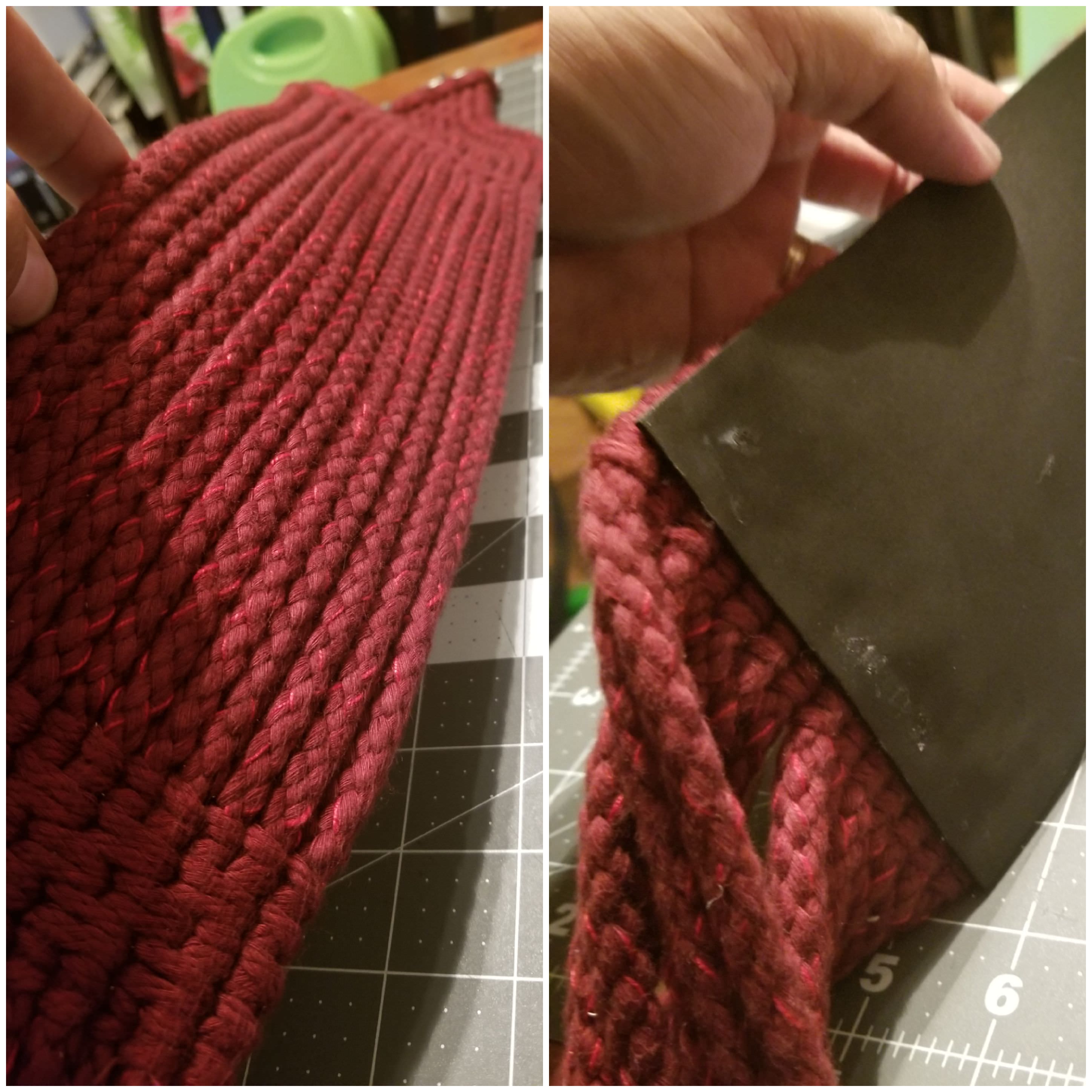

To solve the rope belt dilemma of loose strands, it was suggested to glue down the strands to Craft Foam, a .99cent sheet from Michaels Crafts store. I'll be picking up some new nylon strapping to help with my XL body type. I used Gorilla Glue Gel to bind the foam and the rope. Fun fact: the gorilla glue chemical mix caused the foam and rope to smoke when bound together. It fused together forming a rather solid bond. I'm sure hot glue would have been fine.
Anyway. That was my first stroll and everything stayed on despite a few costuming hiccups. Next con is San Francisico Comic Con in June! I'll be making a few more updates and changes to the suit and hopefully take it for Round Two. Doubtful, but hoping to get the weapons before then - I'm on the unofficial wait list for Sidewinders' resin EE-3 and sidearm kit with no timeline established yet.
More to come.
A rather less intrusive way of keeping the girth strands under control is by simply using duct tape on the back to hold the strands together. Worked like a charm for me.
Stuff a little foam into those pockets too! Congrats on the first suit up!
Two valid points. I first considered a cloth type gaff tape but didn't have it on hand. And yes! I need to get some pluck foam. I could probably raid my wargaming stuff... :lol:
I got some pick n pluck foam donated to me from work from an old pelican case for camera equipment. I am thankful too, as that stuff is not cheap to buy new!

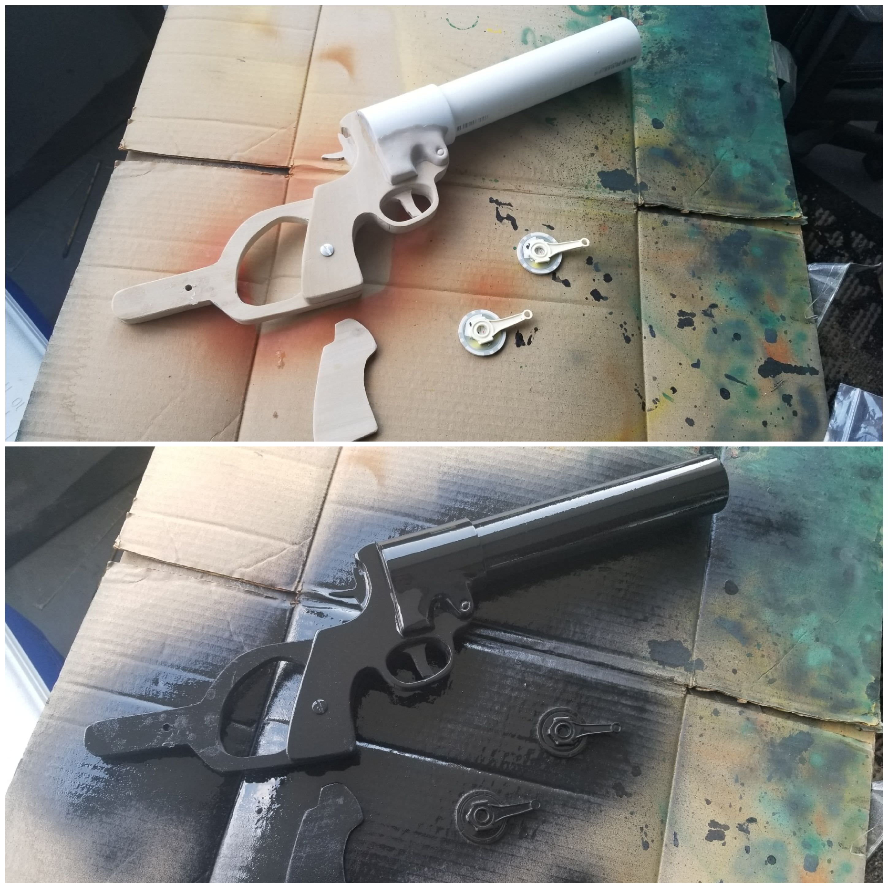

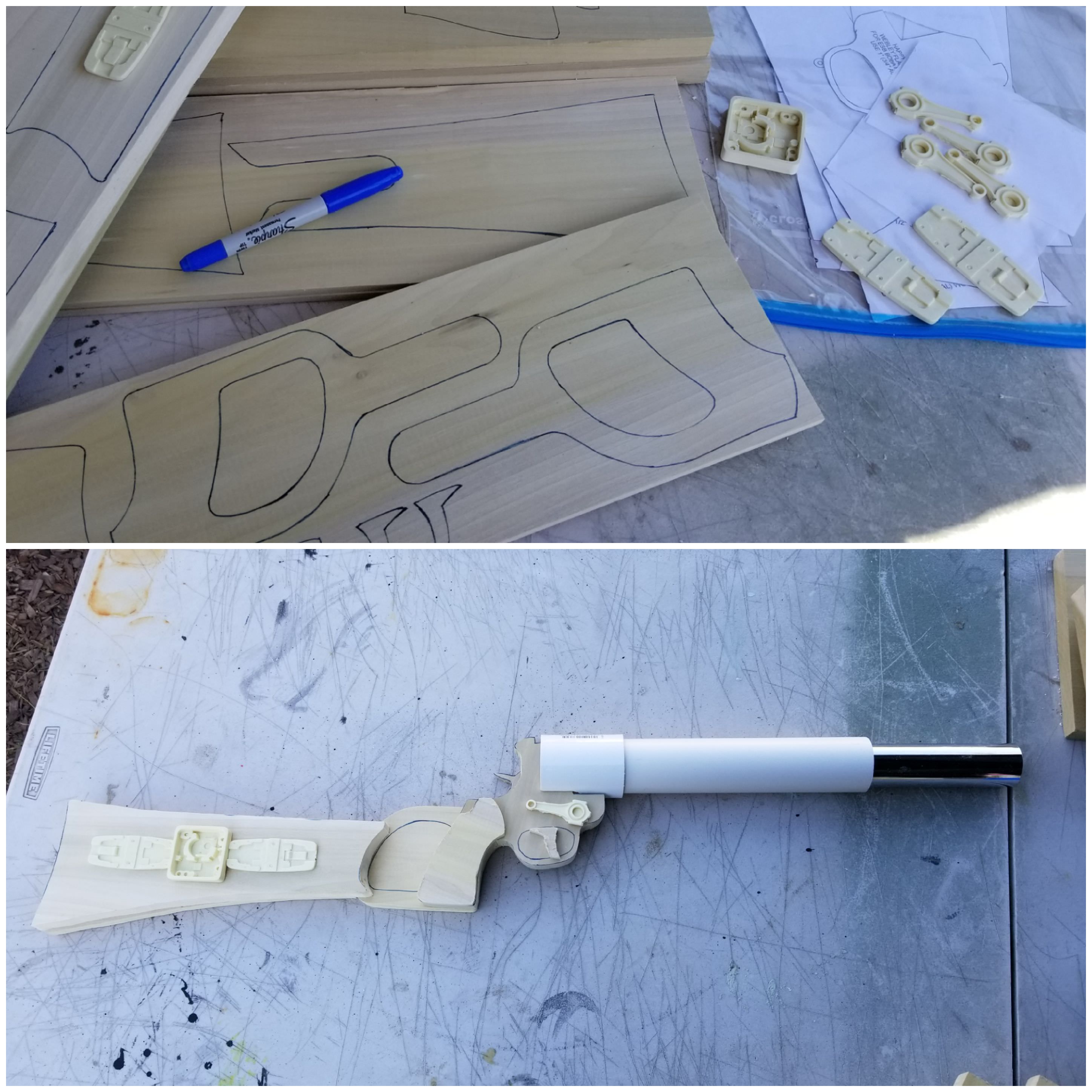

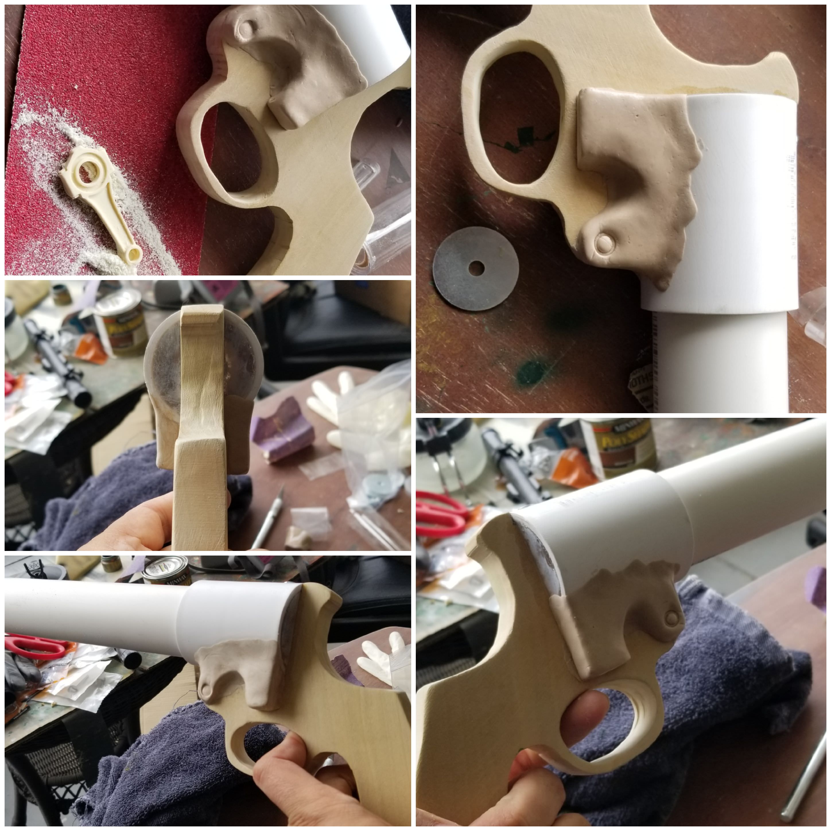

I'm naturally impatient and wanted to get an EE-3 in time for May 4th, so I used the HappyTrooper.com EE-3 tutorial. Seeing as this is a scratch build, my goal isn't screen accuracy, rather silhouette accuracy. I will, however, keep an eye out for upgrades but will see how this holds me over. Might even get approved.
Basic shapes and rough fit:
Wood epoxy shaped on the barrel, sanded down:
First coats of black primer!

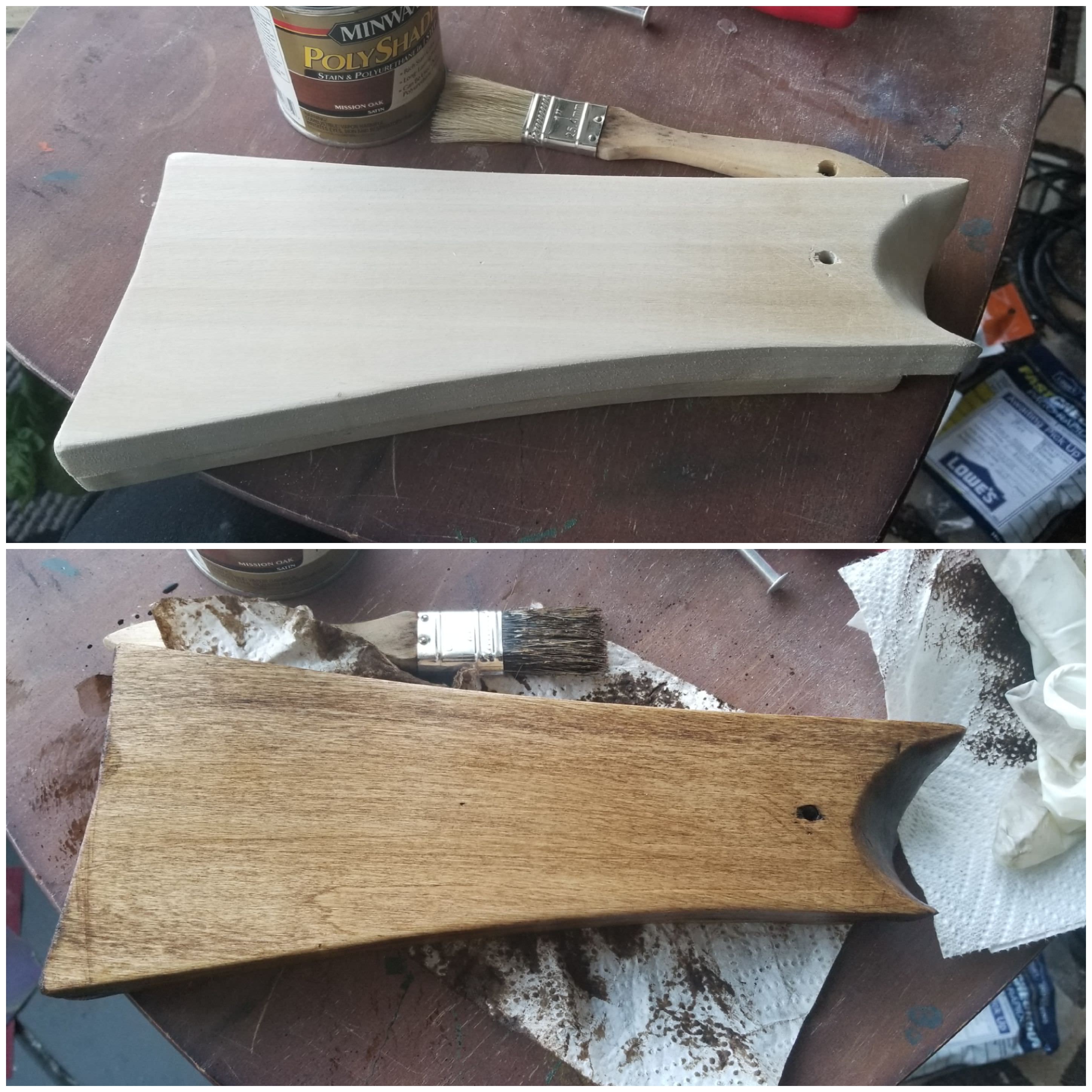

And a stain for the rifle stock:
Getting there.
