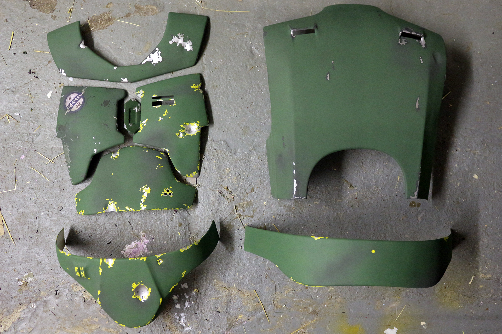

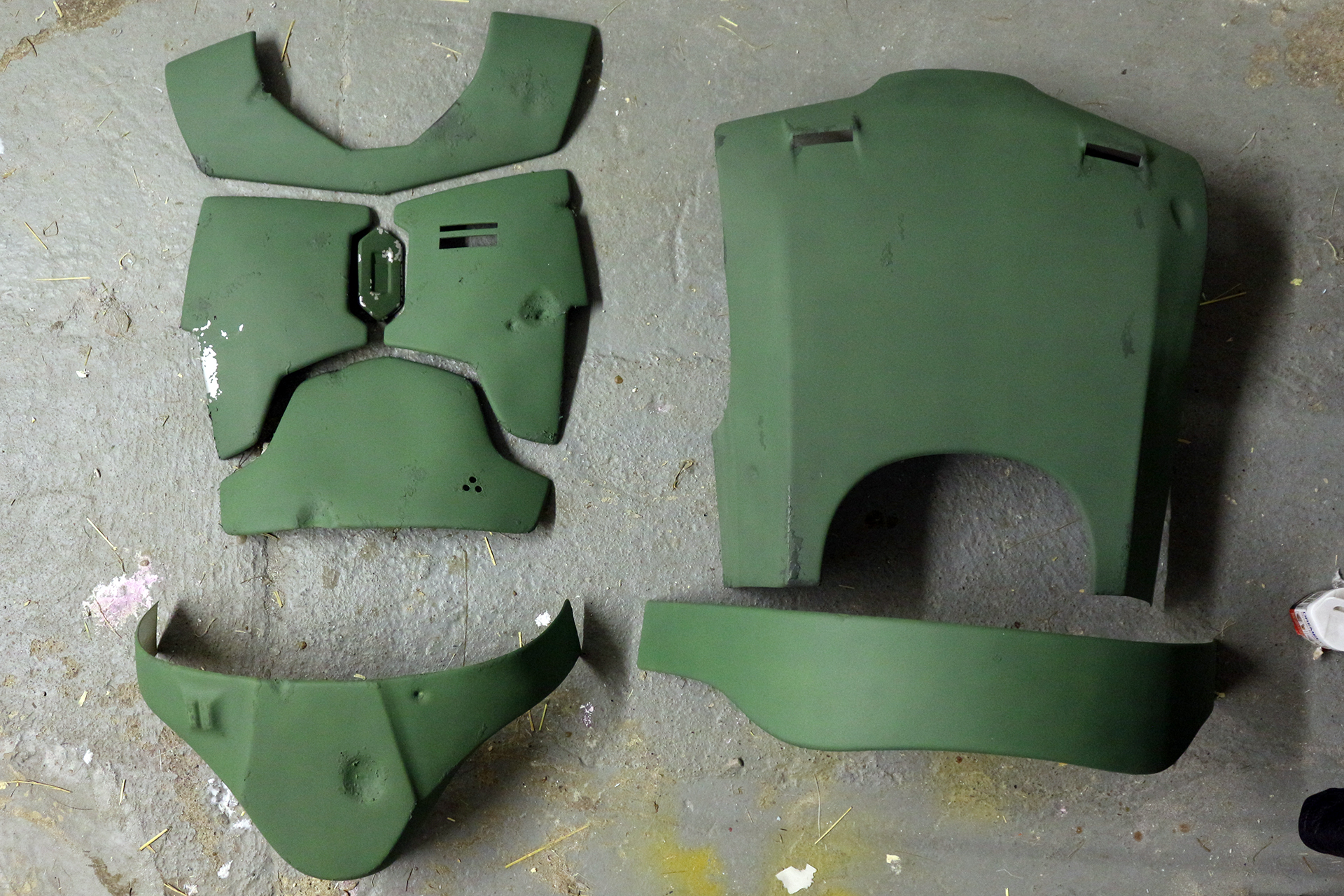

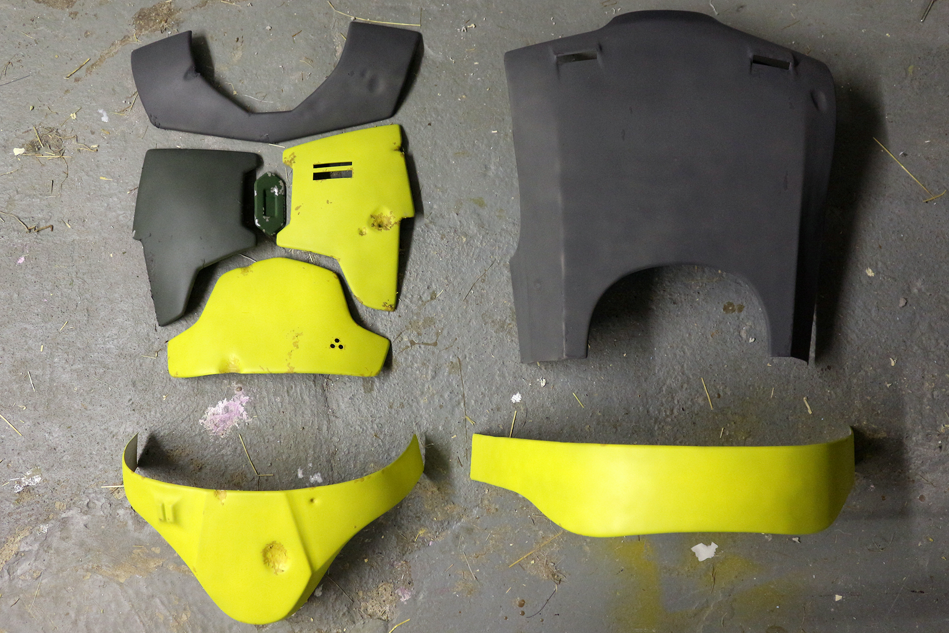

I've finished the second pass of paint on the armour. I ended up mixing 76 and 117 together and adding a touch of black for the centre diamond.
Now I just need to mask everything up one more time and hit it with the green.

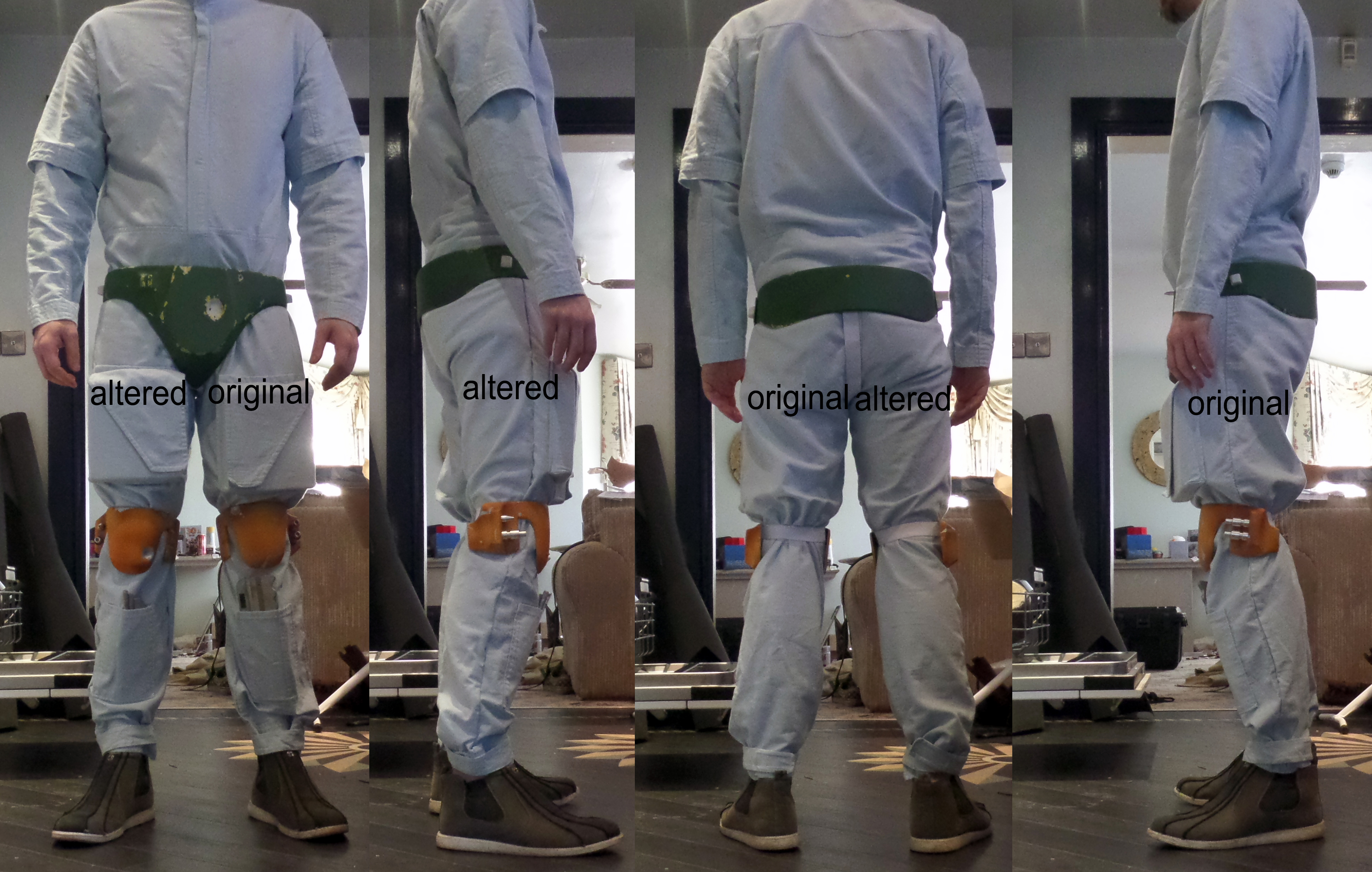

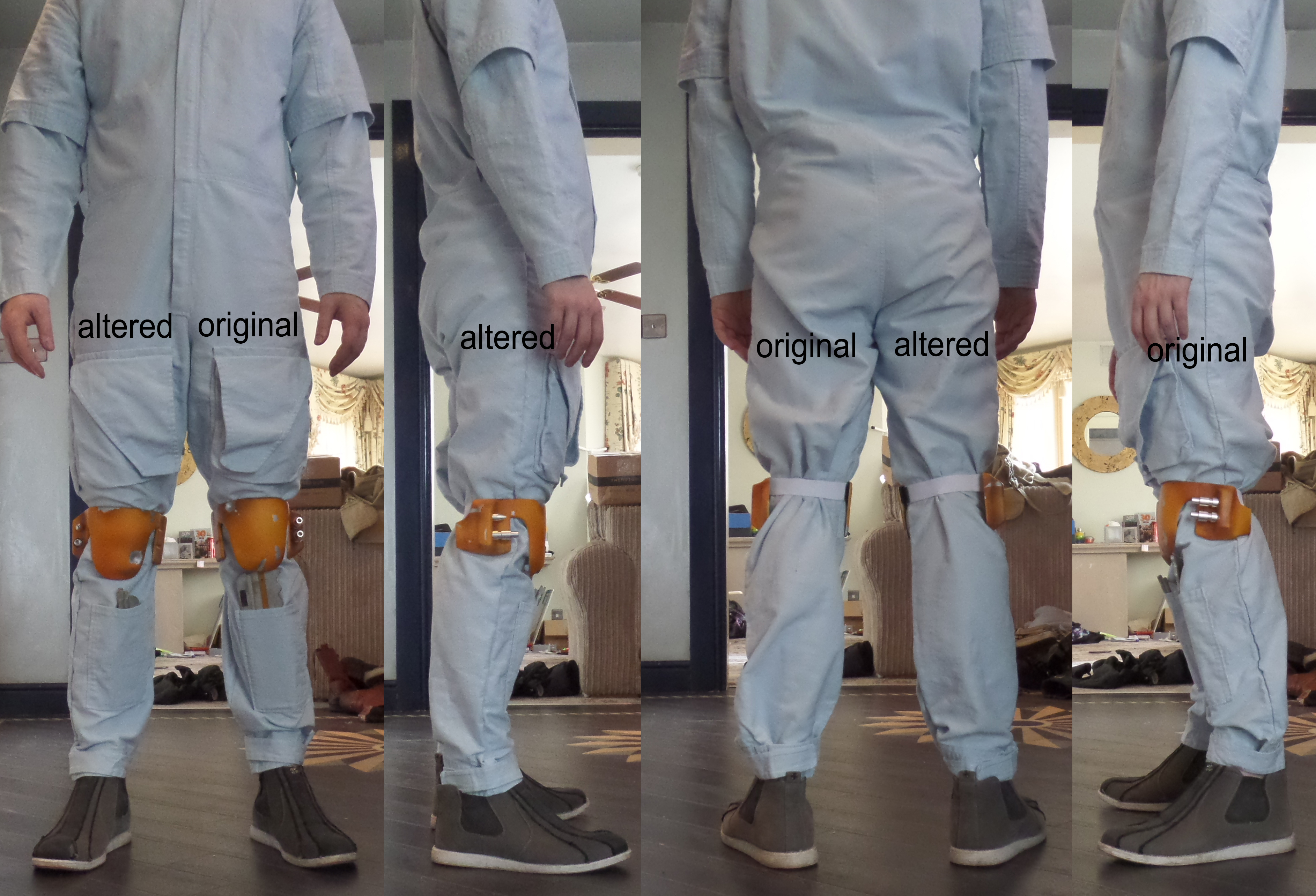

I started thinking about tailoring the flightsuit, currently the legs. Like with my first version of the costume, I'm concerned I don't have an objective eye for the fitting since the fit looks totally different in pictures to what it feels like and what it looks like when I look down. I've pinned one leg so far, taking in an inch from the waist and tapering that to 1/2" for the legs from both the outside leg and inside leg (in order to keep the seams straight). Here's a picture, wearing my old boots:
Which looks more accurate? Before or after? I always struggle at this bit. :/
Altered looks better. Are you gonna bring the arms in some too? Glad to see when people take the time to get the flight suit fit correct. It's a make or break element to the whole costume.
Try wearing the cod piece and kidney plate , they weirdly have an effect on the way the flight suit fits. Also put some foam in the leg pouches . This will give you an idea if they are positioned correctly on the front of the leg .
I'll take another photo once I've got the codpiece and kidney ready. I have padded the pockets since taking those photos. I used some EVA foam and shaped out space for a small container to store spare batteries in one pocket and a mini repair kit in the other. I've kept working on the armour. I laid down the green, a mix of 78 and 76 and went back over it with the grey weathering before peeling off the masking fluid and sticking down the decal I got from Bobamaker.

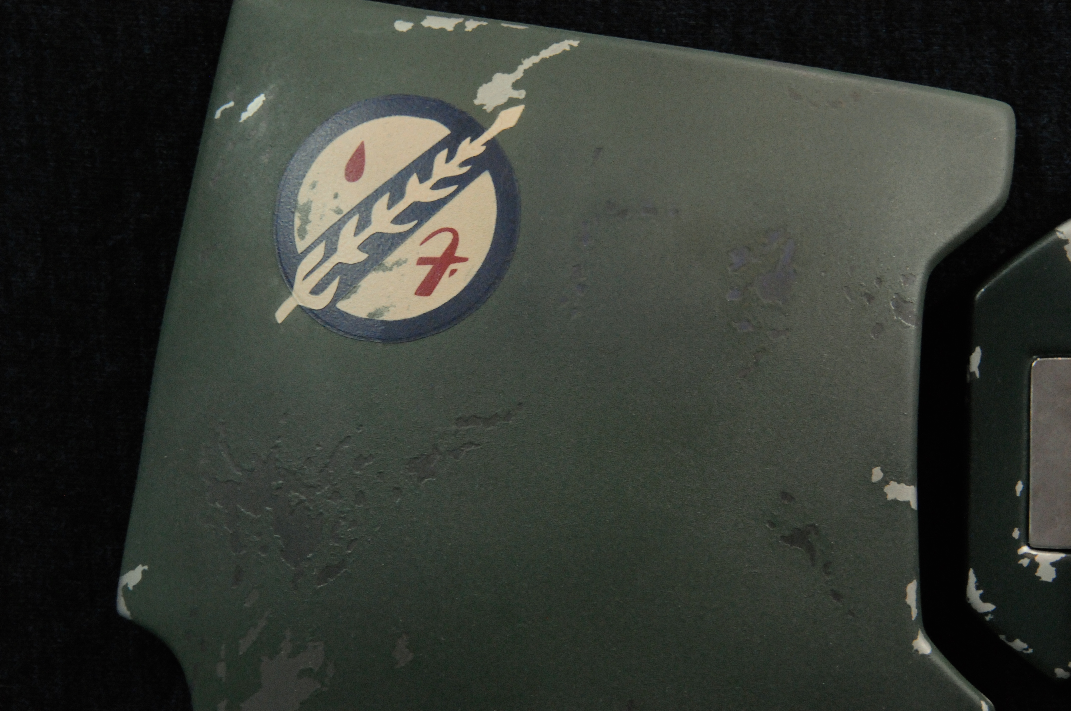

Thinking I might use some inks to mottle the green a little more before I clear coat everything.
Hi Jesuit....I think that you're at a perfect stage in the paint up to as you say "mottle" the surface of your good looking paint.
My suggestion is to mix a very sightly darker and lighter value of your base greens and grays, thin them and dab with a small piece
of sponge ,say one inch or less, or use any uneven surface material for a older and used surface look.
It will get you away from a sprayed only look which it sounds like your shooting for. If you get a little too much paint down use a small piece of wadded
paper towel to pick it up...just add and subtract, let it dry, back and forth etc. Patience pays off at this stage.
We all can interpret things like color,detail,etc. differently so here are a couple of pics. of how this technique looks on our armor.
The only difference is that I applied it as I did each layer of paint and not completely at the end. As you see I like a more layered build up to
the look to the color. It's still a very small build up.
This is the fun stuff when you really make it your own.

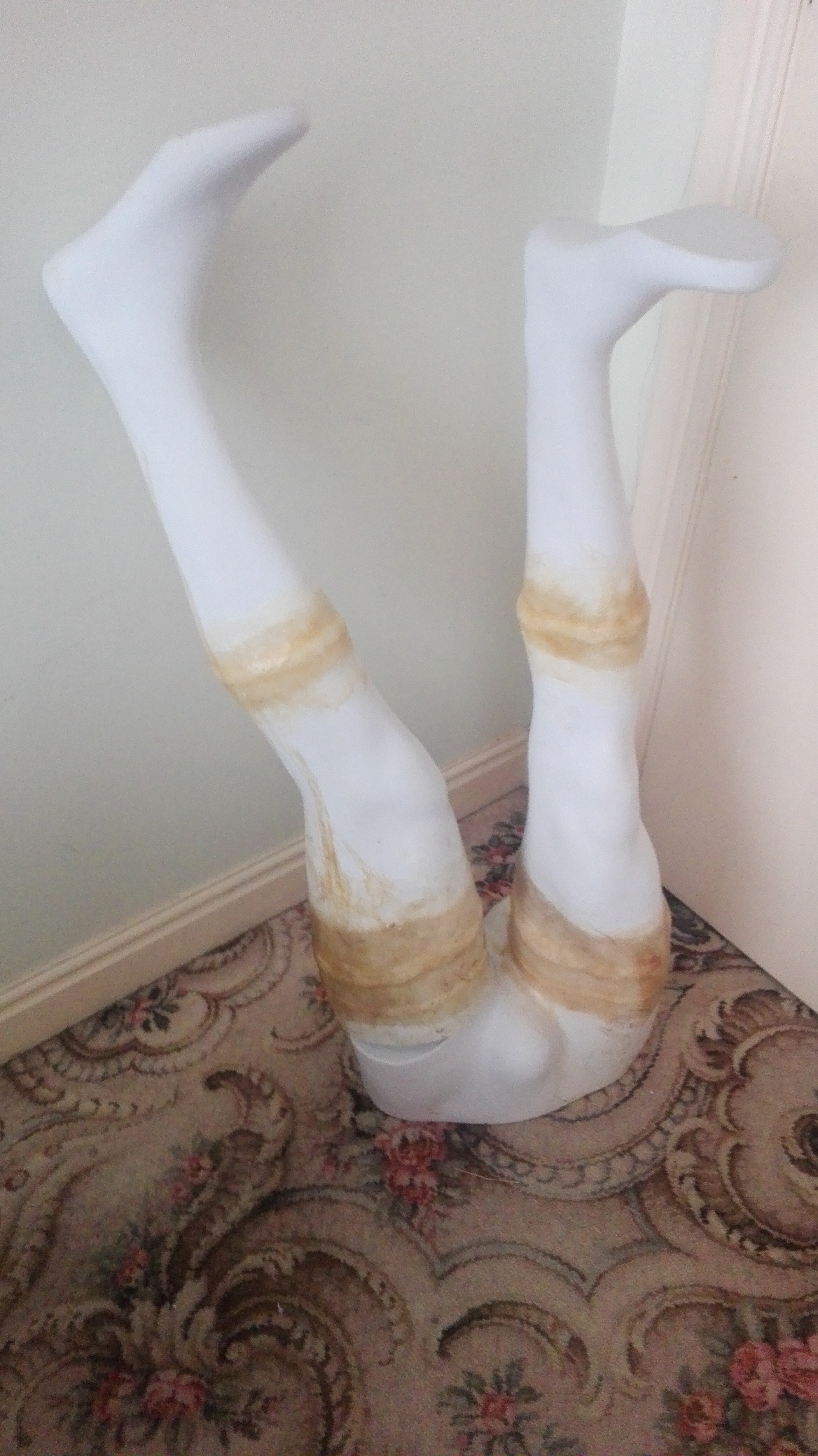

I also got a better mannequin with poseable arms. This will make my life a lot easier when it comes to the fiddly bits I can't do without constantly taking things off. I had to cut his legs off to shorten him to my height, which was a bit grim, but with fiberglass and milliput, he's just as strong as he was before.

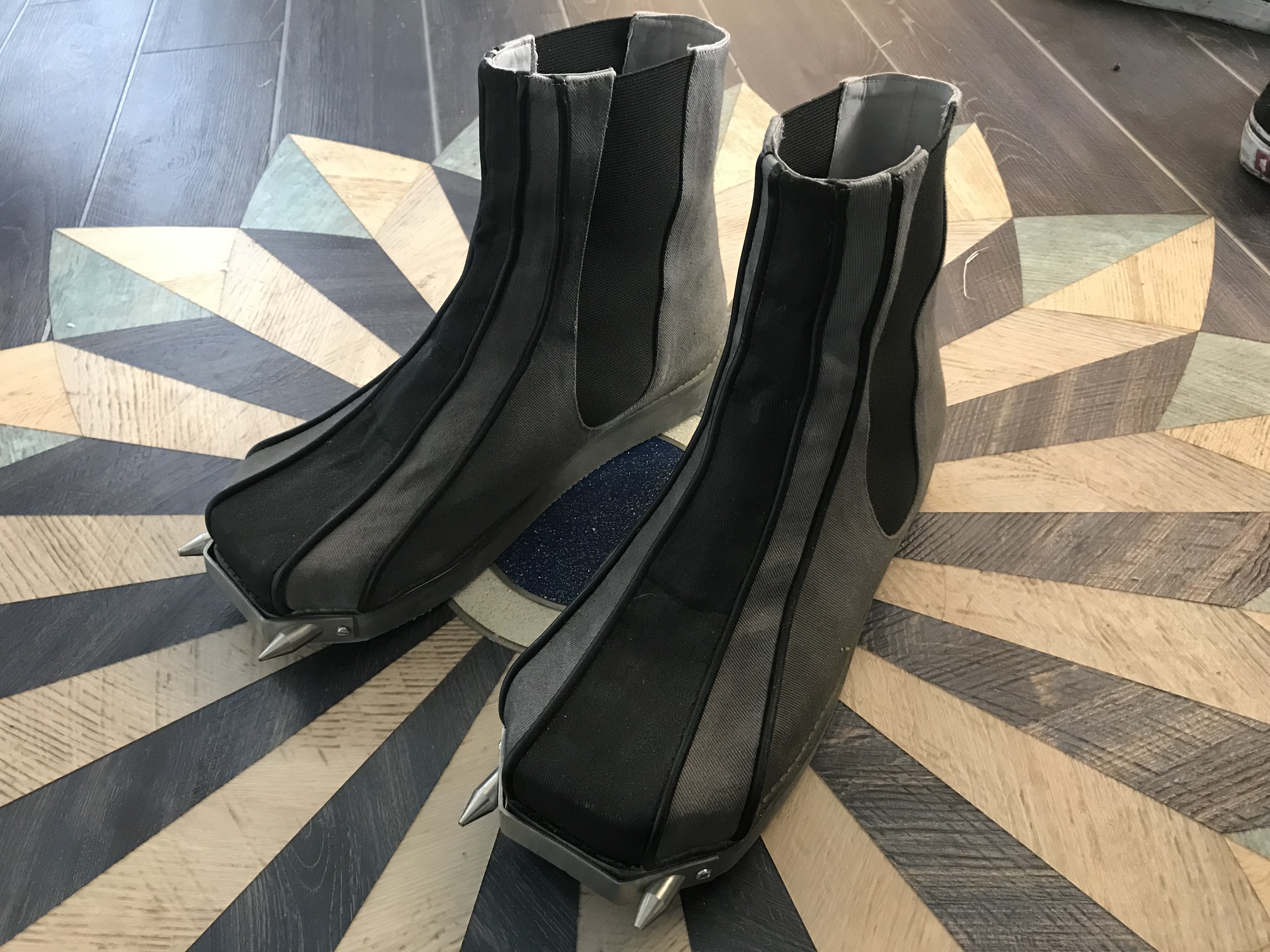

Boots also came in from RSProps, which I believe are Imperial Boots which have been bought for this side of the pond. They're a bit big, but fit snug with lifts which I was planning on wearing anyway. I think I'd have preferred them unweathered (RSProps does the weathering) just so I could have gone a bit easier on the the white sole weathering. I'm still going to need to take the weathering darker since the ESB boots are grubby, but the rubber weathering may be a little too dark.

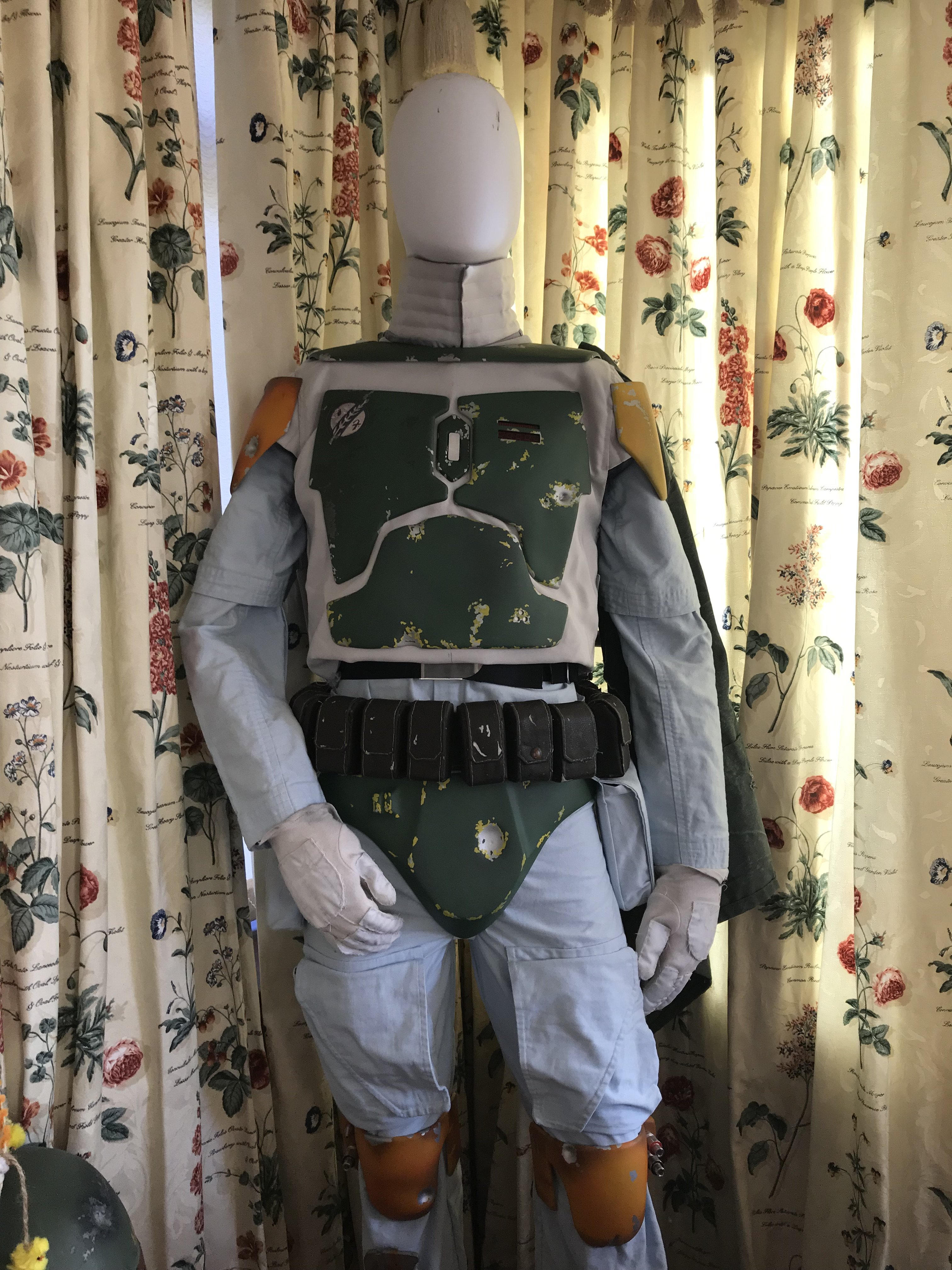

I've also since corrected the armour placement, straightening out the breast plates, which has let me sew the vest button holes in the back for the hooks and bar. I made the bar holes longer than needed to allow for any pull from the jetpack. Still need to hem the bottom of the vest, but I've folded it over to where I'm happy for the photo (I've also included a few of my older SE costume pieces on the mannequin for the sake of seeing how it looks).
So now I guess I sit and wait for my jetpack and ammo belt to come.

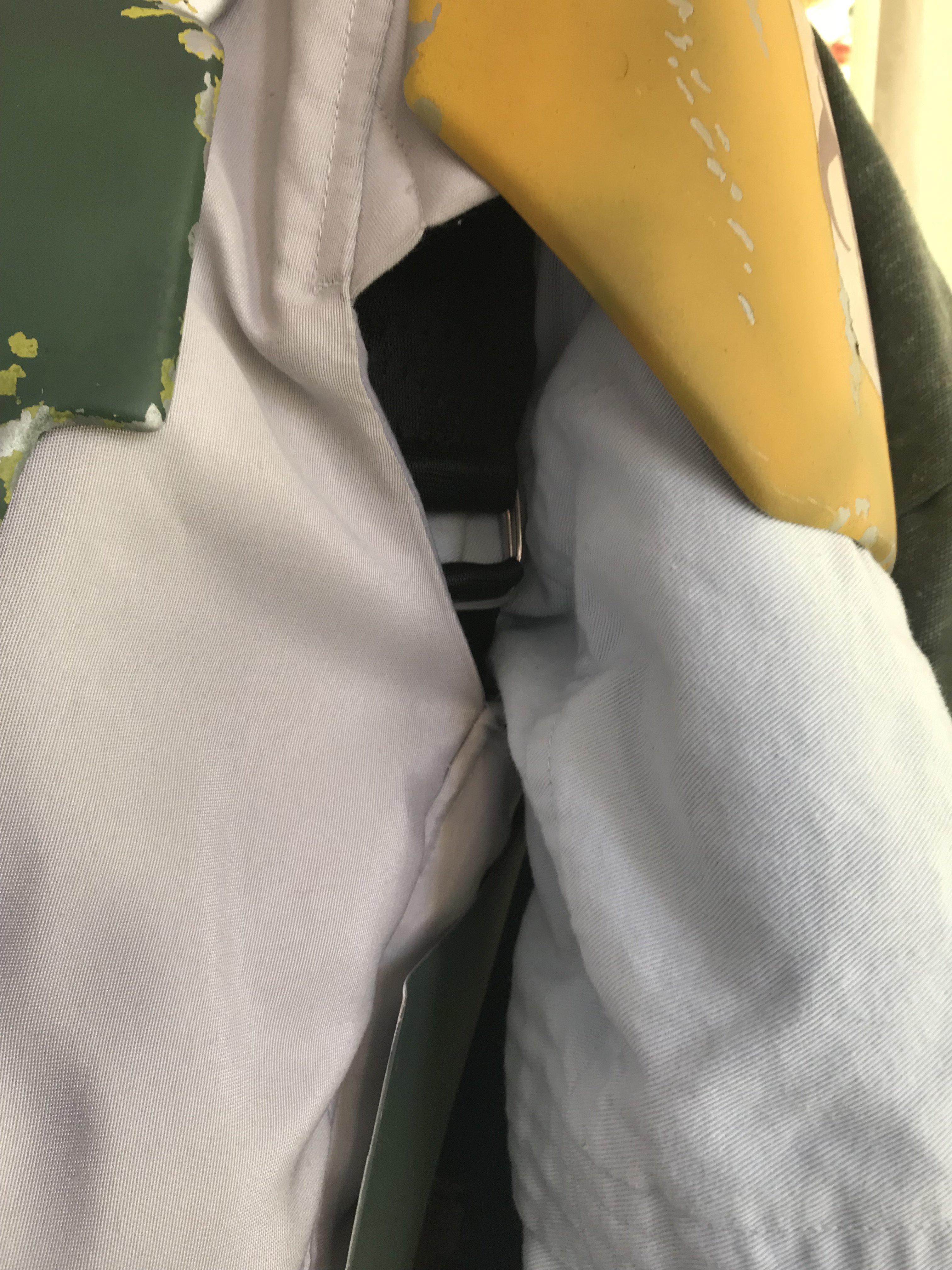

I have one question though. I know seeing the harness waist strap is acceptable, but what about the shoulder straps? You can see them through the arm holes of the vest and it's something I've never seen on anyone else's costume. I'm not sure what the solution would be to hiding them aside from maybe wrapping them in flight suit coloured fabric.

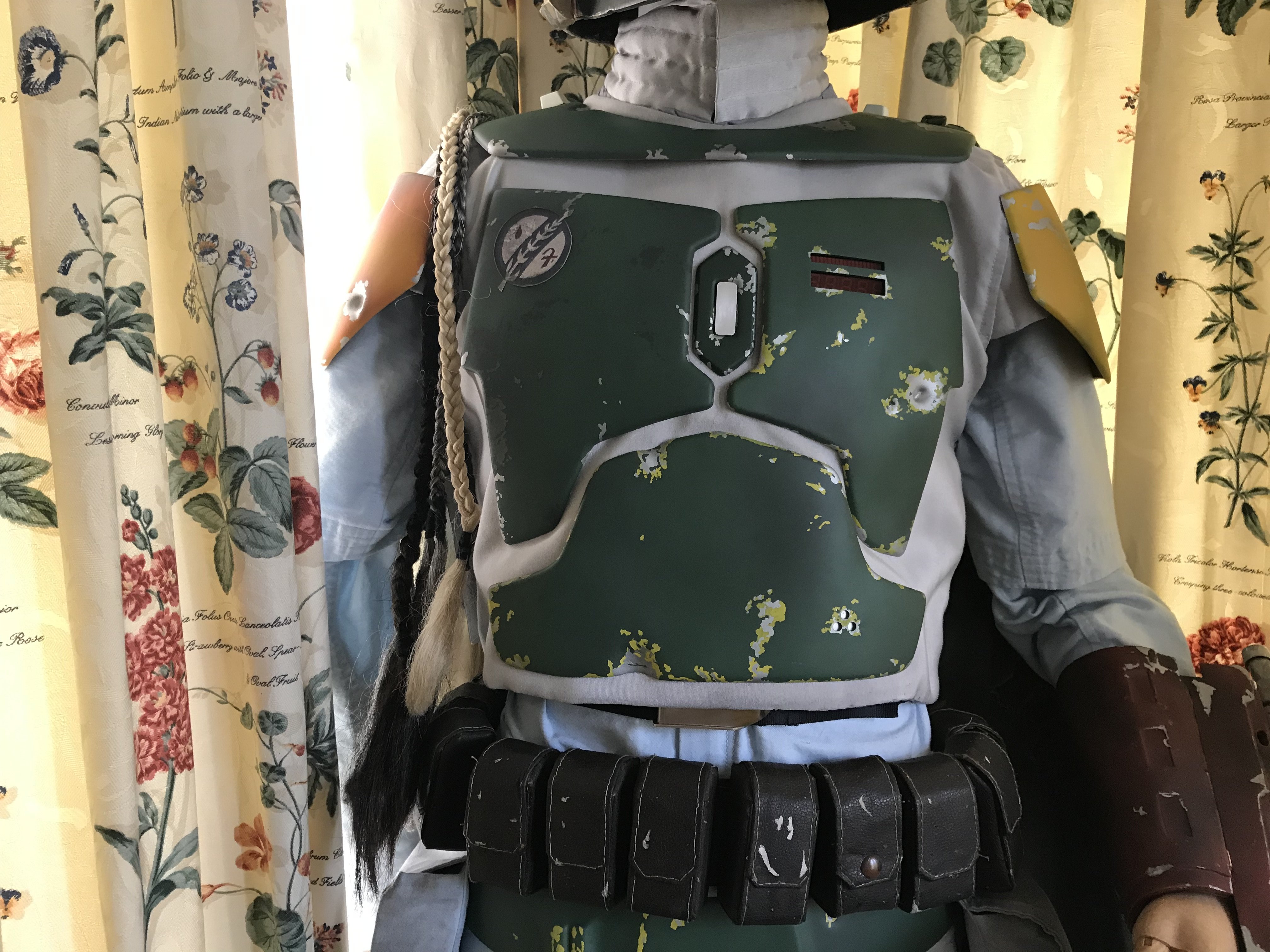

Tweaked Boba a little while I wait for the jetpack and belt. I attached two press studs to the neckseal to combat it pulling up with the weight of the jetpack, since I was seeing a lot of the grey dickie. I may need another in the centre, but I'll see how it goes. I was debating sewing the neckseal onto the flight suit to solve the problem and be more screen accurate but apparently that comes with it's own problems.
I've also further tweaked the armour placement. I feel like that's a neverending task that I'll never be happy with, but this is where the mannequin really comes in handy because it gives me the chance to take a step back and see how it looks. Regretfully, I THINK my chest armour is just a little too small. The gaps between the chest plates and the ab plate and the ab plate and the bottom of the vest are too big for ESB. I could move the ab plate up and re-hem it higher, but then w're getting too high above my belly button for the vest, which will make too much of the jetpack harness visible. I may opt for Wasted Fett's FPA chest armour, which is slightly bigger than FP v4.
I have also hemmed the vest. Again, I was towing the line between having too much of the divers buckle visible and closing the gap between the armour. New armour should solve that, along with my plan to velcro the bottom jetpack harness strap higher on the flight suit. I know having the buckle visible is fine, but I'd prefer not to see it since most of the people who see this costume won't have seen it before in the film.

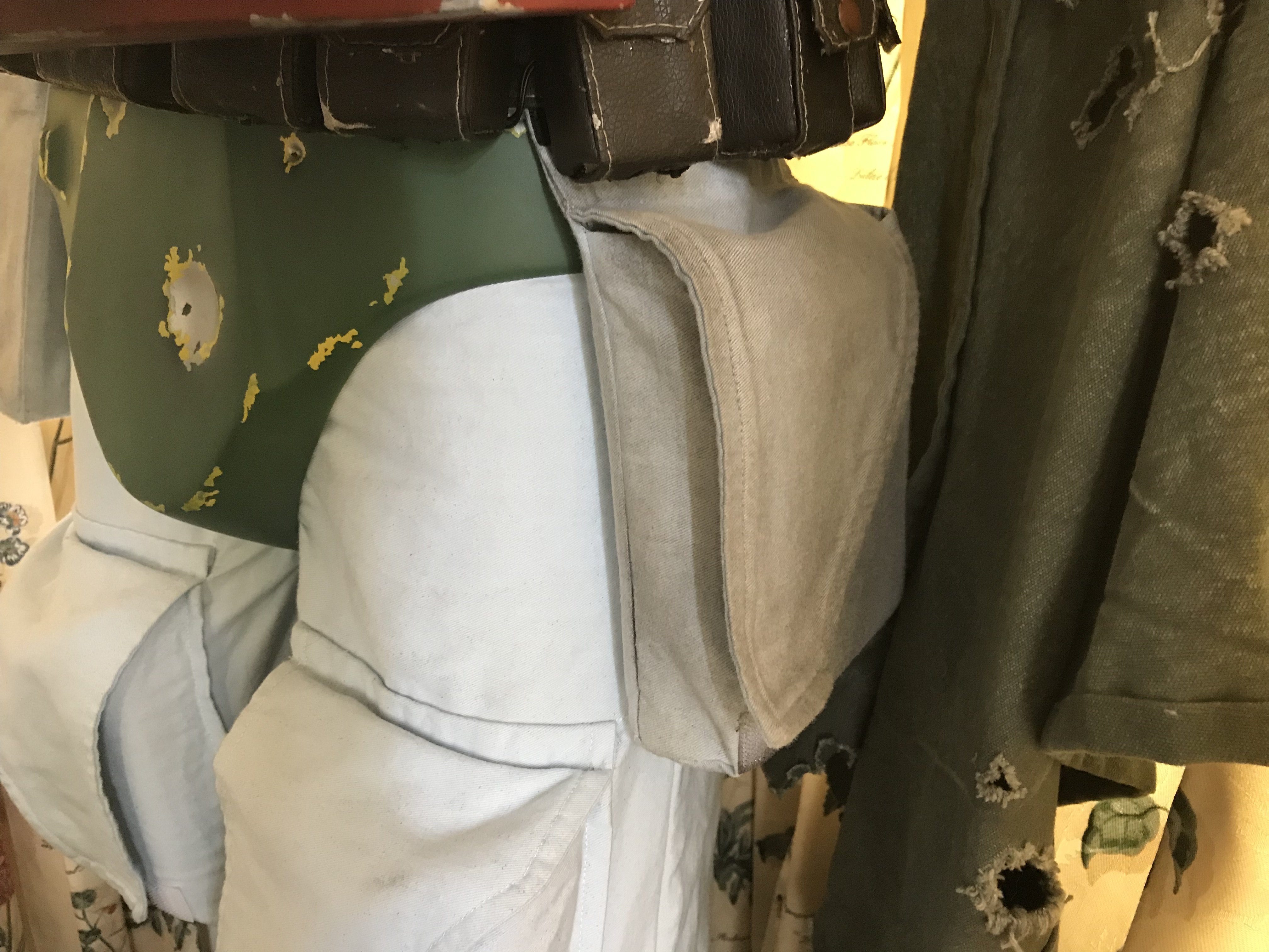

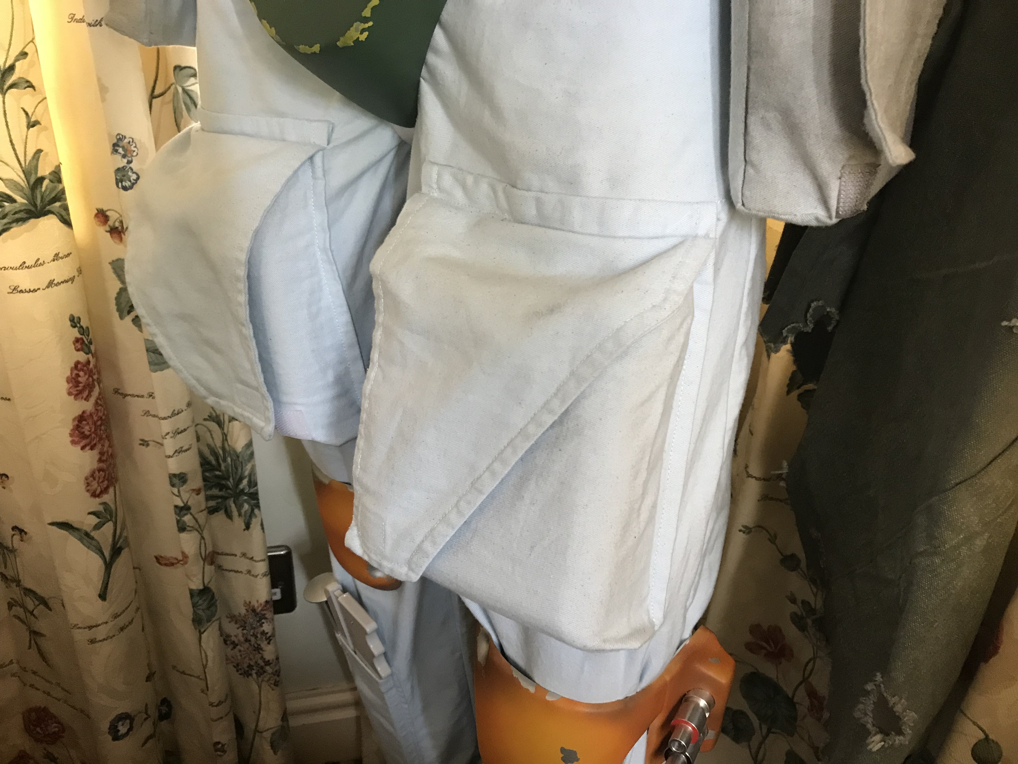

I weathered the side pouches. I just wet the fabric, sprayed on some grey, black and brown rattlecans (going heavier with the black) and then buffed it into the fabric with a sponge. I could have gone further with the weathering but I'm still on the fence over how much weathering I want to do. I know the behind the scenes photos show him caked in dirt, but the screencaps seem to mute a lot of that. I can always add more later anyway. Also weathered the boots the same way but used wire wool to buff the rubber.

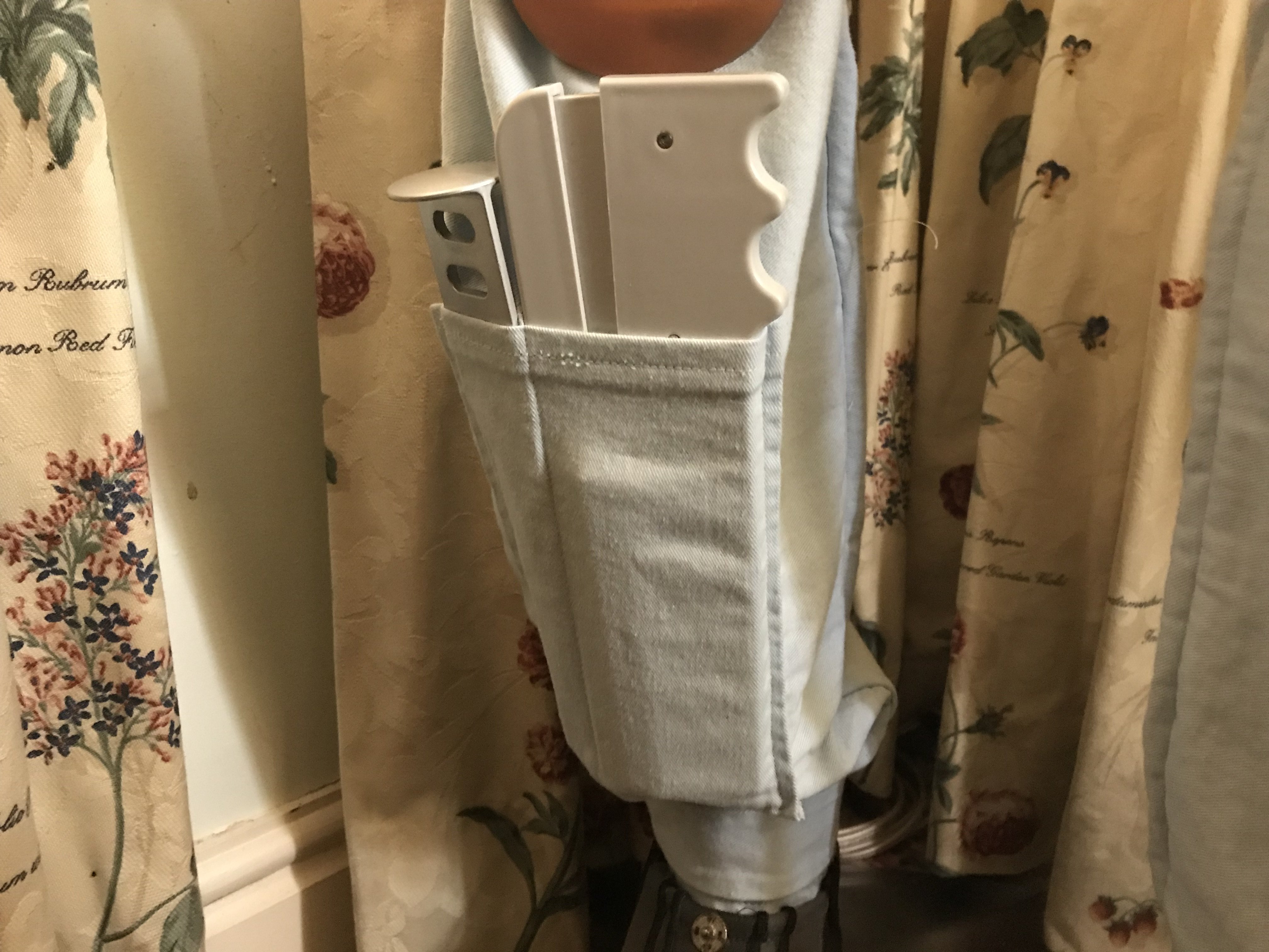

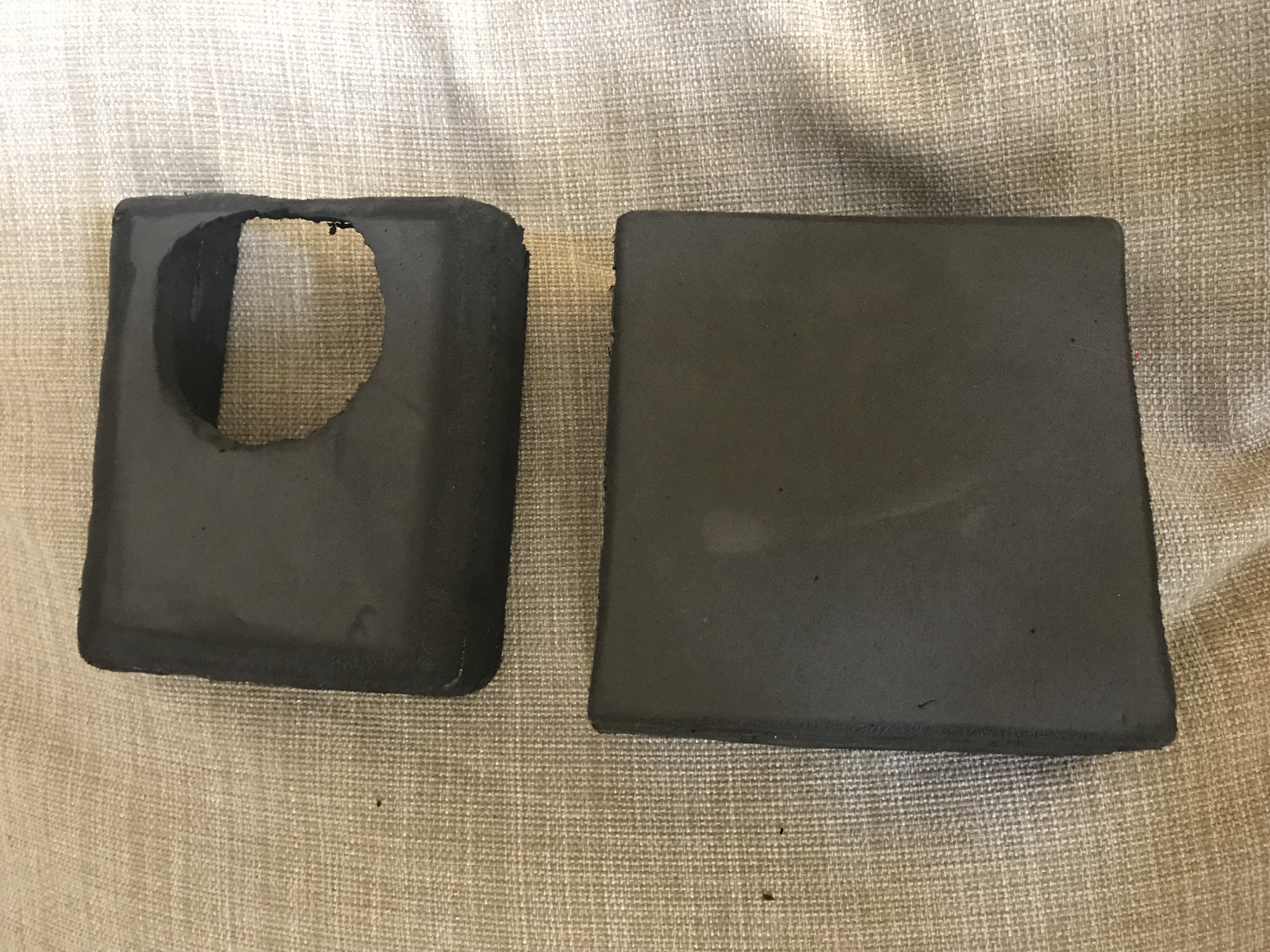

I made the foam padding for the pockets. I rounded off the sharp edges on the side pockets, and rounded them off severely for the thigh pockets. I'm planning on putting my voice changer in the jetpack, since the setup currently JUST fits in a sidepocket but messes with the shape, so I'm putting the voice changer speaker in a thigh pocket (so it's facing forward).
