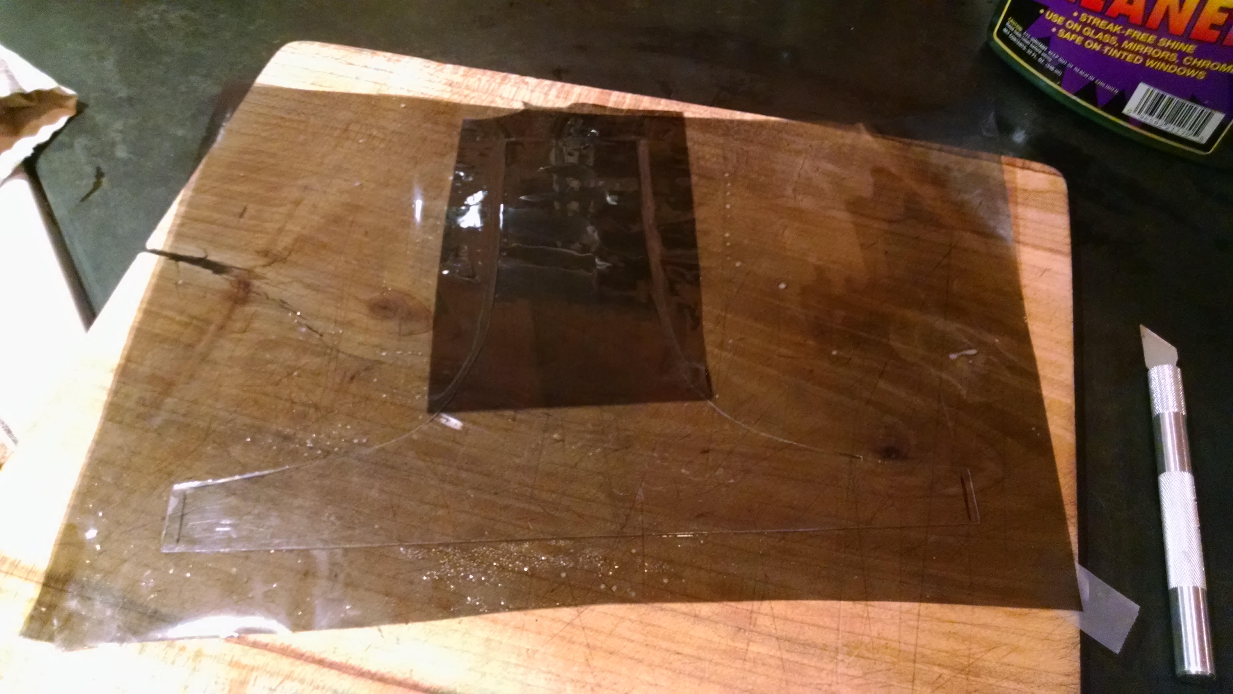

I use 35% auto window tint to tint the styrene, 1 layer overall on the outside, and a second layer inside for the vertical part to hide my nose etc. I got a t-visor.com one but I found it hard to see out of. So I decided on scratch-built. The basic instructions are peel the clear backing off, spray window cleaner on, apply film, squeegee out bubbles.
Window film applied but still wet:

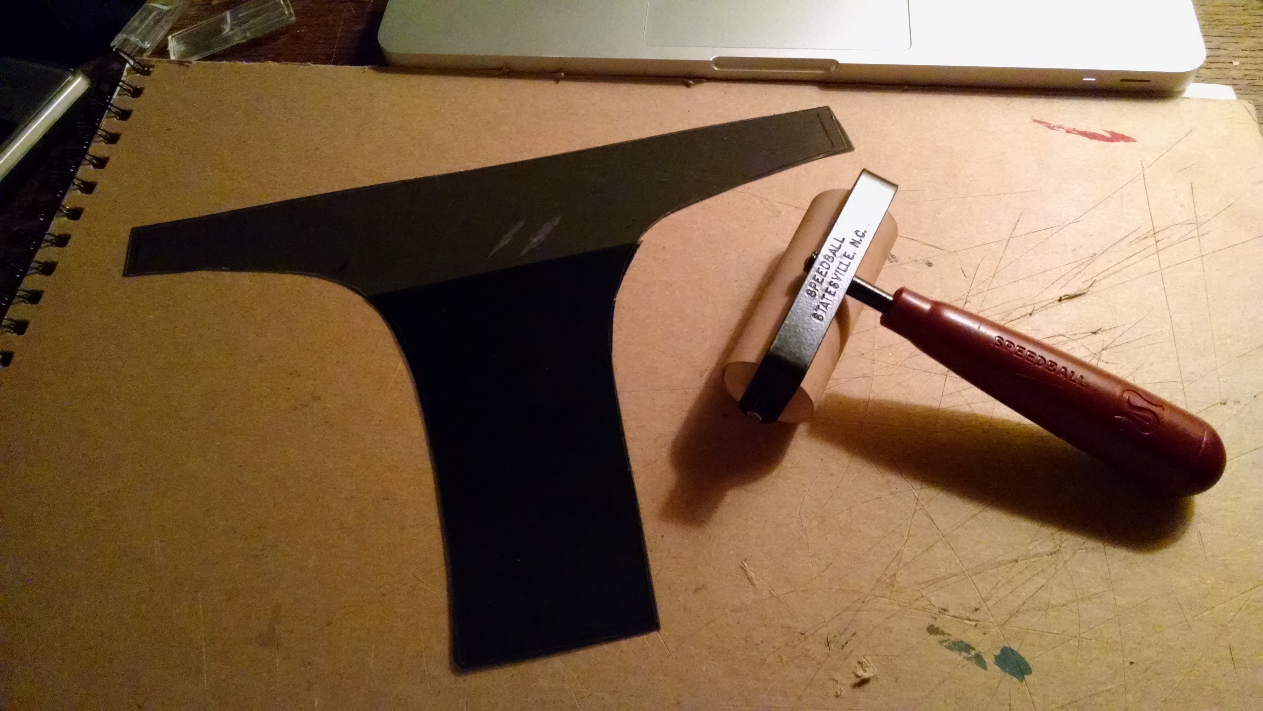

Rolled out, now has to dry to remove various bubbles:

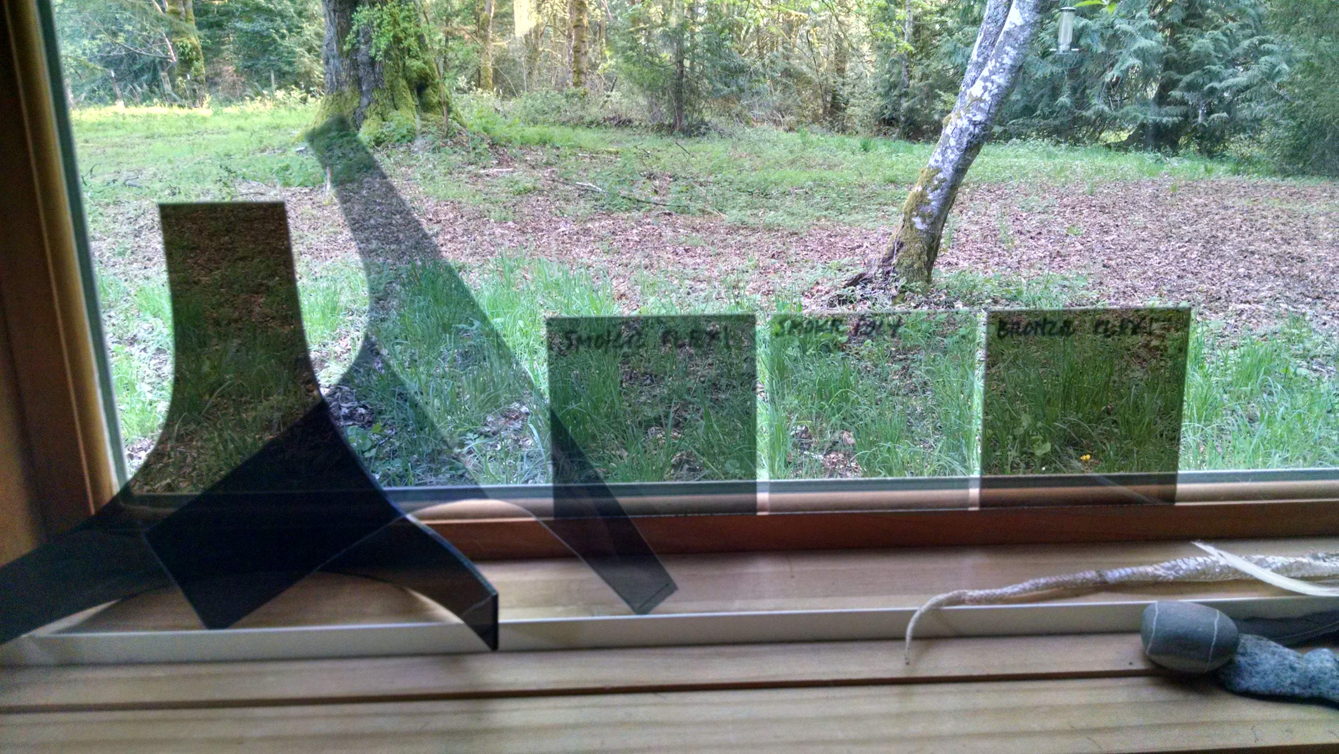

Ordered some samples from Tapp Plastics, our local plexi and other stuff supply house. In this pic you can see the T-Visor.com visor, my scratch built visor with 2-stage tint, Tapp's "smoke" plexi, "smoke" polycarbonate, and their "bronze" plexi.
Note how the "smoke" plexi is lighter than the T-visor one, but darker than my scratch-built. I will order enough of the "smoke" plexi to make a few visors; a couple for myself and I'll have some extra if anyone is interested in a visor that offers a little better visibility.
