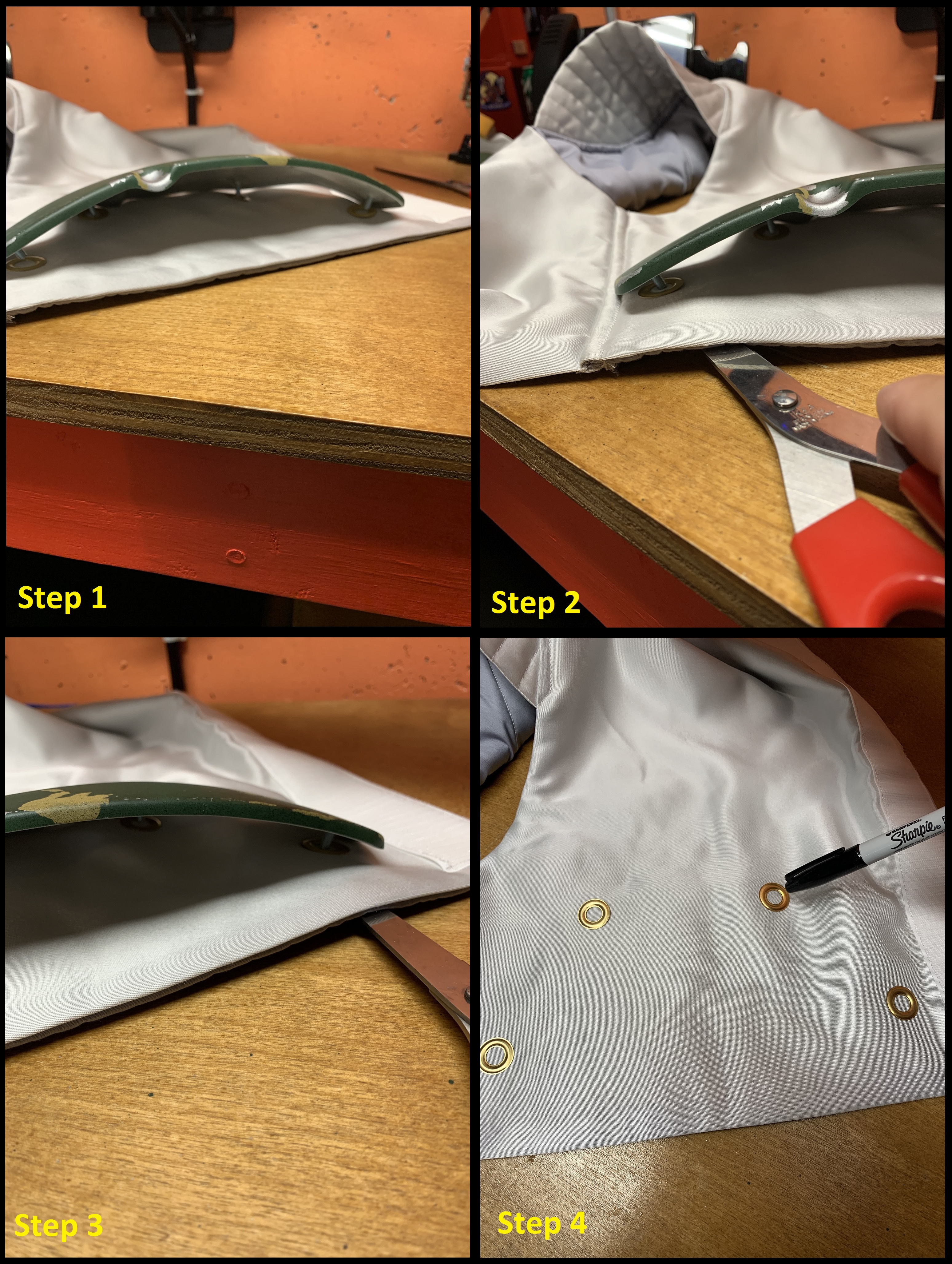

After I got the Bolts attached to the armor I then placed my armor on my vest to get spacing correct, I did so via this method:
Step 1: Place your armor with flat grommet pieces under it, and adjust where needed to get the armor looking right.
Step 2: Using something long and skinny (I used a long scissors) maneuver the grommets in a way that they'll seat the screw just right. Also go under the fabric and gently lift it to see if the screw will land correctly in the grommet.
Step 3: Do Step 2, for all other grommets.
Step 4: Very gently lift the armor leaving the flat grommets in place and then with a sharpie, put a dot in the center of the grommets.

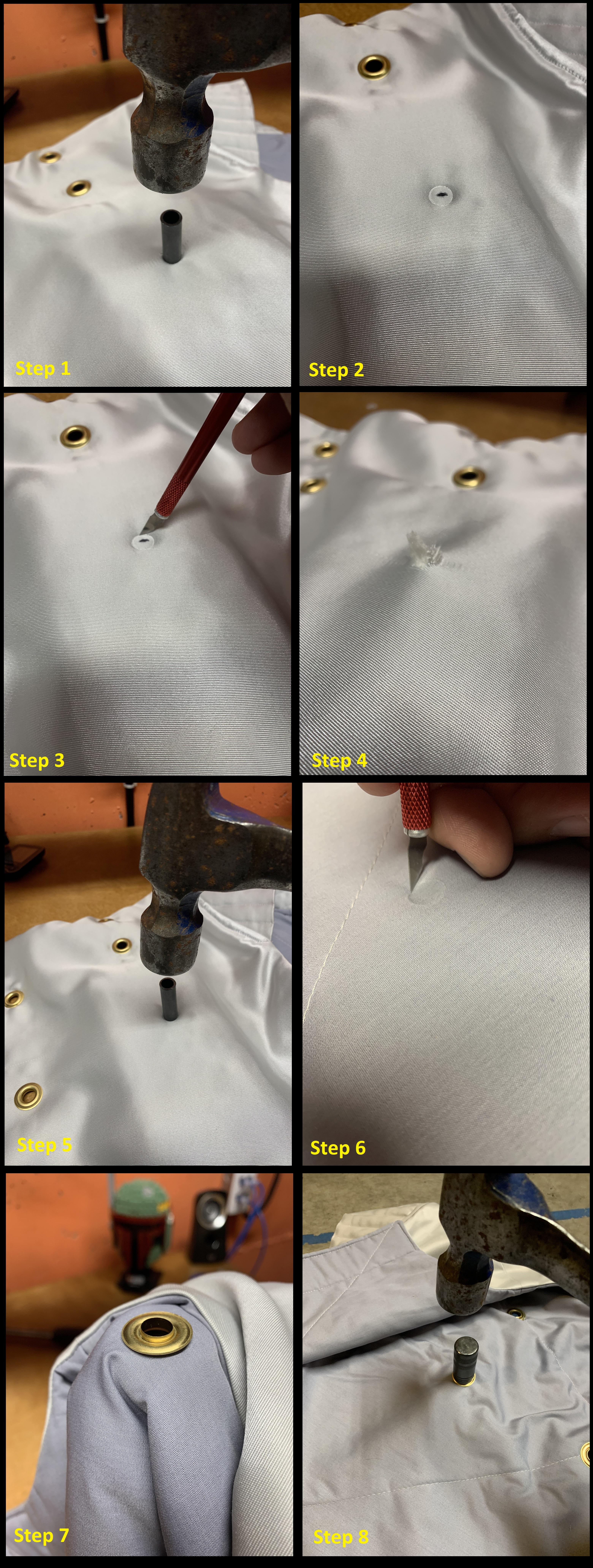

Once that was completed I then started to install the grommets. Here are the steps I took....
Step 1: Hammer on the grommet cutting tool, which doesn't cut all the way through Arkady's vest material by the way.
Step 2: You can see the circle indent it makes.
Step 3: Using a hobby knife, cut out the hole.
Step 4: You'll also have some padding to deal with underneath, so make sure to clean that out.
Step 5: Using the Grommet Cutting Tool Hammer the hole again. (This is for the reverse side)
Step 6: Flip the Vest over and you should see the indent, Using a hobby knife, cut that piece out.
Step 7: Put on the Grommet.
Step 8: Pound on the Grommet.

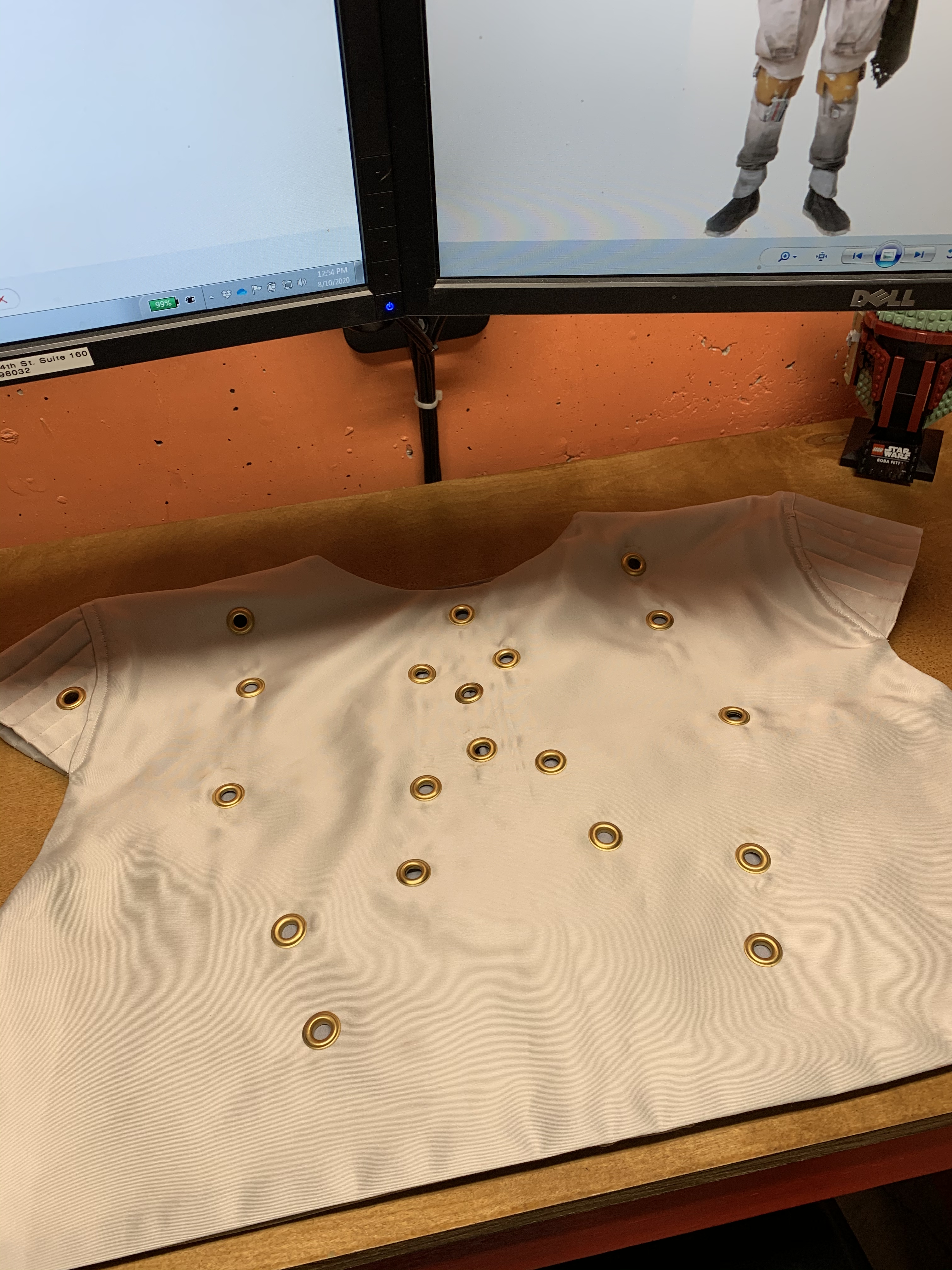

When I was finished, the end result was this....

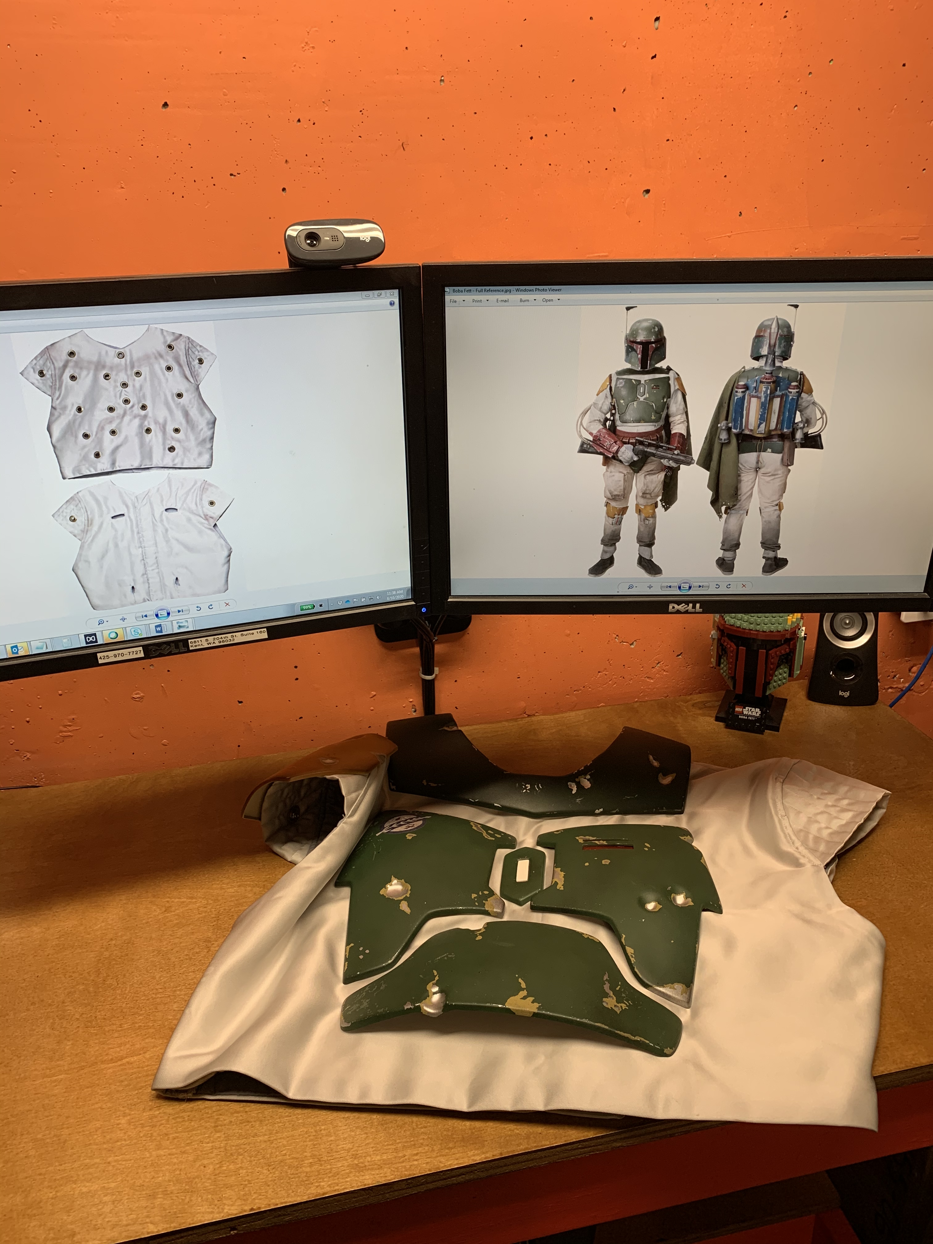

It was a chore indeed and felt great once done....and the armor mounted?

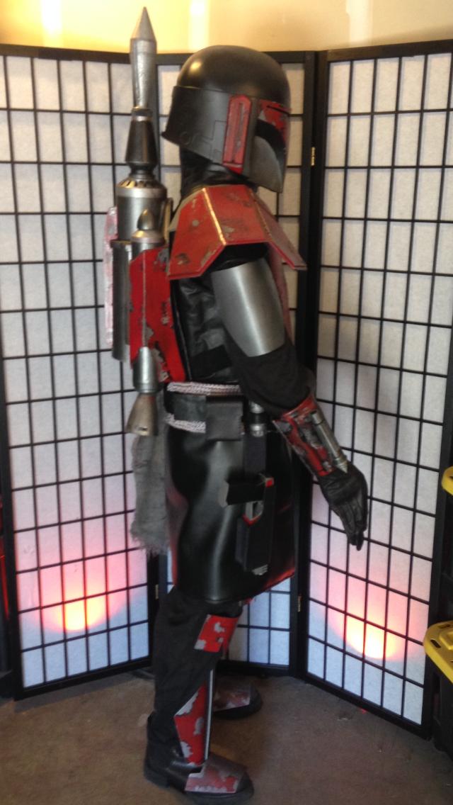

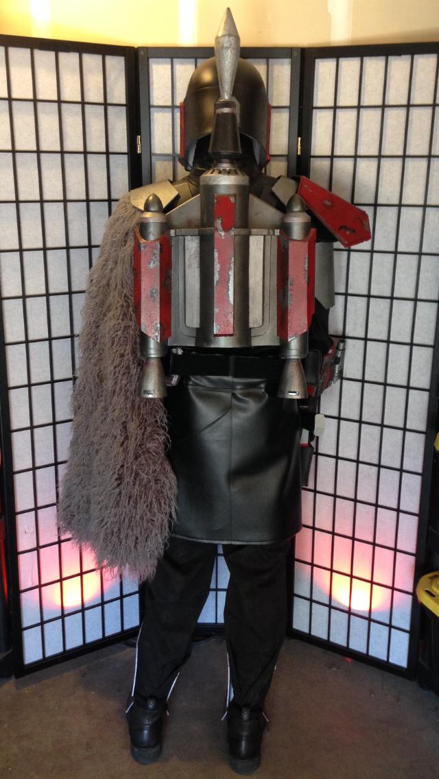

I use a leather flak with heavy duty 3m Velcro ( purchased 2inch wide roll by 50ft ) also stitched it into my flight suit to hold leg and other armor in place even worked well on my back plate with jet pack ( even with the extra weight )
do not want to see any straps or buckles
Hope this helps --- Best of luck with your build :)
