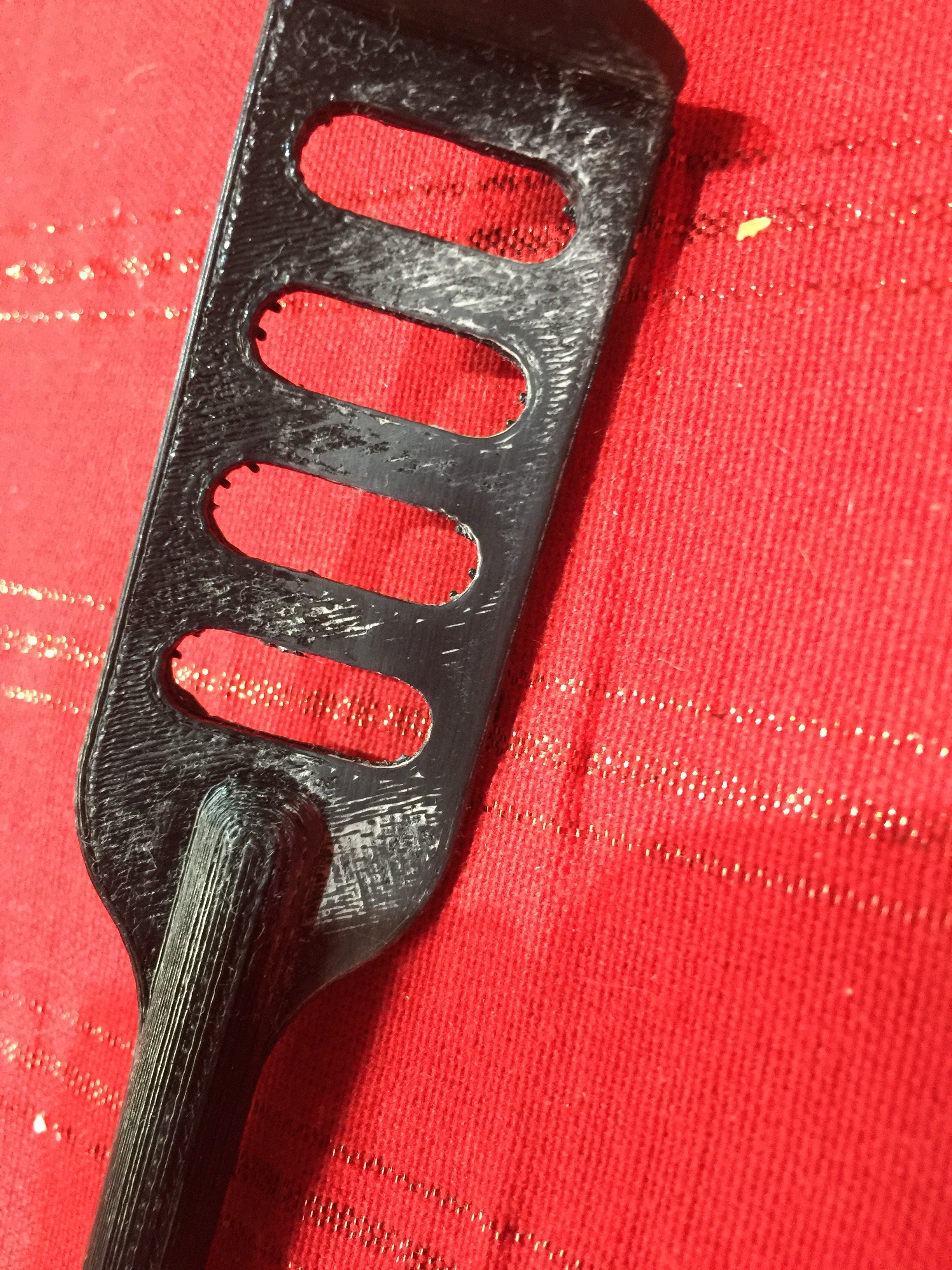

I’ve been slowly working on my ROTJ build starting with shin tools. I was wondering if those in the community that do 3D printing have any finishing tips to share?
My best finished piece which is ready for painting took me roughly 12 or more hours to get to this point. The close up picture was part way through the process. The full length shot is ready to paint. Didn’t want it too smooth or the paint won’t stick. :)
Not afraid of hard work (I have drawn blood already) but was hoping others out there have thoughts or suggestions to share.

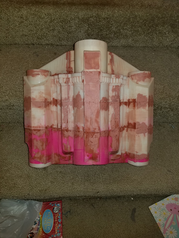

I usually do some light sanding on my raw 3D prints then hit it with a coat of 3M glazing putty to fill in any low areas. Once dry, more sanding to a smooth even finish, then a rattle can Primer/Filler coat, more sanding (and another Primer/Filler coat depending on imperfections, then sand again), then paint coat. I would guess on a print the size of that shin tool that all this could be completed in 1/3 of the time you have spend already, depending on weather conditions for primer and paint application that is.
Larger pieces you could probably use bondo instead of the 3M glazing putty. Either would work.

No problem. There are other products out there that would be an option to try as well. I know of 1 called XTC-3D. It's a 2 part coating specifically made for smoothing 3D prints. You mix part A and part B together and then brush it on. Then it cures to a gloss and is supposed to be sandable and accepting of paint/primer.

If you go to home depot and get the 2X Clear Gloss spray paint and give your parts 2 coats of that it does a lot of the heavy lifting as far as filling gaps in your print.
2 coats of that plus a light sand then Filler Primer will do 95% of the smoothing work without having to mix chemicals.
This a bit more work, but I like to coat with a 2 part epoxy...basically a clear casting resin. It gives a nice hard sandable finish. Tabletop epoxy may work, but might be too thick. If you end up trying this, be careful to mix really well or it will be a mess that won't harden...mix 3 minutes...pour in a new cup mix 3 minutes.

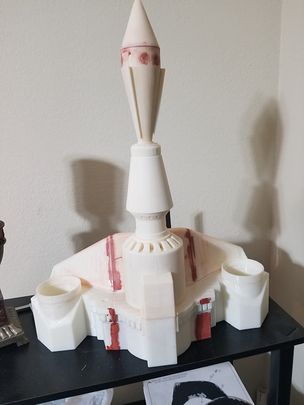

Hey MinaFett,
I have 3d Printed my Jetpack, EE-3 Blaster, All Shin Tools, helmet interior and starting the Sidearm now. I have printed all in ABS plastic.
When the print is done and in a raw format this is my process:
  • Sand the piece with a low grit just to knock down the grooves then follow with a higher grit
  • I will then brush on some acetone to smooth out some of the grooves
  • If I am bonding pcs together I bond with JB weld. When the JBWeld dries, I brush on acetone to really weld/melt the 2 pcs together
  • I use the Bondo Glazing putty to smooth the joints as needed
  • I use several coats of a filler primer, this really creates a nice smooth finish, but since I am really wanting my Boba Fett ESB build to take on more of a weathered/damaged look, I don't mind leaving some of the ridges or inconsistency's that may be left if not all of it is smooth, makes nice damage marks
Definitely a multi step time consuming process
A couple of Aussie alternative products to the 3M Bondo Glazing and Spot Putty are; Septone Car Filler, Body Filler (aka BOG), or builders fill. Those products should be in automotive sections. Some googling lists a couple Aussie businesses called "Super Cheap Auto" or "Repco" should carry those products.
