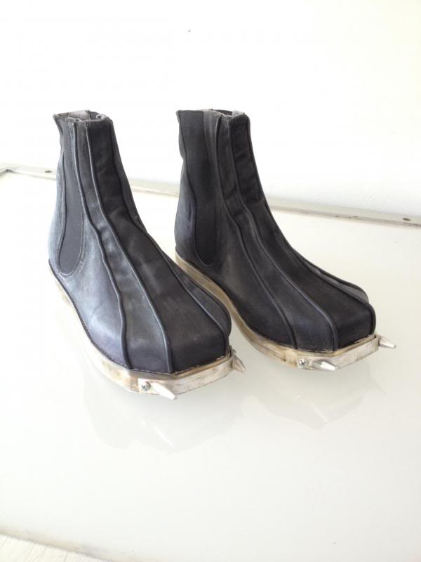

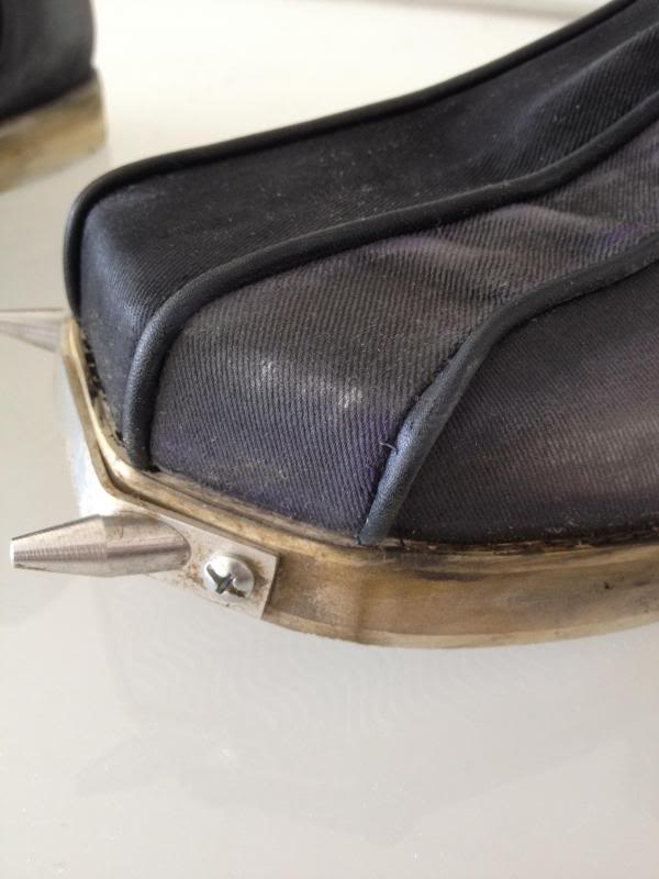

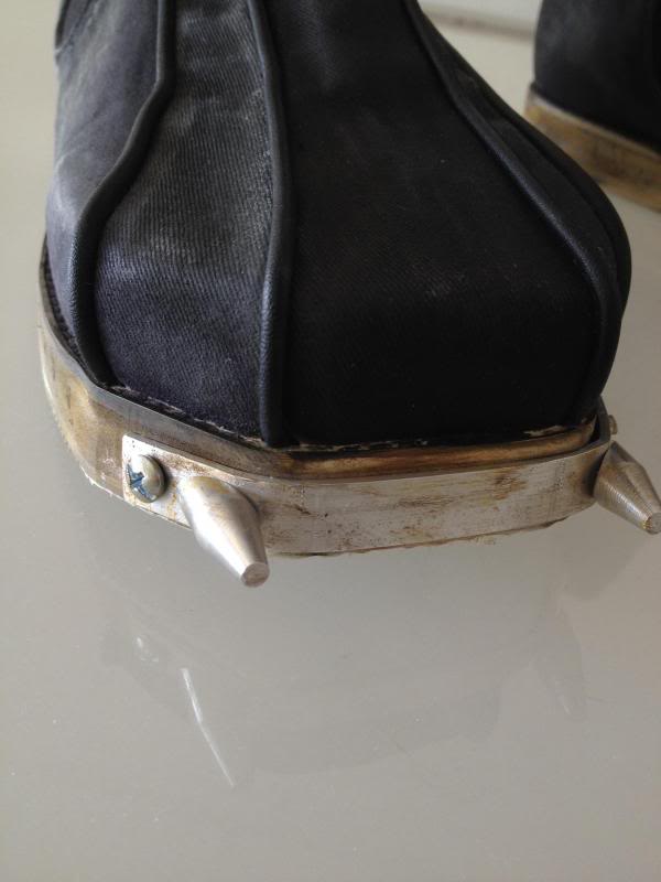

Here was my answer to toe spikes for my 2014 MOW boots....I made these from stock aluminum & aluminum dowls.
I also did the weathering.
Thanks guys,I'm always hesitant to post pics because everyone's Fett looks killer to me...so it means a lot.
Negative,I uses stock 1/8 aluminum & took the aluminum dowel to a 4" grinding wheel then smoothed it out on my
vertical belt sander with a fine belt.
- - - Updated - - -
Oh & they are attached with screws from the back....I put a tap & die to them.
Those turned out great. Nice weathering as well. I have a set of spikes myself that I need to mount on some MOW 2014. Do you drill a pilot hole and slap in some glue when you attach them to the boots? I'm just curious if the rubber gets loose on you after awhile?
I did drill a small hole first,they fit super tight. I figure if they start to loosen up, I will
put a dab of JB weld in the hole or some E600 on the screw. But definatly make sure tou
lock tight the spikes.
