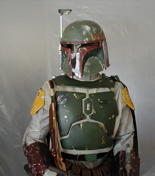

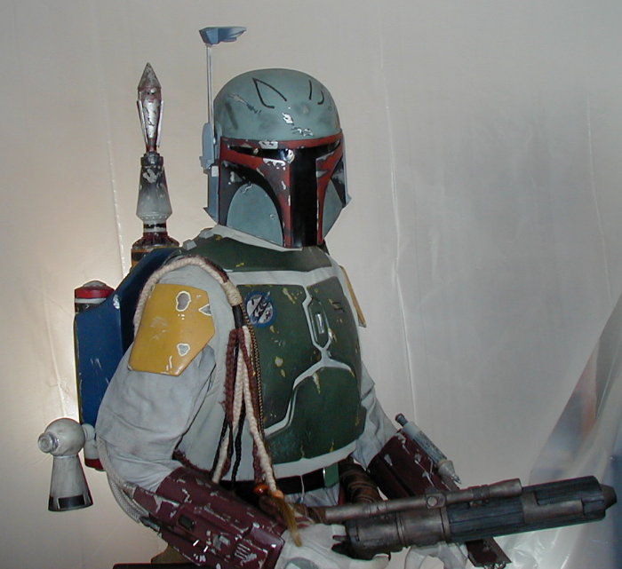

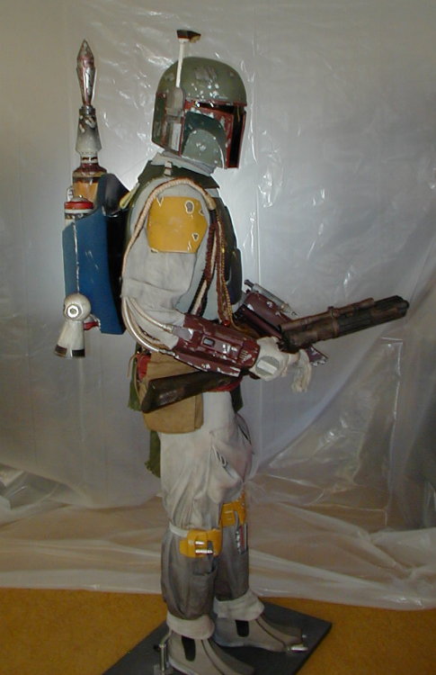

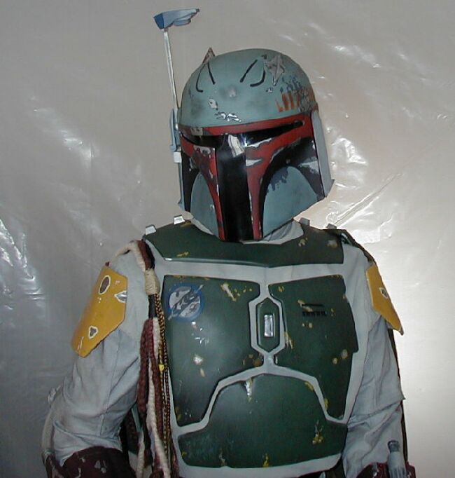

My wearable Boba Fett circa 2001.
All painted with RIM, including the GF (George Fallano)helmet. Same RIM paint, just weathered different.

My old Pre Pro helmet, I mixed a little something with the RIM to get this red color.
