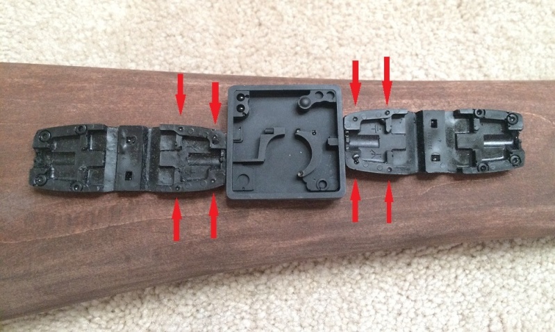

Hit it with some stain. Haven't glued the greebles on yet. Not quite sure on what glue I want to use

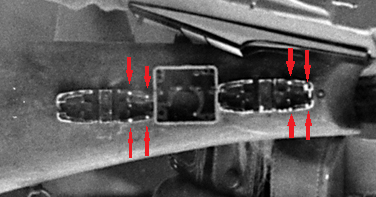

Hey mhlayne, back to the topic, before gluing your greeblies check out the positioning of the lateral greeblie on the right. The four little teeth that snap into the matching recesses should be away from the central greeblie. Yours is the other way around:
Perfect thank you! I was having a hard time figuring out which way I needed to have them. Straining my eyes at my computer screen haha. Thanks a ton.
