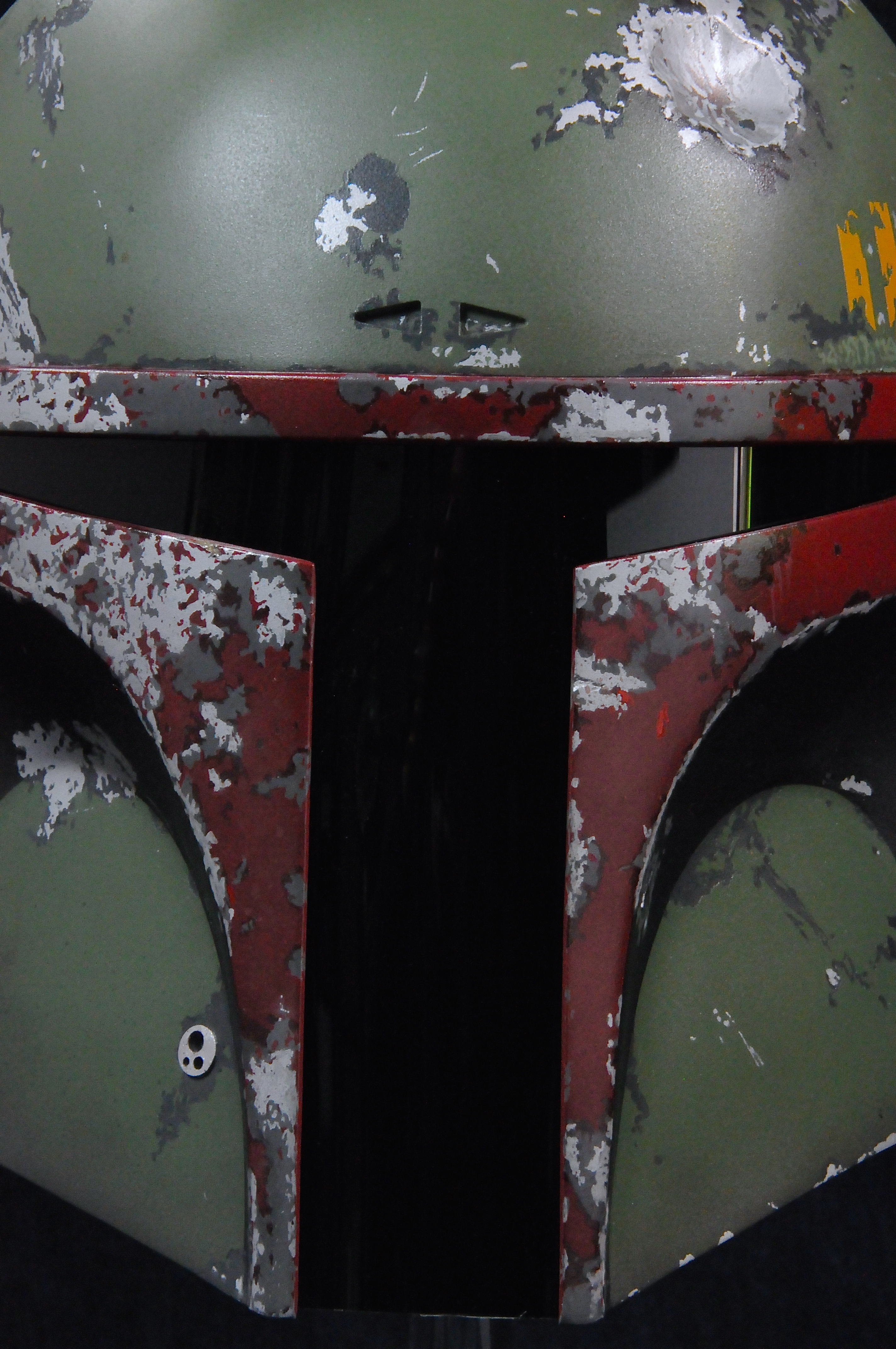

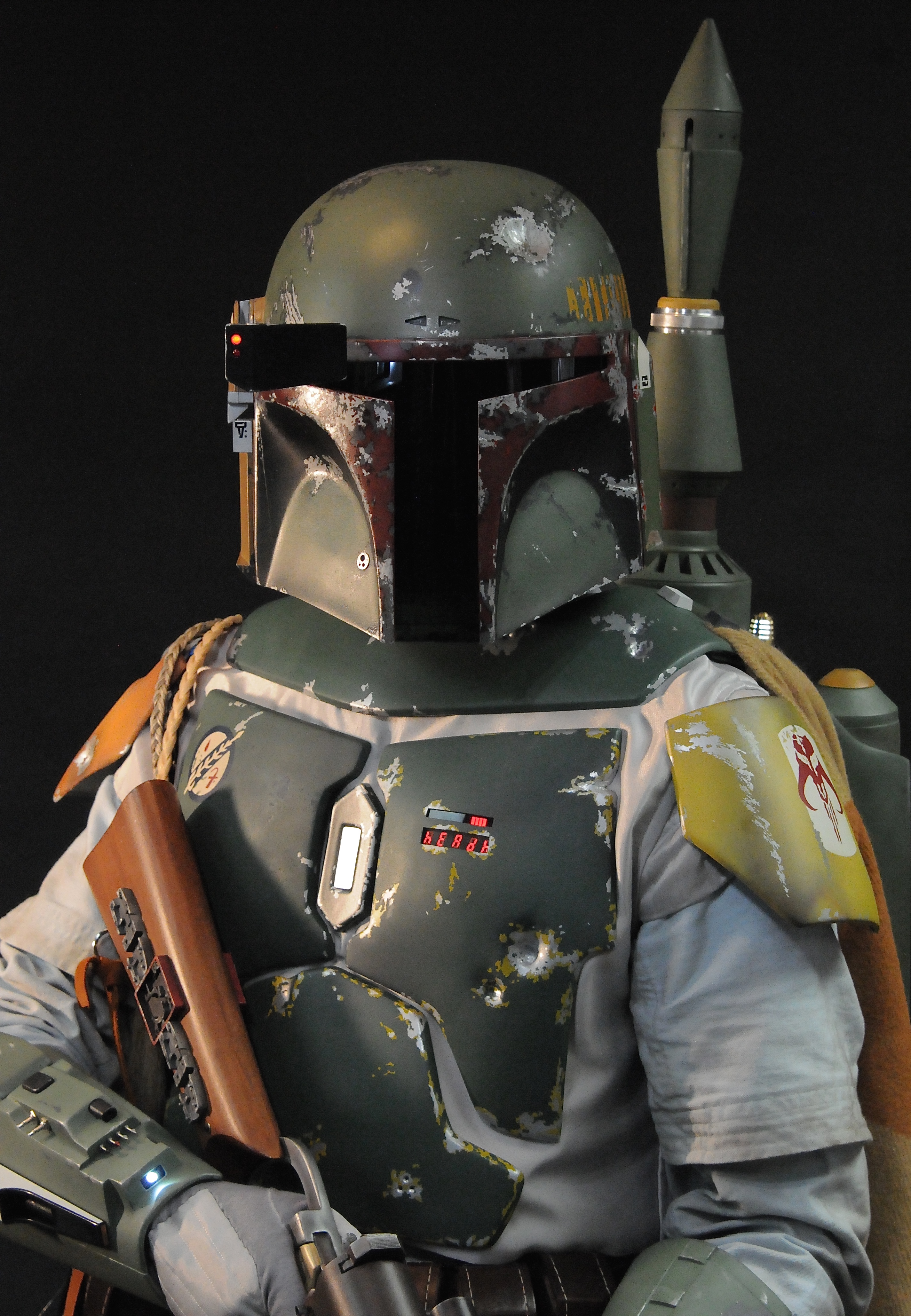

Here is how our ESB Boba looks with as many as 4 coats of sealer and under a heavy studio light set up.
DSC_7352.jpg He shines less with excellent color depth in natural light conditions.

Here trooping in fairly average light with four coats of Testors Model Master Metalizer Sealer (non- buffing) over
all painted surfaces.
Note that the silver non buff aluminum paint on the shoulder armor still has a nice shine but the paint around it doesn't.
The colors remain vibrant and have depth without shine and the subtle difference in the greens holds up well. My two cents worth.
