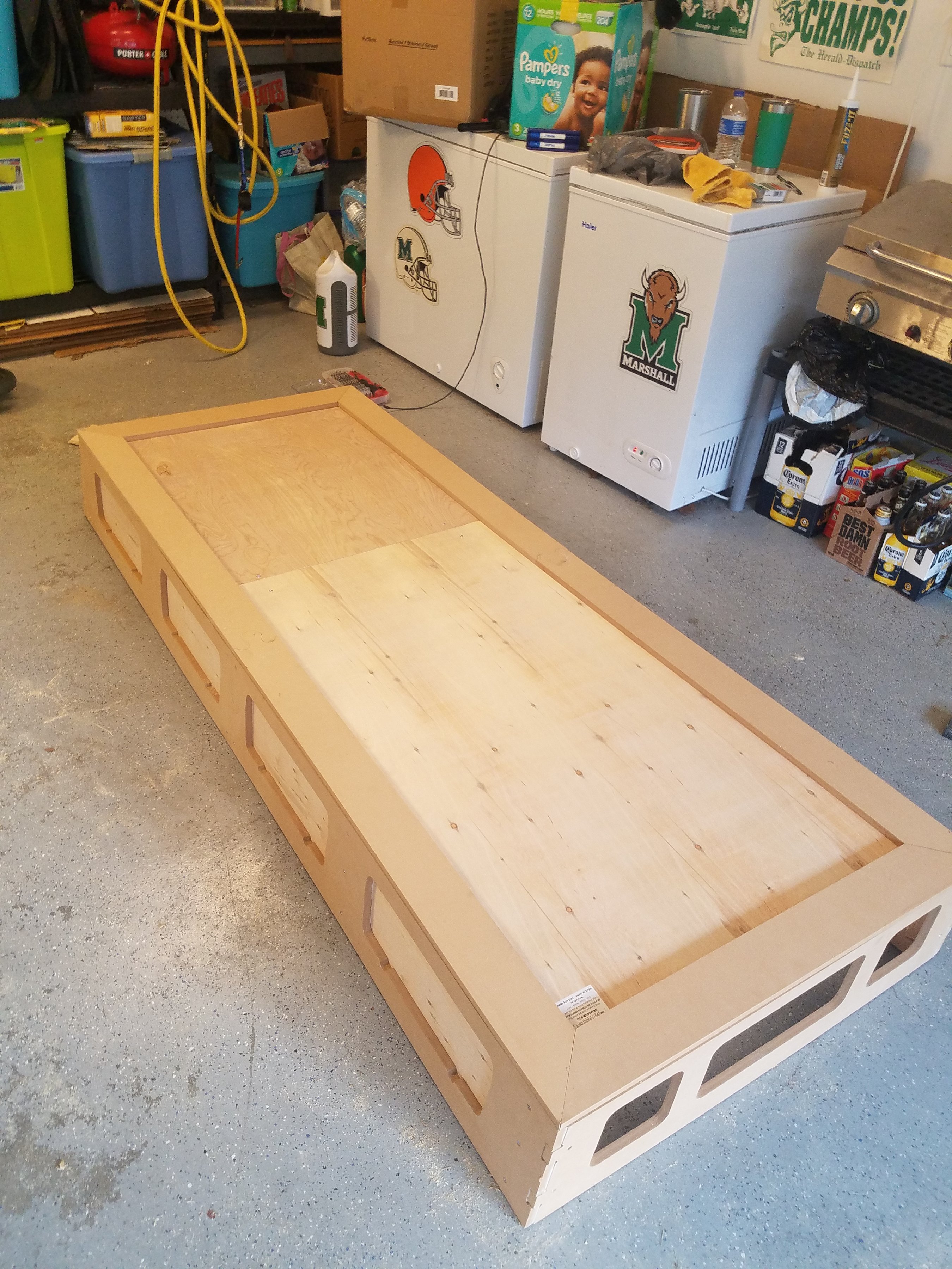

Some images of the start of my build. Box from zenix and front panel from Stormrider. Only thing I noticed is that once I got the box done and sized up Han on the box I noticed that there was a few inches of room left at the bottom under Hans feet I need to fill in with texture. Not sure what to do about this and what you guys recommend. I don't want it to look mismatched and like I filled it in.
Also, my edges around the box don't match perfectly so will need to sand down and put bondo or something on it to make it blend in. Anyone else who has built have those issues? I don't do wood working and stuff like this so it's tough for me to know what to use and all that mess.

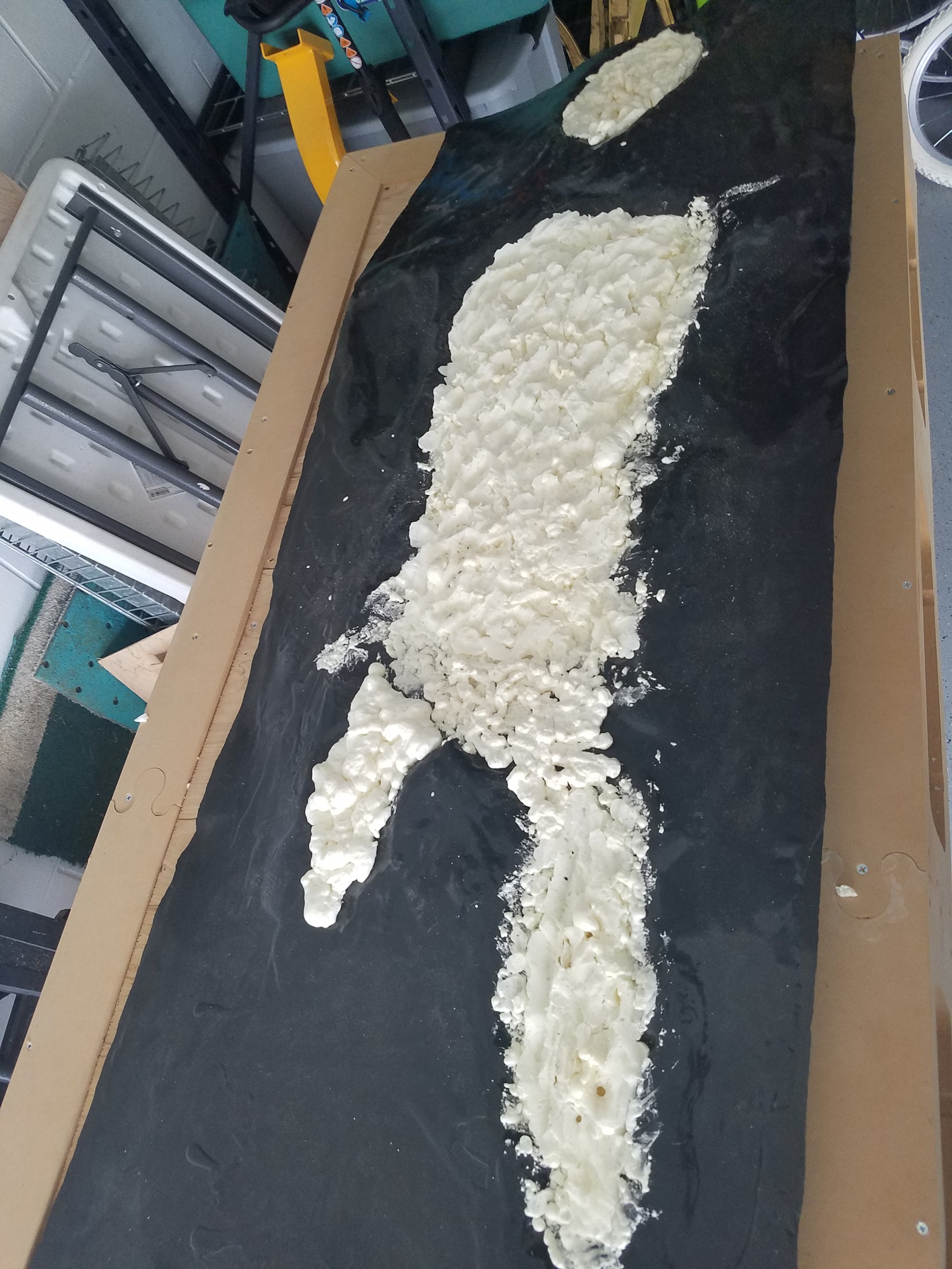

Filled in the back with Great Stuff gaps and cracks. Trimming back to make level with the back. Make sure you wear gloves with this stuff. Lol
This gives Han great support in the concave areas. Solid once it drys.

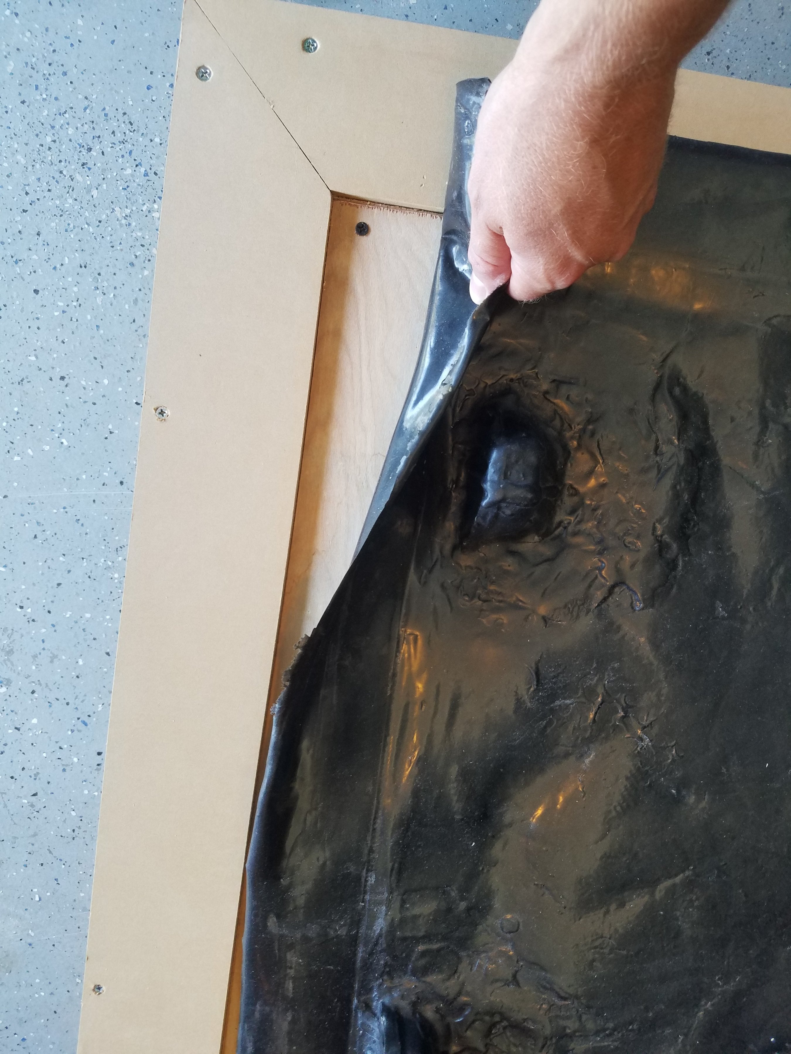

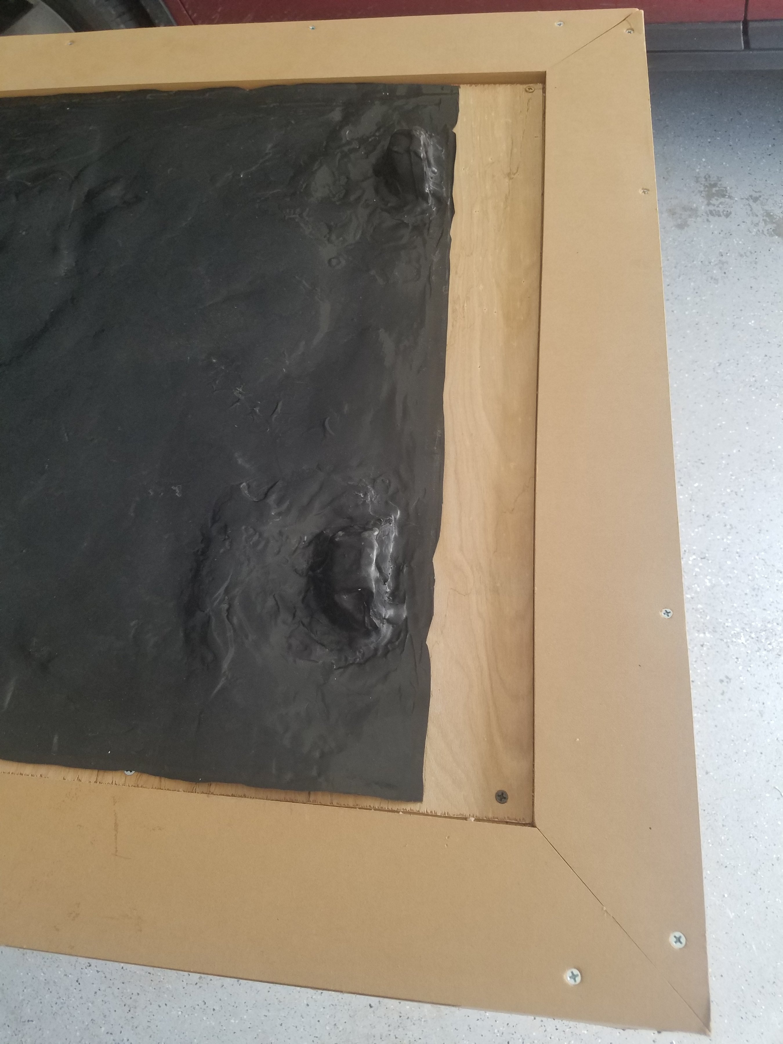

I'm hating this gap. Don't know why I have such a gap at the bottom not sure how to tackle this. Do I fill in bottom or do I cut it and move feet down and then fill in gap between feet and other portion?
Look at reference pictures. You want the feet an appropriate distance away from the edge. You are going to have to fill in with bondo either way, so no big deal.
I just haven't seen any examples with people having this issue. I'm afraid of moving the feet down separately because it may throw off the overall spacing of Han. If I move feet down it may make the legs look too long.
This is a drawback with the one piece. It is not necessarily scaled to fit the box. The advantage is that the texturing of the carbonite is pretty spot on. Most people have to fill in all of the carbonite using wood glue or bondo. You just have to fill in the areas that don't fit.
So essentially the box is manufactured a smidge too big. If I could match the texture decently I would bring the feet down and fill in between.
I don't know if the cast is too small or the box is too big, but yeah, you could cut the feet out and move them down. Or you could just place it wherever and fill the sides in. That is what I plan to do.
