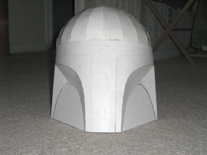

well, I've done this so far
with some hot glue (more like LOTS of hot glue :D) and single layer mat board, and it's not too bad on the wallet. I bought three sheets just in case I make a booboo ( i did :(), and also so I can scratchbuild the knees, gauntlets, and part of the rocket pack with it.
