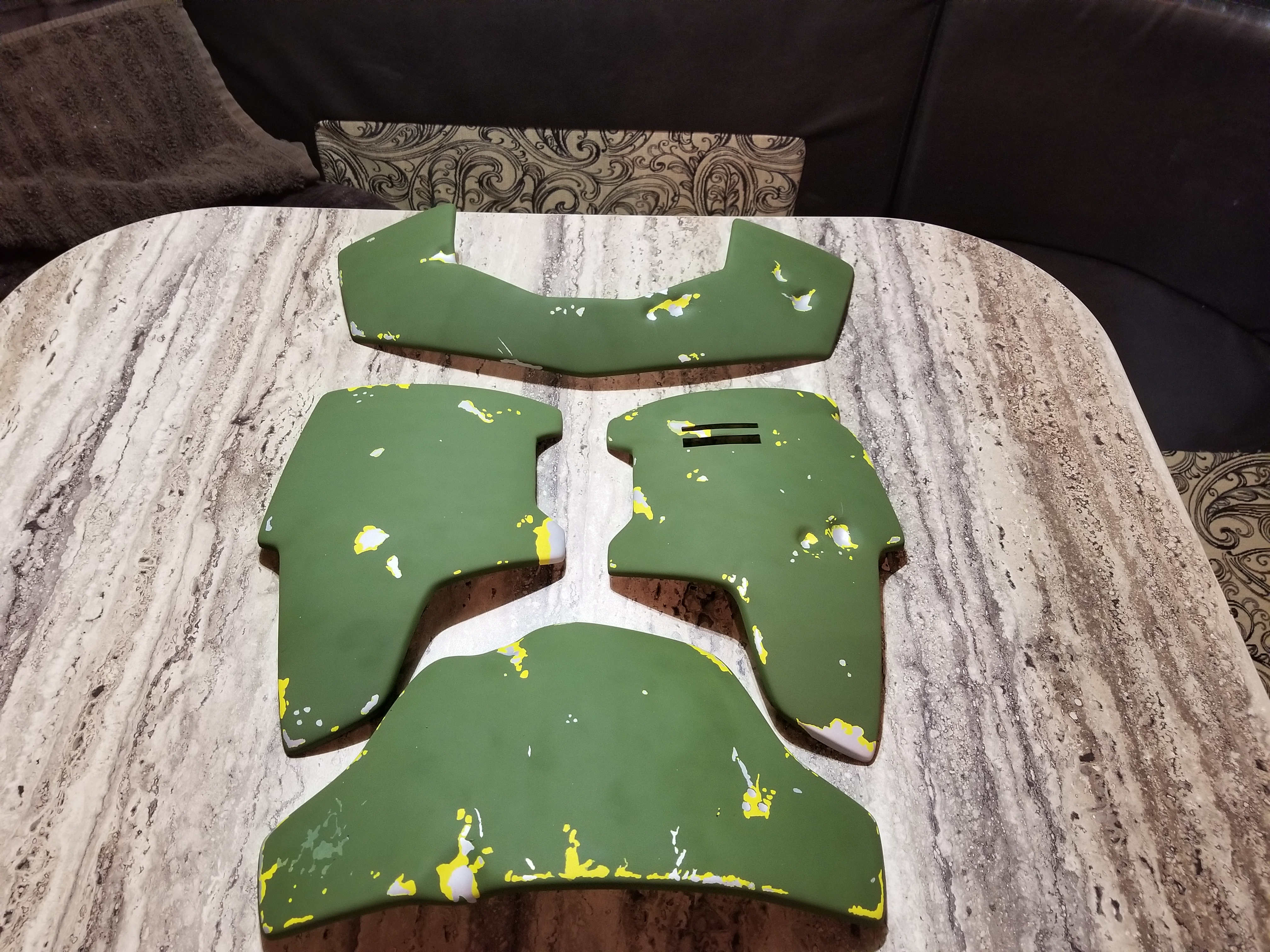

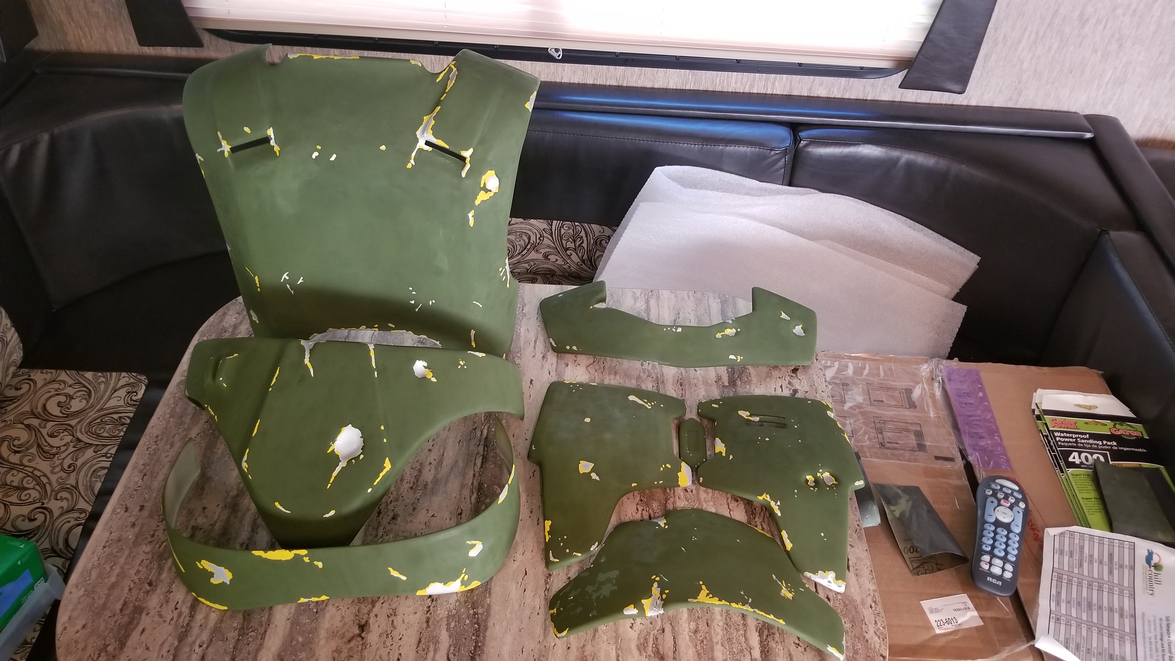

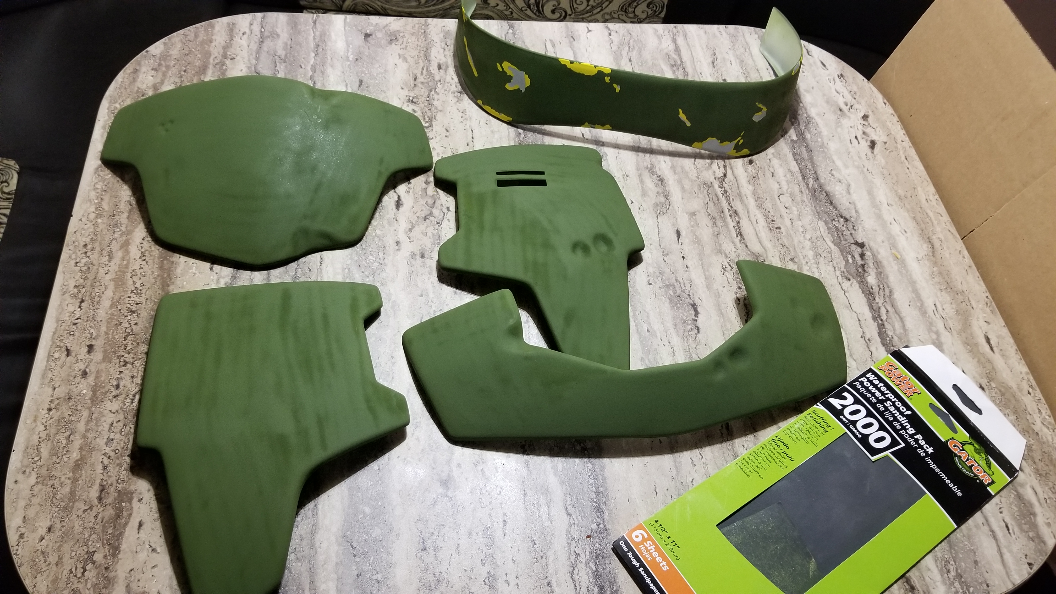

Hea guys, I'm new as well and thought this would be a good place to ask. What ratio do you mix the paint. I have been doing 1:1 (paint + thinner) but I tend to get brush strokes on my armor.
The first image it was really bad second was still bad i deiced to redo my front armor third is the final. 20170801_173029.jpg 20170811_180923.jpg 20171130_195148.jpg
