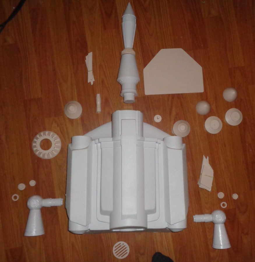

I'm getting my custom MOW jet pack today.
Since his classic jet pack is no longer available I asked him to make me a custom hybrid jet pack using using the Jango arena pack fuselage, 2 side top cones and fuselage detail panels, and using the classic rocket, and thruster ball assembles instead of those Jango parts. I got some Shape ways parts coming for the beacon and stabilizer.
This is my inspiration for the custom jet pack.
I need any and all ideas for building tips on this please.
I want to be able to make the side thruster removable and the main rocket removable as well for ease of transport.
Thanks for any ideas and tips.
Lynn

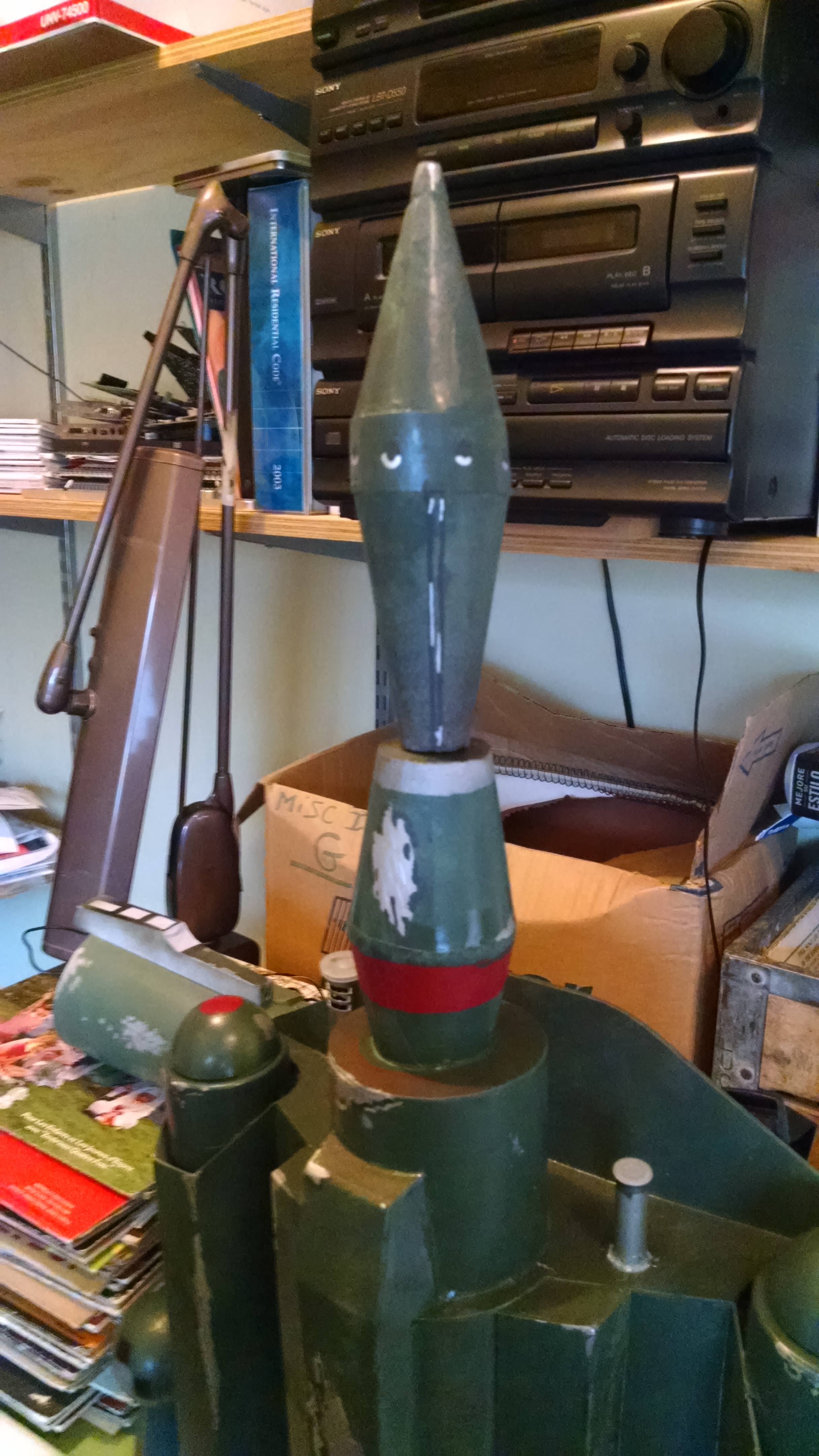

I'm not familiar with pre-made jetpacks, so this might not apply. To make my rocket removable, I drilled a long hole into the jetpack part, with a drill bit that was exactly the same size, if not just a tiny bit smaller, than a 1/2" dowel I mounted in the rocket. The dowel slips snugly into the hole in the jetpack. the hole in the jetpack in my case is really just some styrofoam and 2 layers of illustration board it passes through at the top. I tapered the tip of the dowel a bit to help it slip in.
Please disregard the inaccurate look of my jetpack, it was a 2 day build to get ready for trooping at the theater near me for Episode 7.
Good looking pack! I like the rocket attaching method.
Lynn
Thanks, it occurred to me while looking at the photo, that it would be hard to permanently mount the rocket in a way that was strong enough not to easily break off, without doing something similar. I think I got the idea from the photos of the pre-pro jetpack in the gallery.

Here it is, my custom MOW jet pack. Jango arena fuselage with classic pack parts.
Here are the only visible "defects" that I can see from the mold degradation of the arena pack MOW mentions in his add.
Too be honest, I may not even bother filling them in, why bother? It is not bad, no pin holes and no one will notice when the paint is on and it adds "age" to the jet pack.
Pour holes in the back will need to be taken care of.
A little surface texture needs to be sanded down and some red glaze putty will make fast work of this.
Overall I think this in an awesome pack and is a far step ahead of my old Richies Armor fiberglass jetpack that I had BITD.
Lynn

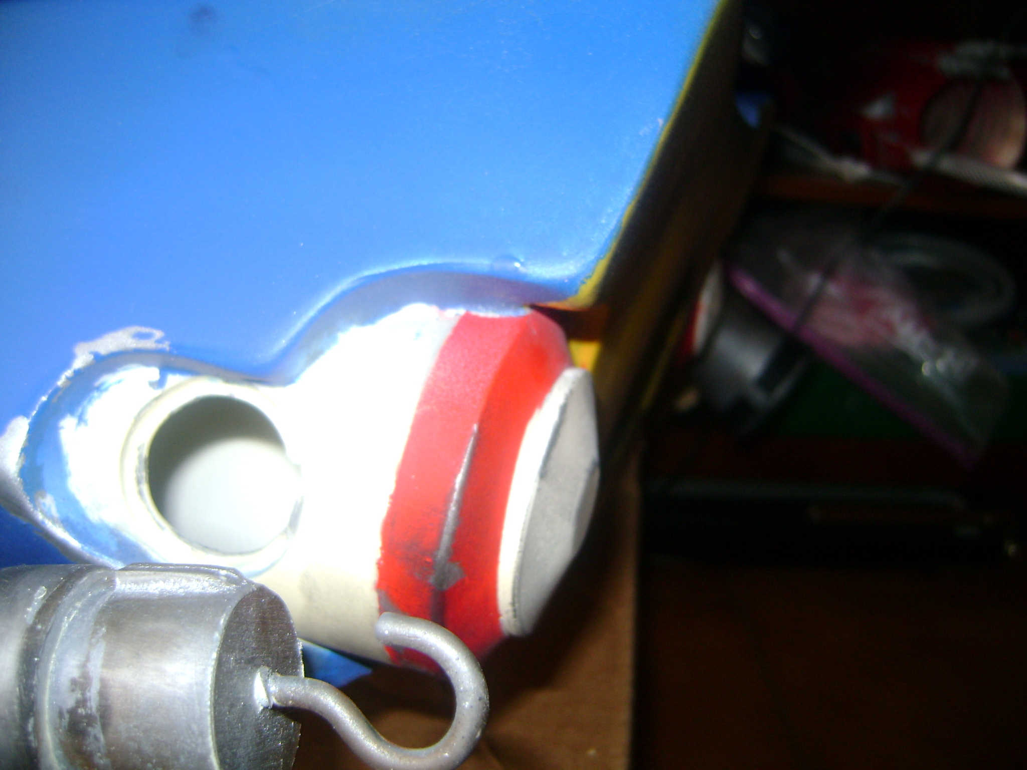

The bungee method for the thrusters, I'd like to lay claim to this method because that's how I figured to attach mine, now I may not have been the first but I figured it out myself lol.
You'll drill holes to insert your thrusters to the jetpack, take 2 screw in hooks (like you'd hang a lamp or plant from the ceiling with) screw one into the end of each thuster insert, then just get a short bungee cord and hook it to each of the thrusters from the inside of the jet pack and viola! Done, thrusters will stay in place and still swivels and makes for easy breakdown when done.
As for the rocket , securely glue a long bolt to the bottom of the rocket, I drilled a small hole in my rocket and seated the bolt in the rocket about 1/2 inch. Drill a hole just big enough for the bolt/threaded rod on top of the jetpack where the rocket seats, use a washer and nut to screw on from the inside of the pack and done. I'll try and find the pics of my build from years back so you can see first hand. Hope it helps.
Here's the pics from my build 4 years ago, i didnt have any for the rocket, if I get the chance Ill take a few, here's the bungee thruster, I was using a big bungee rubber band thing at the time, but I think an actual bungee with the hooks on the ends works best.

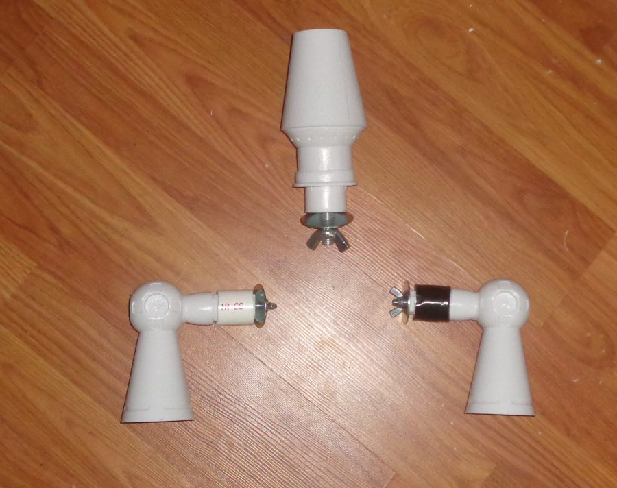

I got my attachments done for the rocket and thrusters.
1/2" threaded rod and accompanying hard ware for rocket.
The thrusters got 1" PVC pipe spacers, 1 1/4" washers and 5/16th hardware all pressure fit only and holds tight. The thrusters can move if needed.
Lynn

I just stuck regular eyelets in mine and found out it hit the body of the pack on the pack lol. Your method looks like it will be my next move
Yeah, it is a tight fit even with this set up, but I attach it all loose so I can get the wing nut on, push it all together when wing nut is on, and it tightens right up nice and the thrusters can be positioned in needed.
