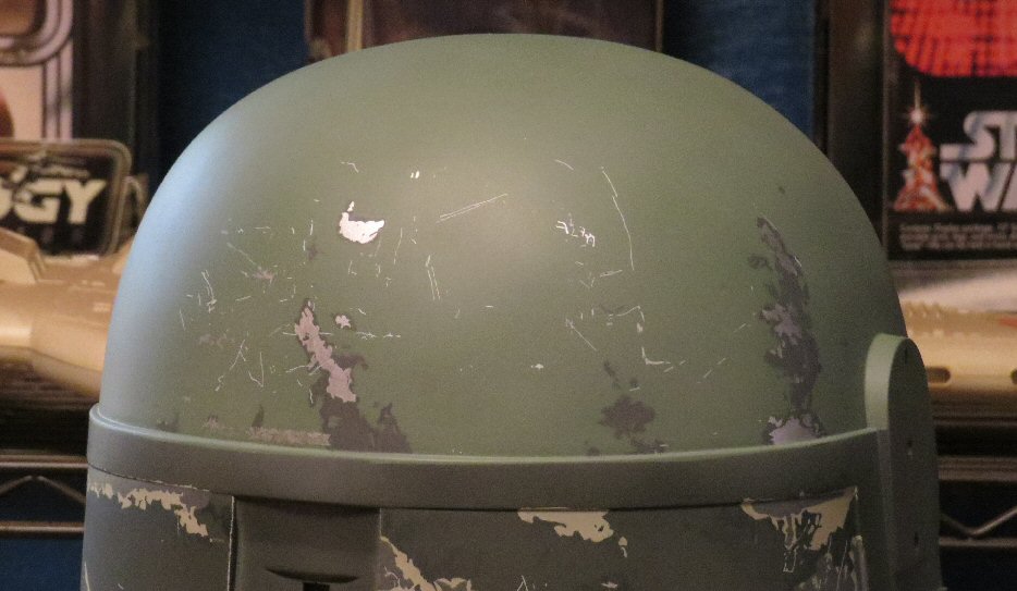

Using the weekend to good advantage! I got the dome base coated and airbrushed on the first weathering layer.
Then I began doing the damage. I've gotten a good amount done, just didn't stop to take pics in between. But I'll
play catch up now.
Here's the back of the dome. This area has a network of really fine scratches. I use a combination of silver laid down
with a very small detail brush (20/0) and physical scratches.
Moving around a little bit, here's another angle of those fine scratches.
This is the "stack" behind the RF ear. Again, a few more physical scratches here, but not nearly so many.
Jumping over the RF ear arch, we come to the cat scratch region. This is always one of my favorite details to paint!
It's probably one of the more recognizable features of the ESB bucket.
