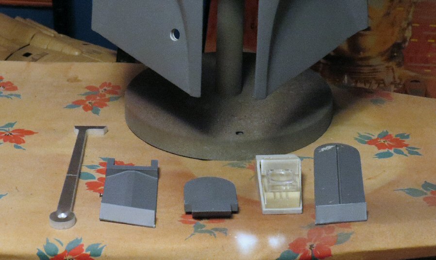

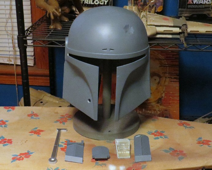

I'm beginning another ESB commission for our very own Rnbuda. It's a beautiful FPH2 helmet, which I've painted several of, and here
are just a couple of shots of the kit. I received it with some of the prep already done, but I spent some time on it thinning the visor
opening a little more, drilling out the holes in the ear platforms, and making an opening in the cheek for the Borden connector.
The helmet was shipped with a visor, but it's not shown in these pics.

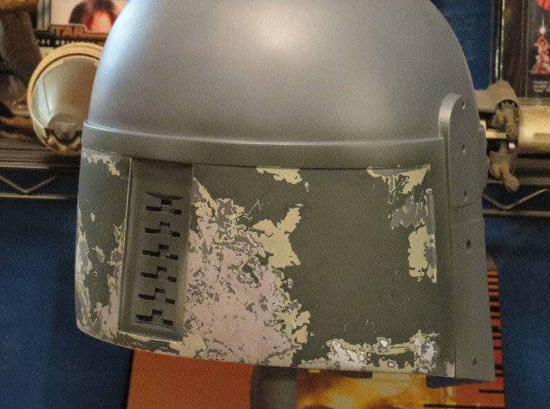

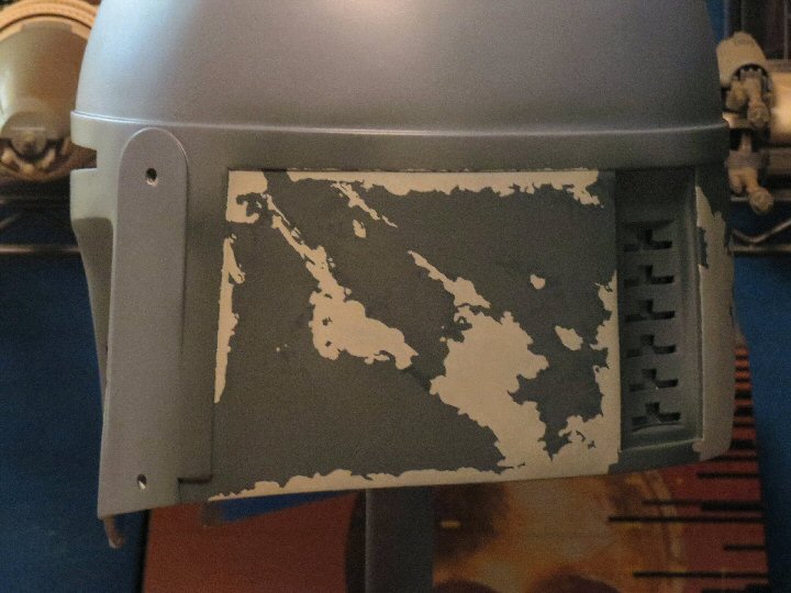

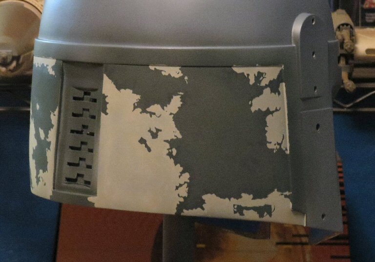

Back panels are well underway. I did the Concrete late last night, and everything was nice and dry this morning.
I stenciled on the damage, then used my Winsor & Newton masking fluid. I airbrushed on the dark green in a medium
translucent layer first, then went back to darken certain areas according to the reference pics.
After removing the liquid mask, I went back with a small brush to tweak the edges of the damage areas where needed. There's always
a few touch ups I like to do. I also added some patches of the dark green where it appears a little more uneven in the reference shots.
I use the same green to do this, but applying it with a brush gives it a denser appearance, so it winds up looking just a hair darker.
Now that this is done, I can begin with the gray and silver damage. :)

It looks like some parts are missing in the picture besides the visor. Was everything included?
In short, no. The upper RF ear "base" and the Borden weren't there. I let Rnbuda know the day the helmet arrived and the parts are
supposed to be heading my way soon. It won't impede my progress at this stage.

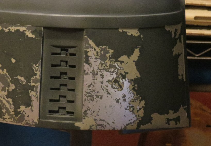

For the physical scratching, I use an old dental tool that I filed into a sharp point. It has kind of a tiny hook at the end so I can see very clearly where the tool is contacting the surface.
By varying the pressure, I can get very "bright" scratches, or "dull" faded looking scratches.
Several sessions later. . .

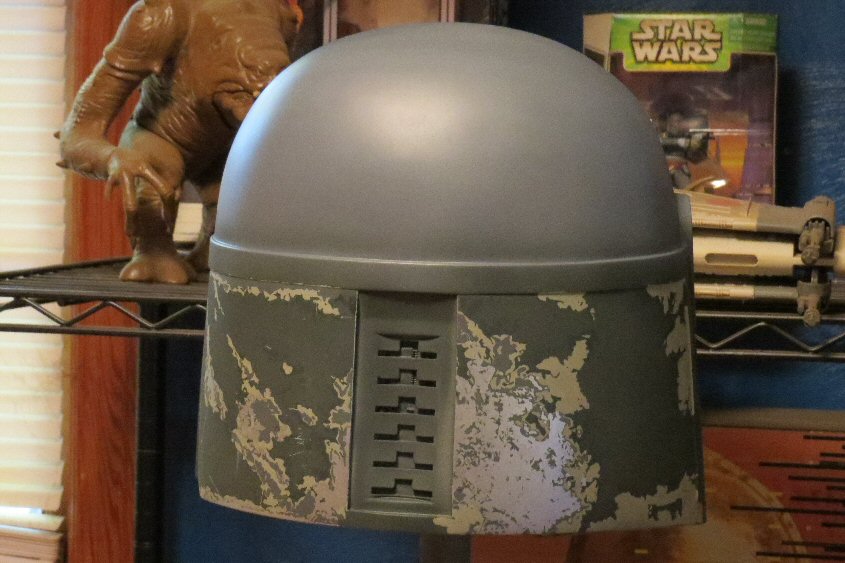

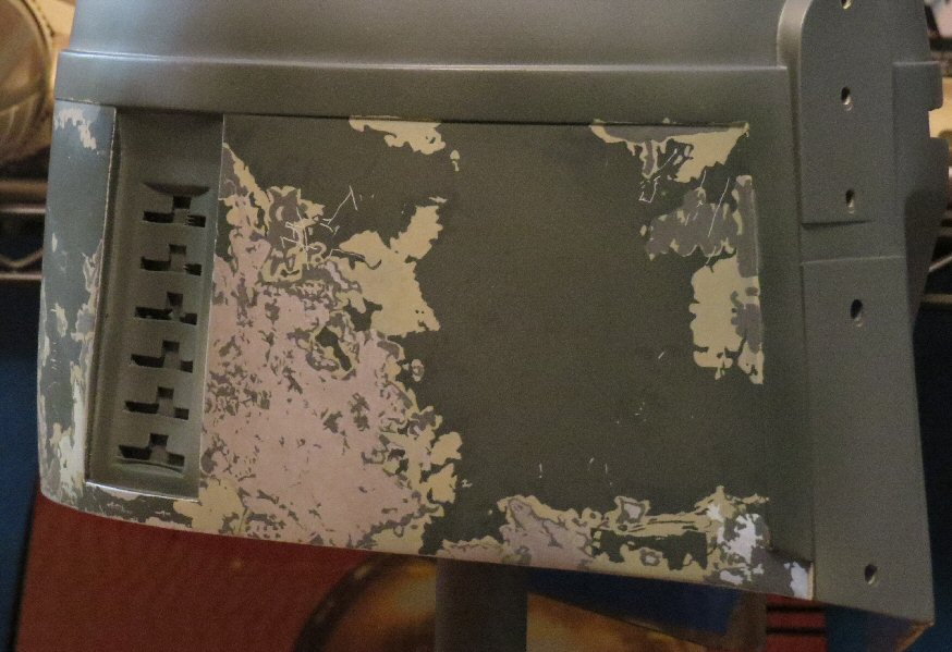

I got the big damage area done on the right panel. This is such a relatively small percentage of the whole paint job, but it's
really detail intensive! Here's an overall pic.

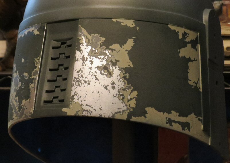

A closer view shows some of the tiny chips and scratches within and around the silver.
Here's a different angle to show the contrast with the silver a little more.

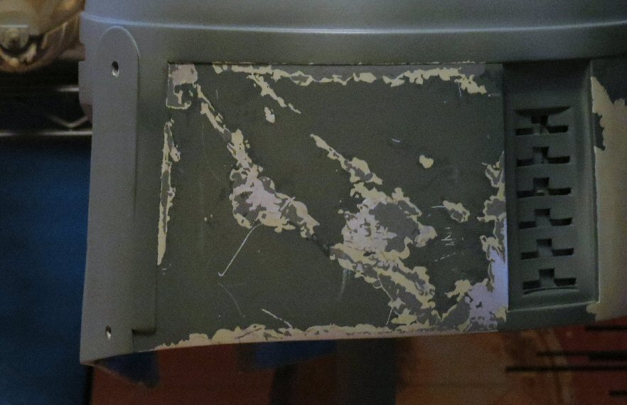

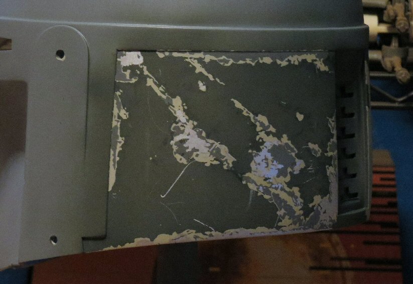

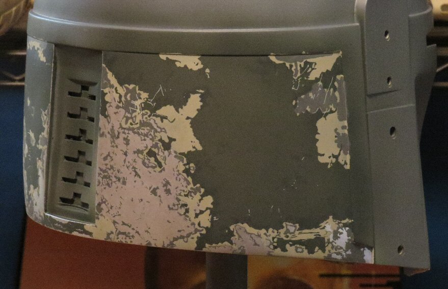

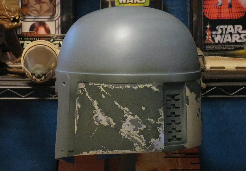

The rear panels are all done now. I finished the rest of the right panel this morning.
Doing the rest of it took less time than just doing the big scrape! An overall look.
A couple of closer angles showing the damage and physical scratching.
This will all get masked off and I'll lay down the base color and first weathering pass on the dome and cheeks.
