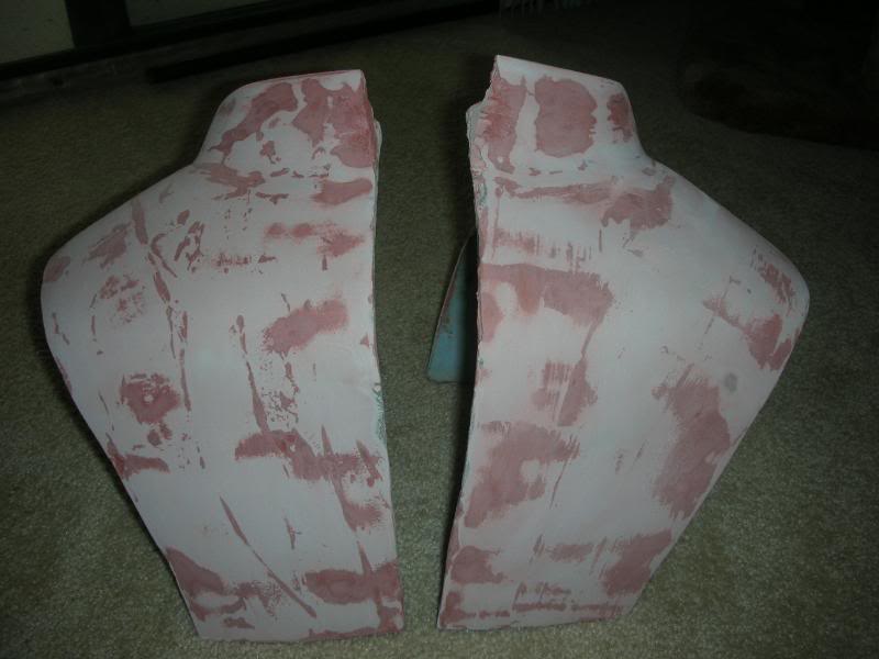

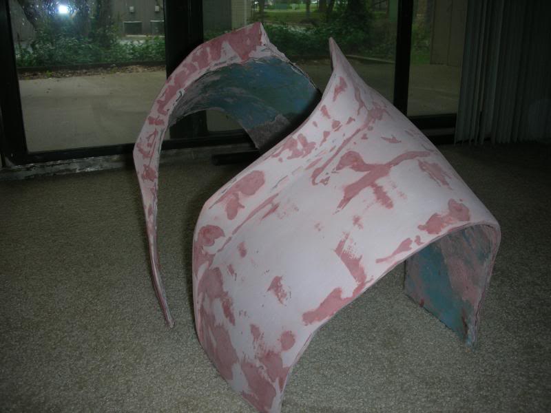

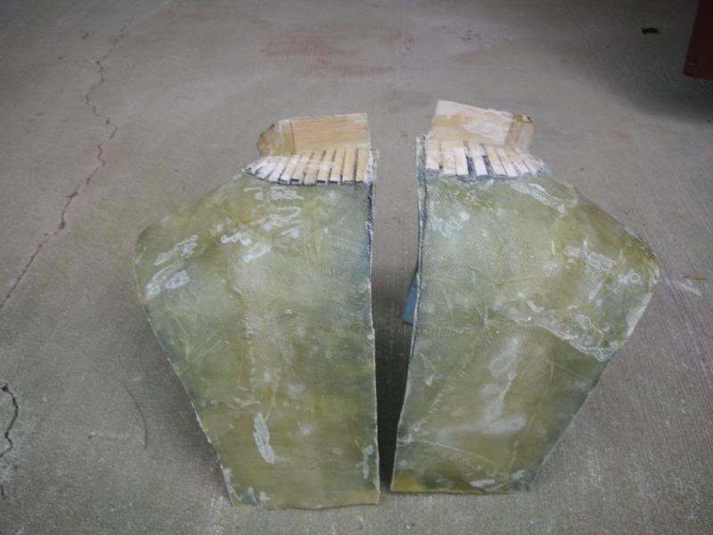

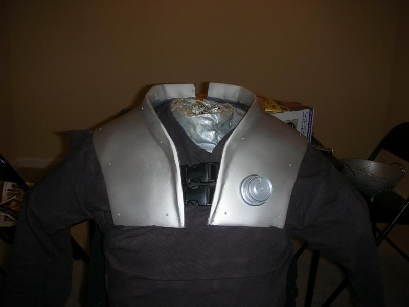

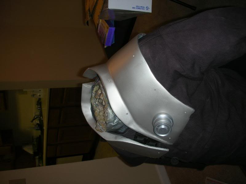

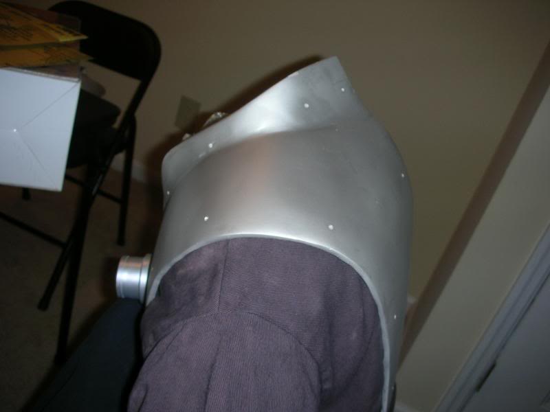

Collar

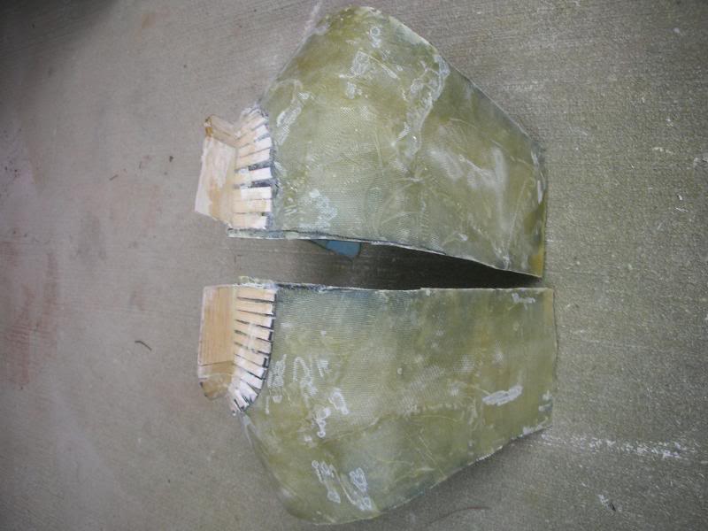

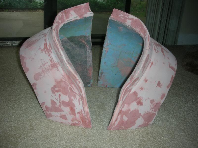

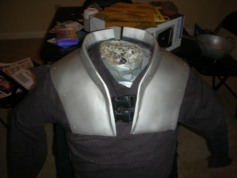

Like before I used a ducttape manaquin and posterborad to form the base and layered it with fiberglass. to get the correct collar shape, I built up a frame with balsa and then filled it with bondo. the holes were made with a dremmel attachment. after two weeks of sanding it was painted nickle. I will weather it like before with acrylic paint anf flat black spay paint when I get a chance.

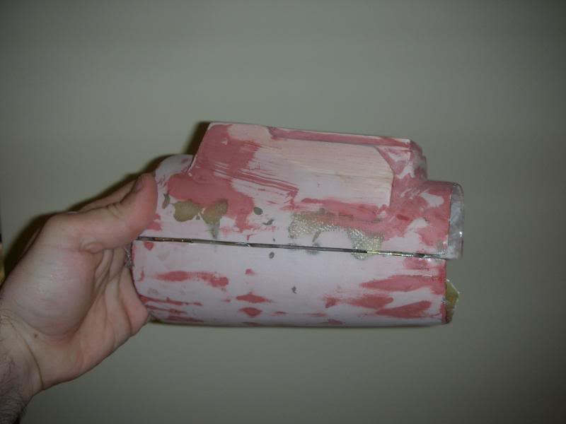

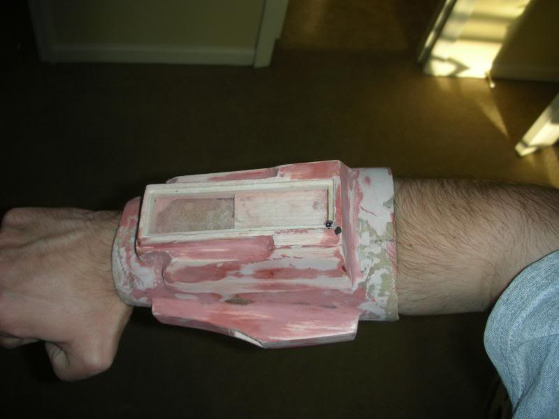

Gauntlet
Prettmuch the same as before with little improvements. One in particular is now the gauntlet hindges like a Fett gauntlet.

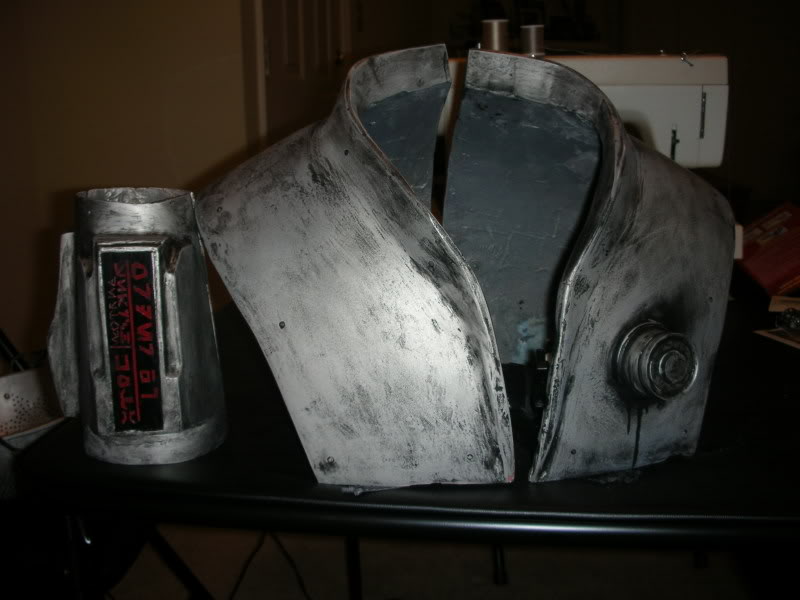

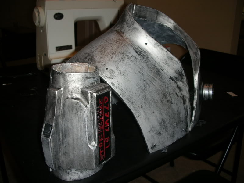

Here are some updates of the armor now painted and weathered
Im looking for advise on making fray-free wraps if anybody has tips..
Thank you. I actually got it to look like this by acident. I layered black acrylic paint on it, but it looked a bit to dirty so I started to sand it with 400 grit sandpaper. It really gave it the worn, scratched look of the in game model.
