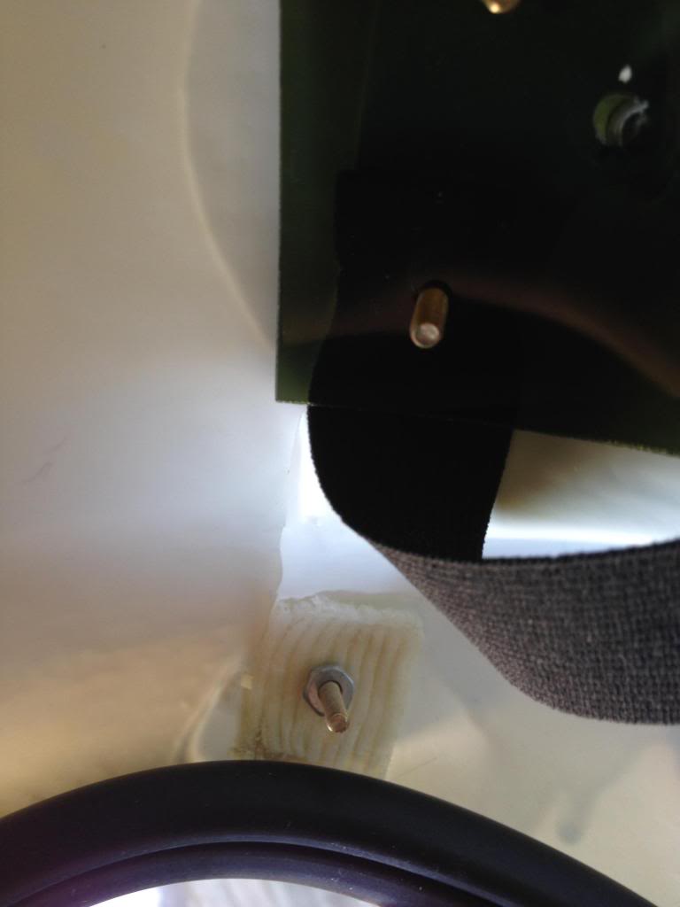

I actually cracked a GINO styrene helmet on the chin one time and asked around on FISD... This is what I did... there is "poor mans fiberglass" take an old undershirt and rip off a piece, soak it in super glue and put it on the inside. to re-enforce it then a bit of automotive Bondo (the red kind comes in a smaller tube.) sand the Bondo and repaint the entire helmet. good (Accurate) paint to use is the Krylon gloss white (that was a recommendation from Gino). It does yellow a bit over time but that's how they are.

hey sorry it took so long, I wasn't replying from home before.. I was mistaken about where the crack was.. I was lucky enough for it to crack right where the bottom most screw was on the ear cap (under the ear cap).. It was fixed and reinforced with a wife beater (tshirt) and some superglue. after it dried it was strong enough to drill a new hole into and re attach the bottom part of the ear cap...
I didnt use fiberglass epoxy, but as long as it can soak into the fabric like superglue, i would say its worth a try.
