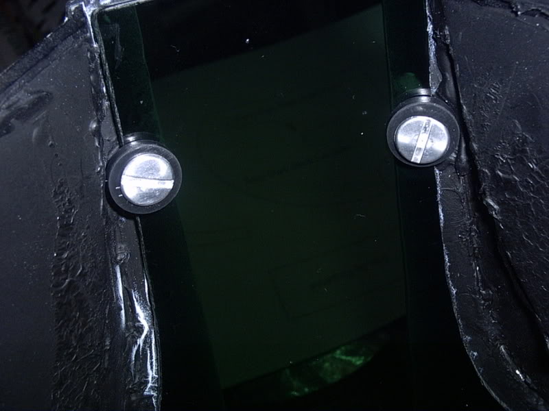

To mount the chicago screws on the inside of my styrene helmet, I used a two part epoxy. I got it in the automotive section of Canadian Tire ( check places like Pep Boys down in the States ).
It's the type that's in a two-sided syringe. Just make sure that you add it to both the back side of the screw half you're attaching, then liberally over the front to fully seal it. ( the black spacers are just that... spacers )
