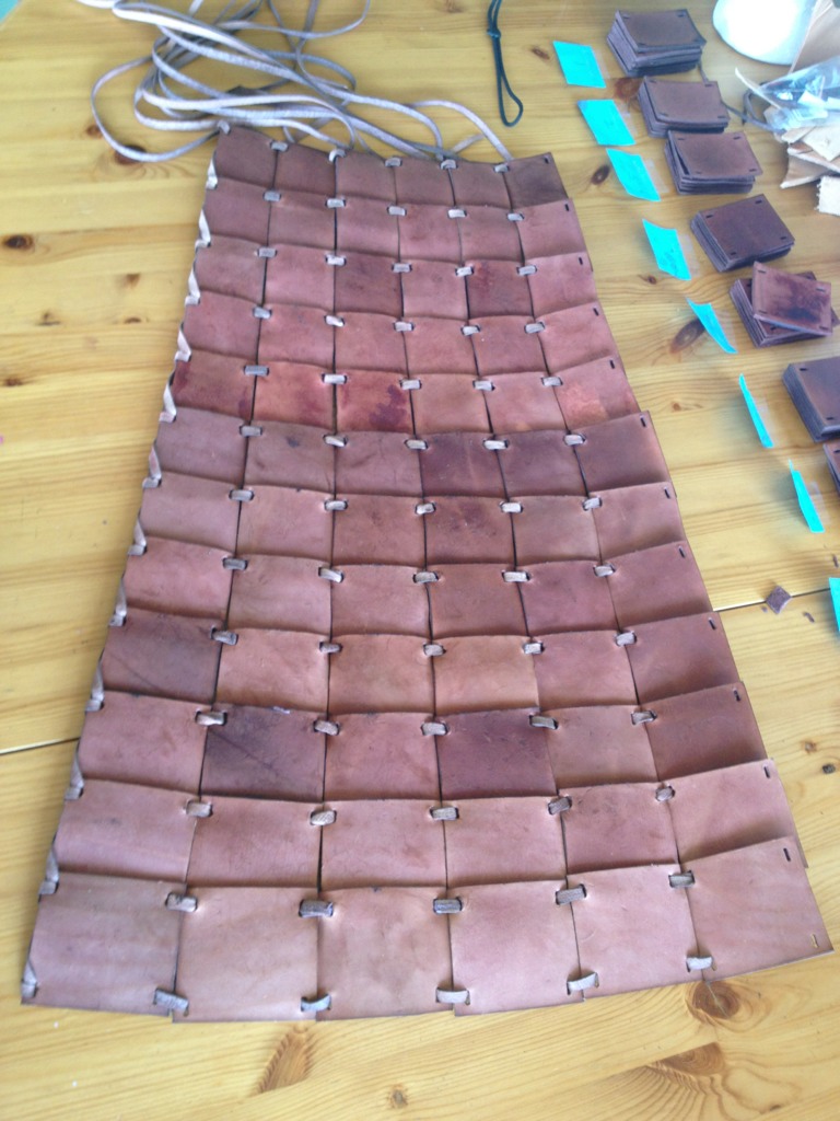

Today I cut up a double shoulder piece of 6oz leather to make the skirt. I used a tool for creating lacing, but I set the width to be the length each square will be, to make strips. I then cut one piece right side up and the next upside down (as each piece isn't exactly square). I hope this makes sense? The pattern I had said the skirt should be 27.5" long, however on me that'd be half way down my shins. Judging on the known height of Leeanna Walsman and scaled to me, the skirt should hang 24". I had just enough leather with enough to test the dyes on.

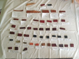

My local Tandy didn't have purple dye so I will have to mix my own. I'm glad I have plenty of scraps to test on! They also recommended water based dyes as they're more friendly to the environment.

Got my heavy duty hole punch today in the post. Looks like it'll do perfectly, it's 1/4" long and wide enough to take the two pieces of lacing that I'll need. Next step will be to punch 144x4 holes, then try the dying. I have enough scraps to test some mixtures out. The dye they recommended was water based and they didn't have purple, so I will have to mix my own purple to match. (red and blue ftw!)
Started the skirt: ImageUploadedByTapatalk1369132897.962396.jpg
The purple they do have isn't right at all. So don't worry about them not having it. Besides, you need all those different shades. I think you've done a fabulous job! It's no easy task to make this skirt, although I suppose it's more of a patience game than true difficulty. Can't wait to see your progress on this gear!

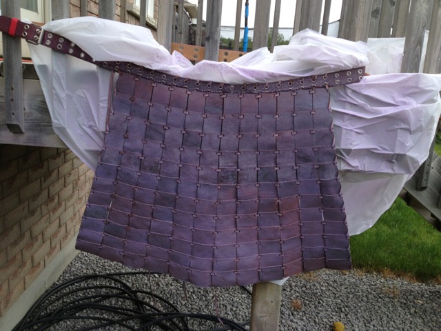

So I wasn't happy with the overall colour of the skirt when I put it together, so I spoke to a friend who is a leather costume expert and he suggested a watered down application of acrylic paint. After some experimentation and a few passes with a paint gun, I am much happier with the results.
Before
After
From the pictures I'd say that the first one looked better, but pictures can lie. And it also depends on the color of your undersuit. Those colors have to fit to get the correct overall look.
So here's the thing. The costume that has been on display at various shows and Celebrations is badly colour faded. I'm certain the one in the official pictures released by Lucas are colour touched, however I think that's the way the costume designer wanted it to look. I'm shooting along the lines of that colour scheme. Honestly the skirt looked completely wrong before I painted it.
Fading color is a natural process in Zam's leather parts. So don't worry about that.
Skirt looks good. I think it was the best piece in the whole costume to make. :)
Thank you :) I know fading is natural, but that's not the way the costume designers envisioned her in the movie. I'm going to do my best to keep the colours proper. It took me 12 hours in totato stitch that skirt together. I'm quite pleased how it turned out.
