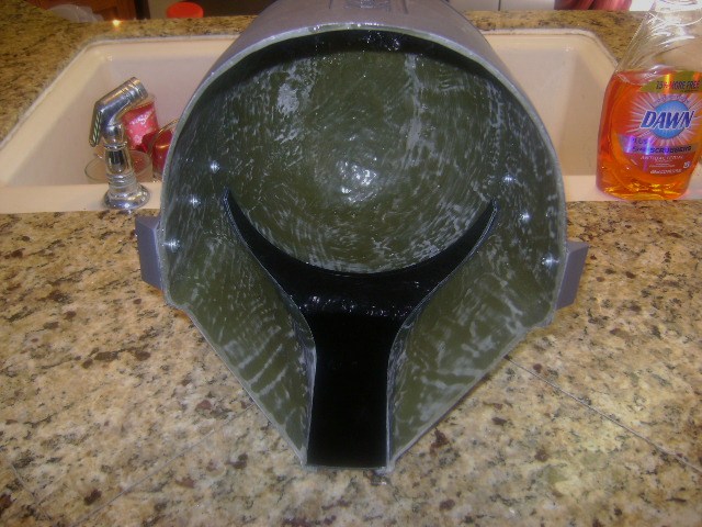

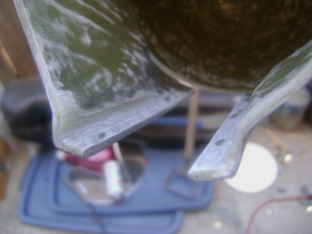

First I cut channels on each side of the helmet with this bit. Once the channels are cut, I usually go back over the channels with some 120 grit or so sandpaper to smooth out the channels...

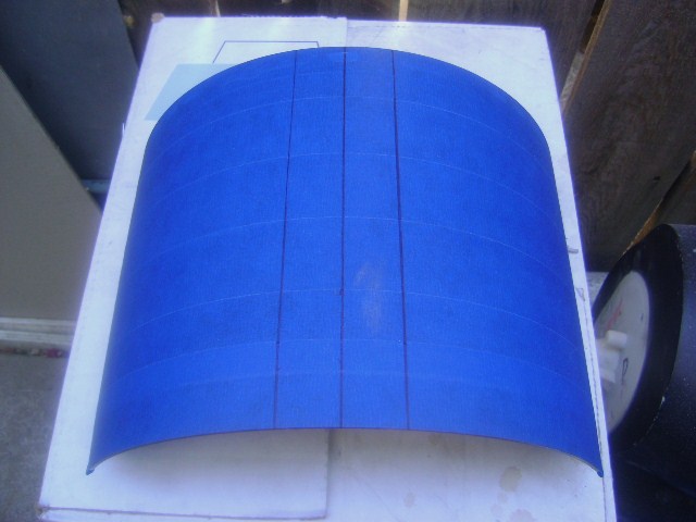

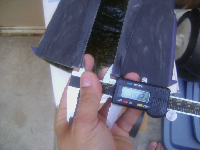

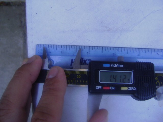

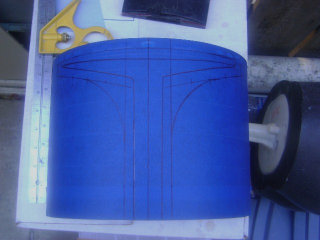

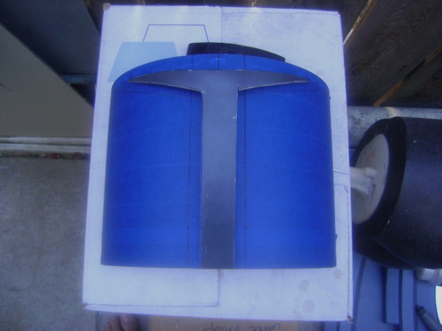

Next, I measure the width I'll need for the visor area on the helmet (I add 1/4" to each side to account for the channel). I apply blue painters tape (cleaner release) to the front of the welding visor, find the center line, trace the cut out visor area on the tape, and start marking for a symetrical visor. I usually leave about a 1/2" lip around the traced shape...

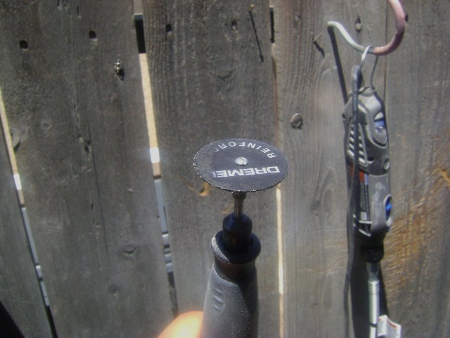

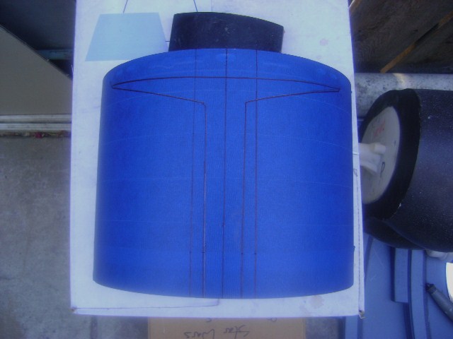

Then I start cutting out the visor with a cut off wheel and the Dremel set at a low RPM speed that almost seems like it will stop if pressed too hard. A higher setting melts the visor material quickly and creates more burrs. I make an initial channel with a first pass and then finish up and cut through with a second pass. I then carefully sand off the burrs with some 120 grit...

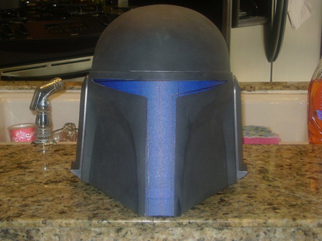

Now I have a perfectly fitted visor that is ready for glue-in installation, or I can drill out some holes for a removable visor installation using t-nuts, bolts, and acorn nuts...but that's a different tutorial!
