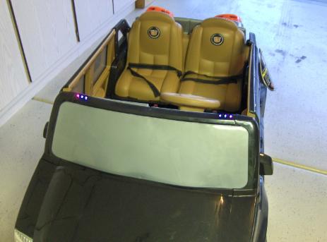

One of my projects I wanted to finish was modifying my son's Power Wheels Escalade so that it had police lights and sirens. I finally finished and wanted to share. My son was a bit traumatized when he saw it in pieces, but he loves it now.

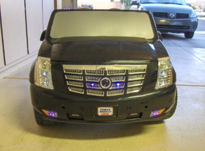

I used a total of 20 flashing red/blue LEDs and 4 flashing white LEDs. I have transistors on the LEDs so I could run everything off one 9V battery. I also wired in a police siren with 4 different tones that I got from a hobby store.

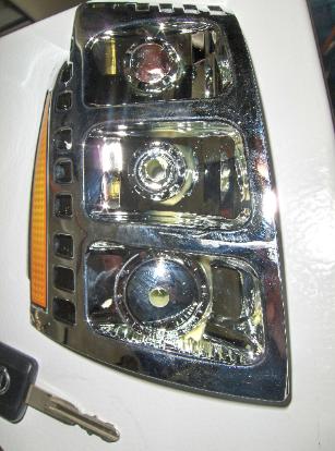

First off was drilling out the headlights for the two white flashing LEDs.
Then I added flashing red and blue LEDs to the bottom facia.

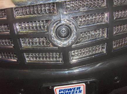

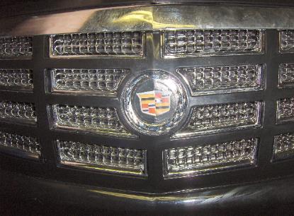

Removed the center Cadillac symbol and mounted the speaker.

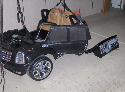

Drilled out two holes on the dash for control buttons, one for the lights and one for the siren.
I think when he saw this he started to worry (he's only 3 and half years old).

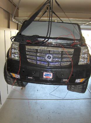

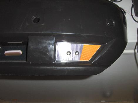

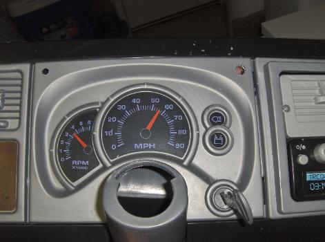

I bought this canoe hoist so that we could still get both cars in the garage and keep the truck off the floor, but it also came in handy when I started running the wire underneath. Best $35 I ever spent, it holds up to 125 lbs (the truck weighs 95).
Pictures don't do the LEDs justice.
