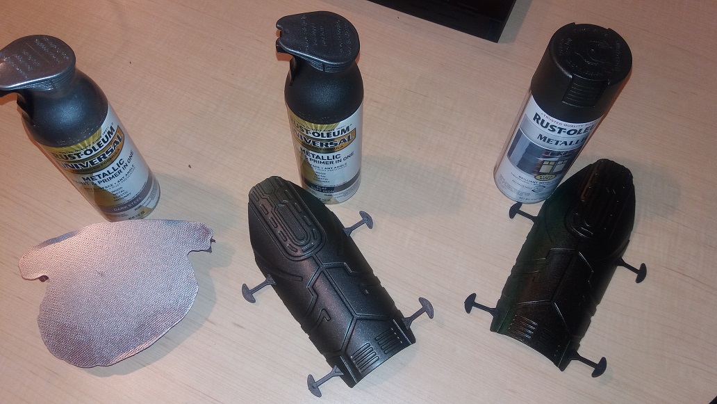

I'm 3d printing my helmet now, should be done this week. Next step is to identify the proper paint color and brand of paint to use.
I do have a full set of air brushing gear but have never taken the time to learn how to use it. If I can find a rattle can that is a good match on color I'll keep it simple and go that route.
These 3 cans came from the local Menards. The metallic paint is about double the cost of the standard stuff. I will spray on some test coats tonight and tomorrow and get some screenshots up for people to see the differences.
Terrible lighting there, let me get some test coats on some scrap PLA and we'll see what it looks like. If neither are quite right I may try mixing the two on the right together and then airbrushing the combined paint.
spyder918 - you are right about those style spray cans, they are very different from a normal rattle can, less aerosol feeling and more of a spray bottle/windex style if that makes any sense.
Image of the results is below, not sure if the lighting is enough to get a sense of what they looked like but the executive summary is that the "normal" can of paint was much too dark, almost dark bronze. Of the two metallic spray bottle styles, the "dark steel" is really more of a silver, and it looks very good but is too light straight out of the can. The "soft iron" looks closer to the tv show but is too dark right out of the can.
I used Rustoleum Chrome and got this affect. I had just sanded back a gray primer layer, so it hasn't been painted beneath. These images are right after being painted so it is still a bit wet (hence the 'dimple' look on close inspection)
I've since sanded it back, and am attempting a 'Charcoal Gray gloss' undercoat, with the same chrome on top. I'll report back with the results.

I'm still sanding and bondoing my main helmet but I don't want to leave you hanging so I ran a test today with a spare quarter panel. Pics below:
Just the rustoleum paint:
This was a scrap piece with a few layers of filler primer and some rough sanding done, nothing fancy. I think the colors look fantastic. The base silver looks really nice but way too shiny and new looking. The graphite really takes that shine down and gives it the gunmetal grey effect.
