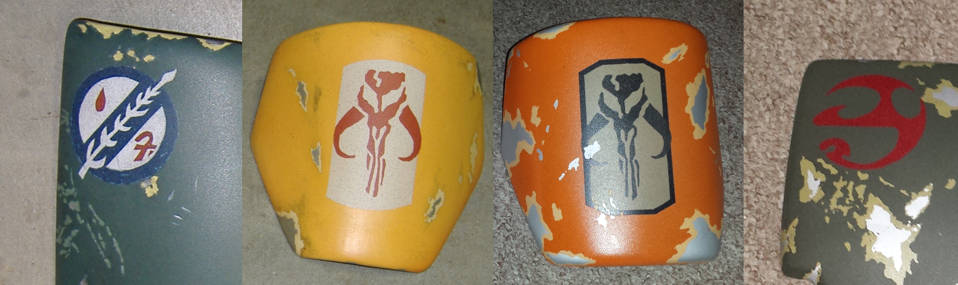

I have used Grafix Frisket Film which is a clear adhesive backed masking film that has a paper backing that peels off. It is very low tack so doesn't disturb the paint. I have gotten this at Hobby Lobby. But here is a link from online.
Grafix All-Purpose Frisket Film - BLICK art materials
You can print on the paper side which you peel off so will have to invert the image.
Then you will have to take a sharp Exacto knife & carefully cut out following the lines of the areas you want to paint. You will have to make different stencils & cut outs for different colors. This allows you to paint the colors in layers.
This works well for spray/airbrush painting.
Here are some examples of ones I have done.
