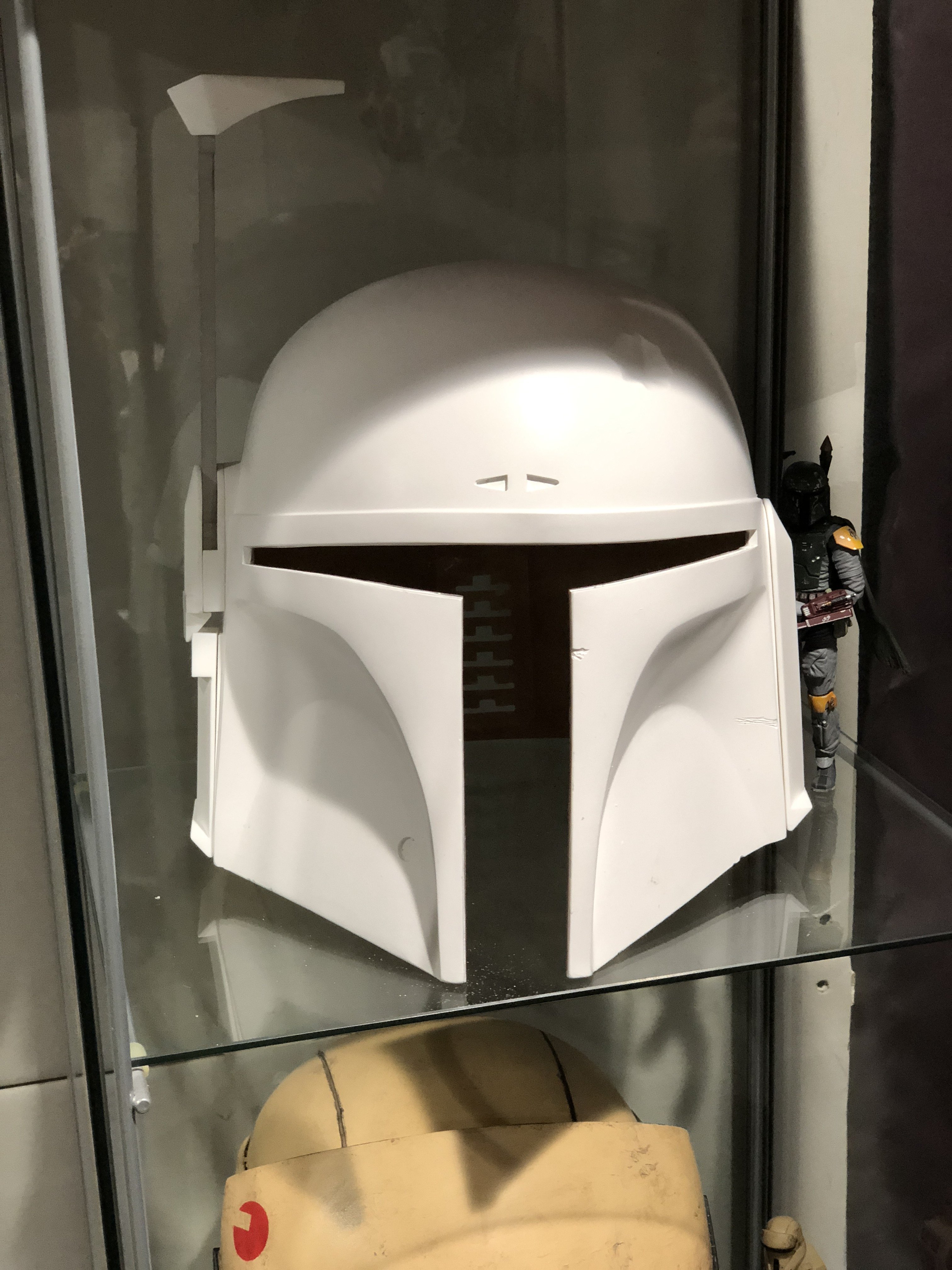

Have a closeup of the cracks? Not sure I'm seeing any.
CA superglue mixed with baby powder makes for a great spot filler though, use it all the time to repair micro-bubbles and stuff.

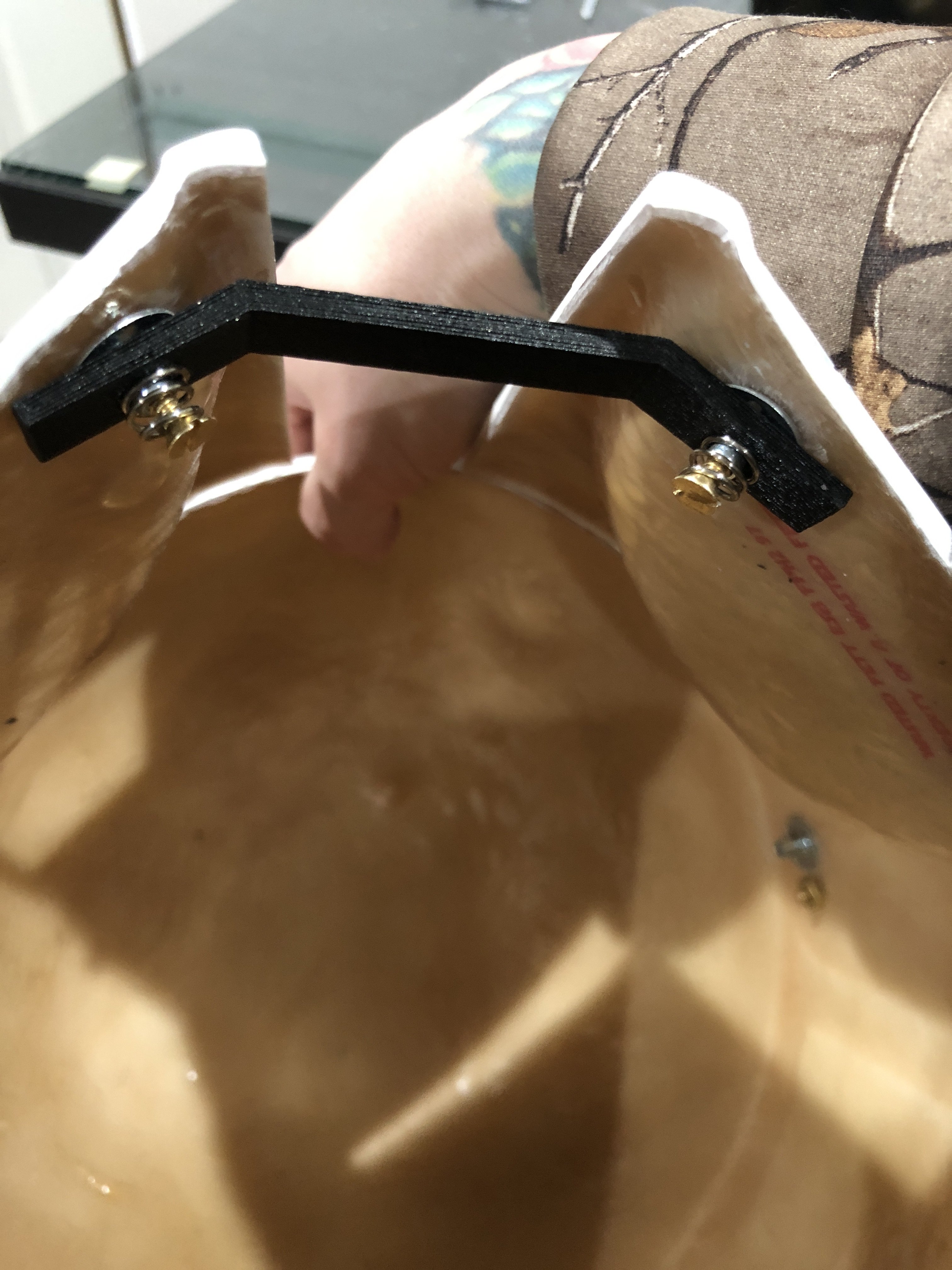

So to prevent further cracking, I modeled up a bracket and 3d printed it. Added two springs to put pressure on the bracket. That way it stays in place. The mandibles are now firm and do not flex when you pick the helmet up.
I will make it pretty later on when I’m designing the new visor clips.

Also, I'm not really seeing cracks either, but as stated above CA/superglue mixed with baby powder makes an excellent filler. I used it a ton on my BB-8 build.

Any tips on repairing cracks at the corner of the mandibles? Or will it be fine once the visor is installed?
hey sorry there was a crack, you can repair it by opening the crack with a dremel and filling it with a mix of polyester and micro balloons. or, fill it in with Home Depot poly resin. Or fill it in with crazy glue and baking soda. message me if you want.
The cracks are barely visible until you put a small bit of pressure on either mandible then you can see them. When the mandibles flex, the crack is visible in the gelcoat. Since installing that 3d printed brace on the lower part of the mandibles, I no longer see the cracks. so I think that brace is going to help keep it from getting worse.

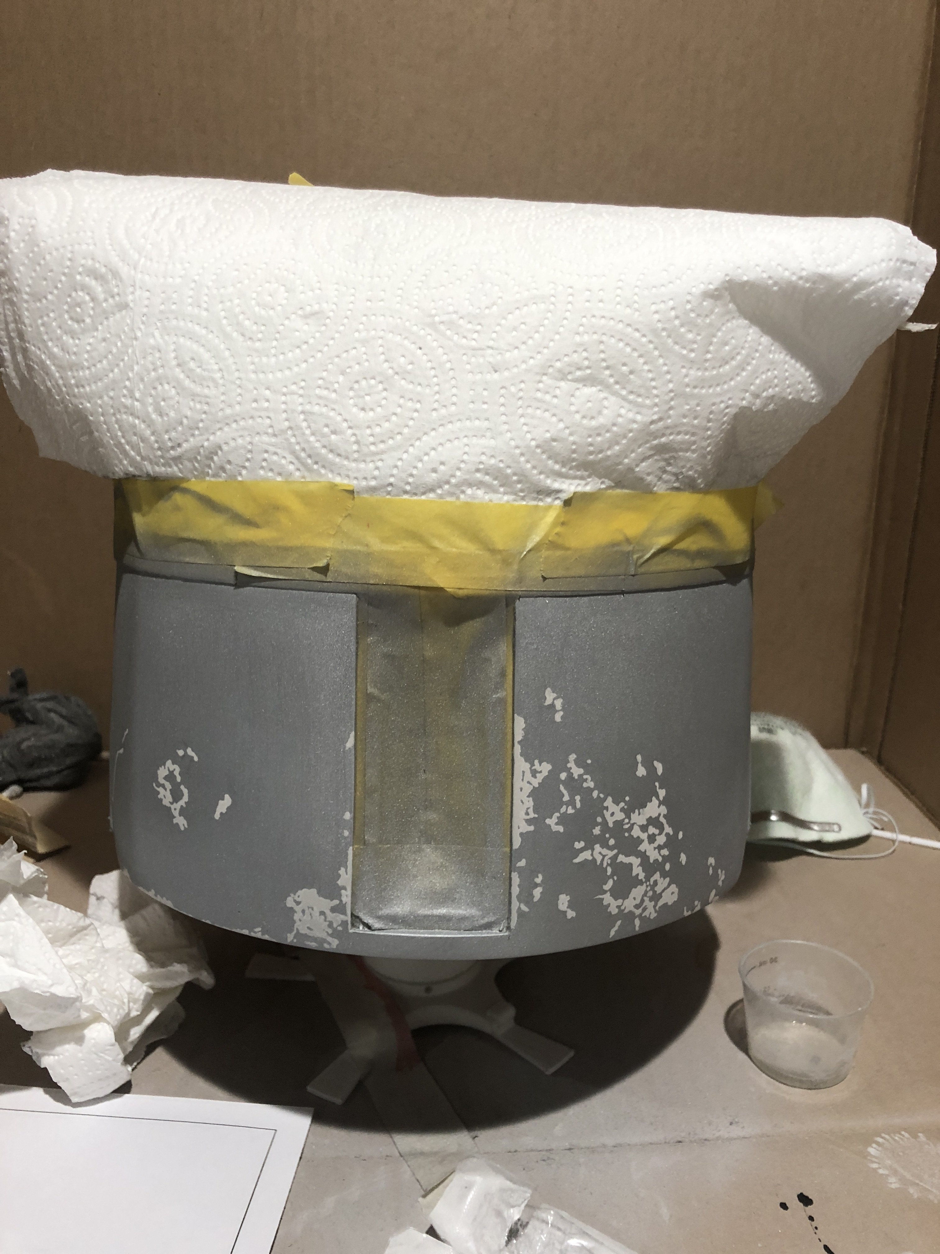

Finally got some time to start painting my helmet. I’m new to airbrushing so I’ve been learning as I go. The base grey. 147 I think it was, gave me troubles. But I think I worked through them finally. Masked off the base grey on the back panels and sprayed metallic silver #11. I peeled all the maskol off to make sure I was doing everything correctly when it comes to masking. (Probably shouldn’t have done that) but now I’m ready to mask the silver and base grey again.

I would wait at least 12 hours, I know many who would recommend 24 or 48. Depends on how safe you want to play it.

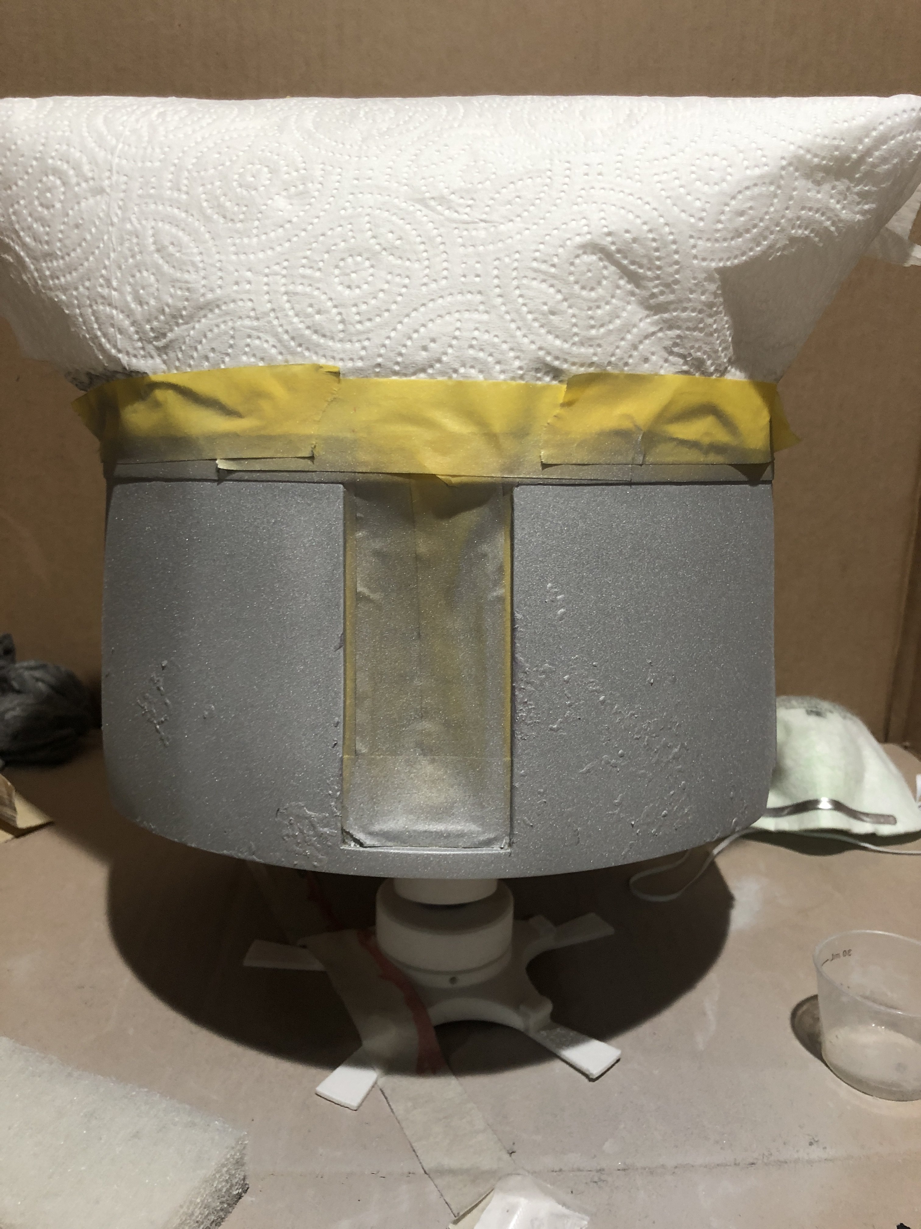

So I got impatient and decided to keep going after letting the silver dry for 3 or 4 hrs.

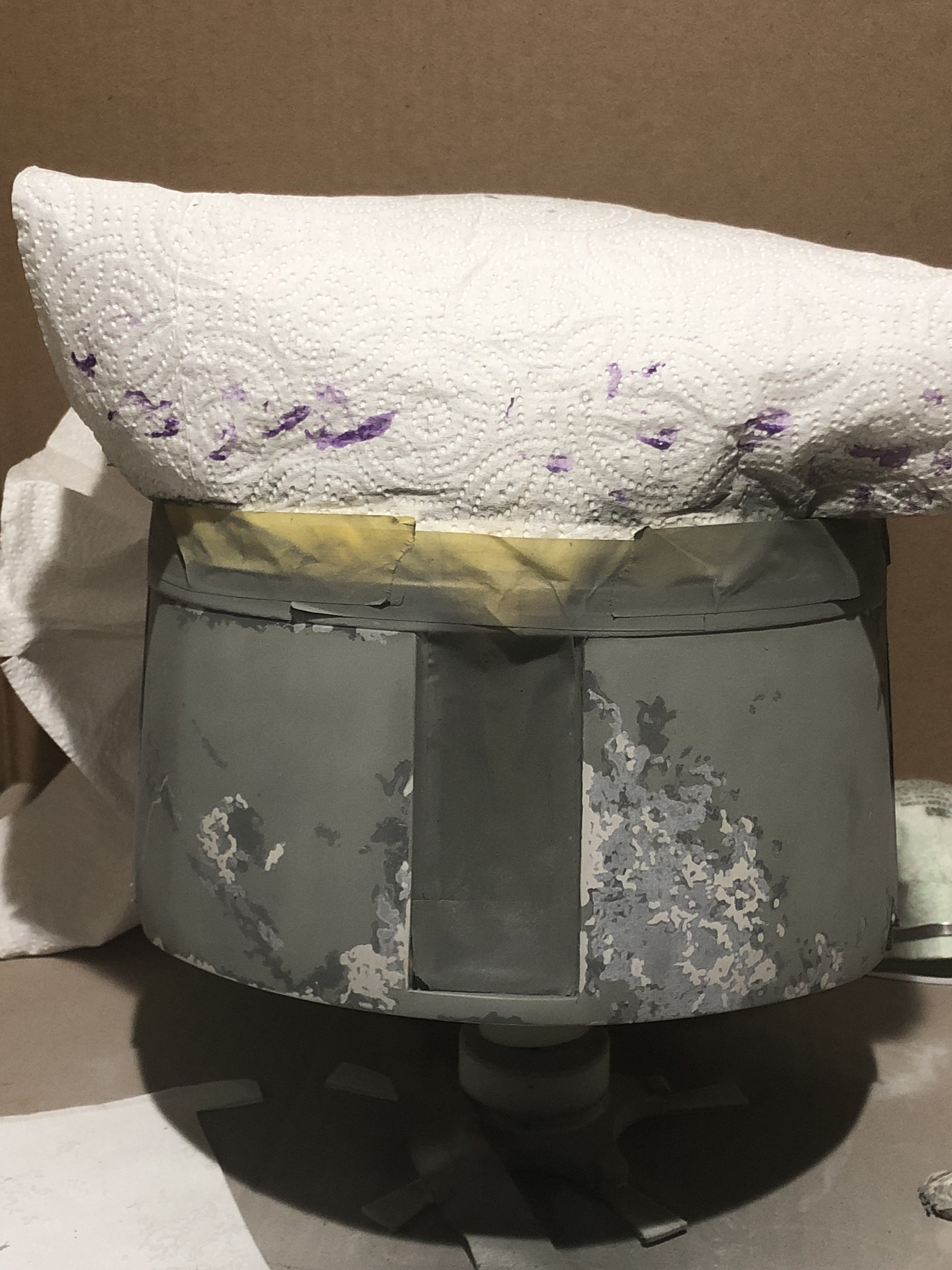

Didn’t have any reactions with the paints. So that’s good. Put down the dark gray #79. Masked it all. Then laid down a coat of the light sea gray. Let it dry about 30 minutes and peeled off the masking. Comparing it to the stencils color sheets and it’s pretty close. I am liking the contrast with the other colors. I will probably mask this tomorrow afternoon and then spray the green. What does everyone think. Definitely different from the terminal fettler guide I’m following, but I think it resembles the real color better.
This morning while staring at my helmet, I decided I was not happy with the current results. I also couldn't get the white Saral transfer paper marks to come off at all. I tried an eraser, tried soap and water and even tried a kneaded eraser. Nothing would remove them. It just looked bad, plus the light sea gray was bothering me a bit. So I stripped the paint. Thats what I get for being impatient. lol
I will clean it up and then start the painting over, this time I will paint each layer and let it dry 48 hrs before I apply the Saral transfer marks, and next paint layer.

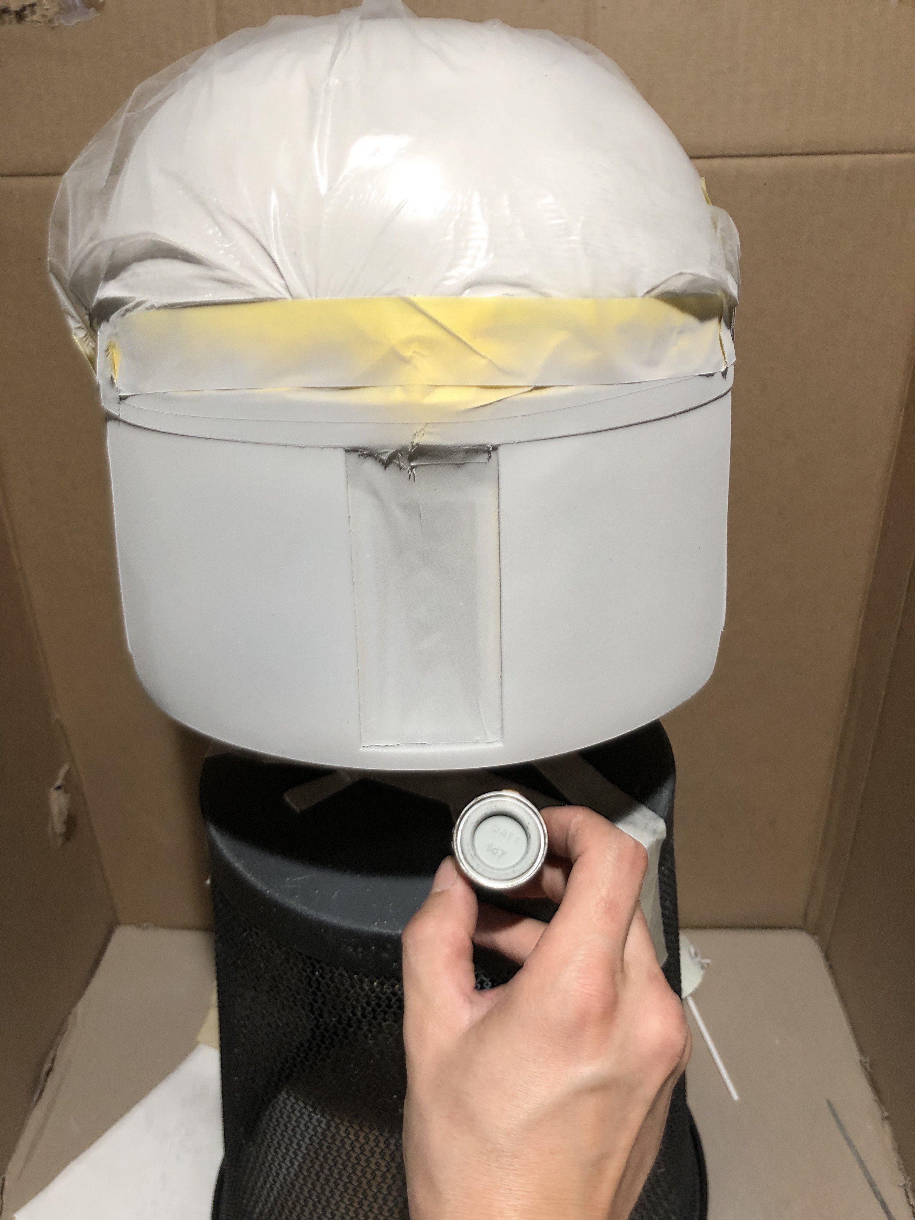

Ok so I stripped the paint layers off. Wet sanded and then primed. Let that dry two days and today I put two layers of the Matt light gray #147 on the back panels. It matches the lid of the paint very well. I will let this dry a few days then use steel wool to smooth it out and apply my stencil and maskol.
Taking my time now. Don’t want to mess this up anymore. I’m also getting the hang of this airbrushing. It’s so fun.
If you look at the dome in the picture that’s also Matt light gray #147, but it appears almost white compared to the back panels. I think that’s because of not using a primer first. So I’ll be redoing those as I go.
