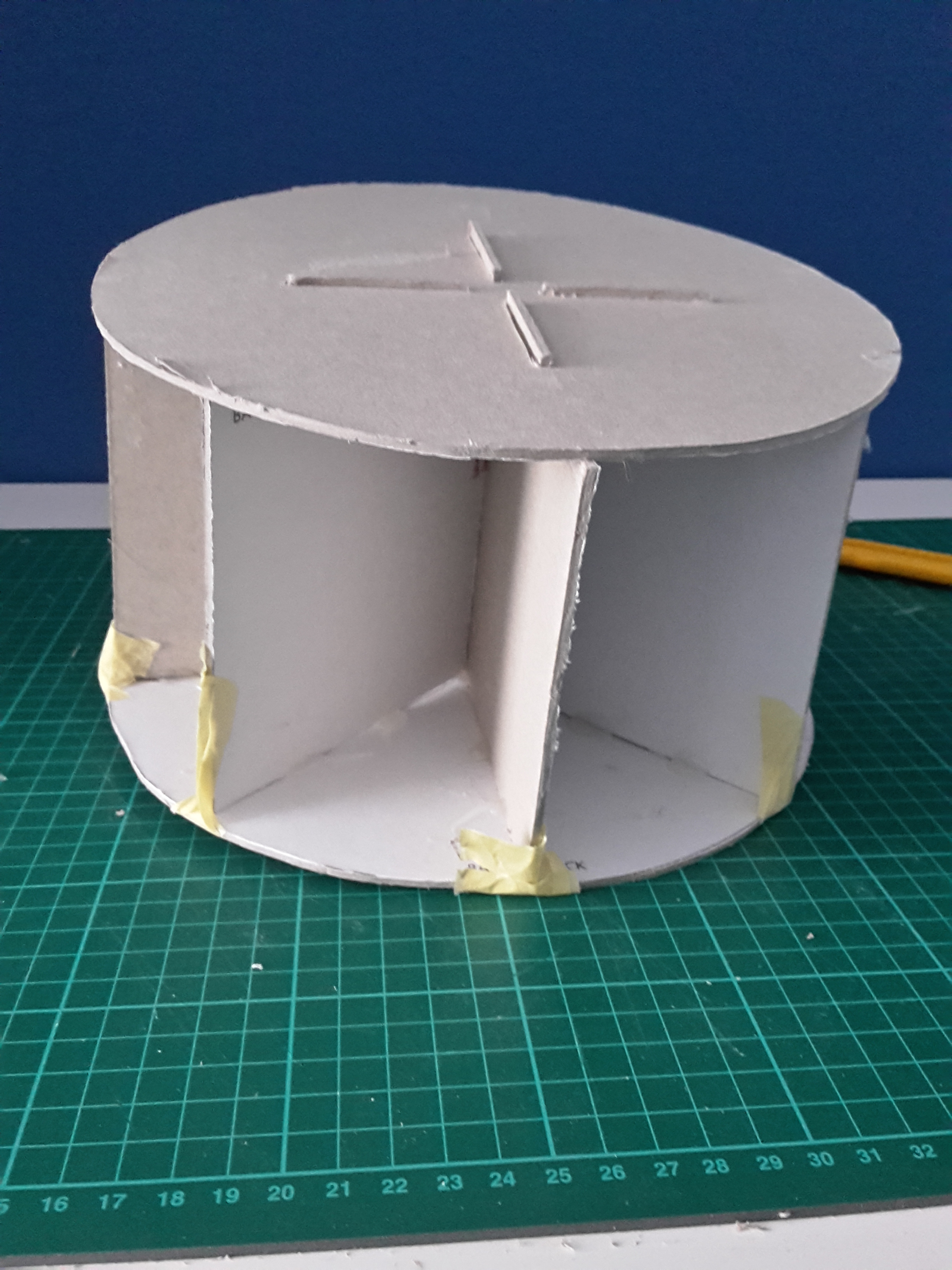

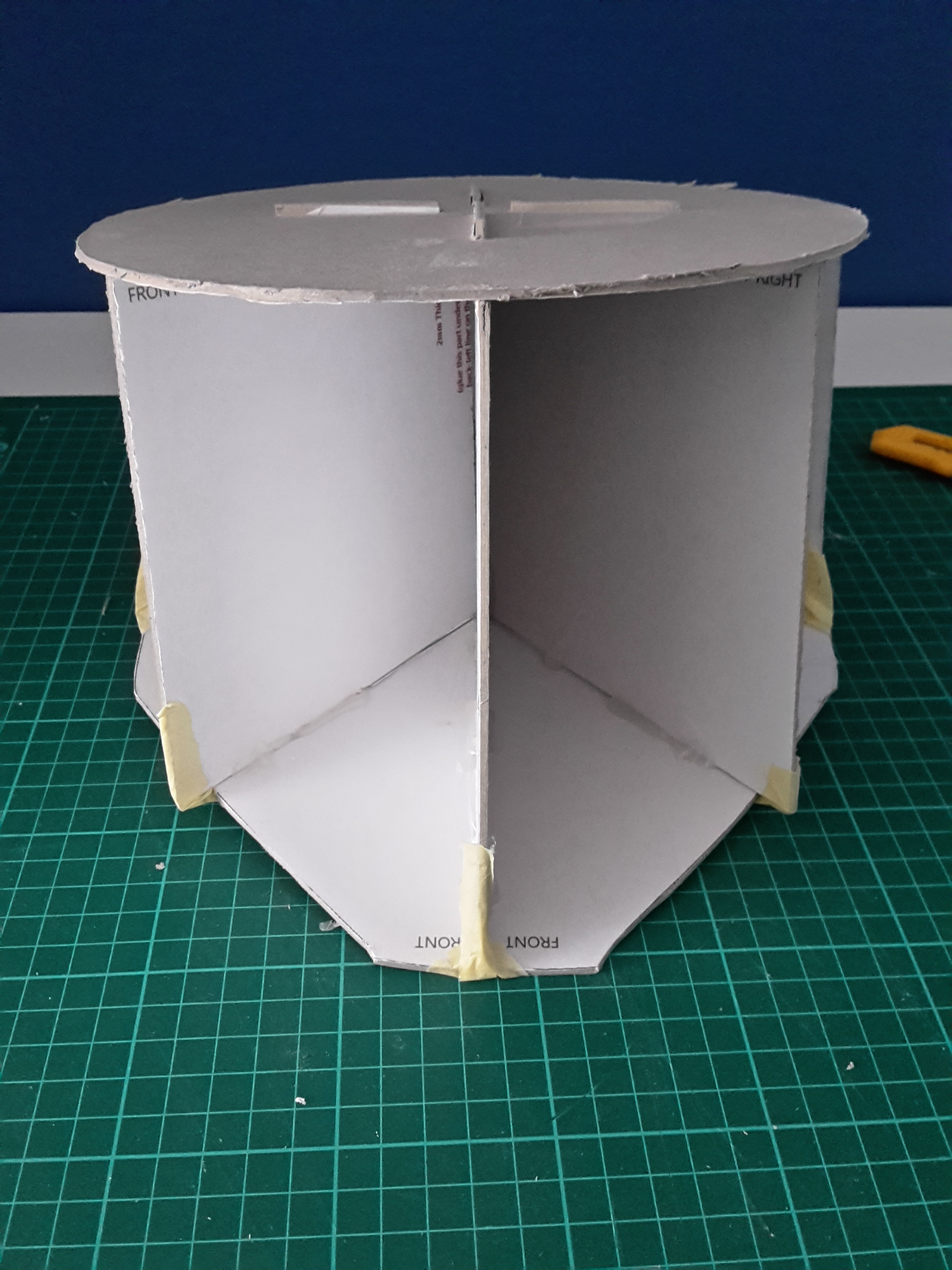

I've finally started building! (only took 4 months -_-) Quick question about the inner support. I some how managed to flip the support left and right (using Rafals template) so the left support is on the right, and vice versa. It doesn't look like it really matters, but was just wondering if it actually does?
will post a pic tomorrow when glue has dried, but not that exciting...we've all seen the inner support before.
One way tell if you're way off is 2 print 2 copies, cut both out & then flip one over and see how the edges align. I'm not sure if there is a huge difference as far as supports are concerned. The important thing is the angle...I ended up adding a little more to mine anyway.

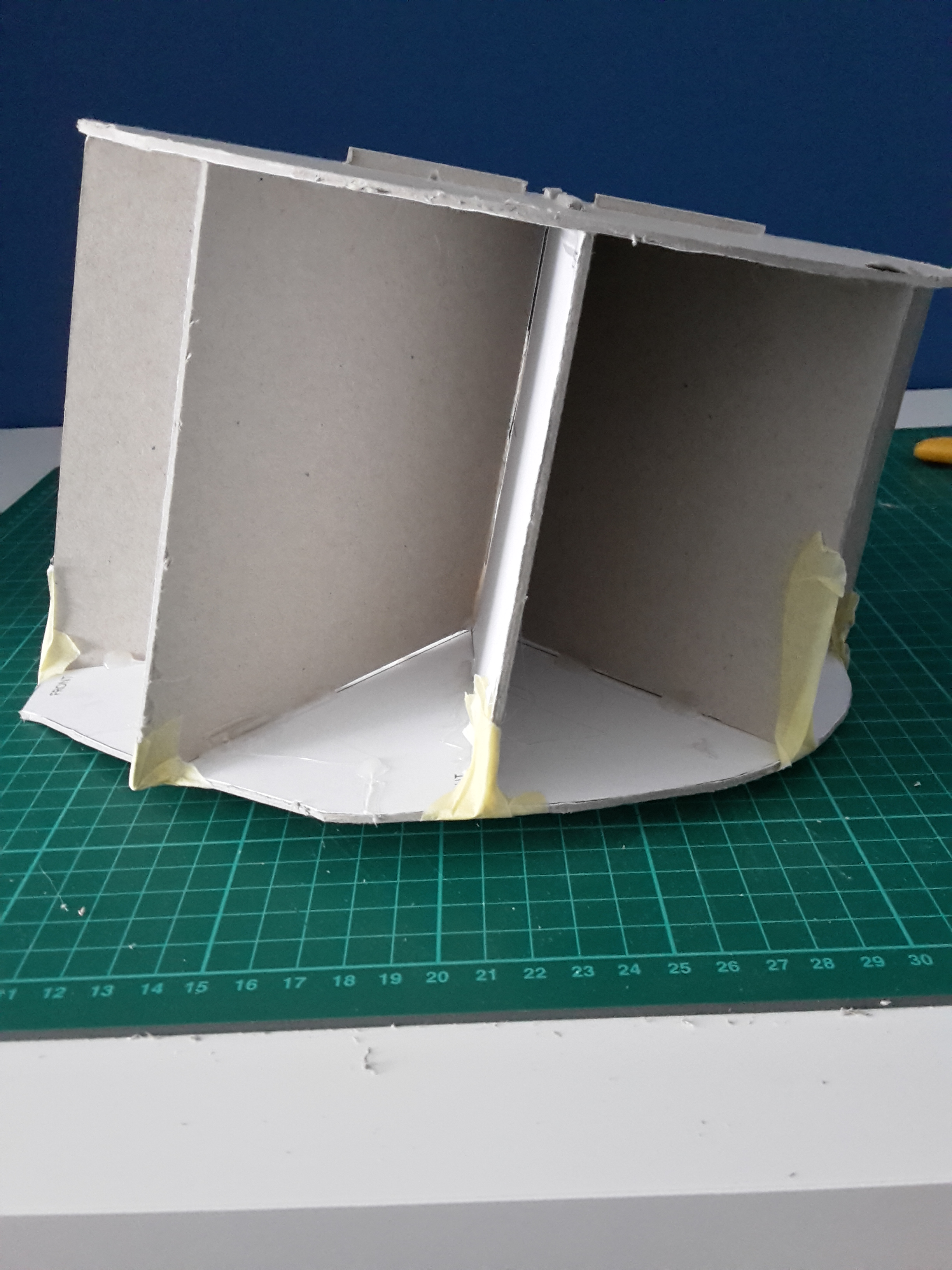

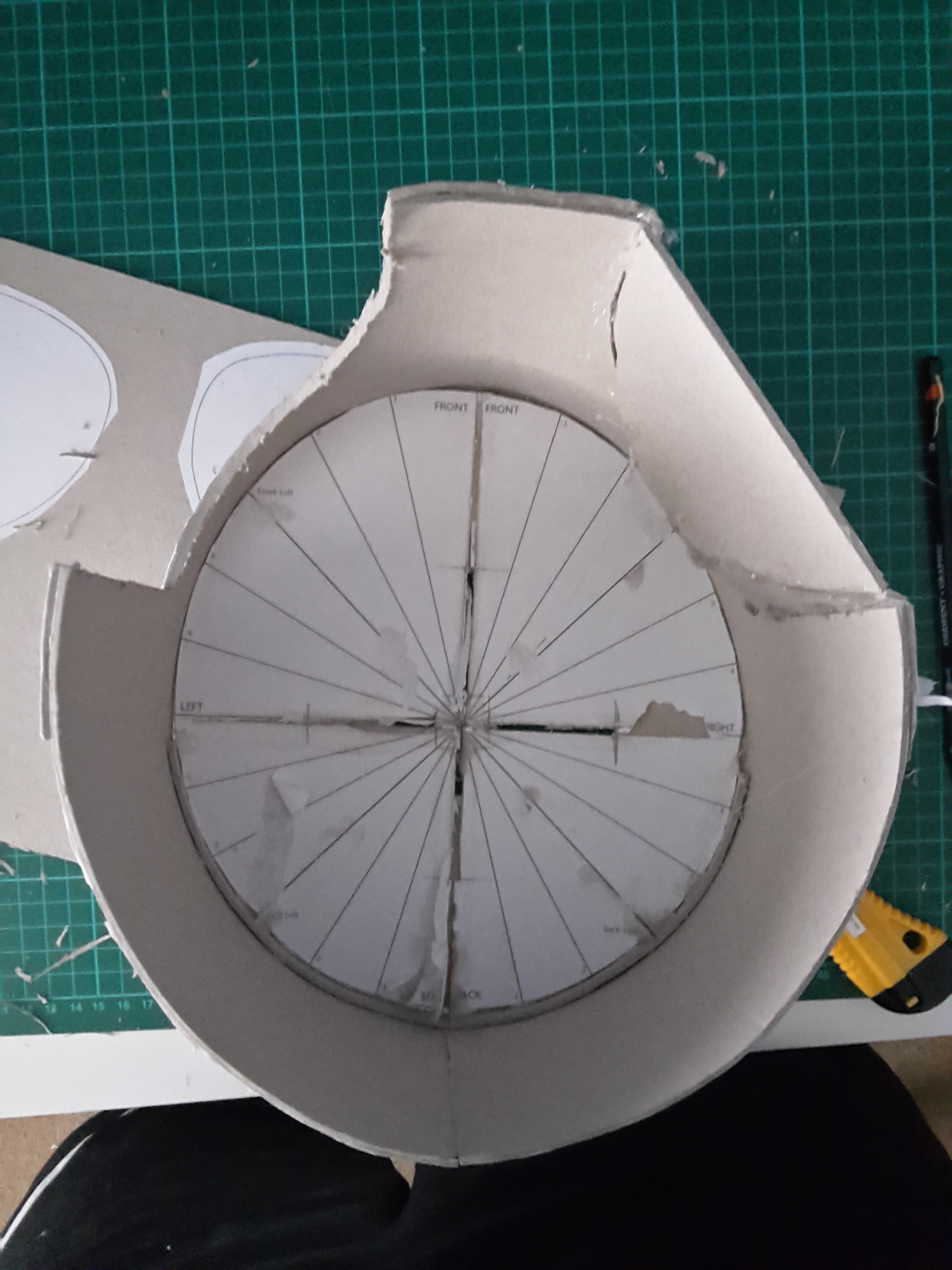

Right, inner support built. Not much to show, but will upload some pics anyway. Came out pretty good. Ended up putting some little tabs to plug in to some holes I cut for the cross support, just to make it easier to glue. Used PVA for top, but just used a glue gun and a couple of little beads for the rest. Seems strong enough. Will now cut out the inner and outer layers, and form them to the general shape, and try to clamp them in a circle overnight so that they retain the shape, and make it easier to glue.

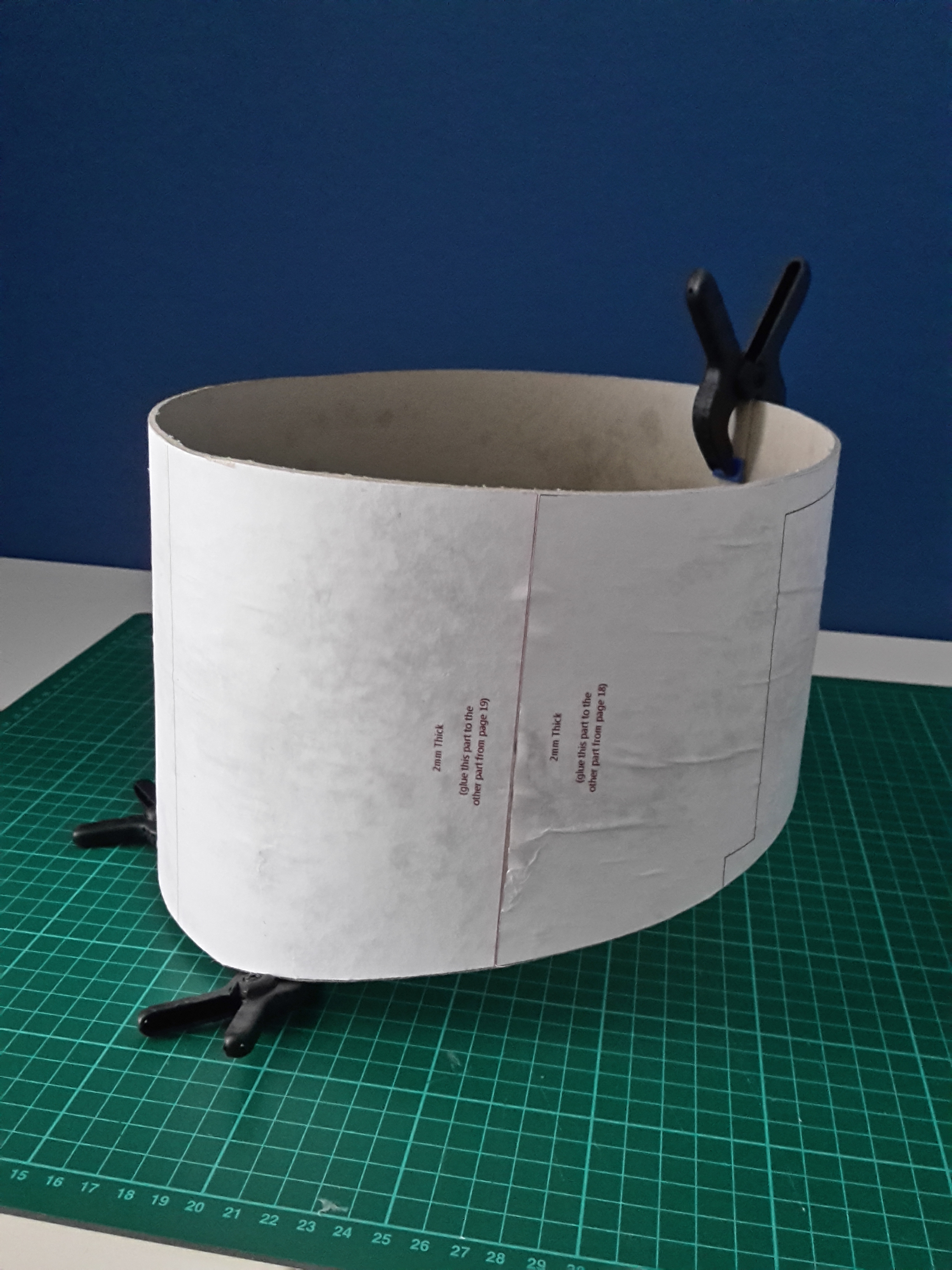

Inner layer cut out. Sprayed both sides lightly with water and then formed to a rough circle, and clamped shut. My brain tells me that when that drys, it will retain its shape and be easier to glue? Can someone smarter than me confirm haha! [EDIT] It worked, hooray!

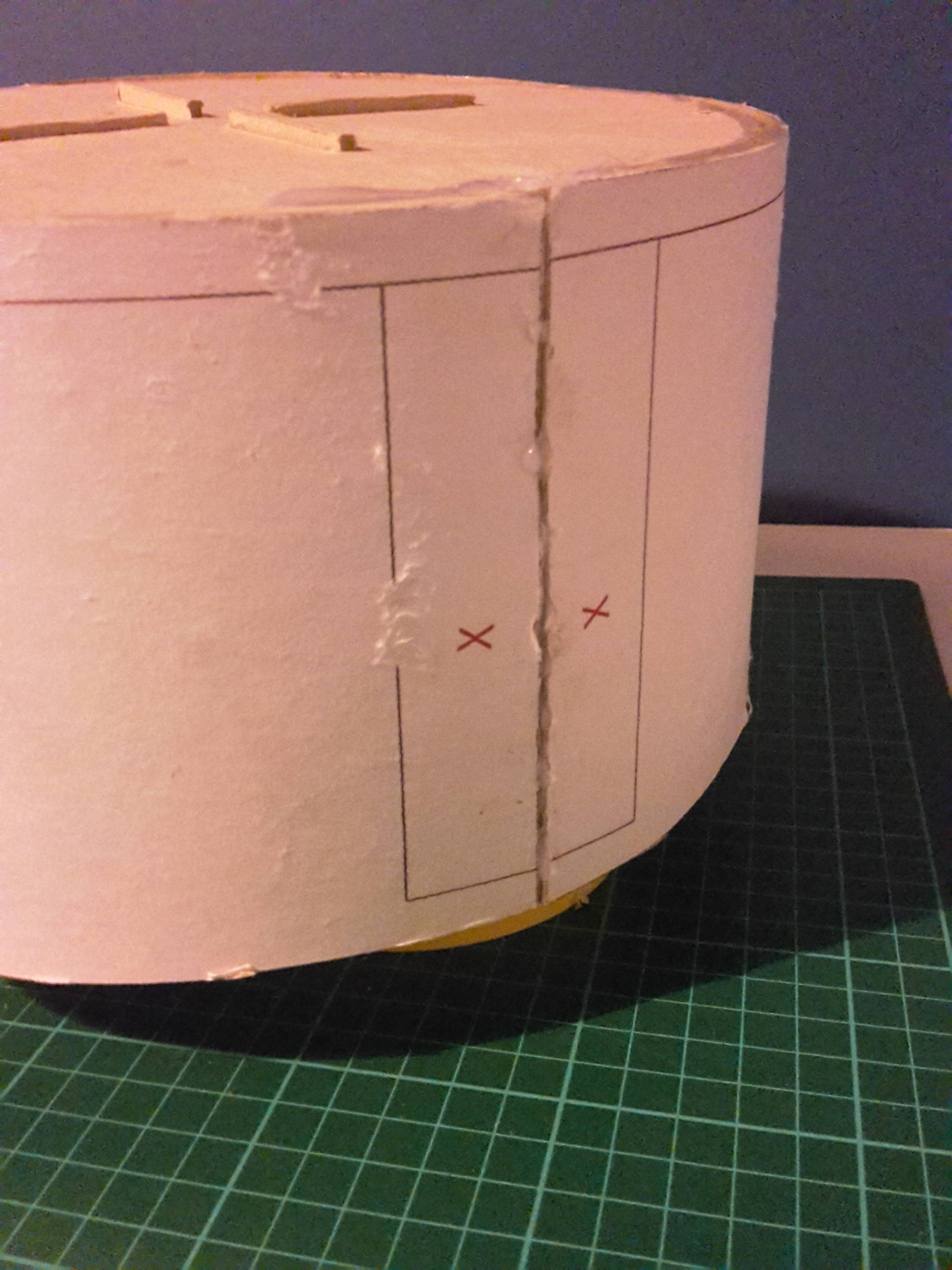

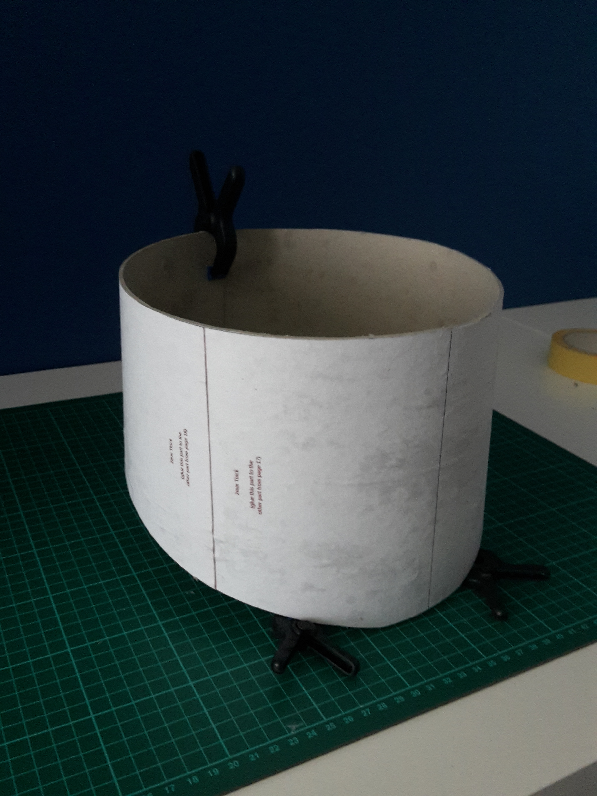

quick question, what do you actually glue the inner layer too? the little strip round the back and the dome support? Ive currently got the inner support taped in several places to hold its place. If I were to put PVA around the top edge and let it soak in and dry, would that hold it? Don't make much sense to glue it too the inner supports too much as it all get removed?

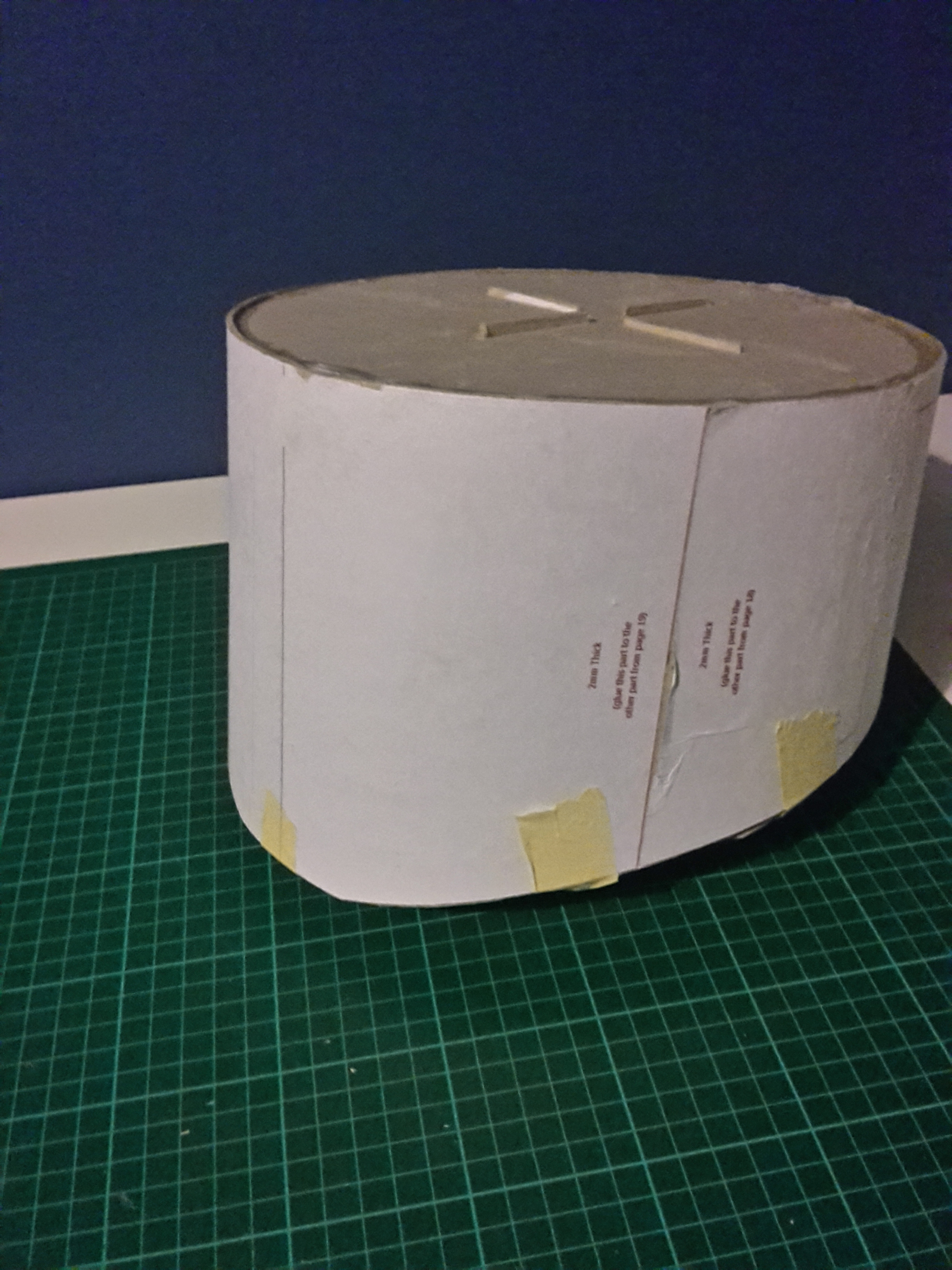

Well it seems to have worked. Taped it in place as tight as I could get it, and then put PVA around a few bits at the top. Dried within couple of hours and was stuck enough for me to remove tape. Couple of little tweaks, and then put a second load of PVA, this time all around the top. Seems pretty sturdy. Will probably add some more PVA, or glue gun beading once the inner support eventually comes out. On to the outer layer tomorrow. Coming together, and a lot cleaner than my first attempt! Should I cut the rear hole out before putting the outer layer on do you think?

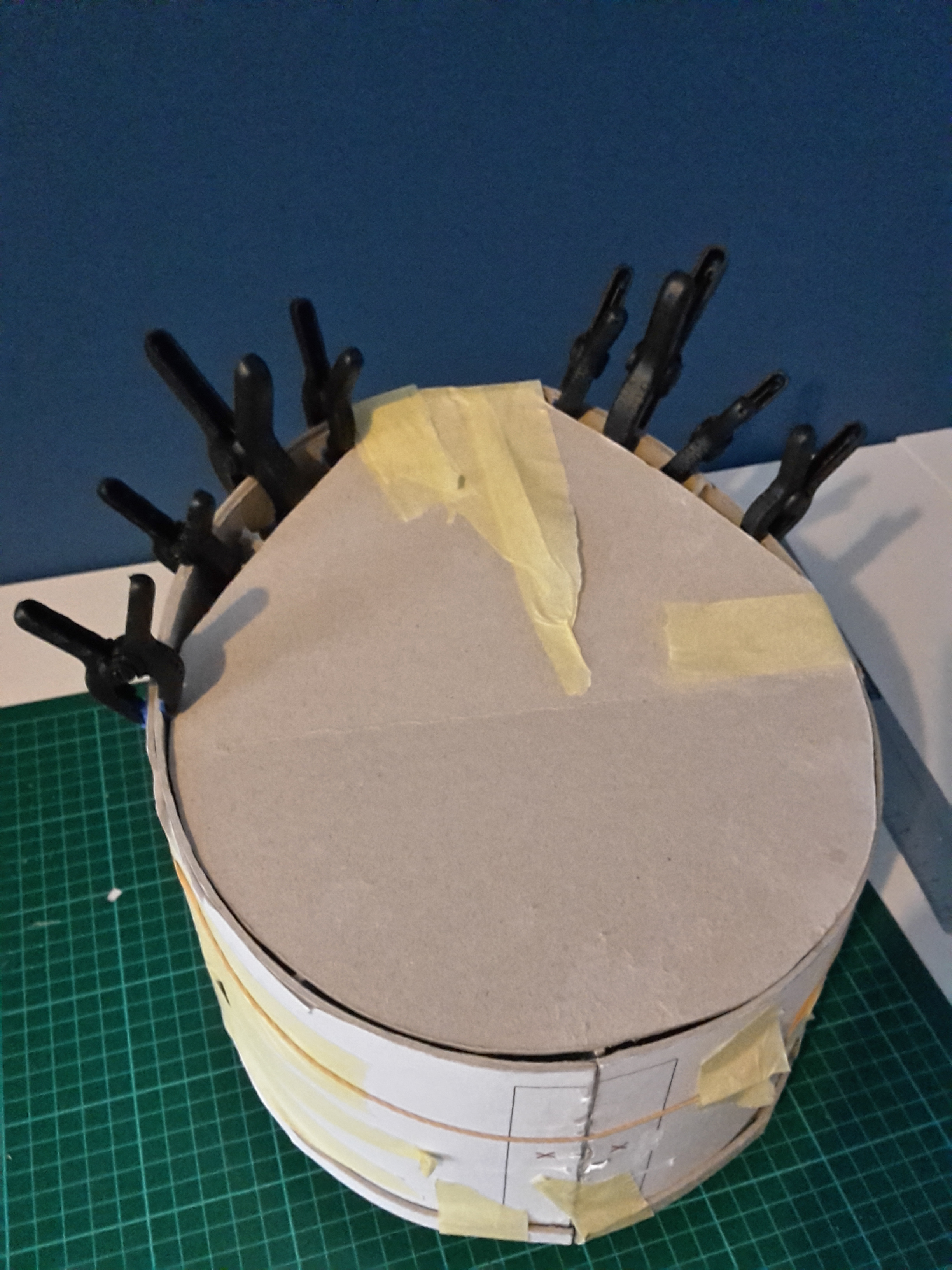

Getting the outer layer on was more difficult than I thought. But by using clamps and a lot of tape, I eventually managed it. Glue should be dry soon so I can take all the tape off and see how it is..

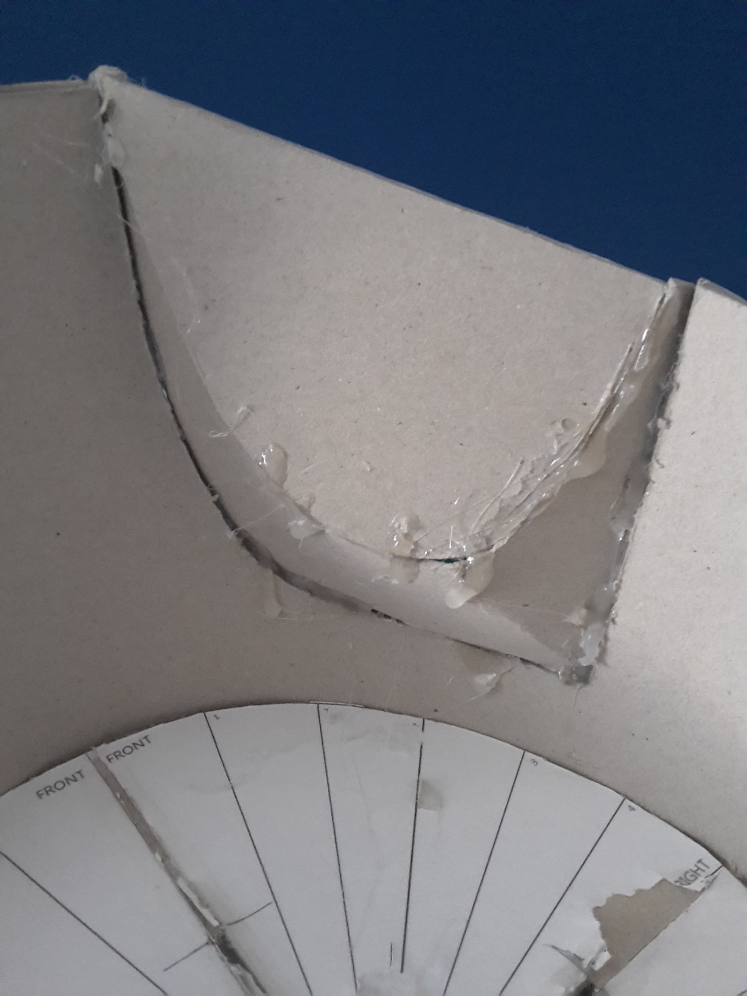

My first "Well that was stupid moment" - put a load of hot glue on a bit of the left cheek, and then grabbed it to hold it in place, forgetting about the hot glue. Ouch!

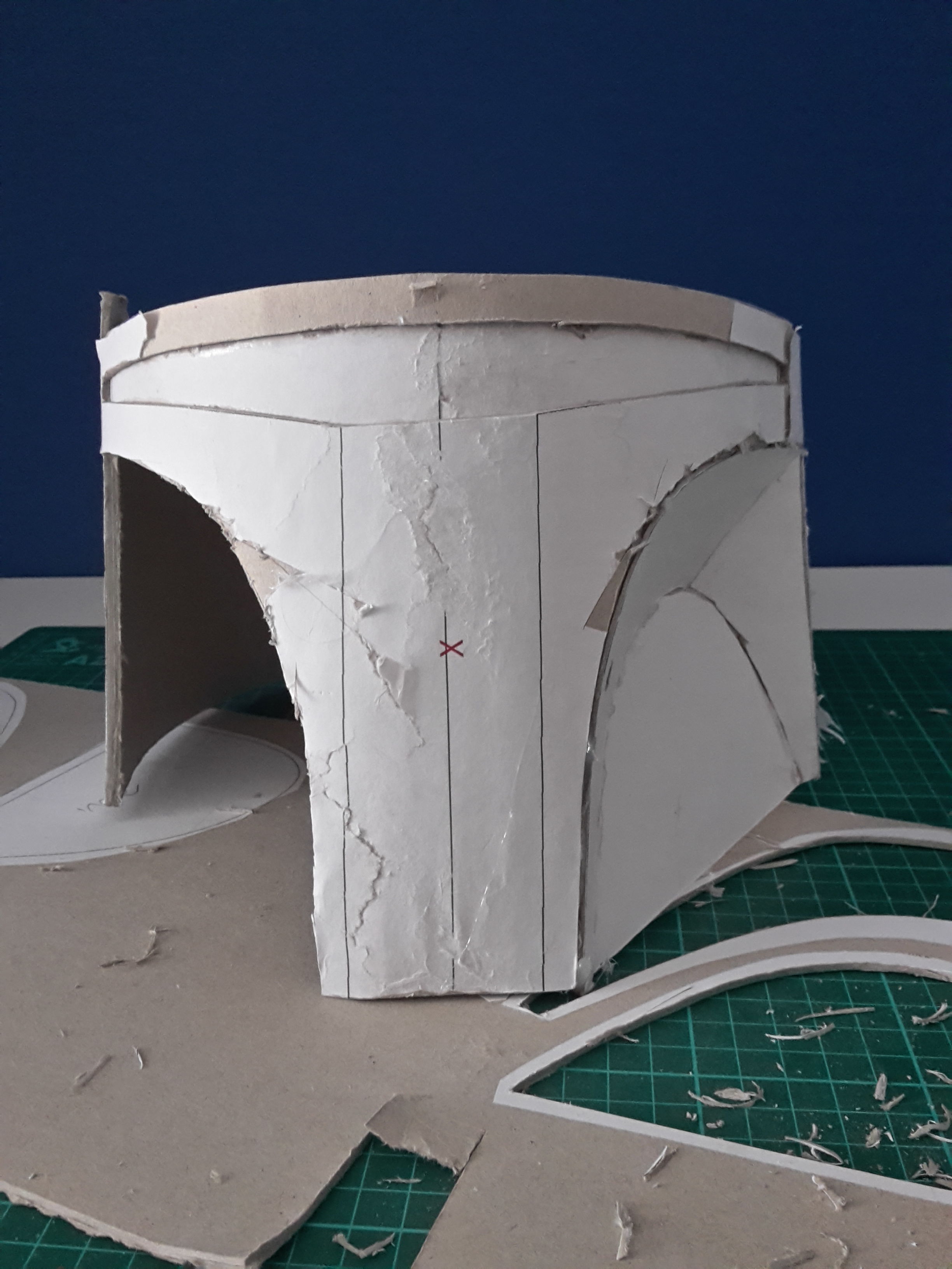

Left cheek done, a little messier than I would have liked, but looks kinda ok? Not sure if it's far in enough. Found it quite challenging to get it all squeezed in, but hopefully I can do the right one a little easier, and not burn my fingers off!
