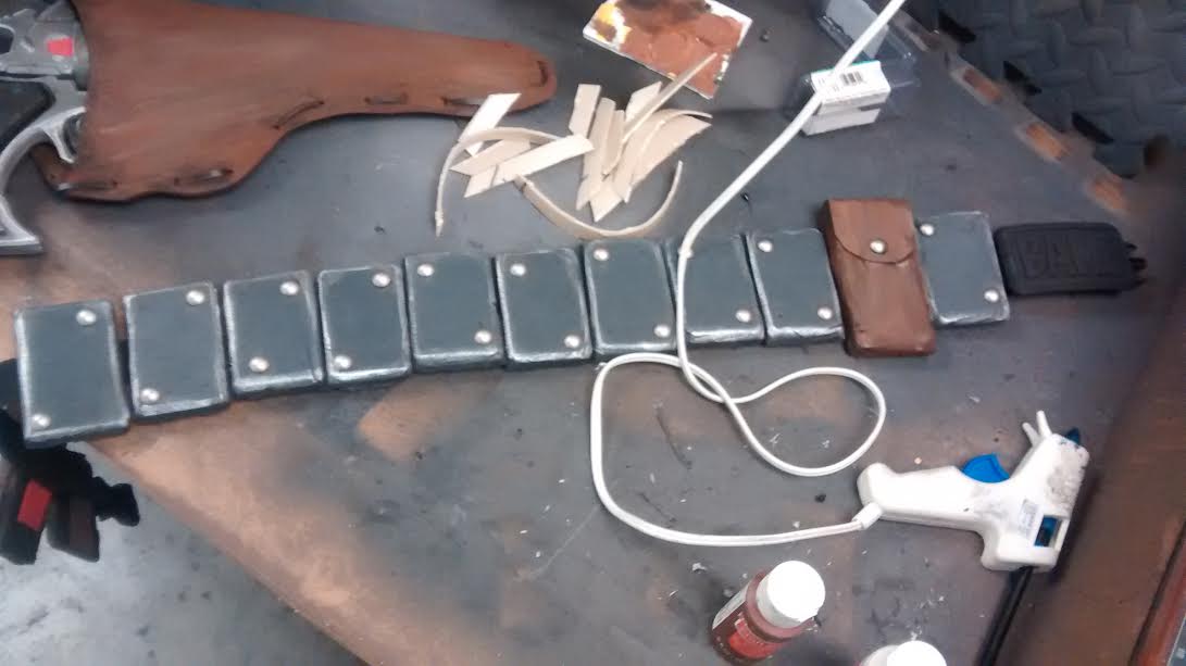

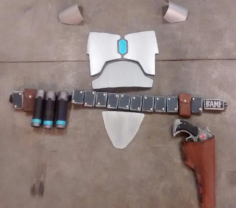

The belt was a doozy. The number of pouches on the ammo belts intimidate me. So I settled on a belt made of many little "armor panels" and two small faux pouches that don't open or go anywhere. I 3d printed 3 McCree flashbangs, McCree's revolver (which I then modified to look more Star Wars-y), and McCree's BAMF buckle. For the holster I simply traced around my gun on some craft foam, folded it over, and stitched it with some leather cord I had around.
Each belt panel can slide around on the nylon strap. This photo shows how. I wrapped the strap in wax paper, place it in the middle of the back of the panel, and glued another craft foam strip onto it. The wax paper kept the panel from adhering to the strap and ensured the gap in the strip was wide enough for the strap.
All the pieces were beveled with dremel, coated in a dark gray plasti dip (which was very close to the color of the foam). The edges were given some silver rub'n'buff for weathering.

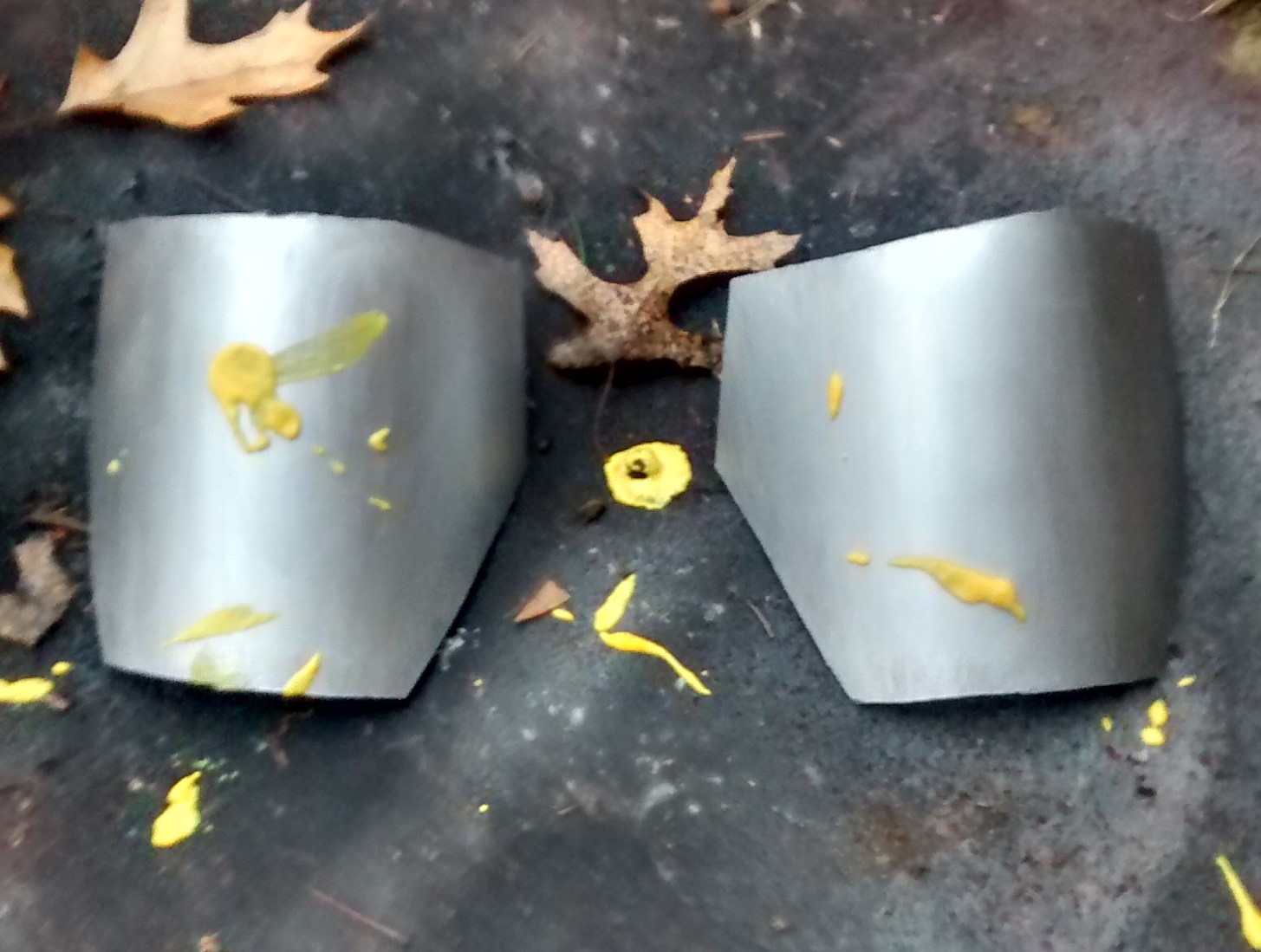

On to actual painting, my favorite (not sarcasm, actually my favorite part). I gave all the plates a base color of silver acrylic
and flung mustard at them. After the mustard I painted them the final color of bronze
then lightly rubbed the surface with a paper towel to remove the mustard and accompanying paint to create an expedited paint chipping effect. To chip away more paint I played Frisbee with the plates ontop a gravel drive, purposely missing and slamming it into the gravel. Weathering is fun.

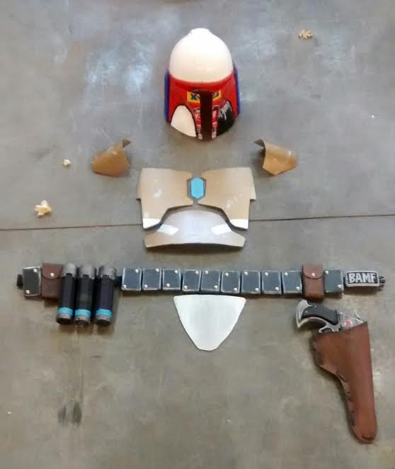

So this is the current state of the armor. Knees are currently in the freezer, flak vest and poncho/serape are in progress at this moment, and the collar plate is waiting to be made if I have the time.

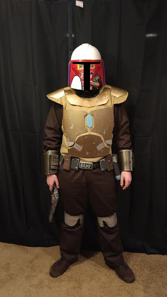

Yay, progress has been made. The flak vest was a bit of a project, so I called up my Mum to give me a hand. For a template she found a plastic grocery bag, cut open the bottom, and had me put on like a vest. I was only a little tight, so she cut it up and added some material and had her template. The vest was made of a canvas-y duck cloth. The plates were all attached to the vest using velcro and I 3d printed some gaunts somewhere in there. Knees have elastic on the back to stay on. I made a cigar with a toilet paper tube and magnets in helmet hold it in place. Things could now be worn, so I put it all on to get a progress shot. The visor is not actually in place, I just colored it black in photoshop to hide my silly face which detracts a little from the bucket. crotch plate is done, but I've yet to attach it, and same with the holster. Hopefully I'll get some progress done on the poncho
