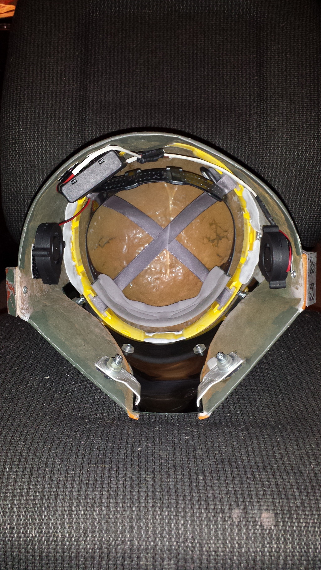

I like the hard hat suspension system. I have used that in both of my helmets. My Boba Fett is a scratch build & Jodo Kast is a DVH. Due to the room & the dome I used 2 different styles but still achieved the same affect. The suspension system keeps the helmet from moving around but also keeps it in the same position. I also like the comfort of it & there is adjustment if needed.
The Boba Fett helmet I used the suspension from a face shield & reversed the locking nuts from the outside to the inside. Epoxied the stud to the inside of the dome & then am able to screw the knobs that came with it & attach the suspension. Went with this cause of room in the dome.
The Jodo Kast helmet there was enough room to cut & fit the attachment area of the hard hat, trimming it down to a ring, to fit in the helmet. Used Loctite epoxy putty to hold it inside the dome.
