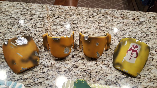

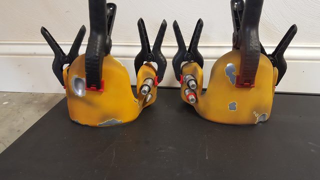

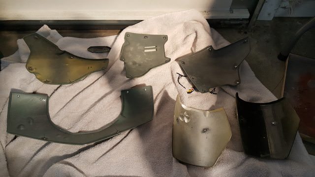

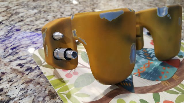

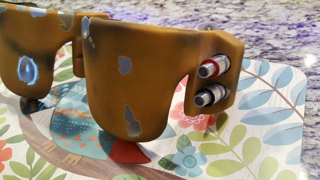

Finished up the knees and shoulders last week soon after my previous post. Very happy with how they turned out.

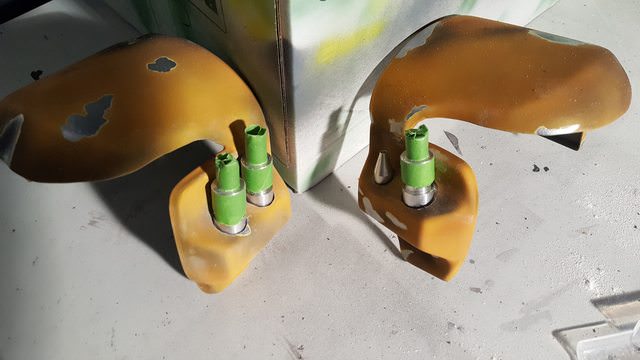

Then, I drilled out the holes for the darts (here is the test fit)
Painted and installed:
Glued on the RKD backs after the darts went in, used E6000 since it needs to flex

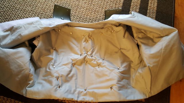

Then I had my own little "glue party" and installed all of the jewelry pins and snaps:
Here are the pins installed and on the flak vest:

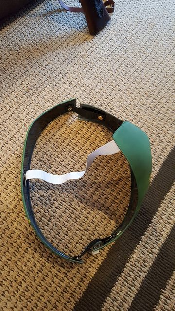

Here's how I rigged up the cod and kidney, used elastic to connect the two since I'm fond of calories and carry it all in my gut

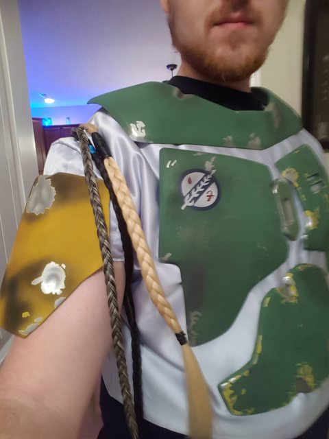

Then I installed the Wookie braids! Just used a big safety pin, poked it out of the flak vest from underneath, ran it through all 3 braids, then back in to attach. Can't see it. Should hold perfectly.

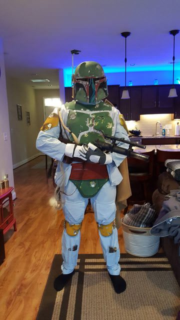

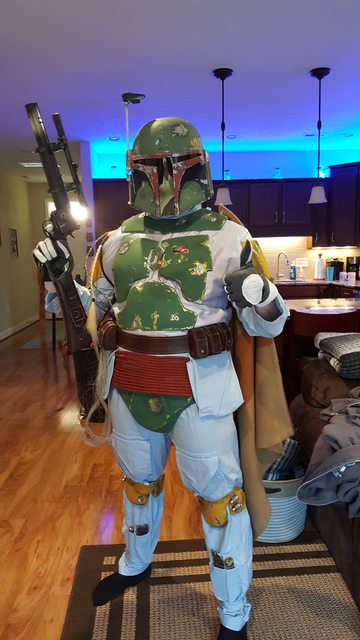

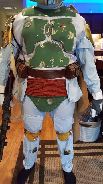

You all know what this is leading up to. Once I got the armor on the flak vest, I had to get suited up as far as I could and take some pictures. It's the law.
Oh..... oh HELL yeah. Ignore the funky lights, I stuffed them in there just for the pic. They did not cooperate. I also cinched the girth belt up in the back with a robe tie-up piece since I haven't strapped it up yet :lol: The braids were a little wonky as well, my wife was really not into it since I sort of put dinner on hold until after I took the pics.
Couple things I learned: very important to know the order to put everything on. Also, the cape did NOT want to cooperate. I don't have enough thread on the bolt for that stud, so my wife just sort of stretched it around the stud. Need to figure out a better method there.

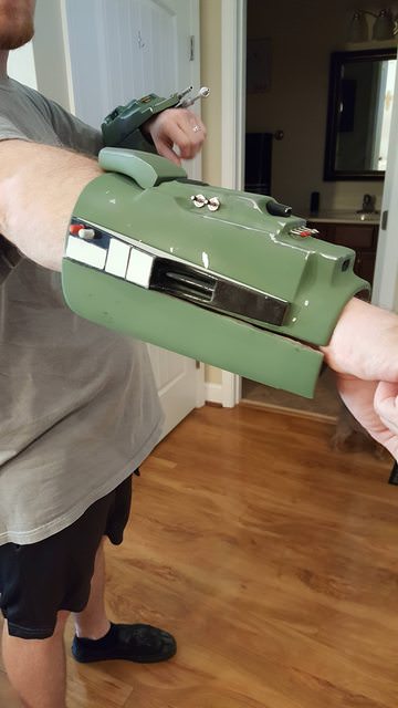

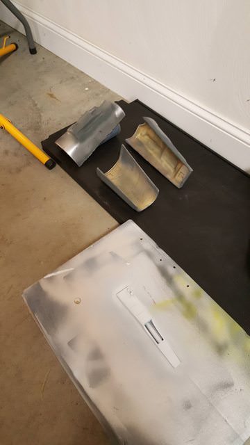

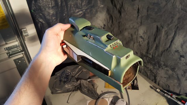

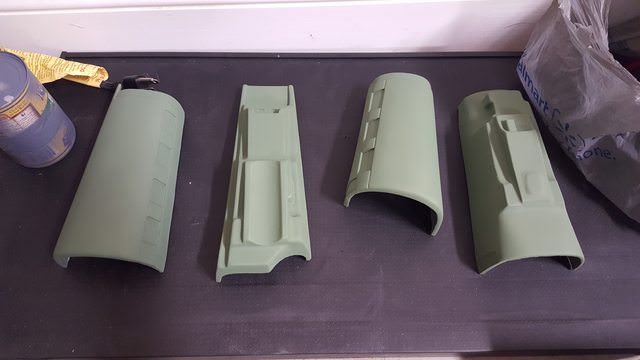

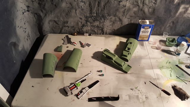

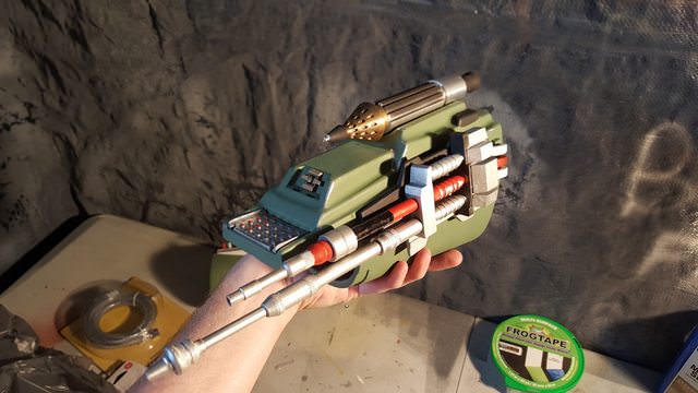

Gauntlets are done! I busted my butt working every night this past week to get em done. I did a layered paint method on the gauntlets, I know most people hand paint the gray and silver damage over the green but I just like the look of layers better. Plus it's what I'm most comfortable with, I'm trash at hand painting. With a little 0000 steel wool you can take down the edge and make it look hand painted anyway.

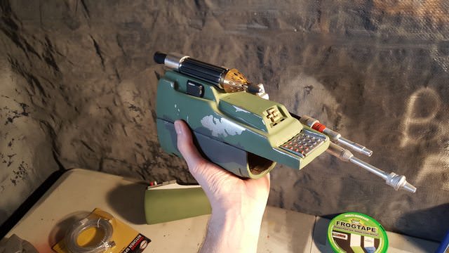

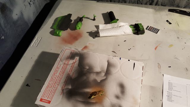

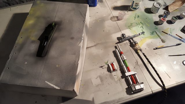

Painting some of the accessories- gold for the dental expander, black for some rocket and flamethrower parts, red and blue for the calculator buttons
Gray layer on the gaunts and white on the whipcord launcher
Some more accessory paint- gloss black on the whipcord launcher and some hand painting on the flamethrower bits- in retrospect I should've done the rocket in gloss black instead of matte, but it was too late. I figure I can go back and put some car wax on it to shine it up later.
The green! Best coat of paint I think I've sprayed yet. Came out really nicely.
Shiny!!!
Some more hand painting- black on the gauntlet "extrusions", and more for the flamethrower and whipcord launcher

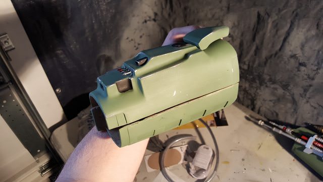

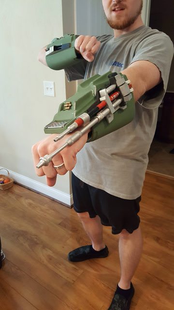

I took off the masking, bolted or glued everything on after that, and then strapped it up which took foreeeeeeeever! Of course I had to test fit em after the glue was dry.
And the complete look!
Left gauntlet:
Right gauntlet:

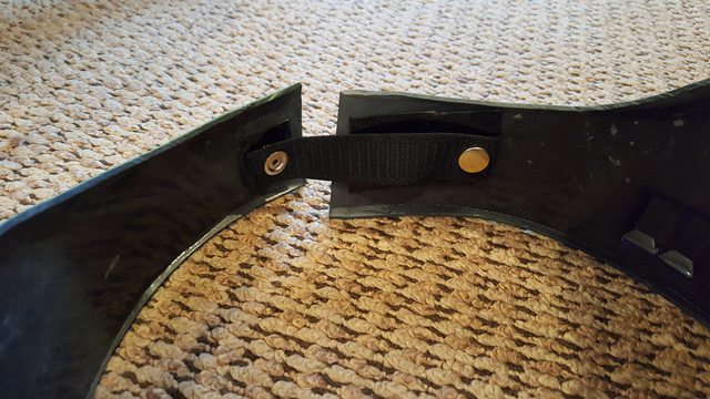

Here's a peek at how I did the strapping. I put two pieces of elastic on the inside edge to act as "hinges", and the other side is snaps for easy removal. In reality, since the straps are elastic, you can just stretch it on over your hand. Works great.

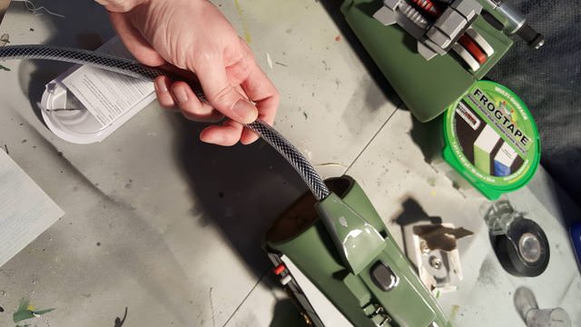

And of course the hose! For this, I went to Lowe's and bought a $5 replacement hose for a kitchen sink sprayer and a $2 3 ft coaxial cable. Cut the ends of both, pushed the coax cable into the hose, done. Easiest part of the costume by far! Once I have a chance to figure out how I'm going to attach it to the flightsuit, I'll cut the rest off and glue it on the gauntlet.
