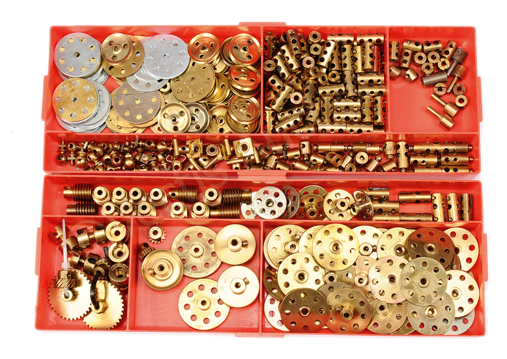

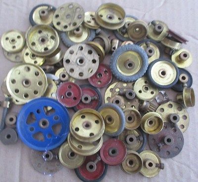

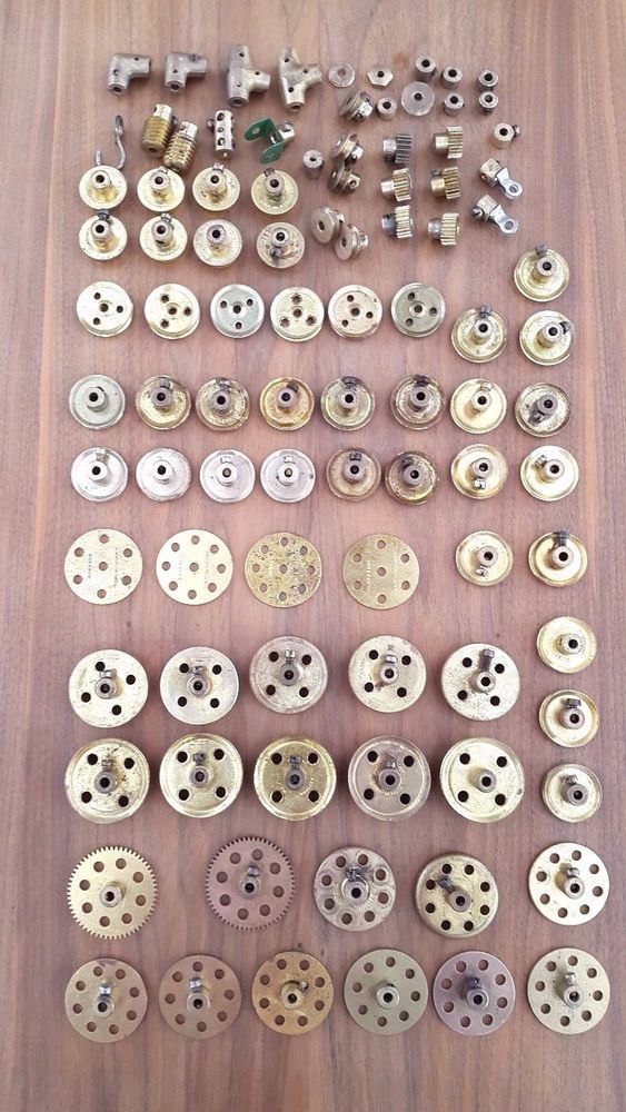

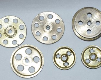

Did a search for Meccano pulley there looks like there are number of possibilities.
View attachment 171204 View attachment 171205 View attachment 171206
Exactly, I had stacks of this stuff when I was a kid and it was widely available in the UK at the time of filming. which was why it sprang to mind but I didn't find anything that really took my fancy although there were some interesting pieces. I had a look through what I still had in the loft and if I recall correctly I had pretty much everything you have pictured there. I also considered plumbing type flanges knowing that plumbing parts were clearly in use on other props.
