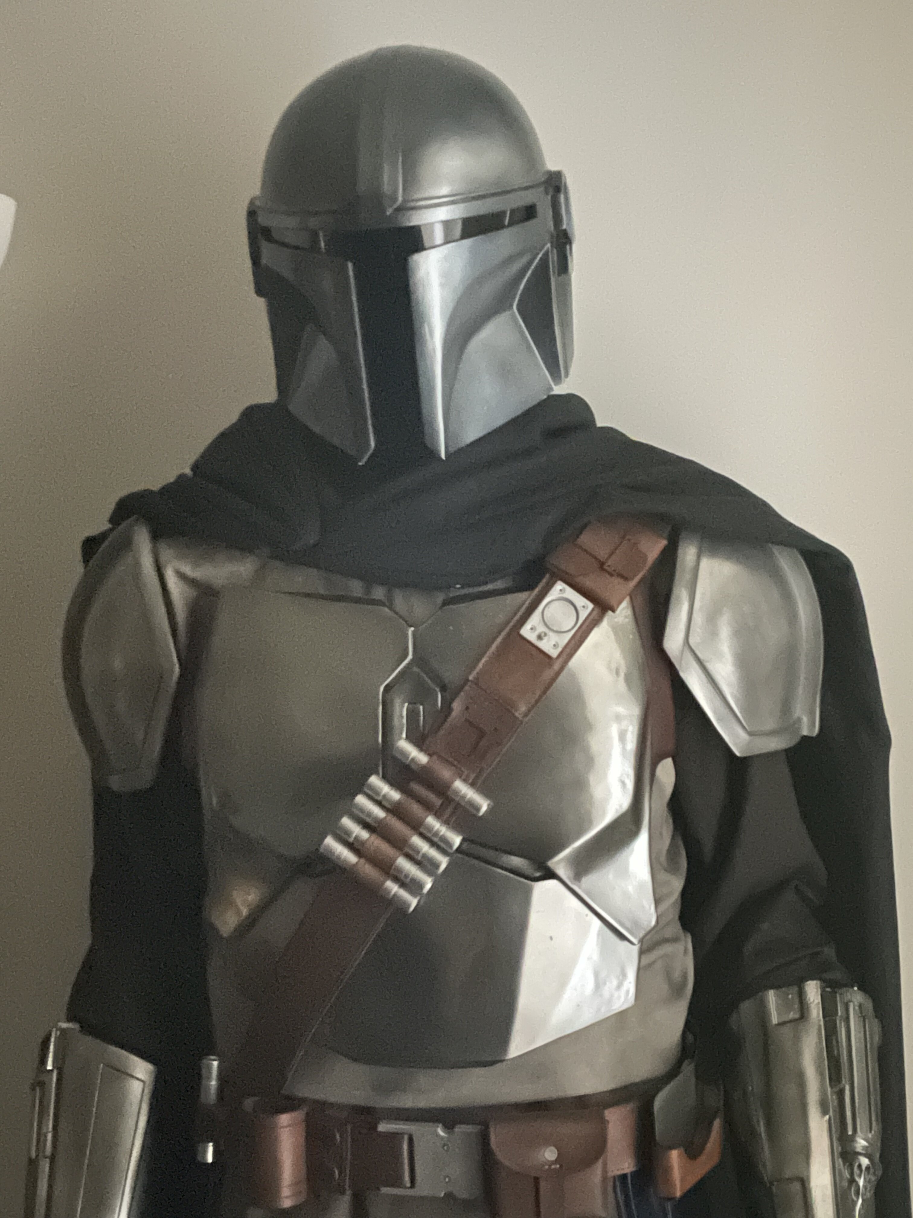

I’ve scrolled through the build posts and saw some references to ways people have successfully attached the shoulder bells, but I haven’t seen too many descriptions and photos of the attachments. I’m struggling with ideas given that they’re a little heavier and hang differently than Boba or Jango armor. If anyone wants to share their tips on what worked for them, I’d really appreciate it. This is where I’m at…. I’m waiting for the flight suit, and eventually will upgrade the helmet but would like to being working on the armor attachments. The chest is held on with magnets. I saw that in firstcoastfett’s build thread. Thanks!

Would you happen to have any pics that show the straps that you’re describing? I read somewhere that in the show, they ran some straps to the shoulder that were attached to the vest piece. Is that what you did? Also, curious as to why you didn’t do magnets on the shoulders? Worked on the chest but not so much for the shoulders? Thanks man! I’m about to do this work on my build - picked up the knee pads you mentioned
I opted out on magnets for the shoulders only because my arms have way more movement, more likely to come off. The velcro and elastic are a good combo (for me). The chest stays in place, the ab piece is attached to 3 pieces of elastic (middle and sides) allowing for a little flex when walking n stuff
Sorry I don't have pics of the setup. I found the center of the vest and put the two snaps in place (pointing down, from the underside of the vest). The elastic runs perpendicular from the vest. If I get time I'll take a pic and upload it here
