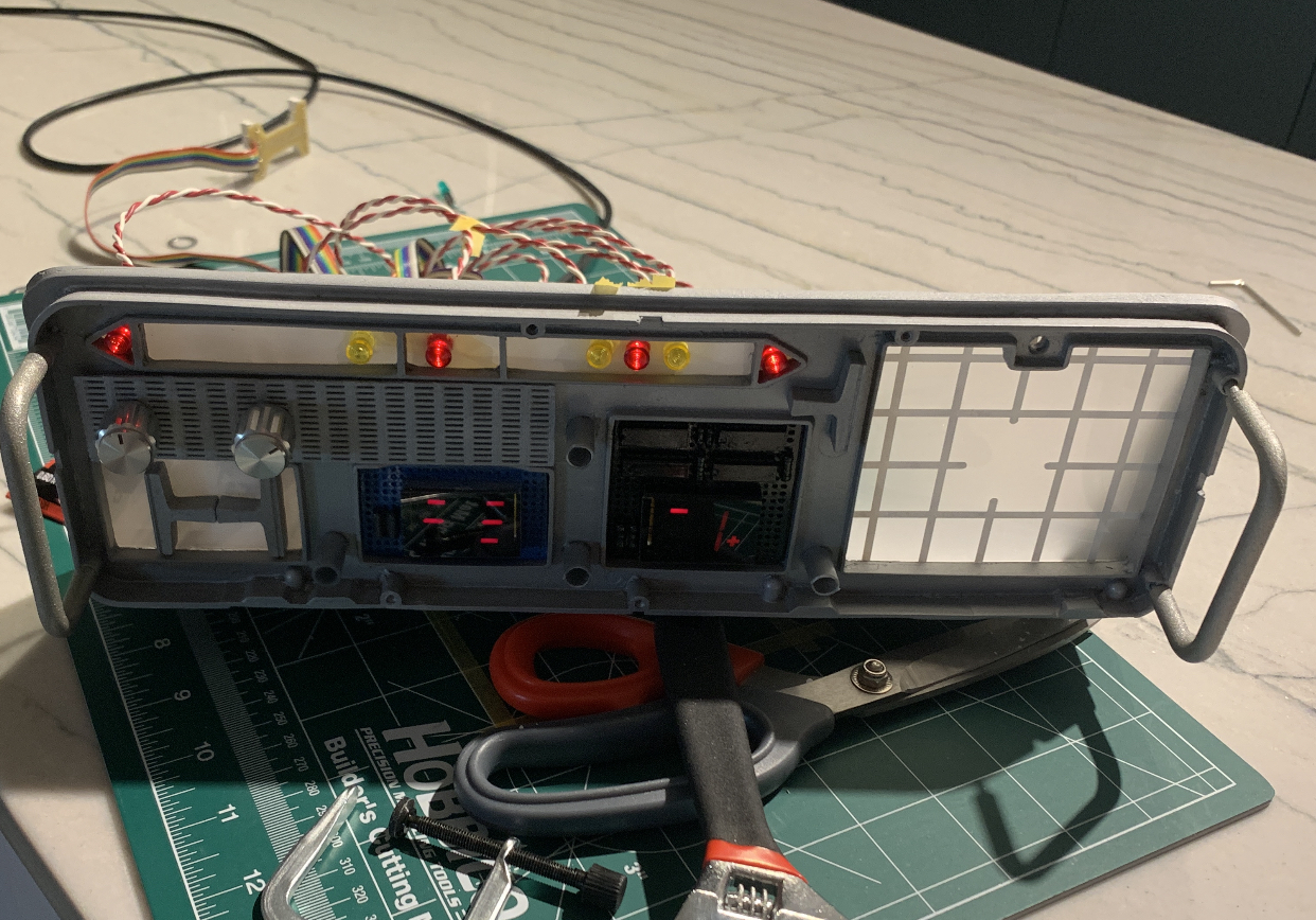

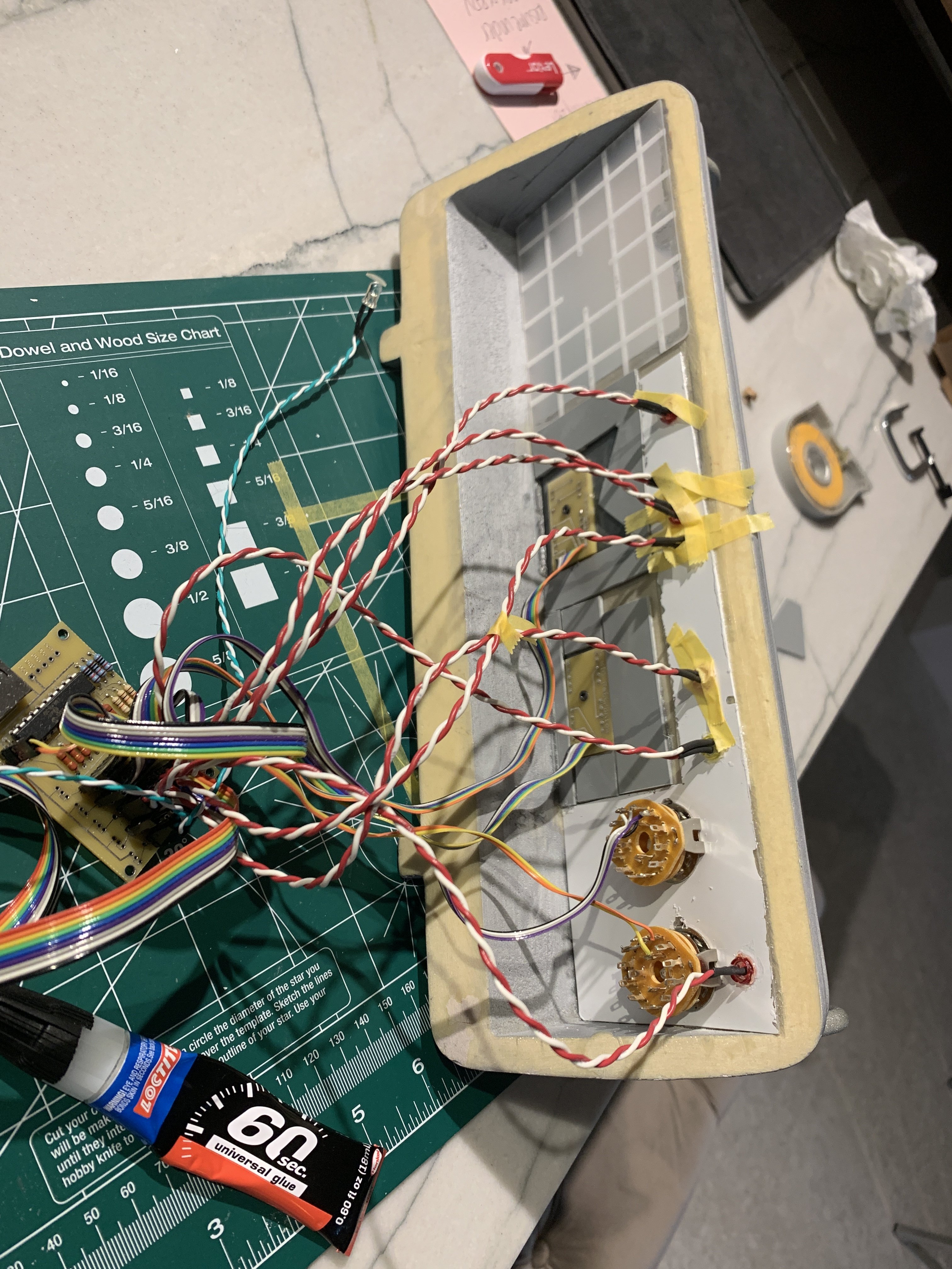

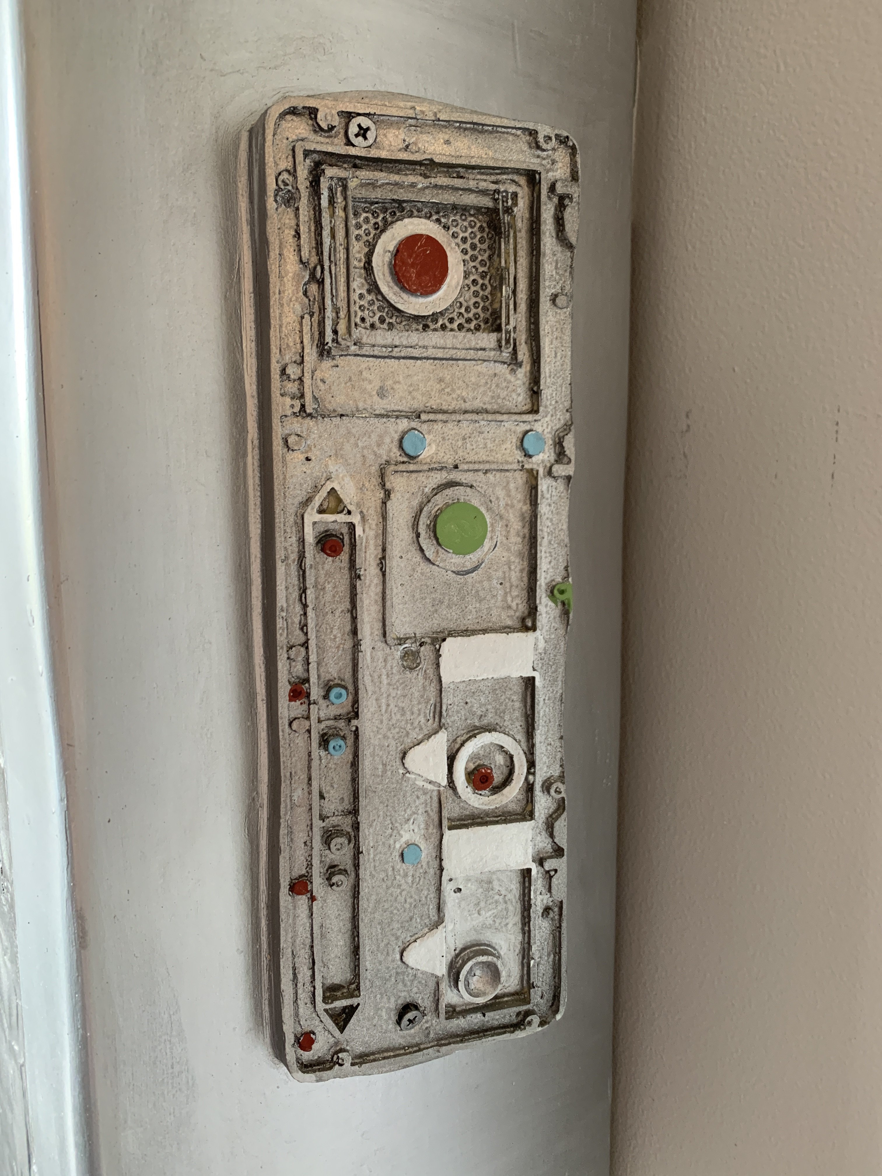

Better late than never? I’ve started back on my HIC project. I originally bought a decent copy of the Illusive Concepts HIC on eBay. He needed a lot of love to get him up to speed. The side panels where rough molds like the IC one but painted weird colors. I’ve almost got the Hero panel completed.
