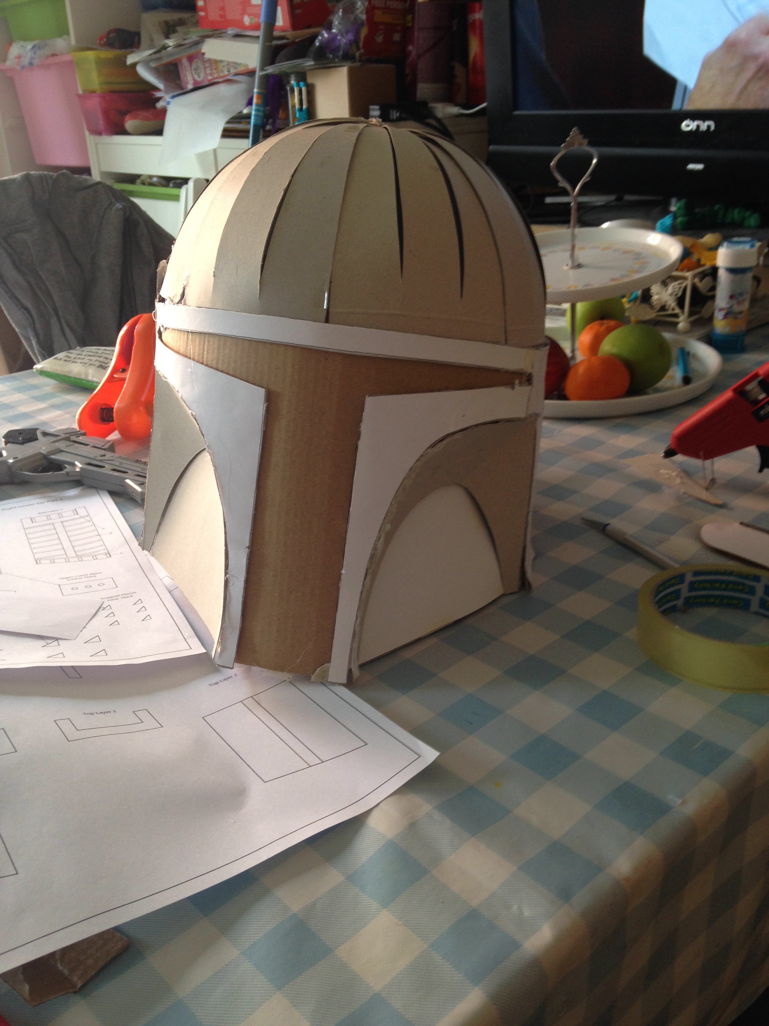

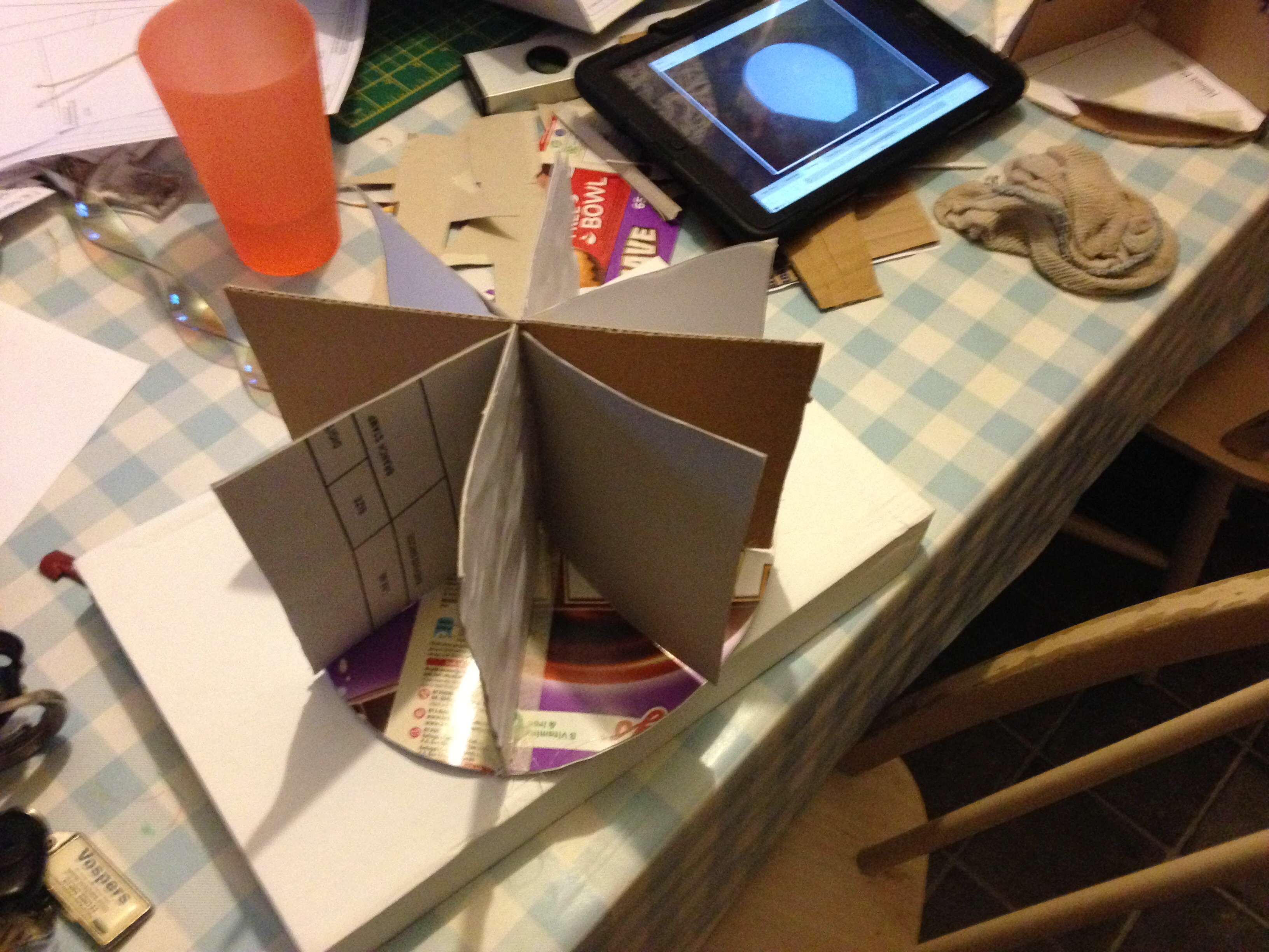

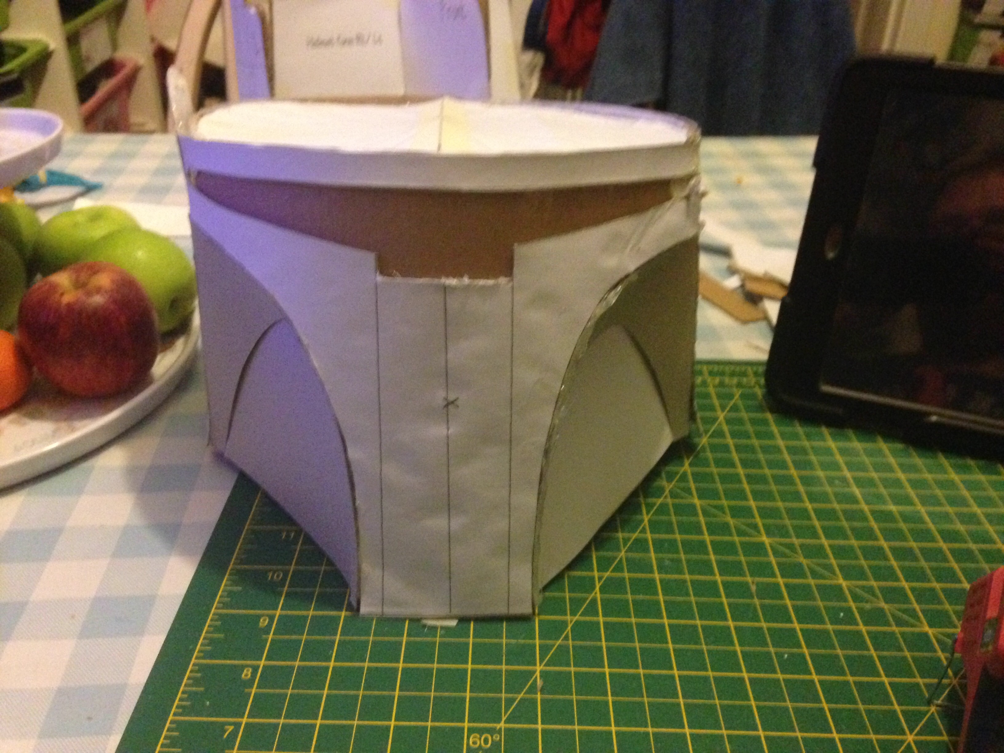

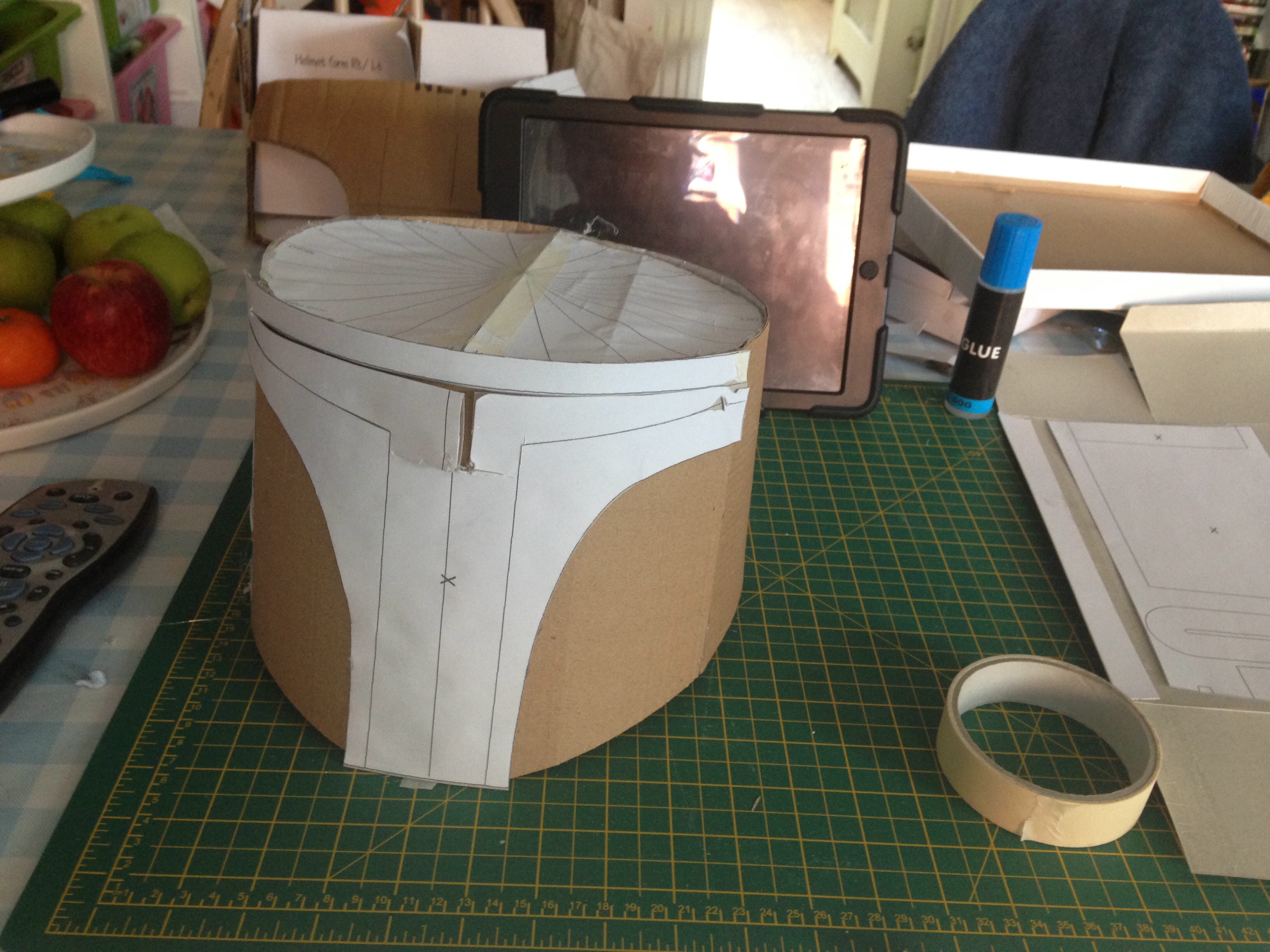

As you can see I am constructing my bucket from recycled materials. Shoe and cereal boxes mostly. With corrugated cardboard for the internal support structure as I figured it would be the strongest material that I have to hand.

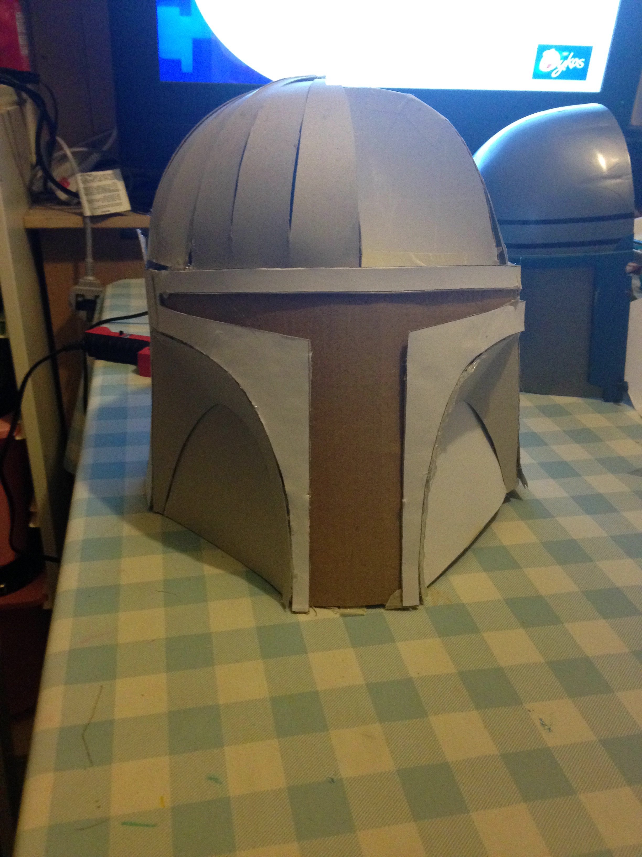

Unfortunately due to my inexperience I used a thin cardboard for the dome base and for some daft reason out of two pieces. I paid dearly for that later on. As you can see from the pictures it is poorly formed an so does not fully support my dome. A perfect example of 'follow the plans because you don't know best'

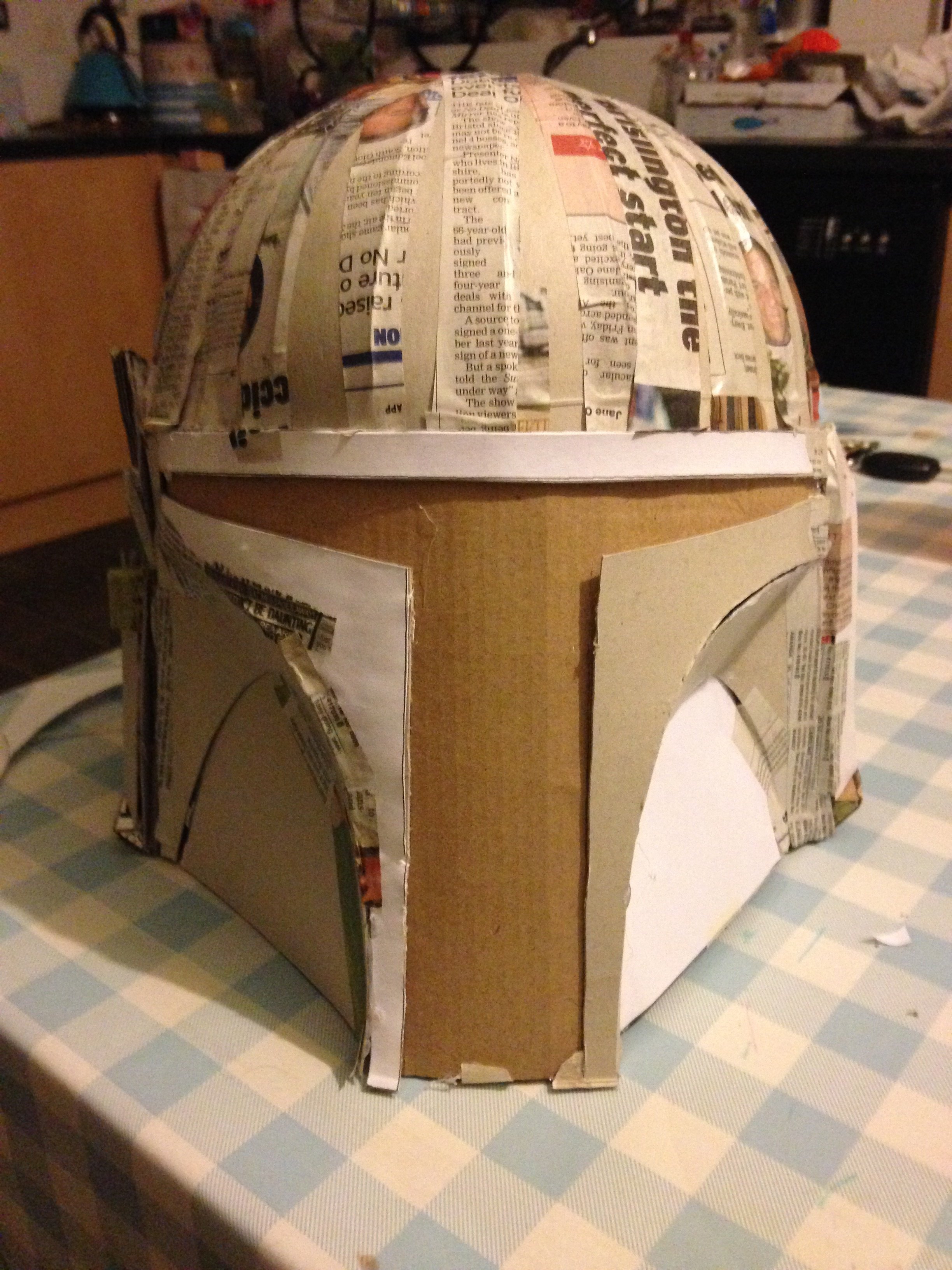

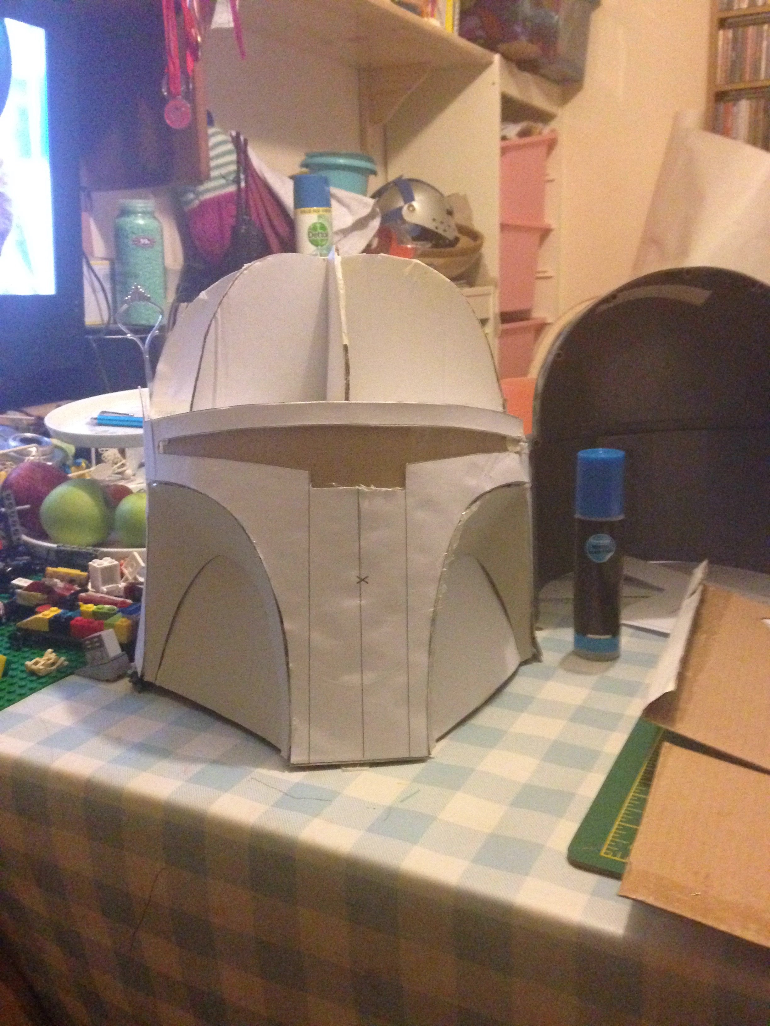

As the dome frame went on I used hot glue to fix it in place. You can see I have not removed the structure supports from the base or dome. It is my intention to hopefully use this model to make a cast from so it's my theory that I will need as much structure strength as possible. The urge to cut them out and try it on was very tempting especially with everyone around me asking if I had tried it on yet.

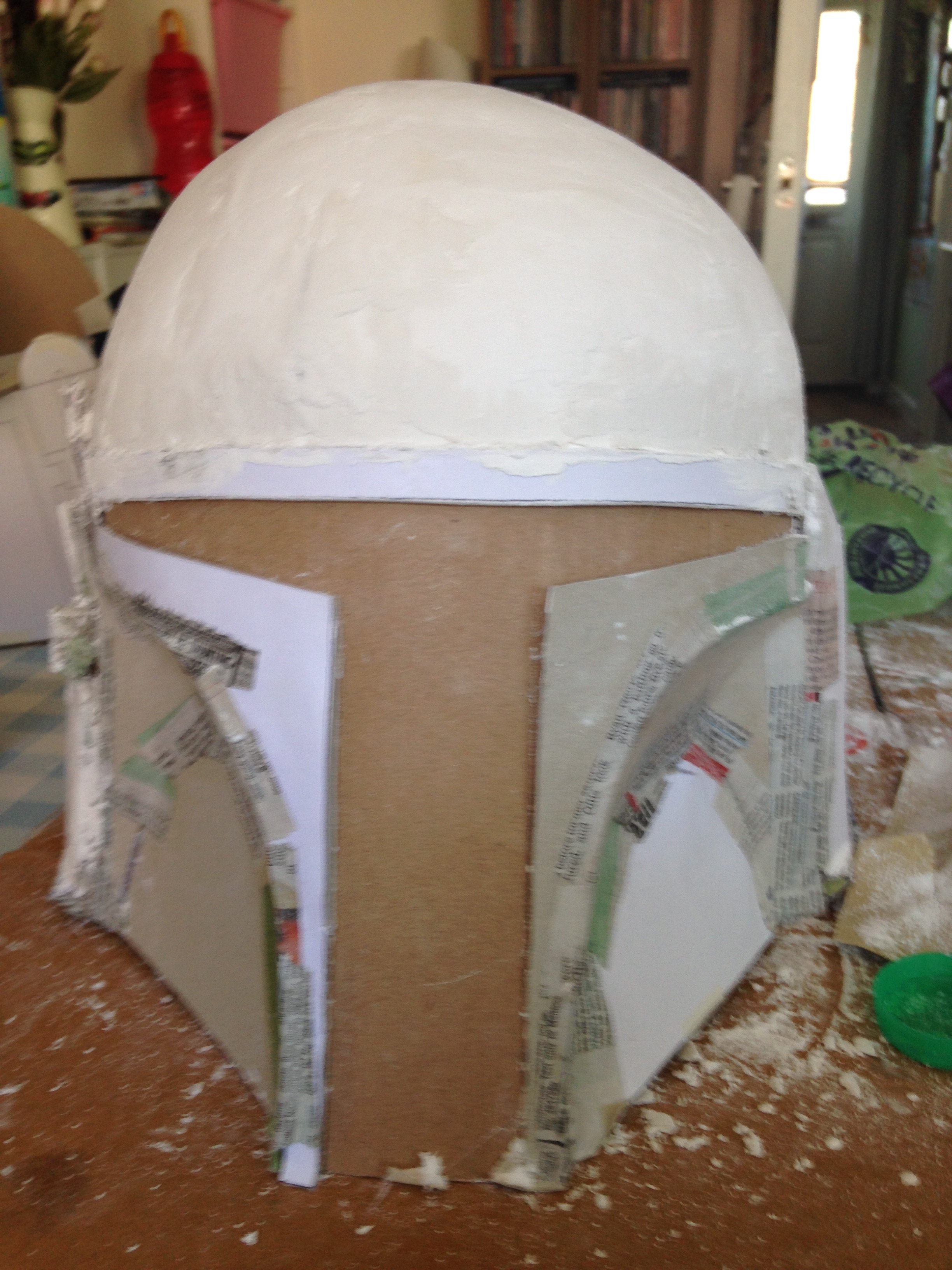

Forming the dome was a challenge. Even though I am aware the model is not as tidy as I hoped I am learning techniques. I also became aware that the cheeks were not seated properly and will have to be removed and reseated.

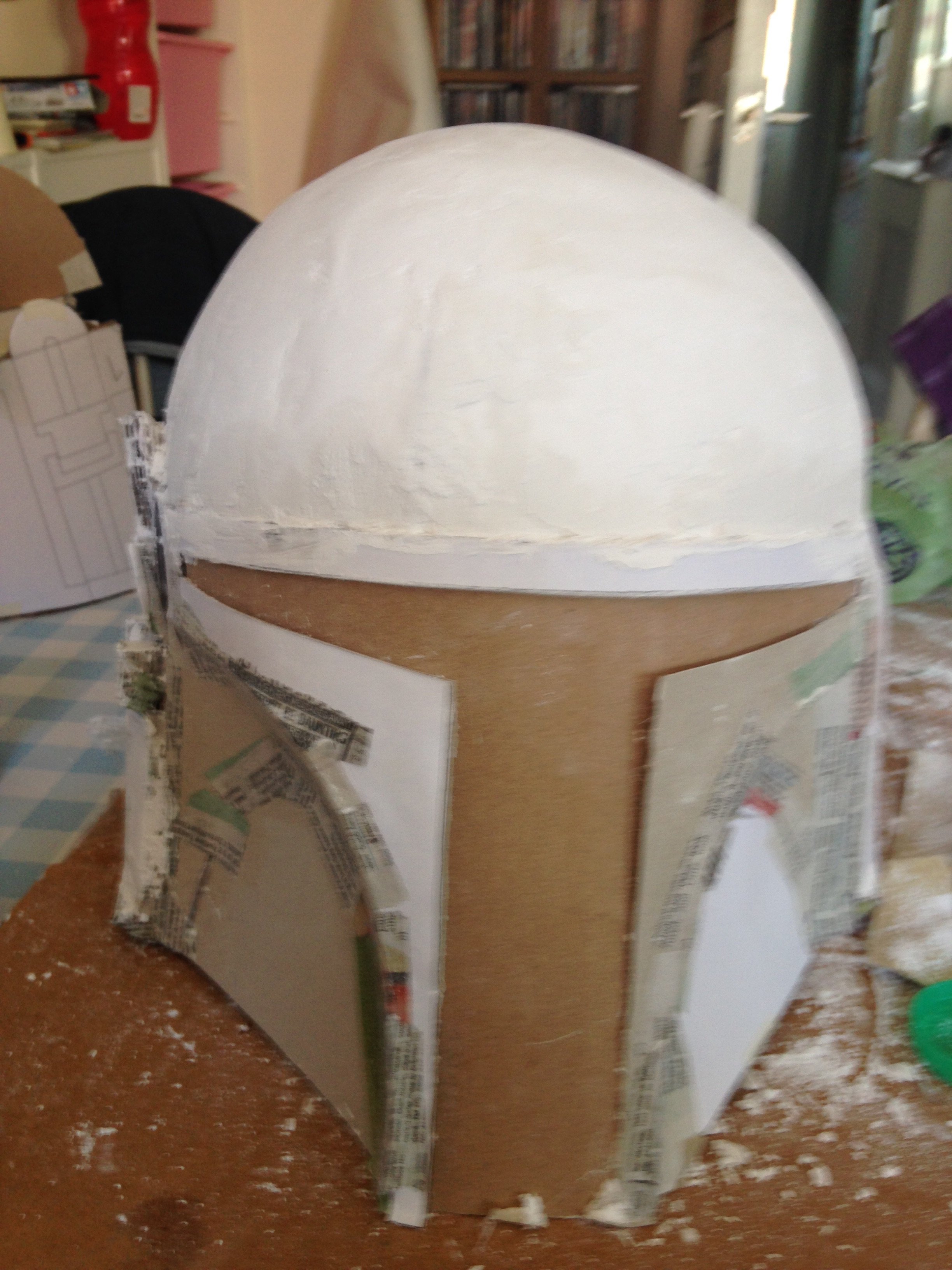

I am currently applying a layer of papier-mâché to seal up the joins before I apply the filler. I learnt the technique like most things from YouTube and is a very satisfying finish. Although while I was waiting for a layer to dry I was back on TDH reading and Learning when I came across a thread that said applying papier-mâché is the worst thing I could do......gulp. Guess we will see.
You got em on now. :)
I think you're doing well. If the mache is an issue, why not use a spray adhesive, and layer on newprint or whatever you're using?

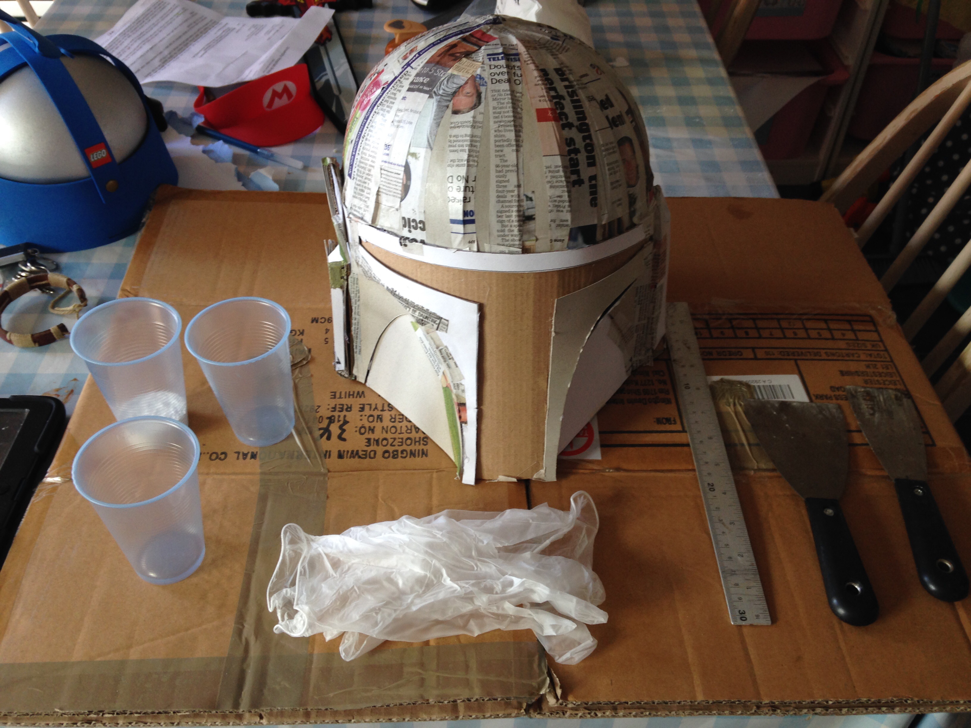

That certainly sounds like a plan. At the moment the paper mâché is going on quite well and life willing should be moving onto the filler soon. I plan to use a filler/water/pva mix just researching mix ratios now.
After some research on the net I have found a few 'recommended ' mixes for my filler. The top ones are 50/50 , 1/3 pva and 2/3 water and 1/6 pva and 5/6 water. Think I am going to go for 1/3 pva to 2/3 water.

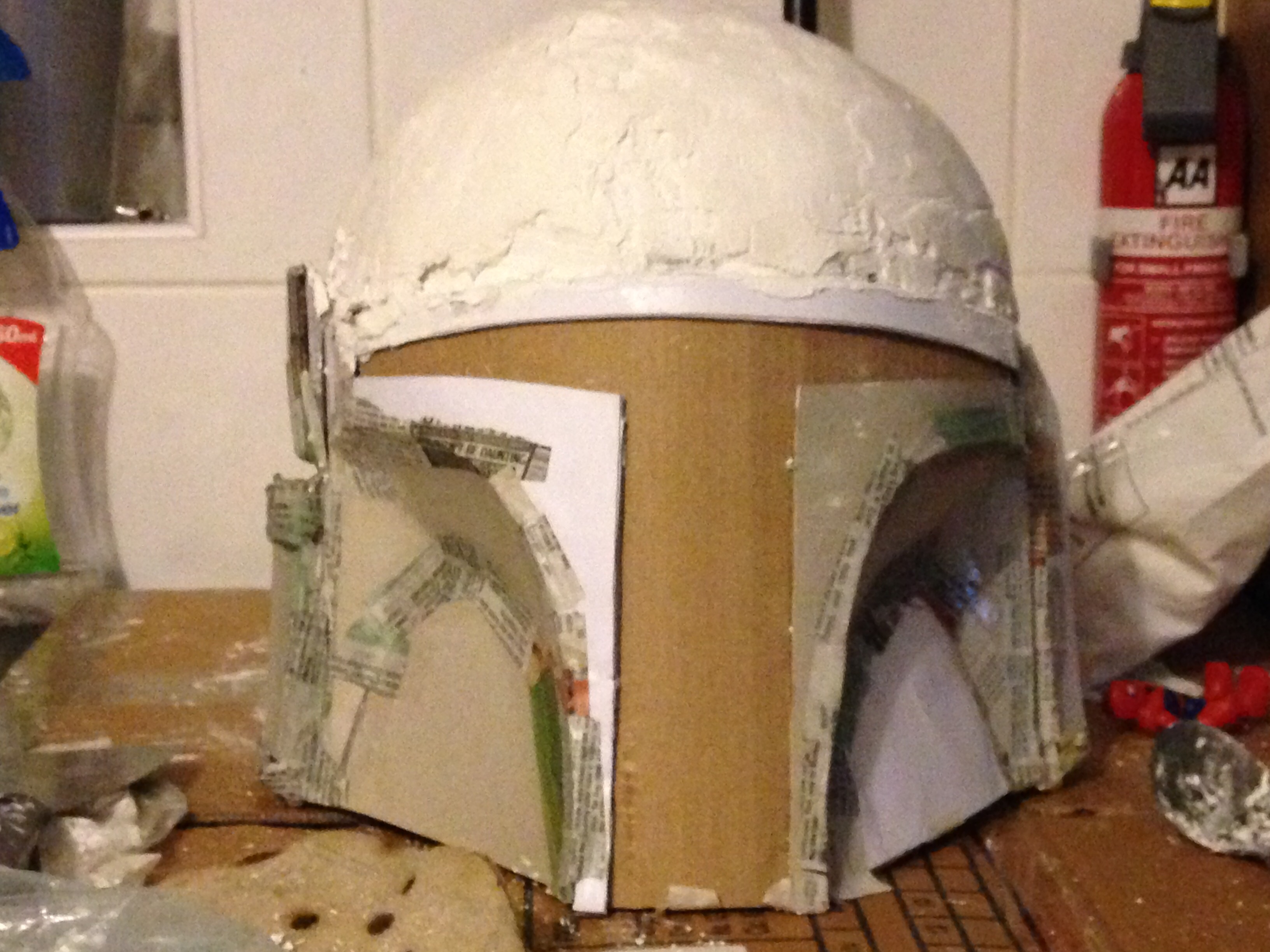

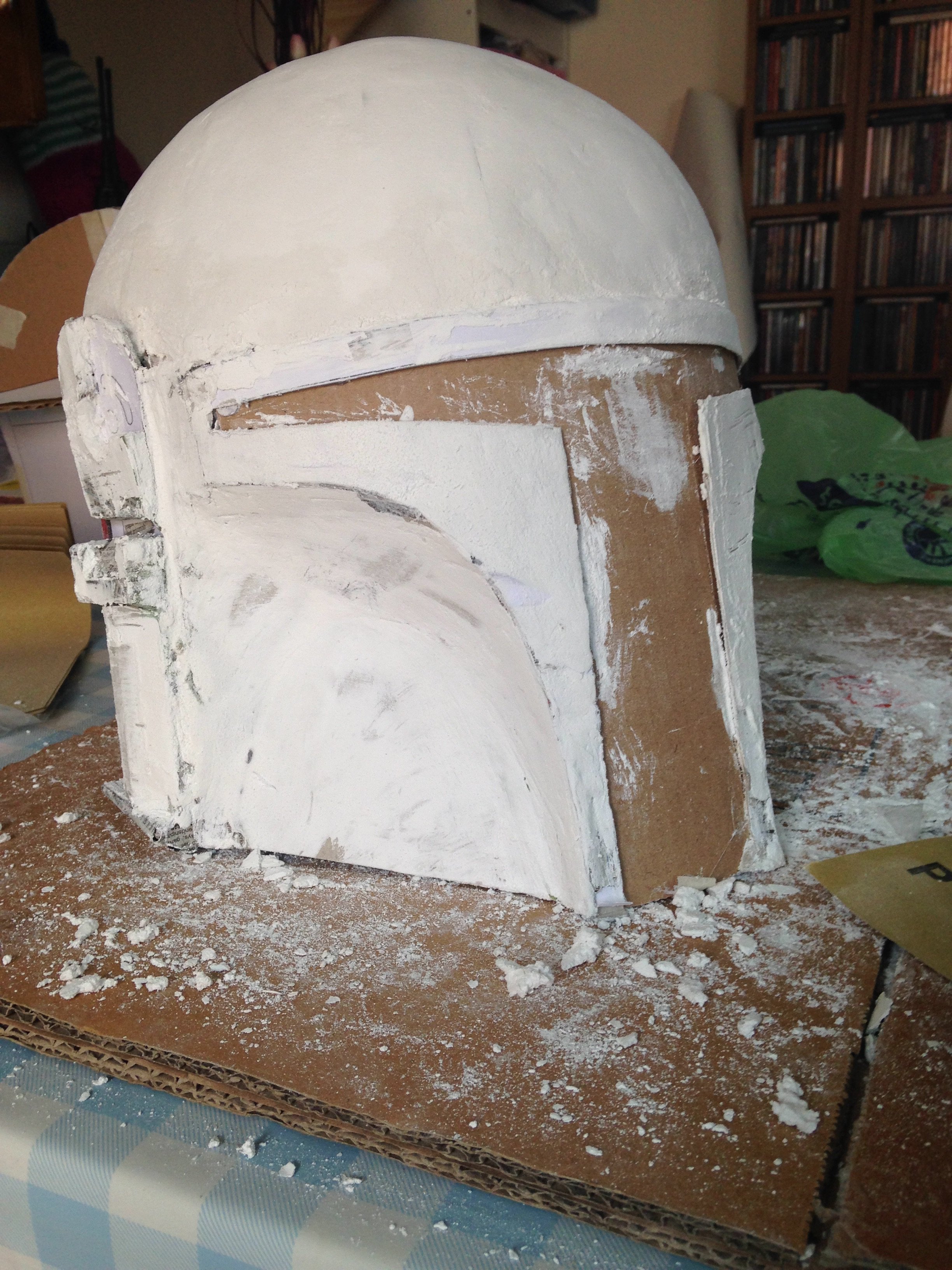

Well the plaster stage has begun
I used the water & pva mix for my plaster with a bit of Ds9 in the background
The plaster went on but not as smoothly as I would of liked but then I knew there was going to be a lot of sanding in my future anyway. Progress was slow as you can see Ds9 has changed to Flash Gordon

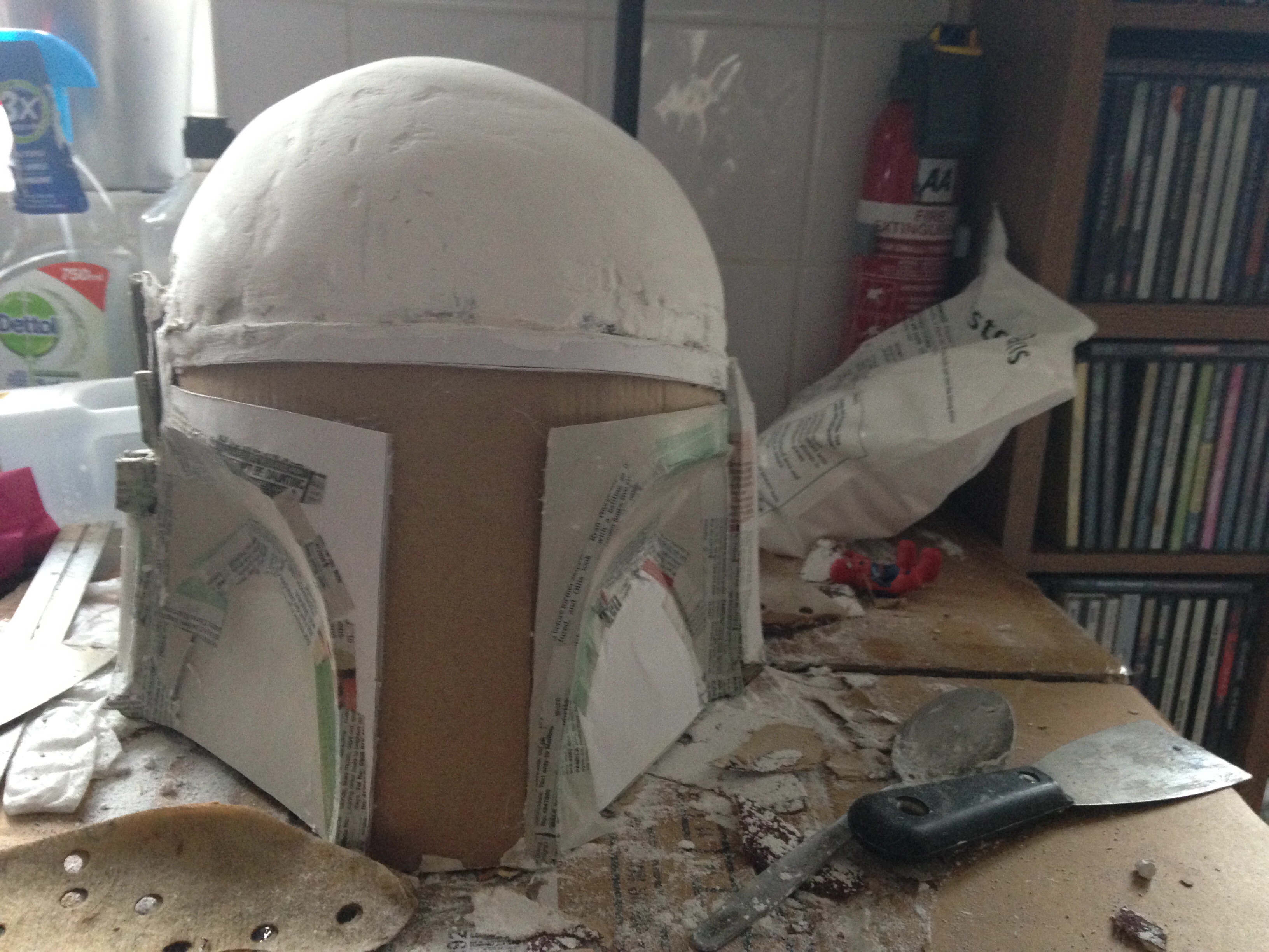

The sanding has been an interesting process
Again the process is slow and I will have to add another layer of plaster before anymore sanding
"The sanding has been an interesting process "
Bwahahahaha!!! You're kidding, right? Ok to clarify, I'm not trying to be a smart mouth if it came off that way.
What I really mean is you didn't cuss that part of scratch build to oblivion? I sure as heck did. I nearly burnt up an oscillating tool trying to round perfect round spots and keep sharp certain angles in the Zam helmet I am working on. I had a few bubbles that showed up that I have filled in just this morning and will sand it down after my kids get home from school today. I still have alot of detail to get hammered out too. But your helmet is looking wonderful. I think your method is working beautifully.

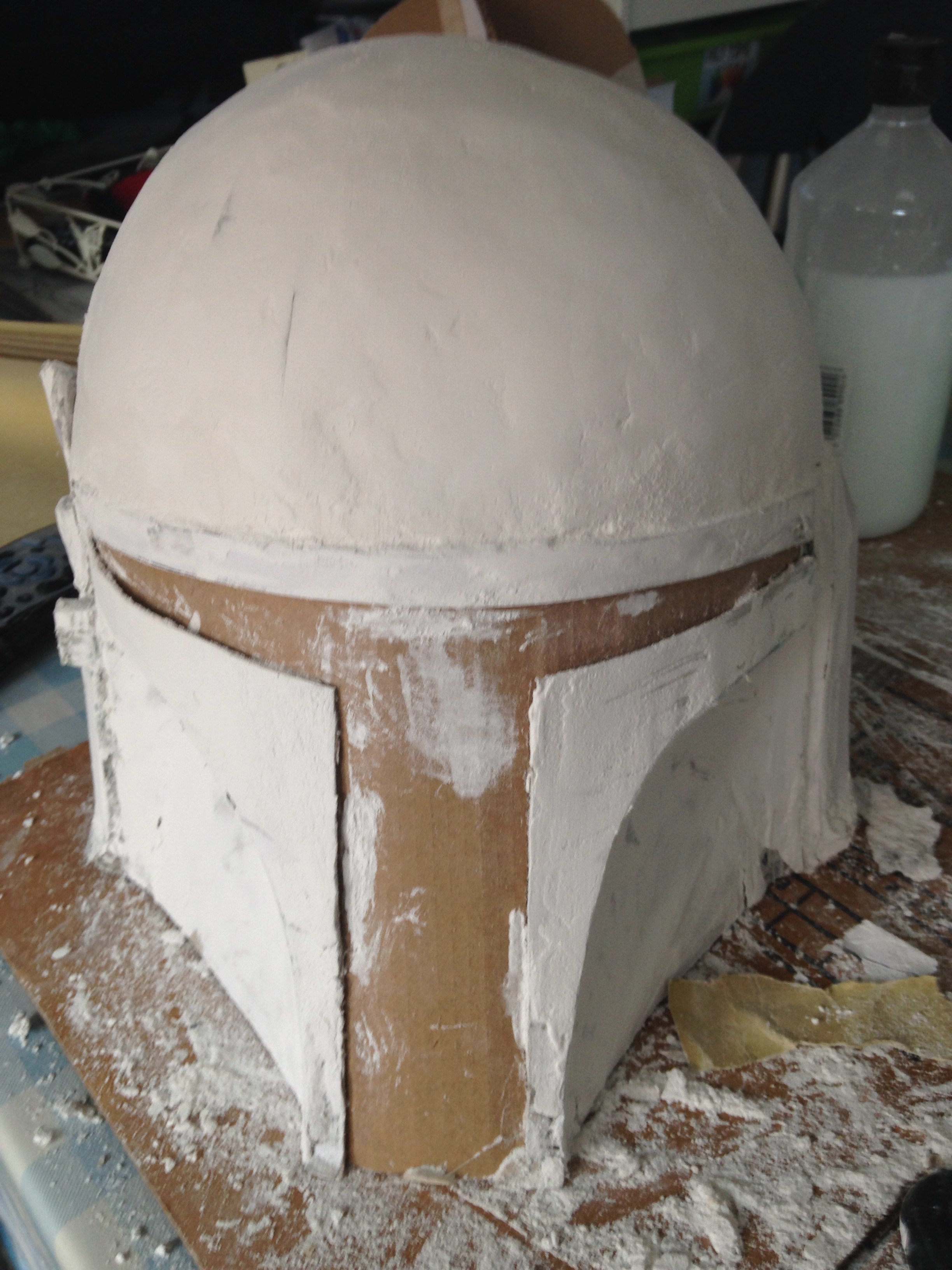

Ha ha ha ..... Ok yeah there were a few moments when I did on some level consider whether I should of gone with a car filler rather than plaster but I think I can work this out. Might sound daft but I have found it really helpful to walk about with the bucket. Seeing it in different lights from different angles made the sanding much easier to find the spots that need work. I still have a long way to go but so far it's working out(ish)
Well my build has taken a few knocks time wise due to various life adventures but this is me so far
It has been quite an evolution and I am learning all the time

Nice going! However the dome looks a little off...it seems slanted to the left. That's the only thing I can really say at this point. Keep it up!
