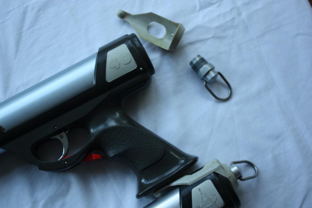

Does anyone have a link or any assistance in getting a Pulce 40 disassembled to look like the ESB version?

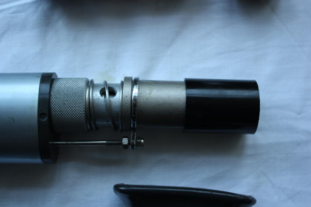

Unscrew the tip and slide the plastic sheath off.
There's a thin rod with a little nut so unscrew that too then everything else slides off. Be careful here because there are some balls inside although you won't need them.
The plastic oval should slide out with a bit of effort.
Unscrew the nob at the back with the d ring attached.

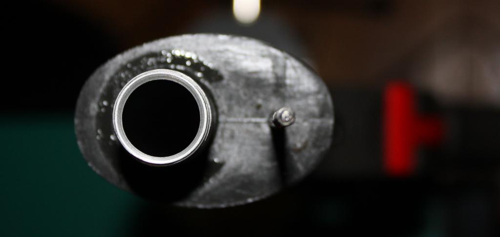

Knock the pins the body of the gun through with a tap and that will allow the tube to slide free.
Now you can see the inside mechanism and remove that long rod.
After that it all goes back together quite easily and the pins are just pushed back in to hold it all together.
The pin holding the red trigger clasp in place is removed by tapping through as well.
There will probably be a lot of gunk and grease inside so make sure you prepare for that.

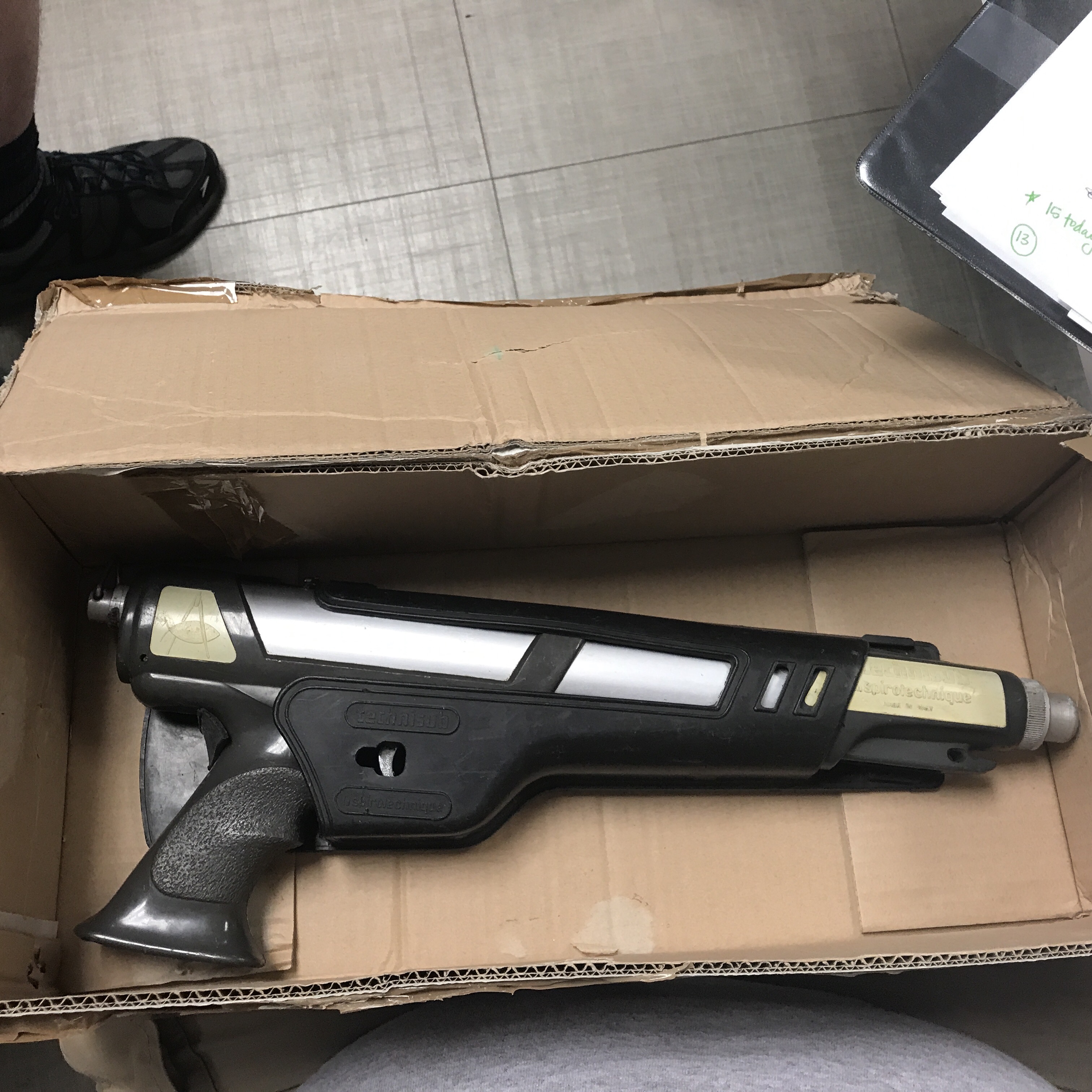

I just picked one up on eBay for $500. I honestly can't quite remember, but I believe the last one I bought went for around $800 or so. There is one on the RPF right now for $1000.
Now that I have two, I am finally willing to mod one out to ESB sidearm. Still trying to figure out that paint....

I'm still thinking poorly painted with Zinc chromate primer with the original colour showing through giving the grey tones.
I am still trying to work out how to make the trigger continue to work without the rod showing on the front end. I THINK I have it resolved... we will see.
So... found a solution.
I pulled the upper receiver apart (it is just pressure fit together) and the. Resinserted the back/barrel back into the grip. I took the trigger rod, cut it way down and retreaded it. I added a spring and a bit to the shortened rod which made the trigger work again. Then I just slid the aluminum body back in place and put the barrel on! Done! Trigger works with no external visible changes.
For anyone wondering, the threading is M3 x 0.50
