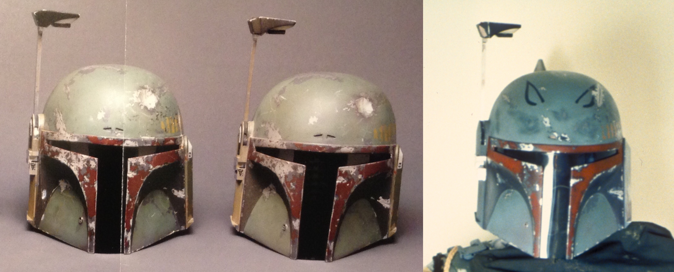

Regarding the similarity between the Pre-Pro #1, Pre-Pro #2 and ESB Hero; these are the Twin Helmets (as I call them), because most of them were painted by Joe Johnston and were meant to appear on screen (this is why the Pre-Pro #3 and the ESB Hero are so close in colors and paint scheme):
The other 3 helmets (the Sister Helmets), more exactly the Pre-Pro #2, Promo #1 (or ROTJ Hero) and Promo #2 (or Sandy) were painted by Daydream Productions (lead by Vance Lorenzini and Sandy Dhuyvetter) and while the colors were almost the same, the paint scheme was different for each helmet:
So the Joe Johnston paint jobs (PP1,PP3 and ESB Hero) clearly show black upper cheeks but am I crazy in thinking that the Daydream Productions paintjobs (PP2, ROTJ Hero and Sandy) appear to sport greenish, dark teal upper cheeks? I've felt that way a long time but I don't seem to see much talk of it or see it reflected in most paintjobs we see posted here.
