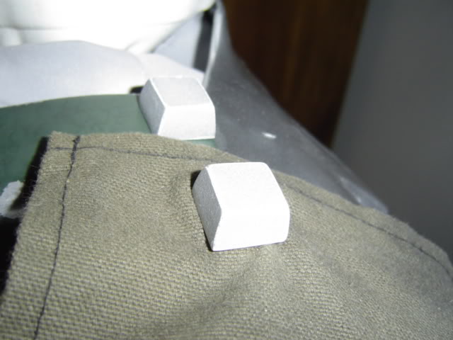

These are my BM collar studs painted and ready to go...
But then you come to the inevitable problem. What's the best way to attach them to the collar?
Glue, bolts, tape, hopes and dreams, mucous?
Here's what I came up with...

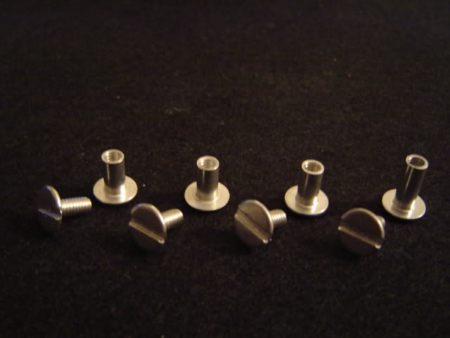

I love the hardware drawers at Ace Hardware. They have the best selection of different stuff that I've found just about anywhere. Thats when I found these...
They are called aluminum binding posts. They come with the screw and run .65 each for the shorter one and .70 for the longer one. (The longer one goes through the cape)

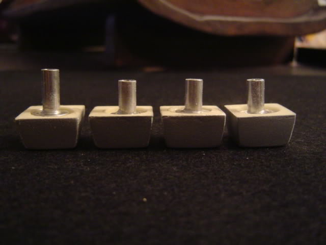

I started out by drilling holes through the collar piece and through the backplate. (sorry no pics, but a hole is a hole, right?)
After that step I took each stud and drilled just slightly into the bottom side of each one. Just enough to accomodate the head of the binding post. Then I lined them up to the armor and put in a couple of drops of Superglue. After they were in I added more superglue and let dry overnight (so the superglue fumes would be good and gone). So this is what I had at this point...
The post goes through both the collar and the backplate and the screw goes up from the underside and voila instant attachment.
One of the best things about this for you troopers out there is that the screws on the underside of the armor are extremely thin and wouldn't even be noticed.
