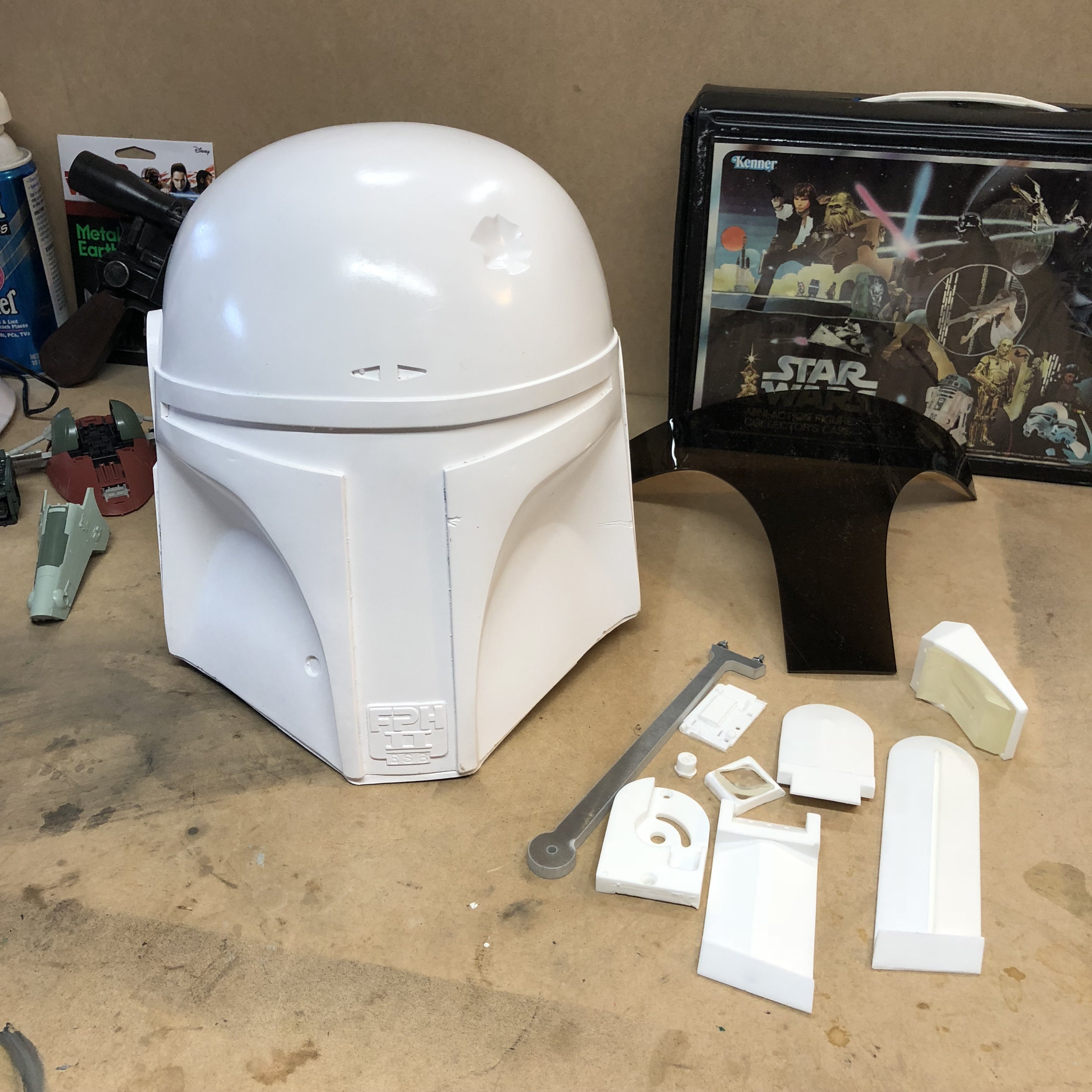

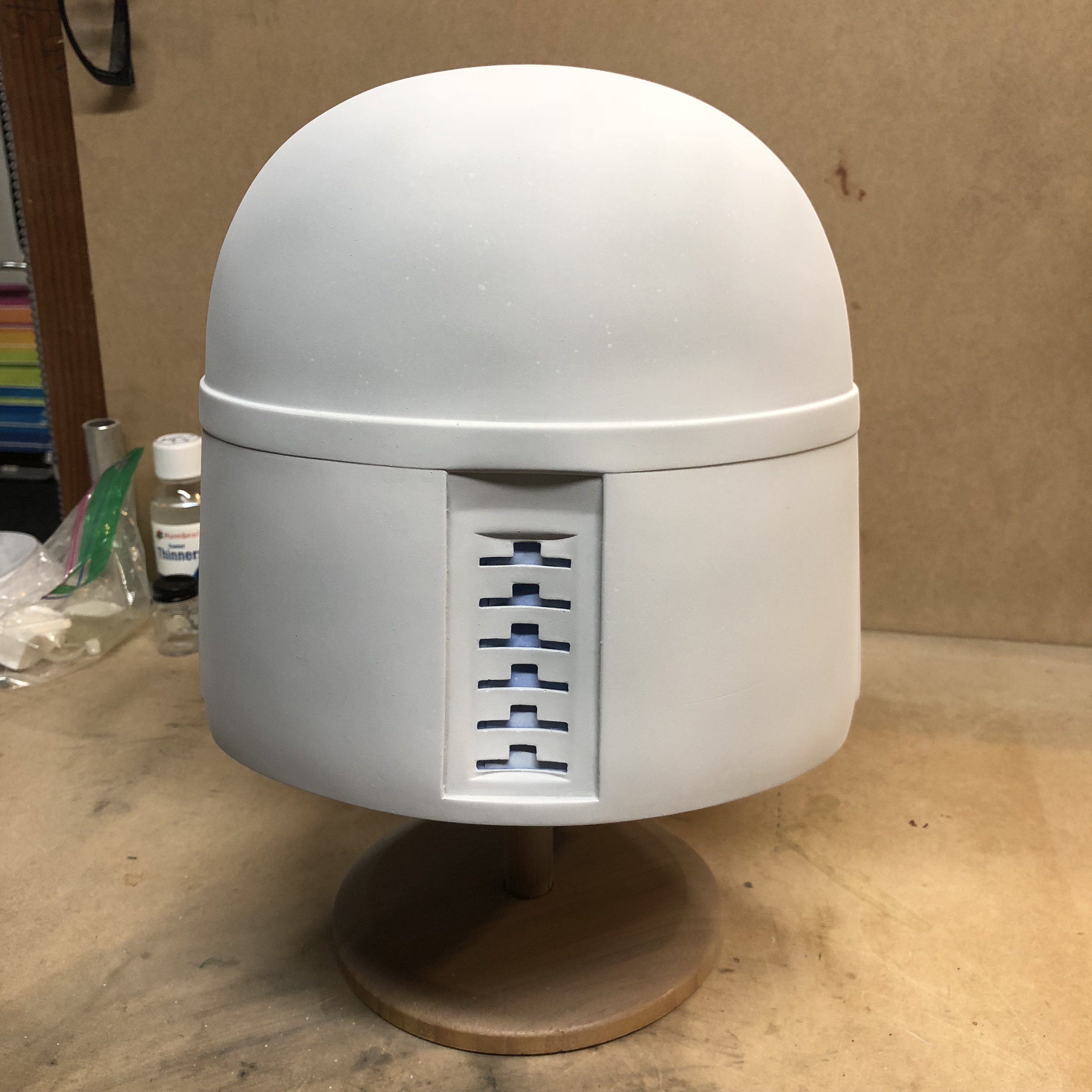

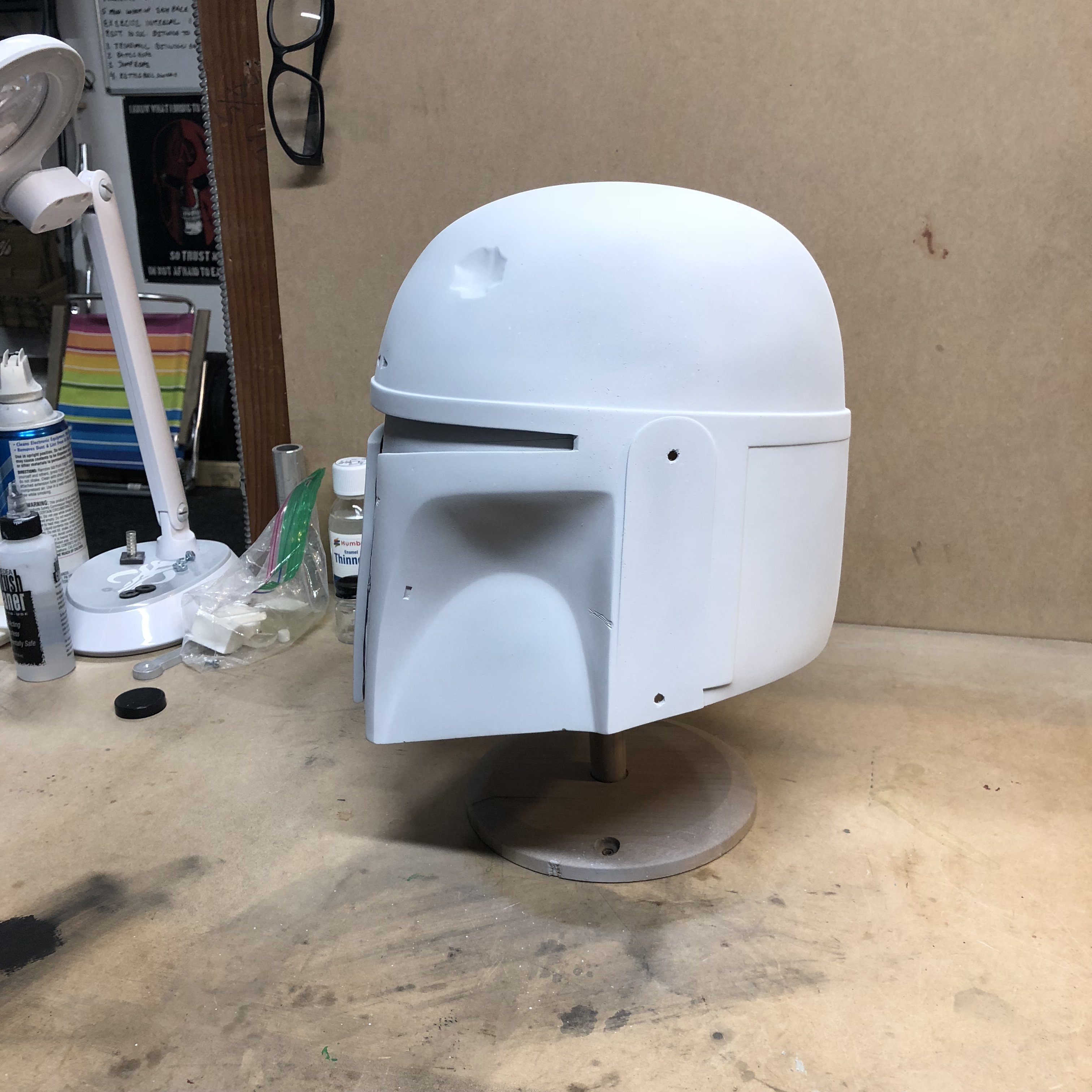

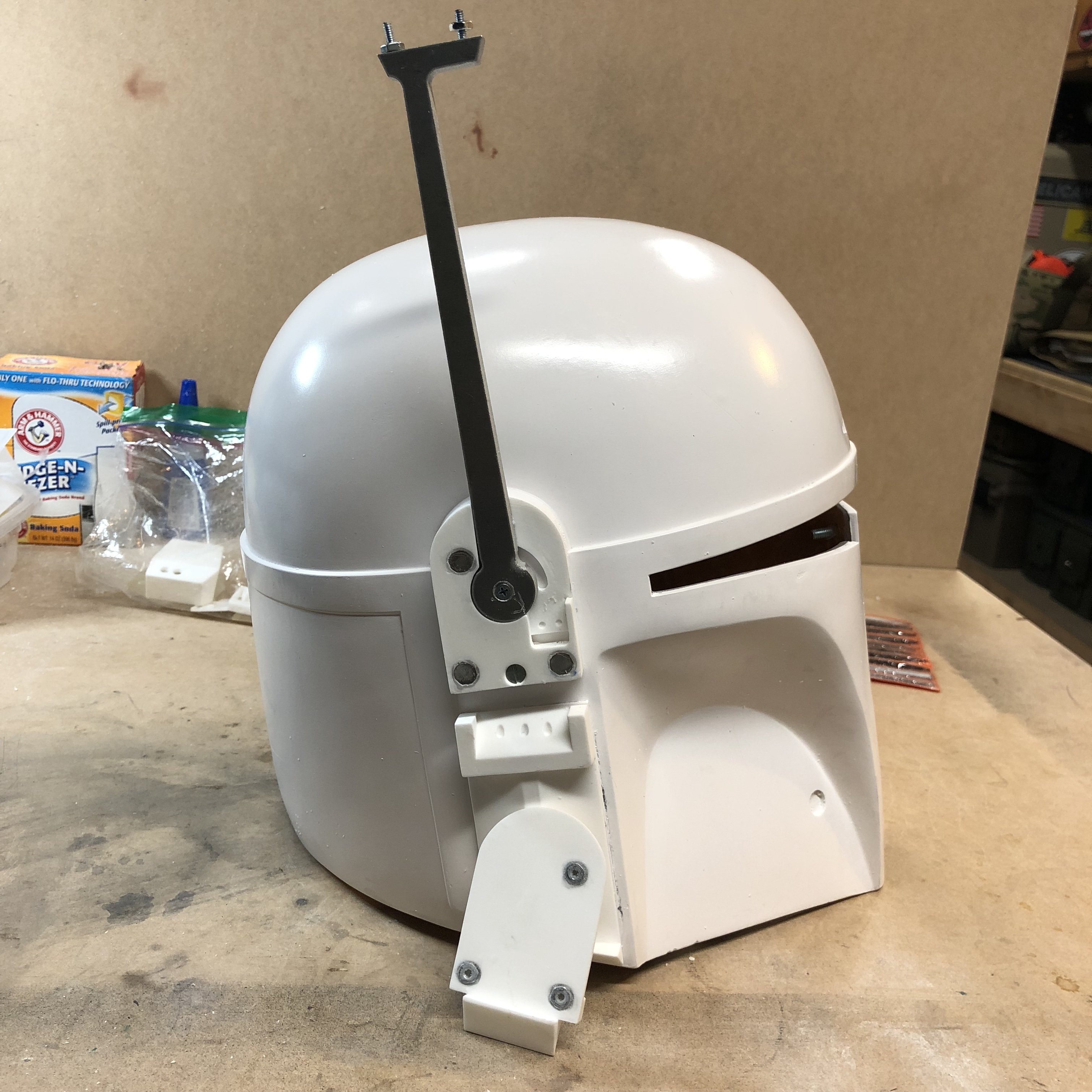

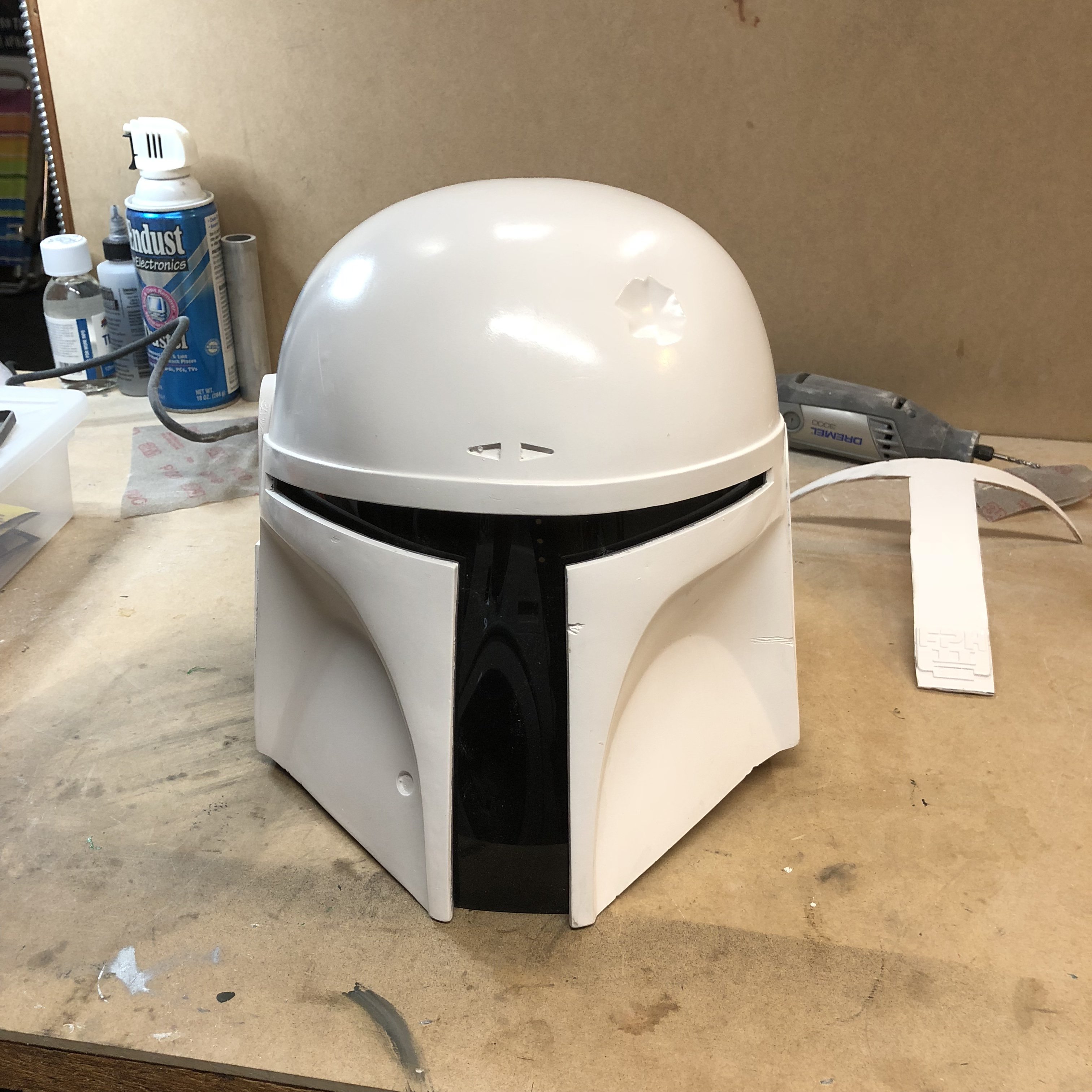

So it begins just received my ESB FPH2 Boba Fett helmet from the Wasted_Fett. I am super happy with his cast. I will be sharing pictures as I make progress through the build.

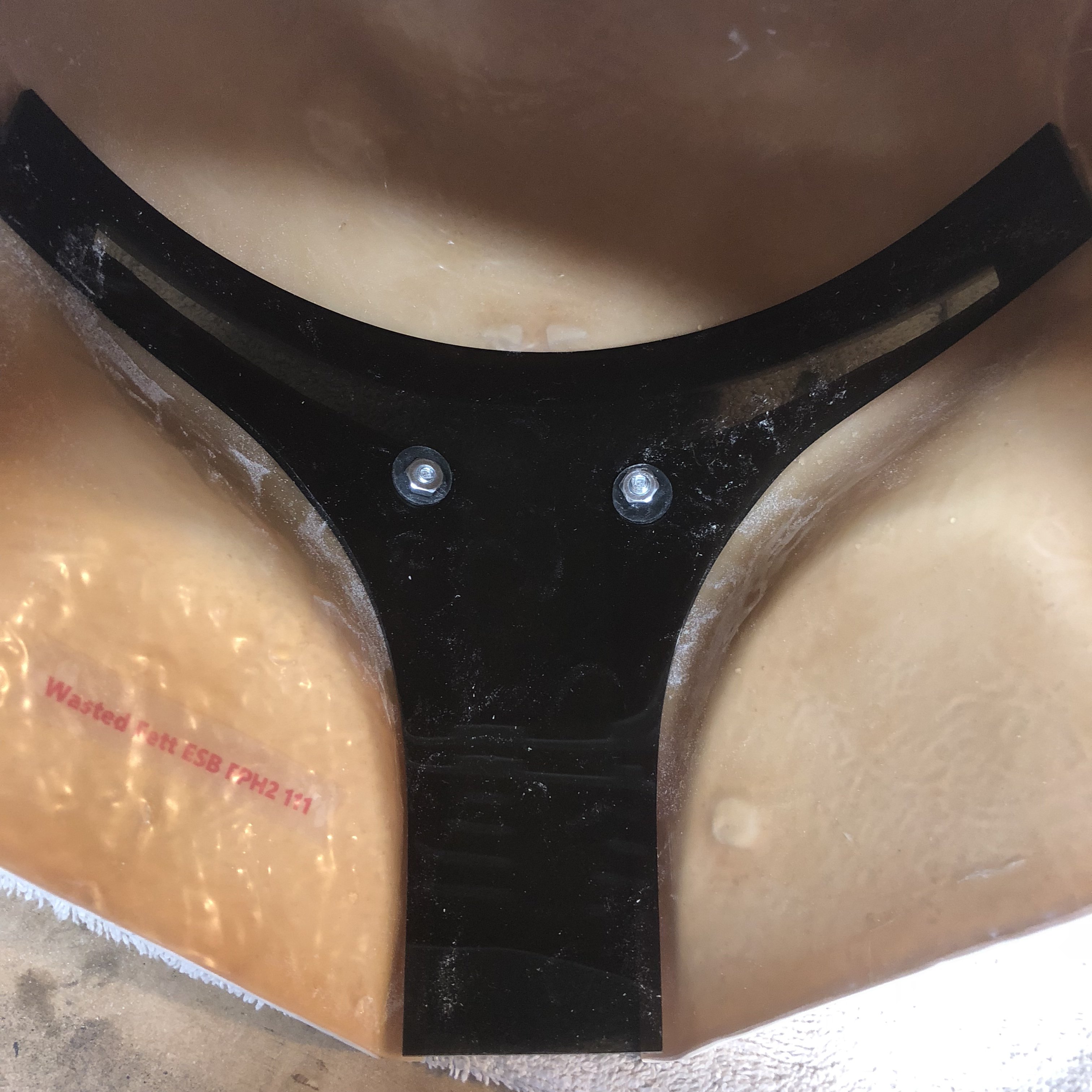

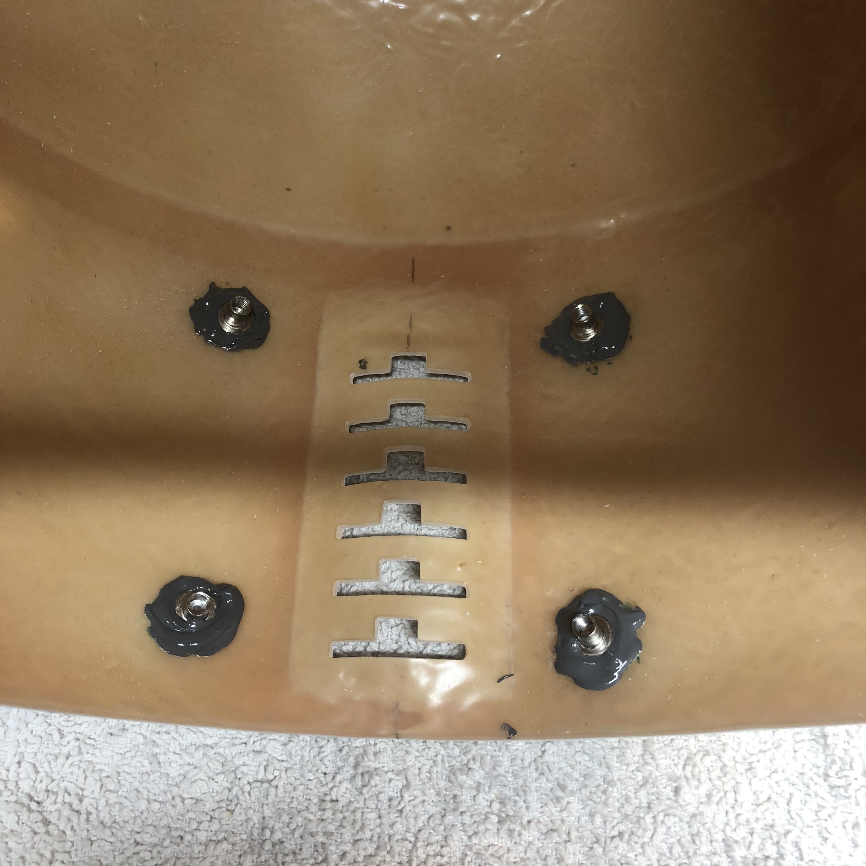

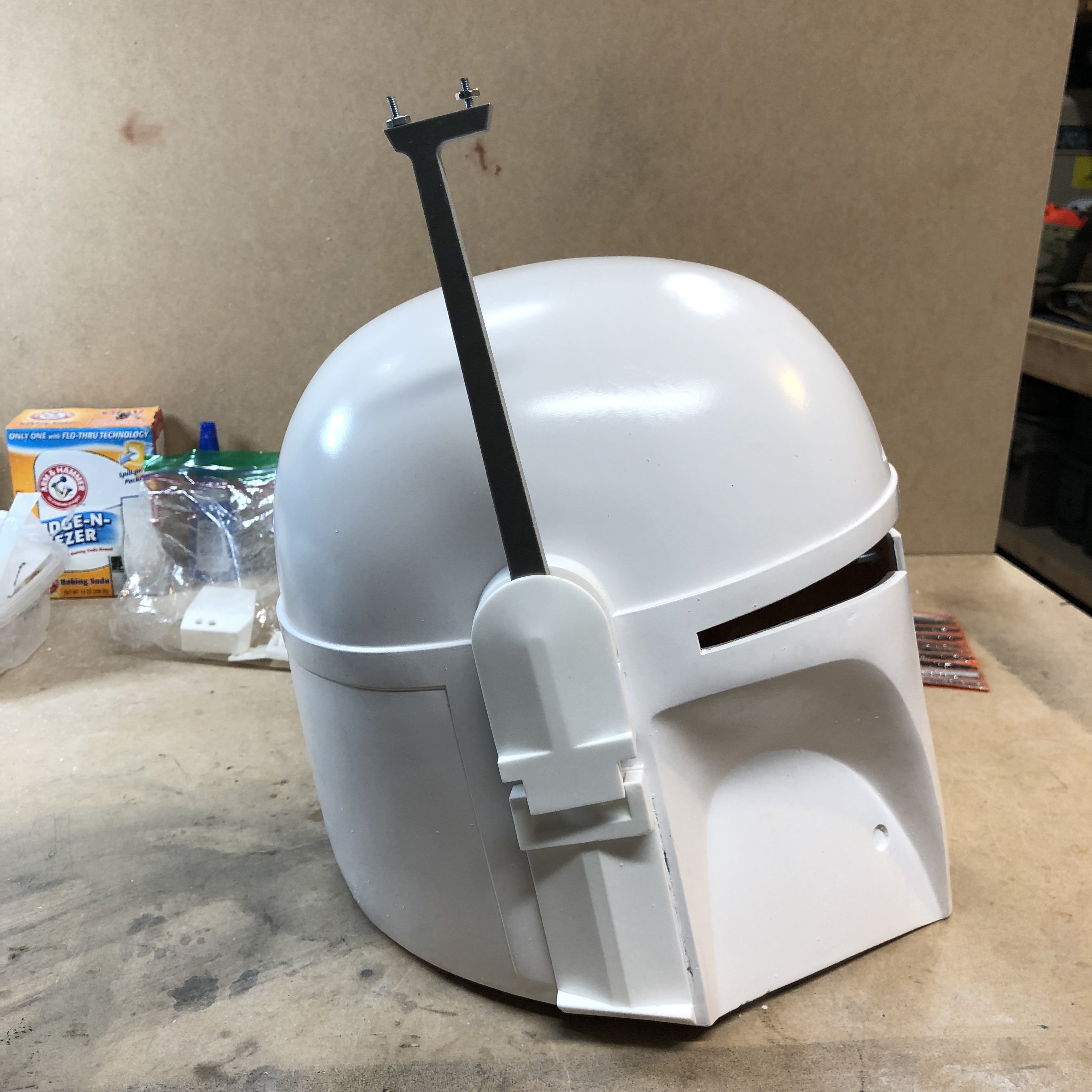

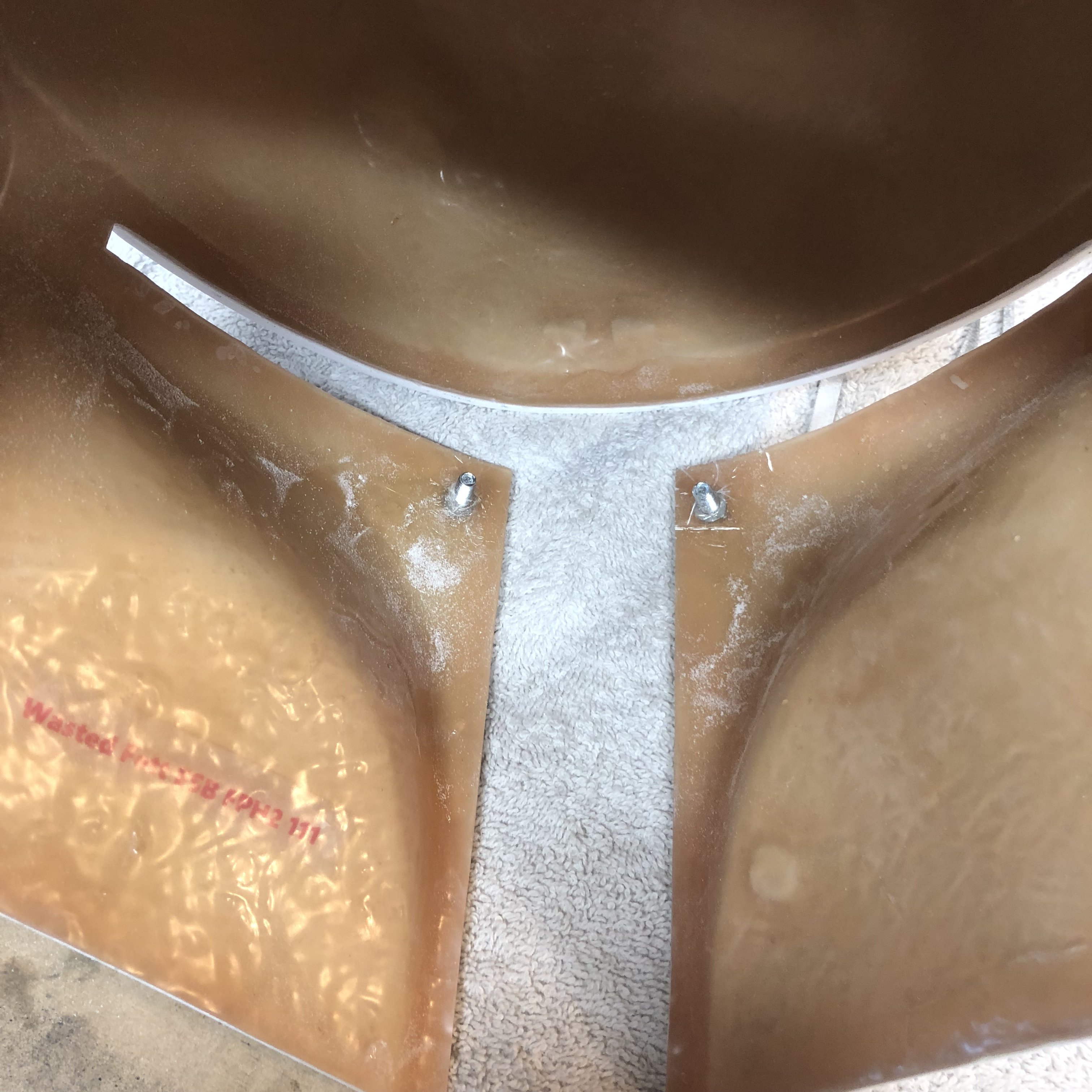

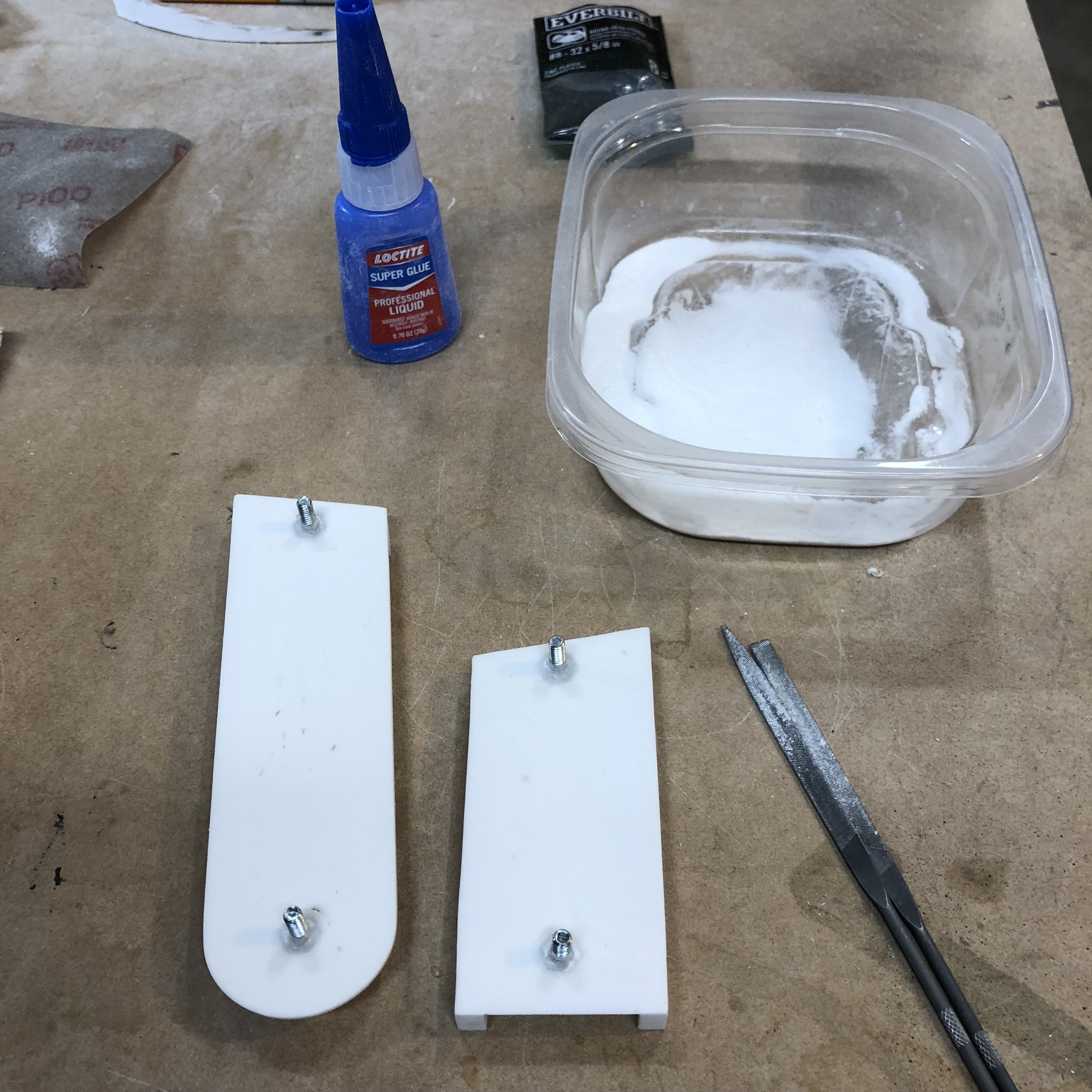

16391669-AACB-44A2-8476-1CDCE348C4E4.jpeg 129746F8-FDCC-429D-9FDC-CC0C49573AA8.jpeg 44C53749-11AF-4EE3-9B4B-CDB117884F7E.jpeg 6D4E3B79-5957-4A18-8822-75B13FD5239B.jpeg 6B28795A-FDC1-4C2C-A383-2164B3505E03.jpeg 7C68485B-F6DC-4D6F-AB18-34CBA63CACA3.jpeg More progress from yesterday and today. Finished the Key Slots. Set screws in the ears. Mounted the ears. Installed magnets in the upper right ear and small nuts on the ear cap. And fitted the stalk.

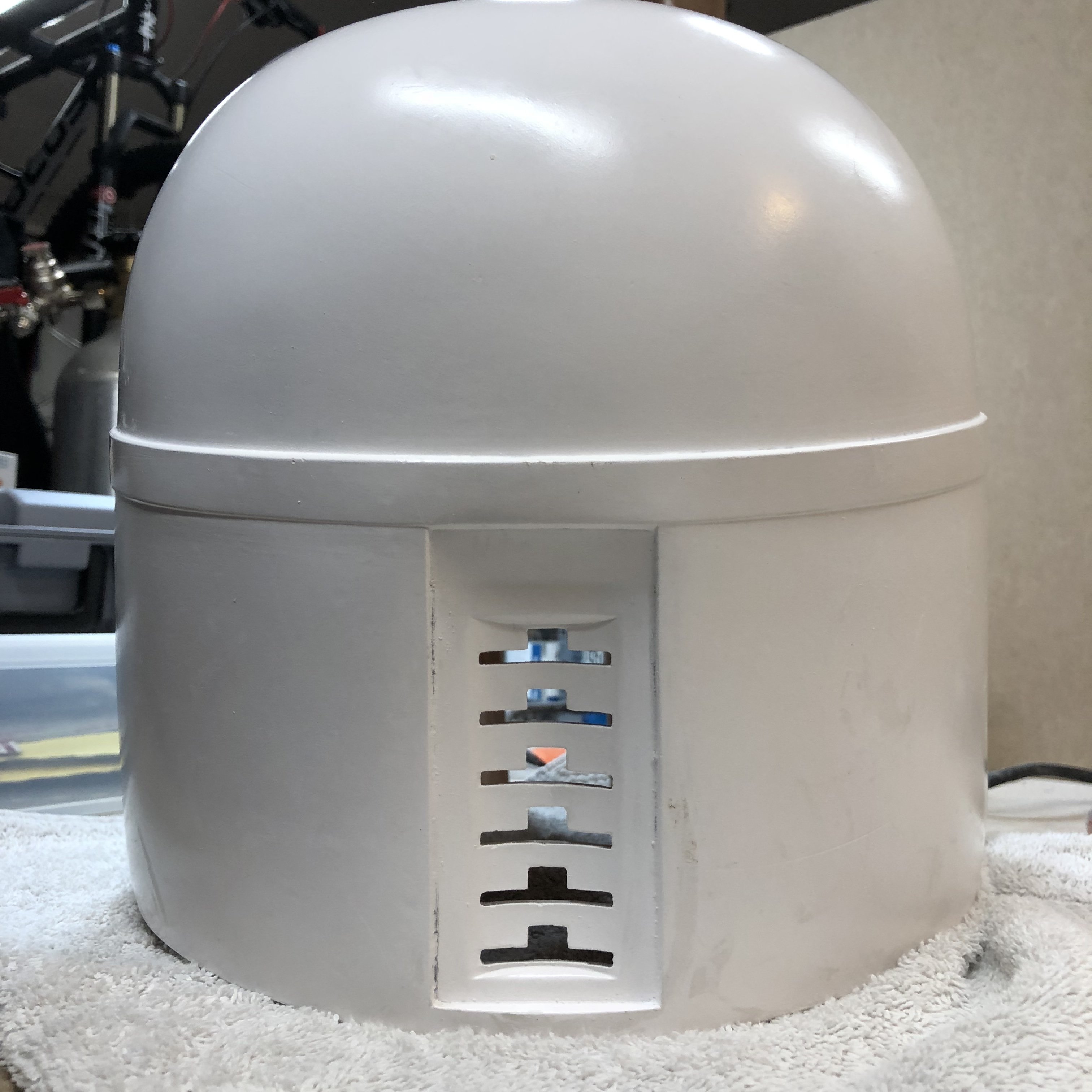

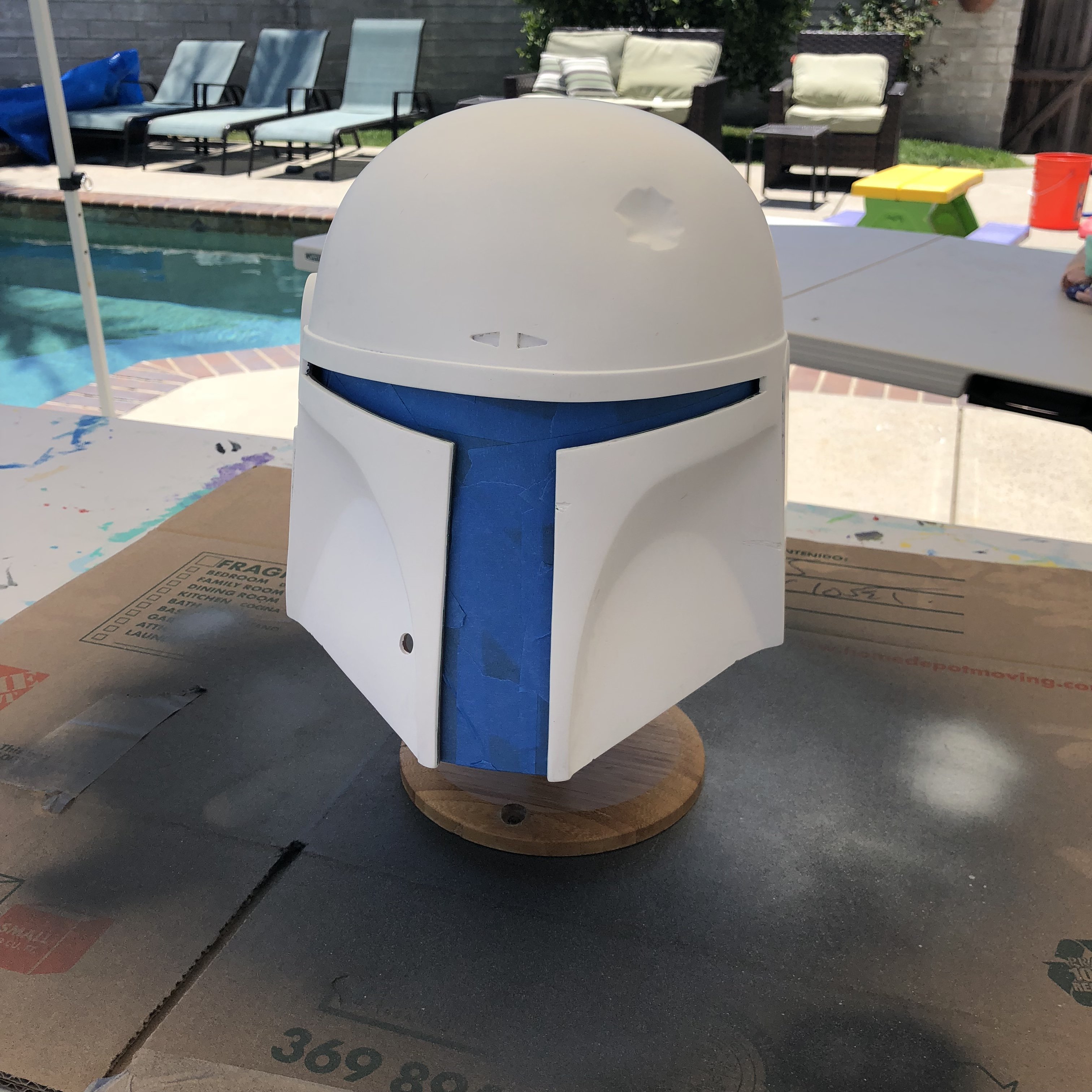

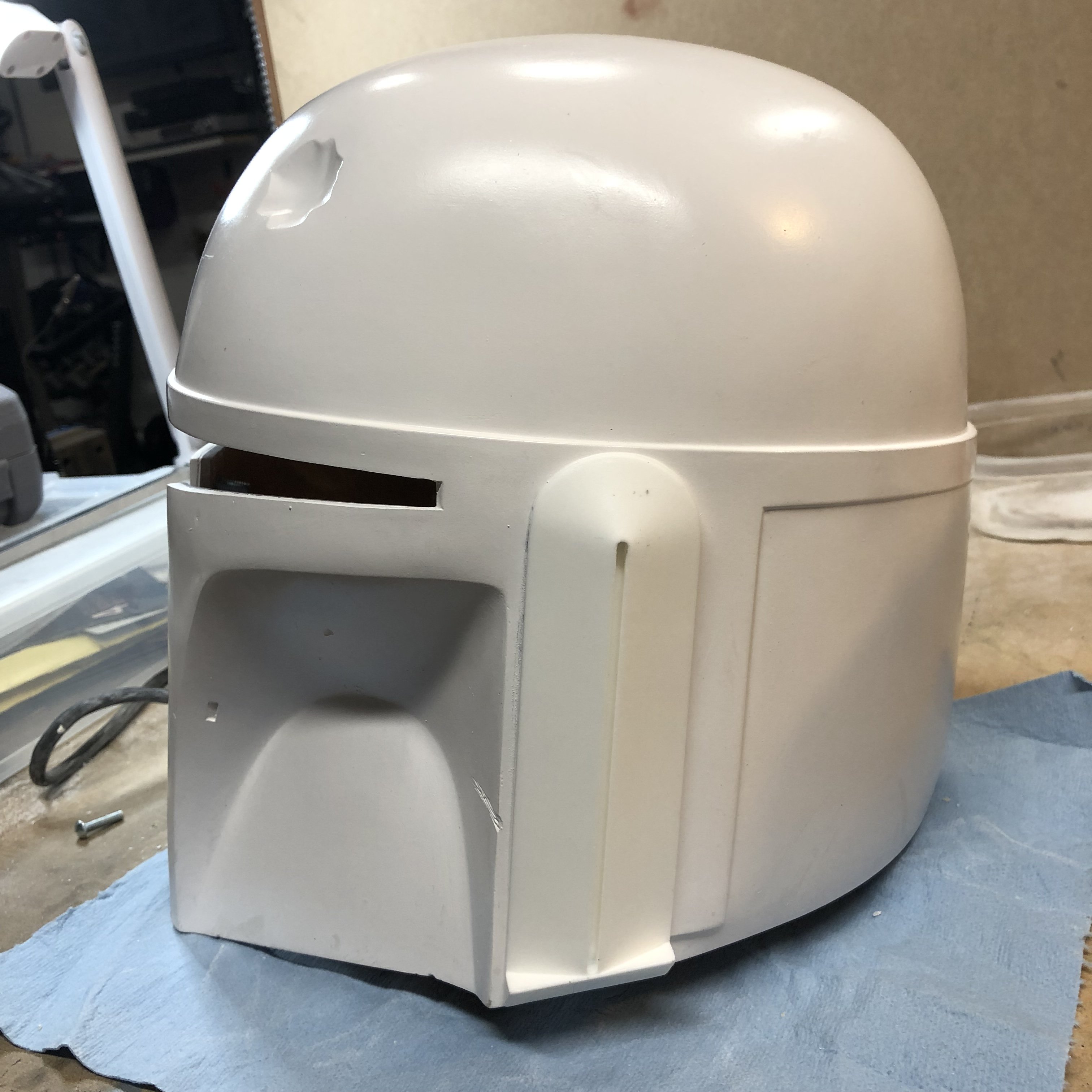

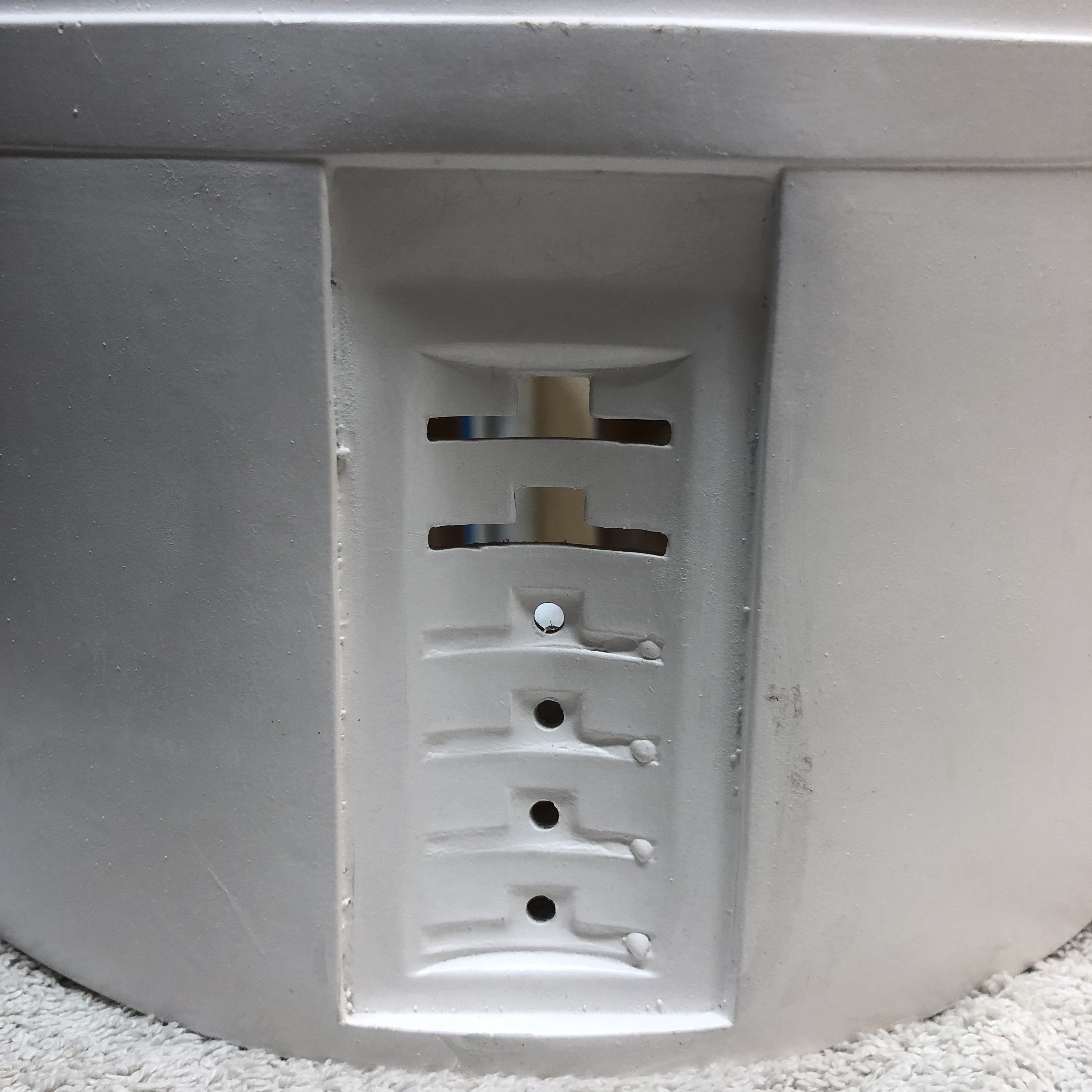

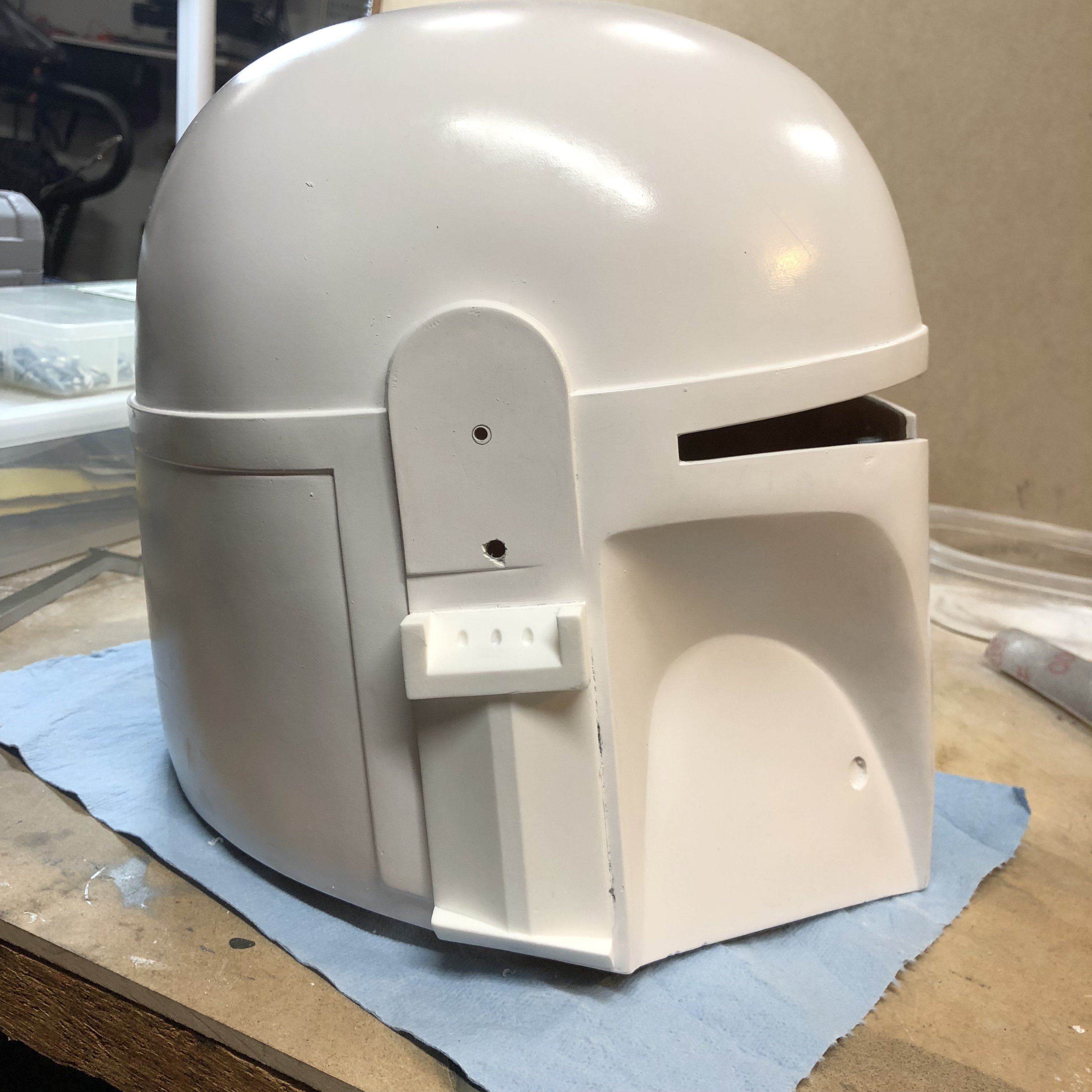

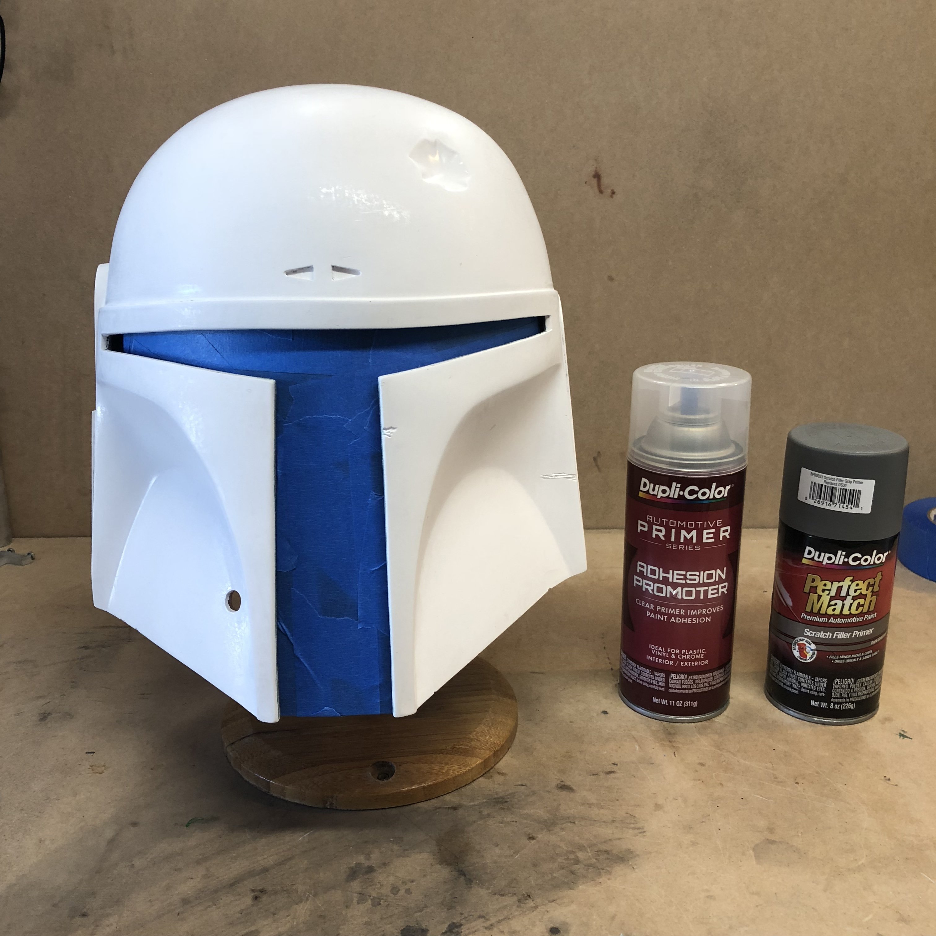

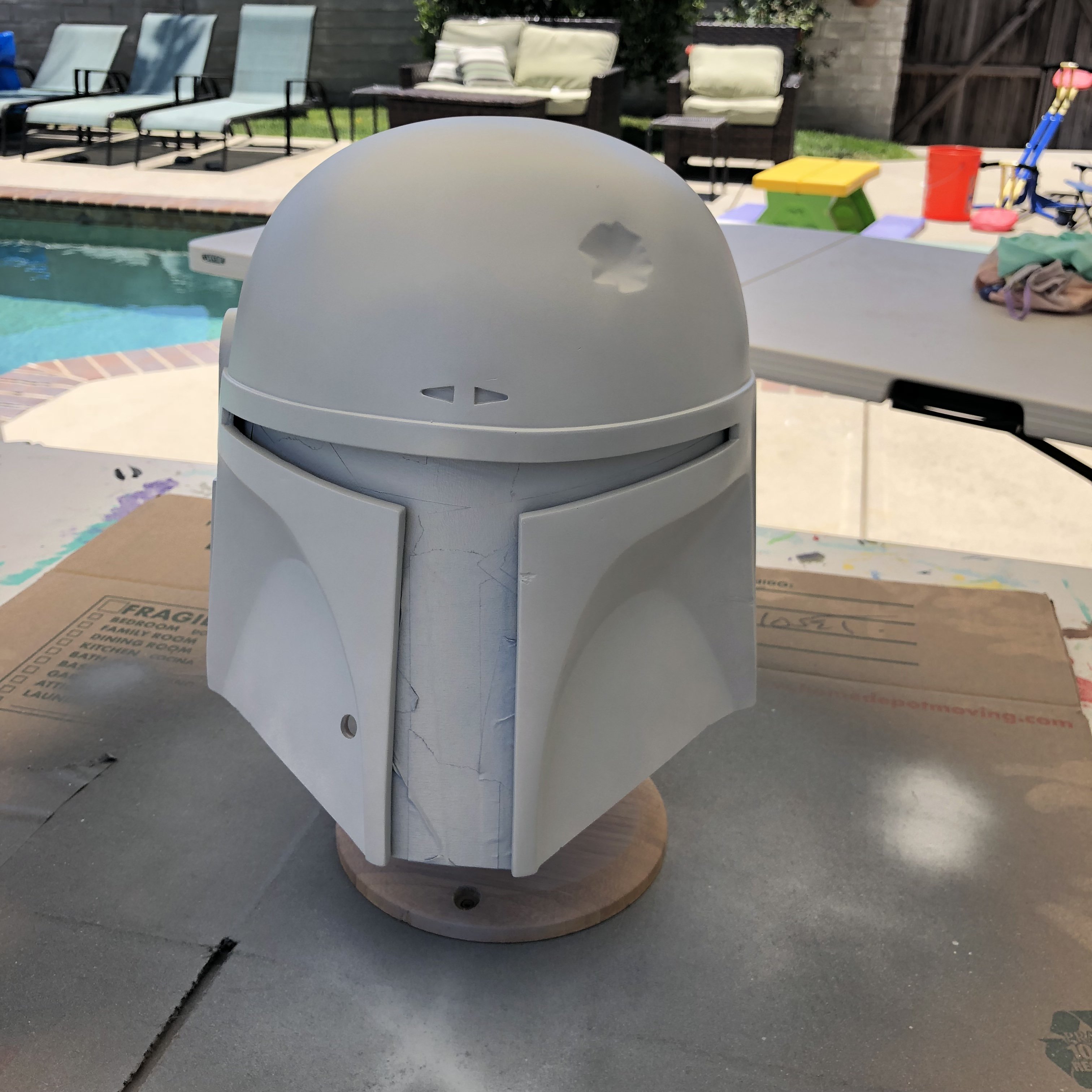

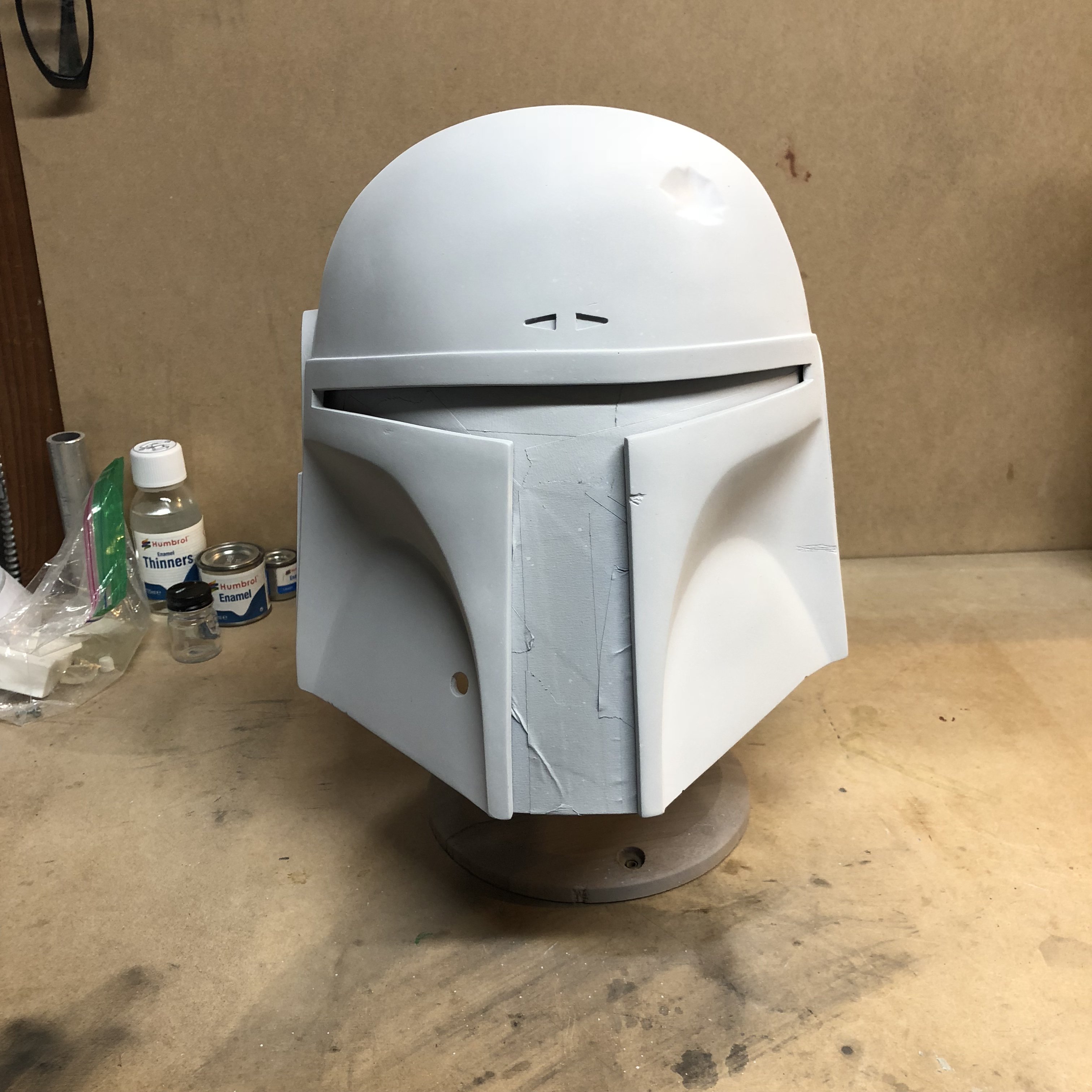

CEAAFFCD-B6E1-46F6-B8CB-BB00386EB41D.jpeg 9D8AD8B9-C902-4A57-8109-594252C599C5.jpeg C6084B5B-AA54-4F77-B114-C87DDBE65995.jpeg 5C457A10-8249-451C-B9C6-5E16348D10FB.jpeg 6A2A361A-BD30-4EC3-B7D3-3150E3C44824.jpeg CEAAFFCD-B6E1-46F6-B8CB-BB00386EB41D.jpeg 9D8AD8B9-C902-4A57-8109-594252C599C5.jpeg I’m excited the Helmet prep is finished with wet sanding. Applied Dupli Color Adheasion promoter and Dupli Color primer. Got that idea from TheRealSuperJedi Now to let it dry and cure. Next is paint.

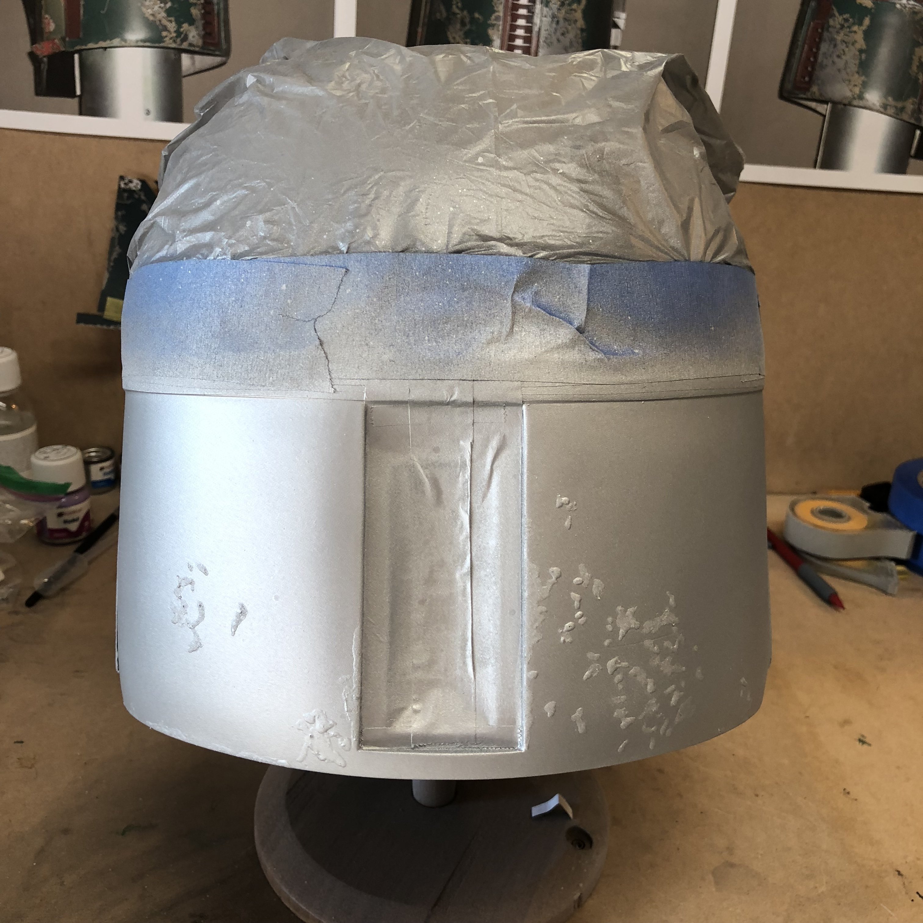

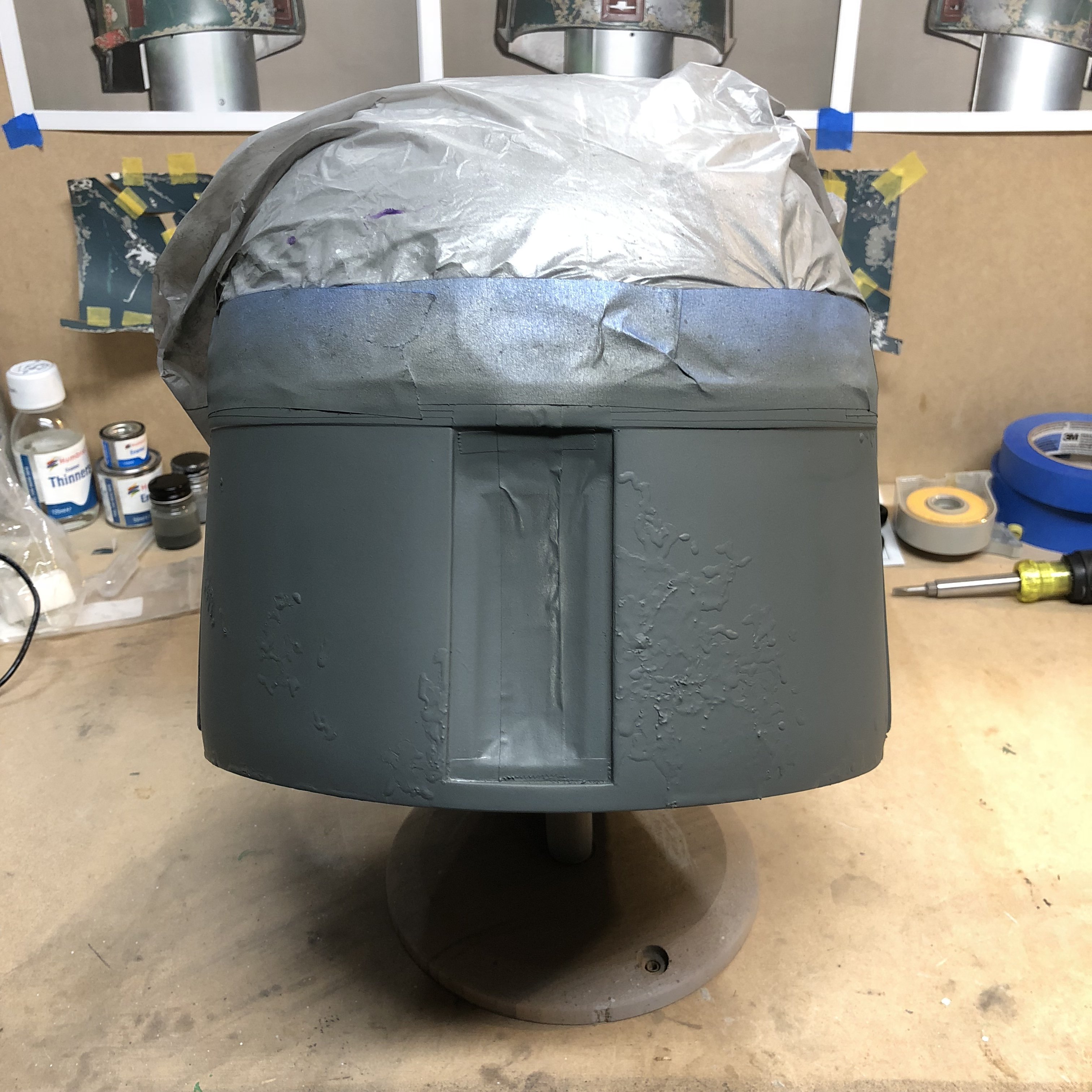

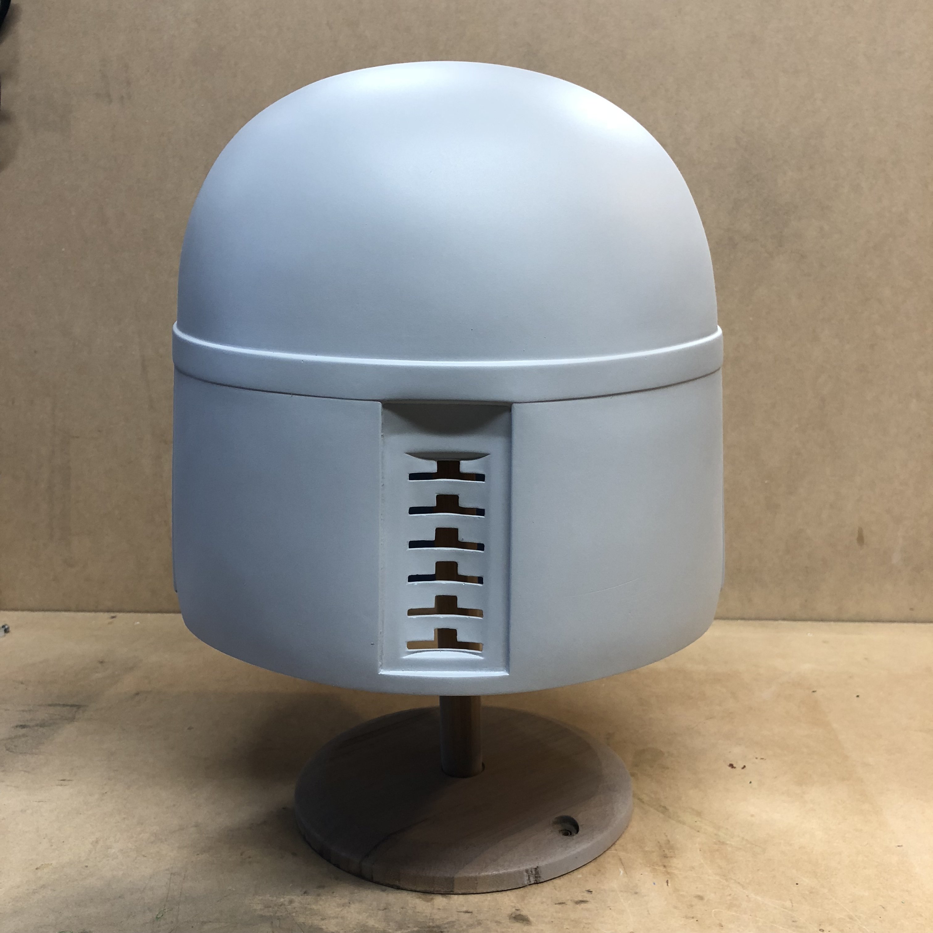

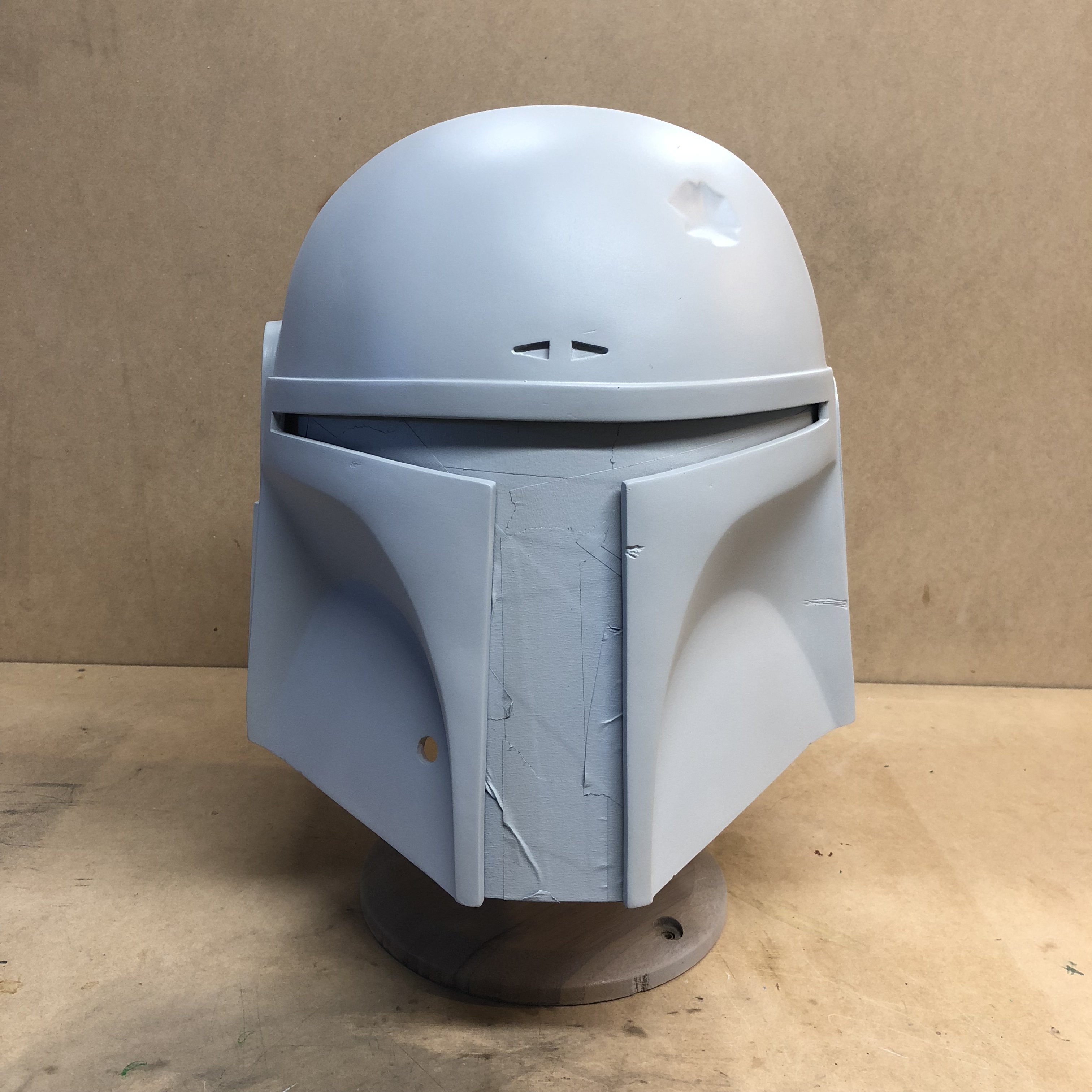

5BE1D1AF-4356-428F-A229-59DFE14E1A40.jpeg 38DAEE3A-051C-4118-947D-7E2E97FBB9F7.jpeg F20E9E3F-7352-4B60-AAF1-847524CA9BC4.jpeg Airbrushed on a layer of 147 light grey. Following Terminal Fetters Wafer Thin ESB paint up. Makes most sense to me since this is my first helmet paint up. I had a little splatter on the front part of the dome but will buff out. I needed just a little more thinner. Adjusted the thinner and Got a good coat on the back panels which I am starting next.

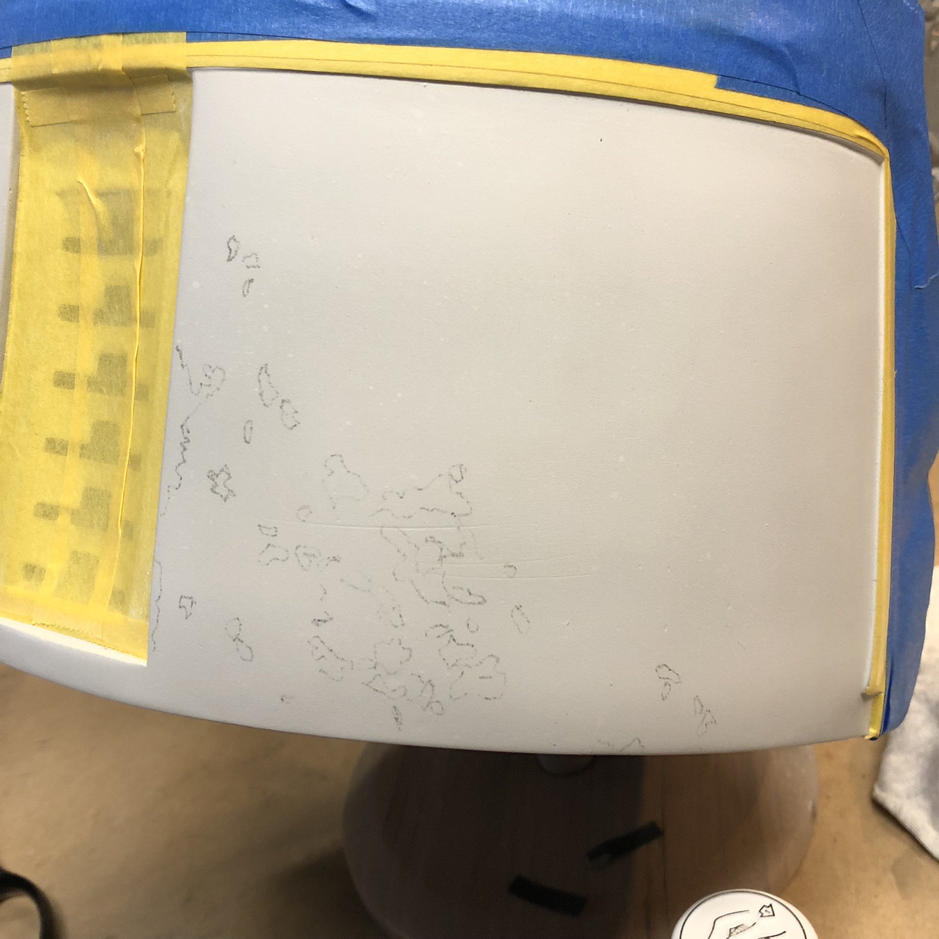

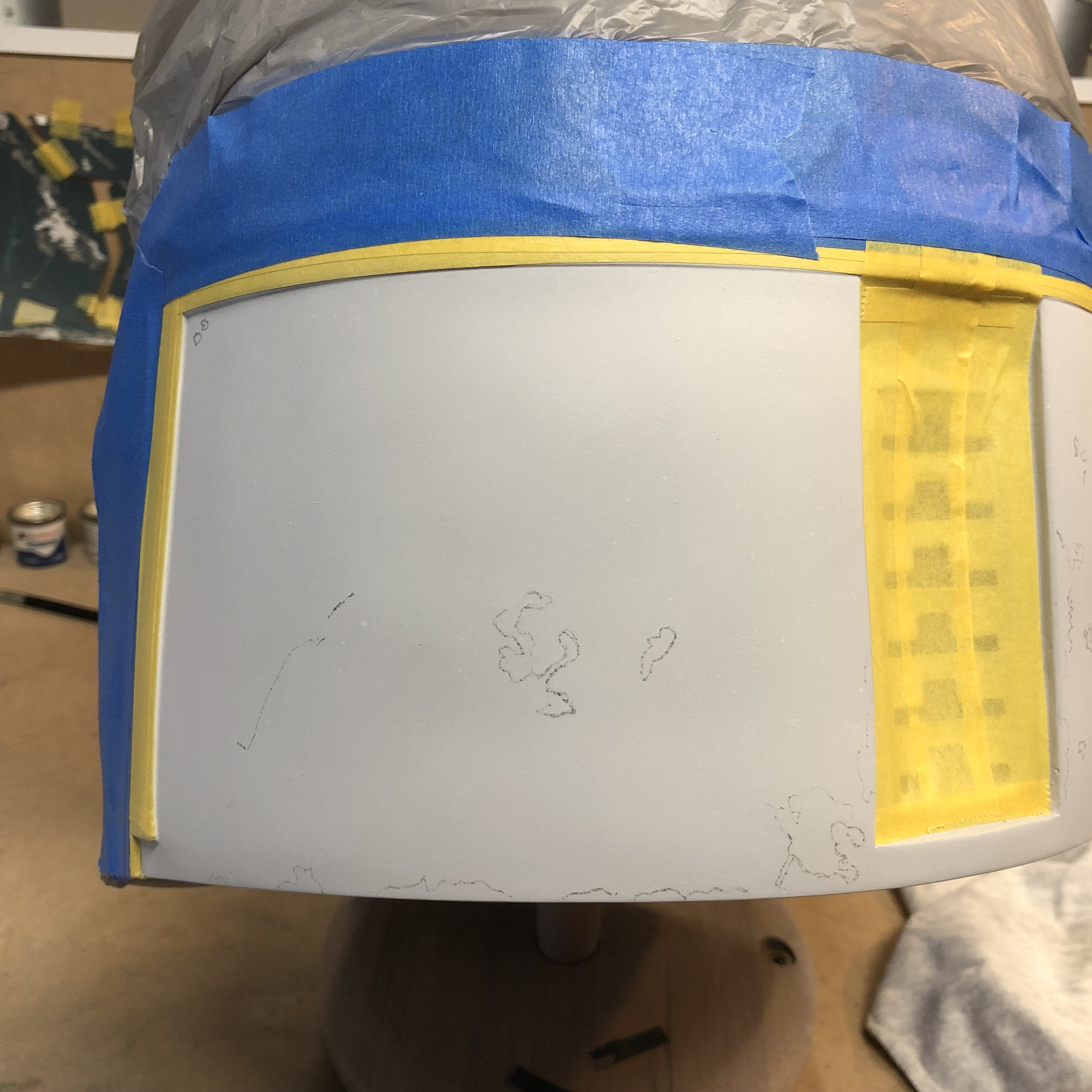

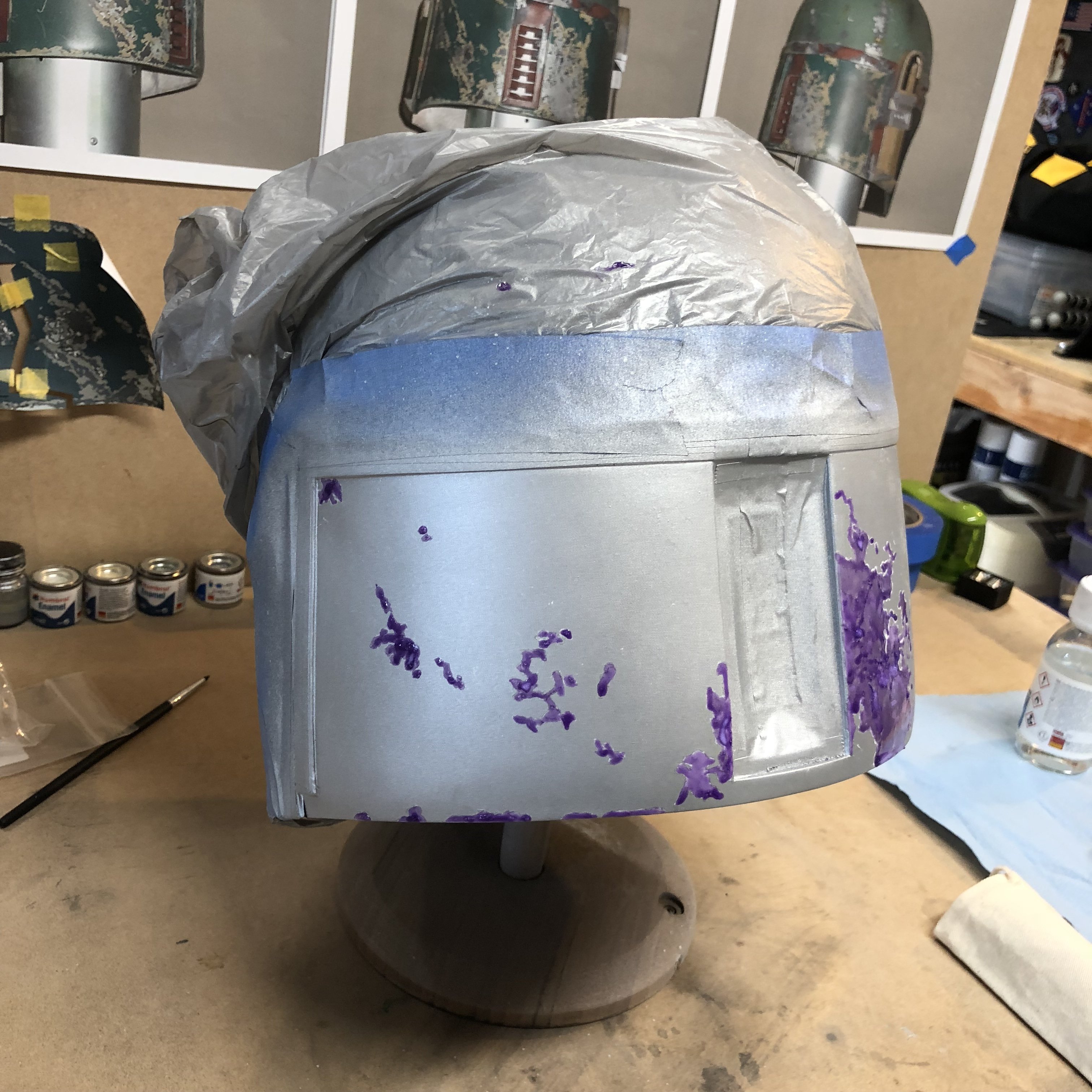

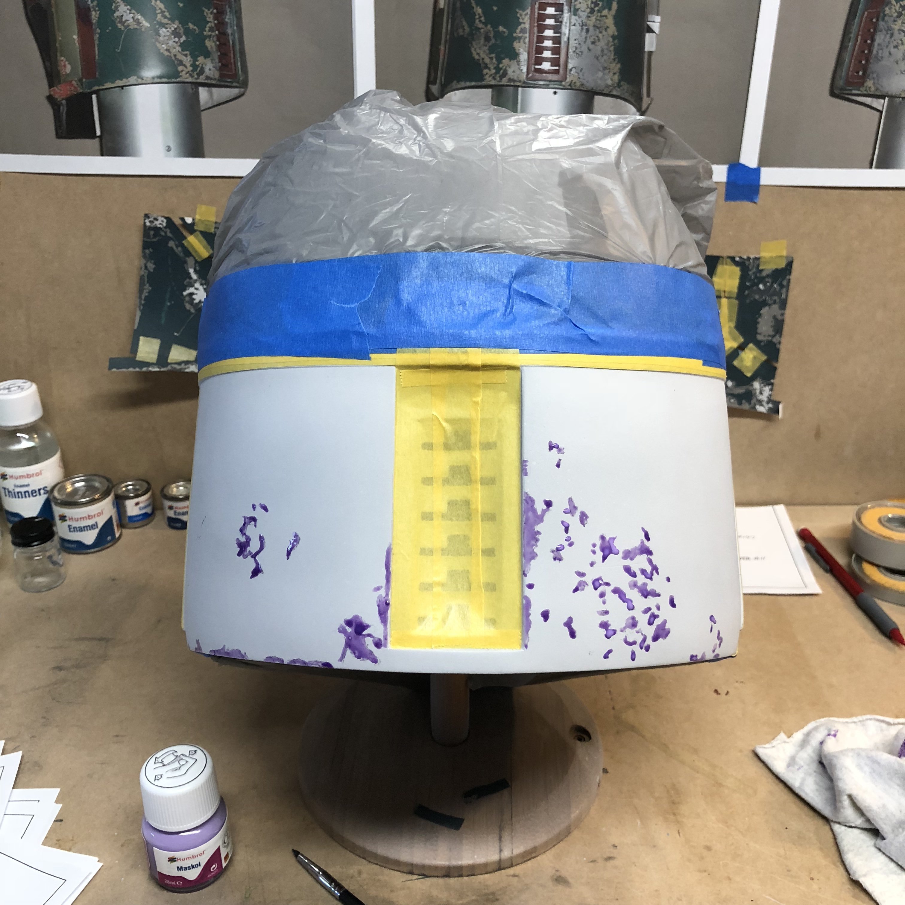

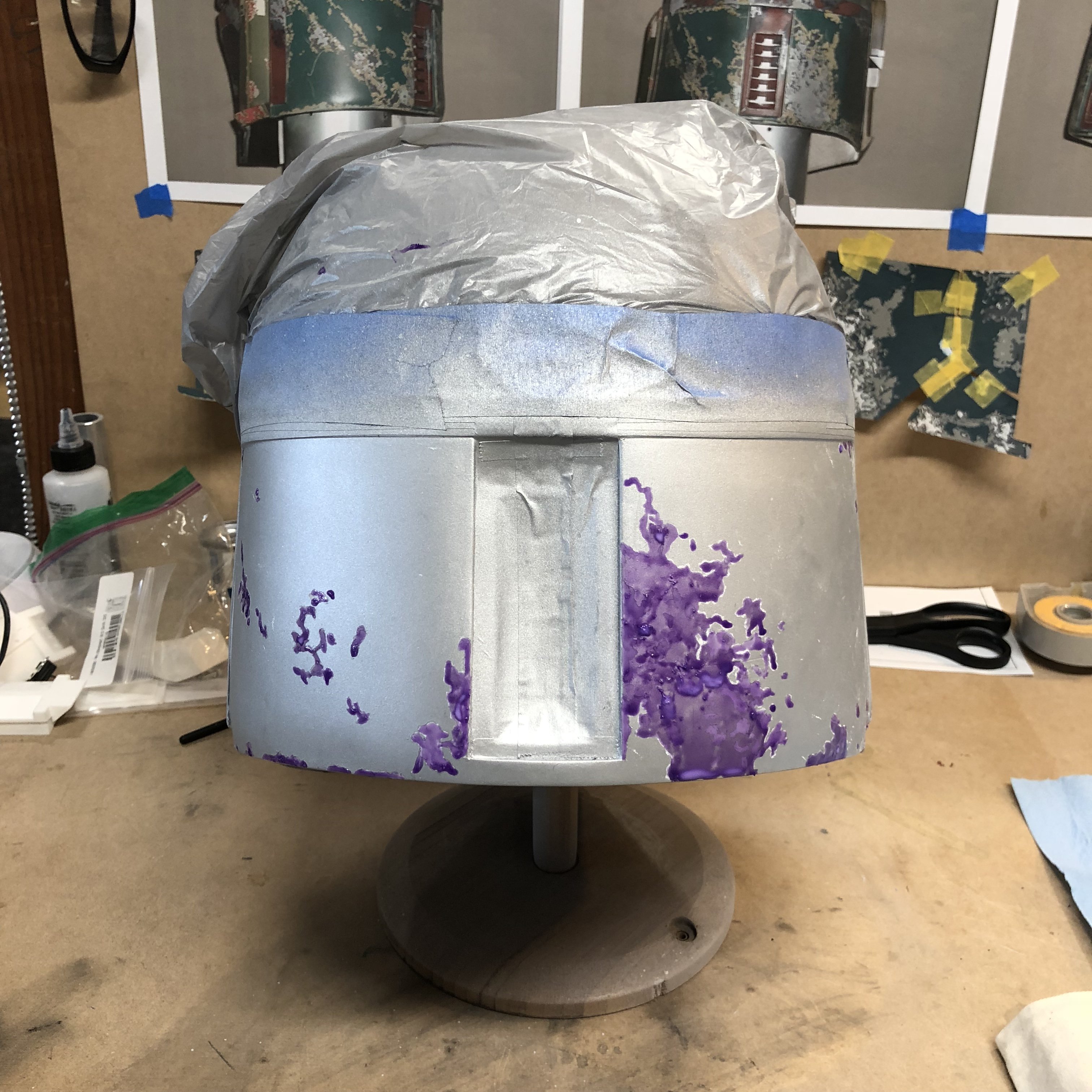

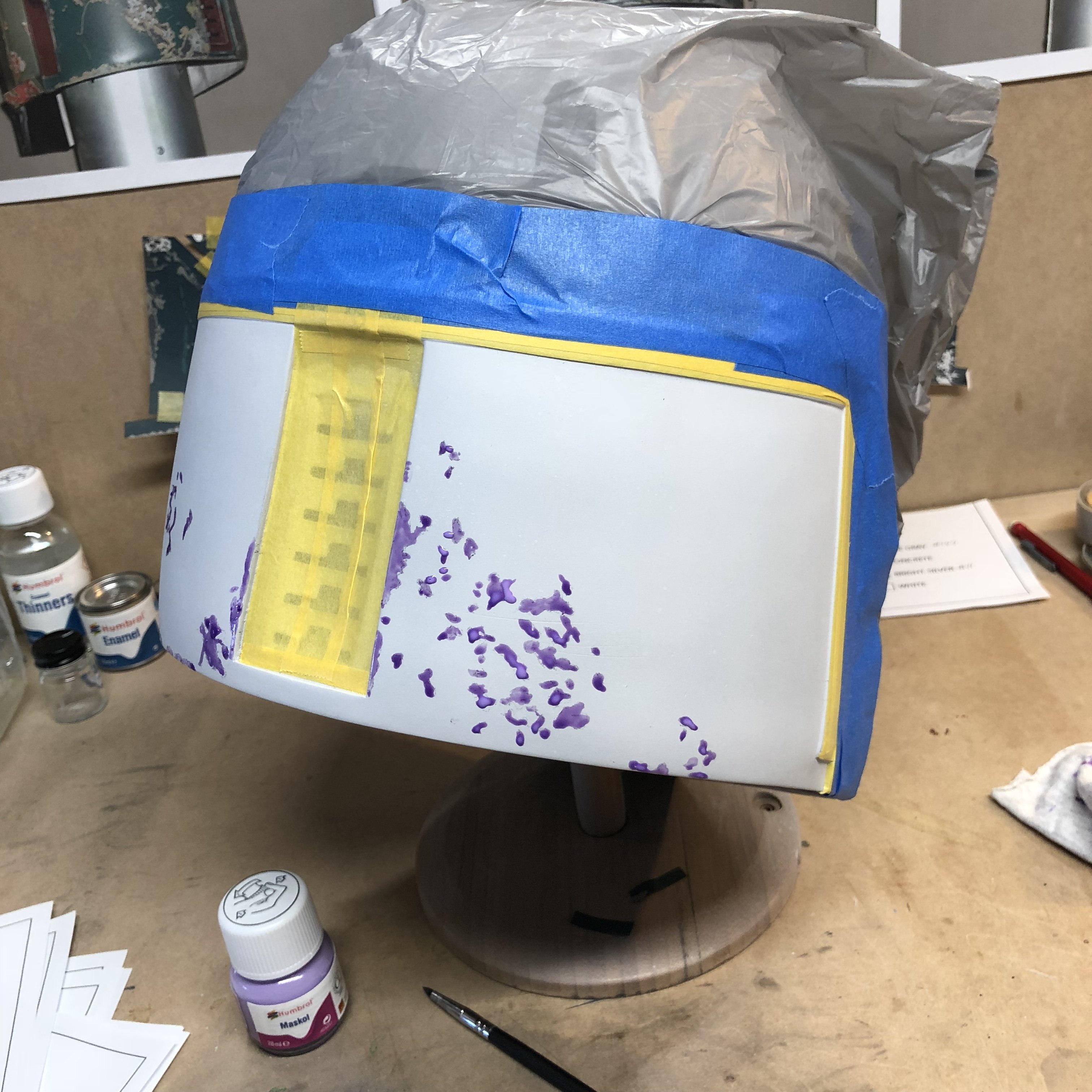

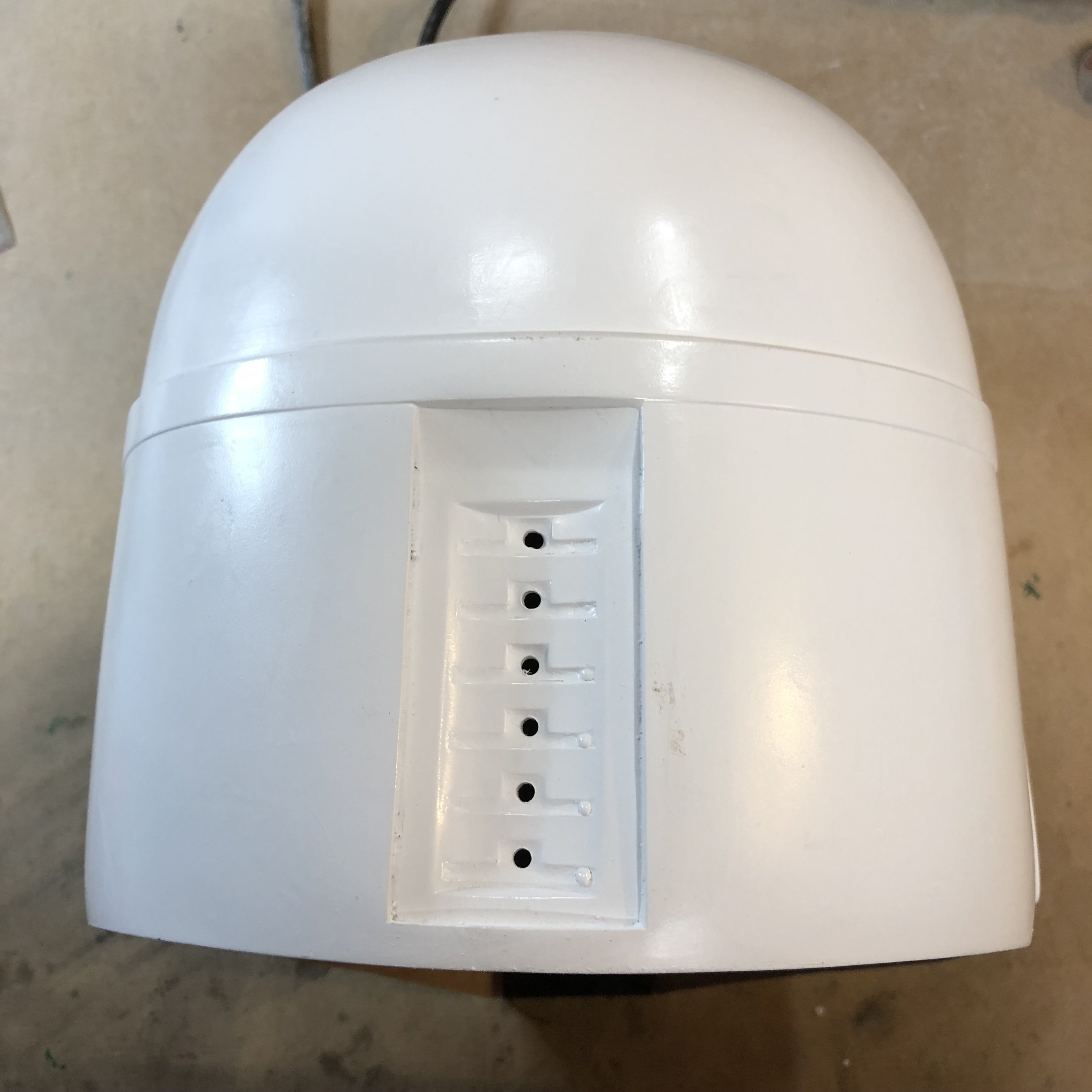

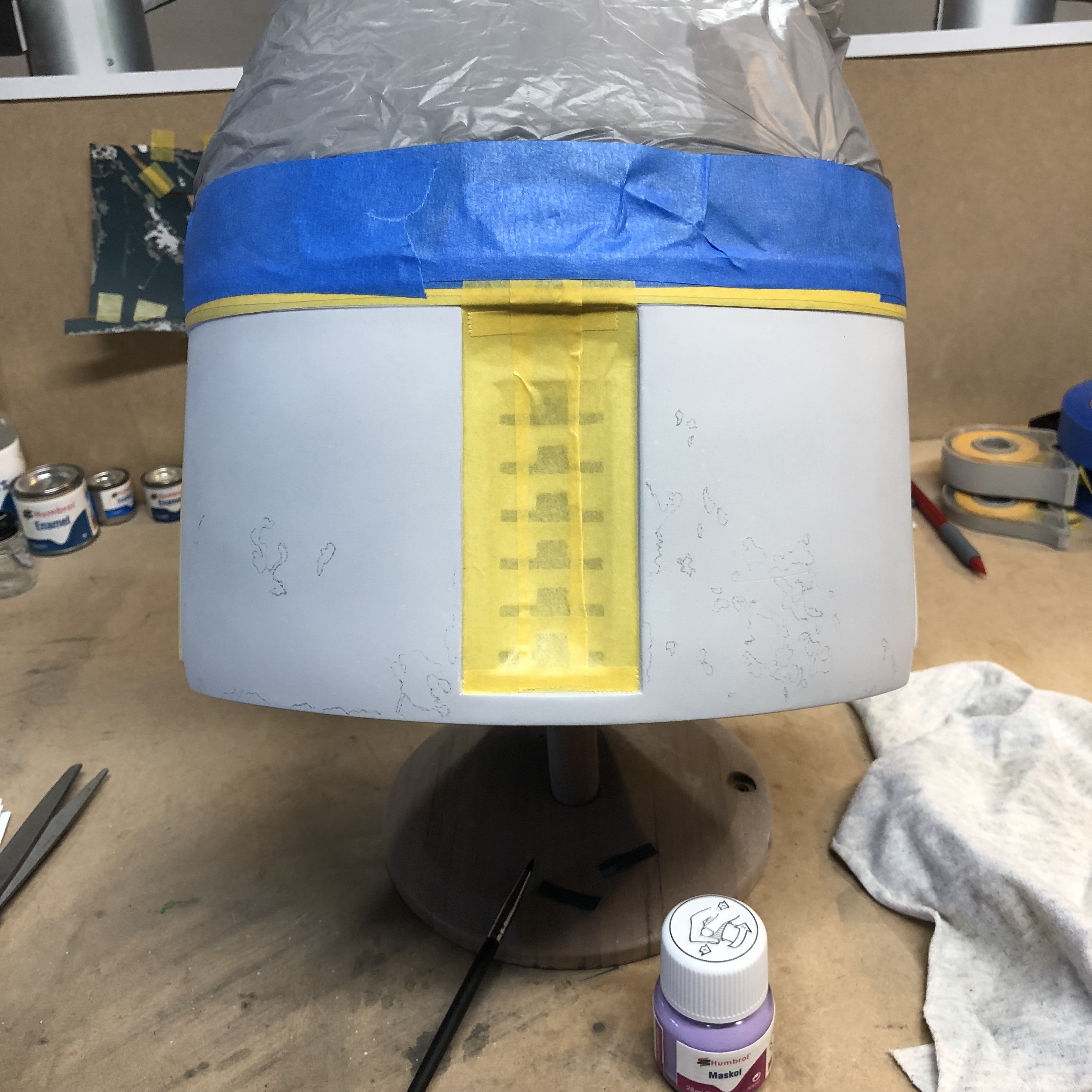

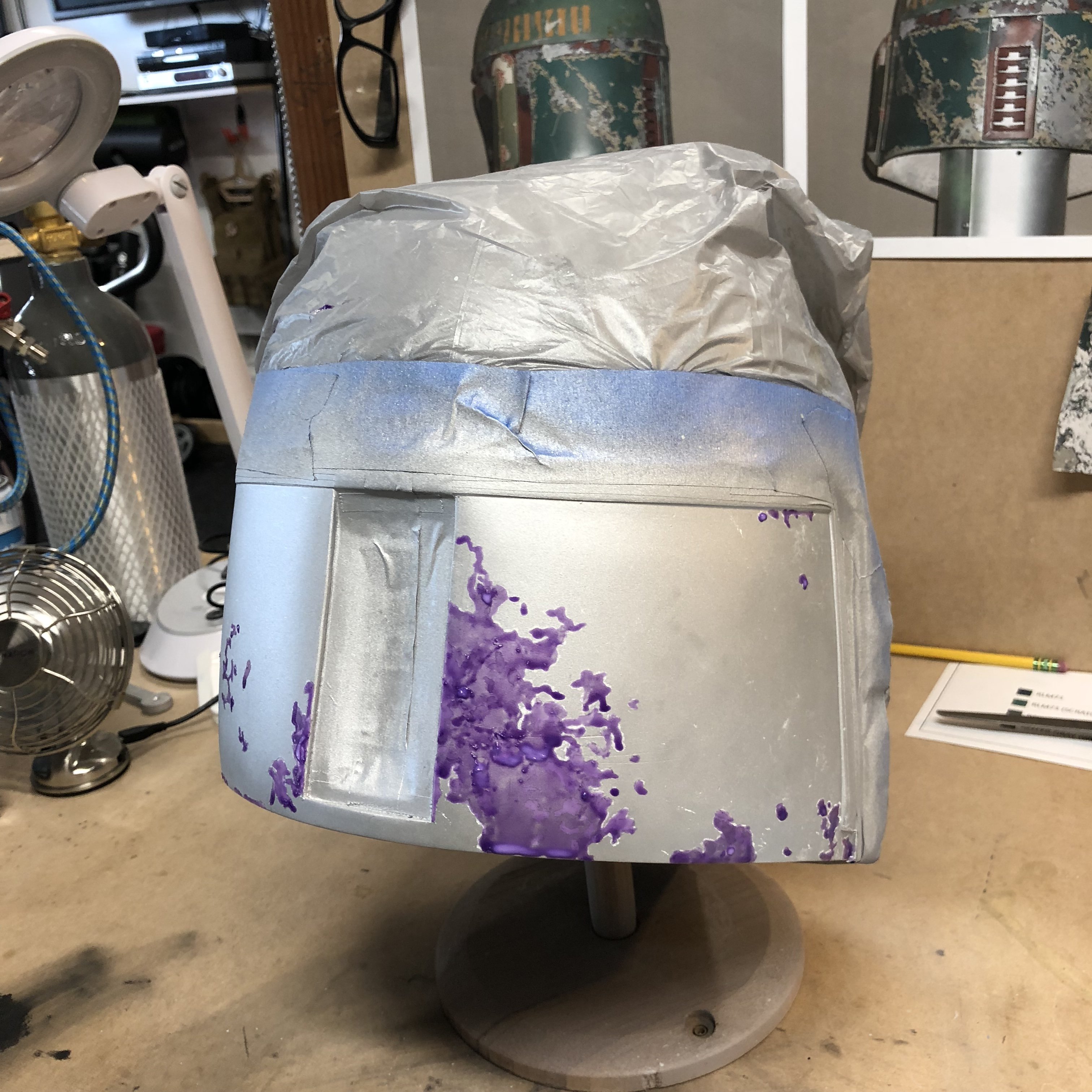

B9A8F8ED-8930-4122-9EB5-CC577F4A7114.jpeg ECA577D4-1898-44BE-92CC-350B21C7EA2A.jpeg 55434ED6-6419-4369-ACEE-81980215B642.jpeg C5E30A18-498C-4B54-9E07-E2237A2922A1.jpeg CCE2329B-9543-4142-9DBE-FF3FAF1772EA.jpeg 022B7A9A-E2E7-4109-9B4F-14118CFF5B3F.jpeg So I finally got my back panel stencils sized. Followed some the Builders feed on sizing. Transferred the stencil and masked off the Base Grey sections with Humbrol liquid masking fluid. Following Terminal Fettlers last wafer thin paint up. Next is to paint the silver.
