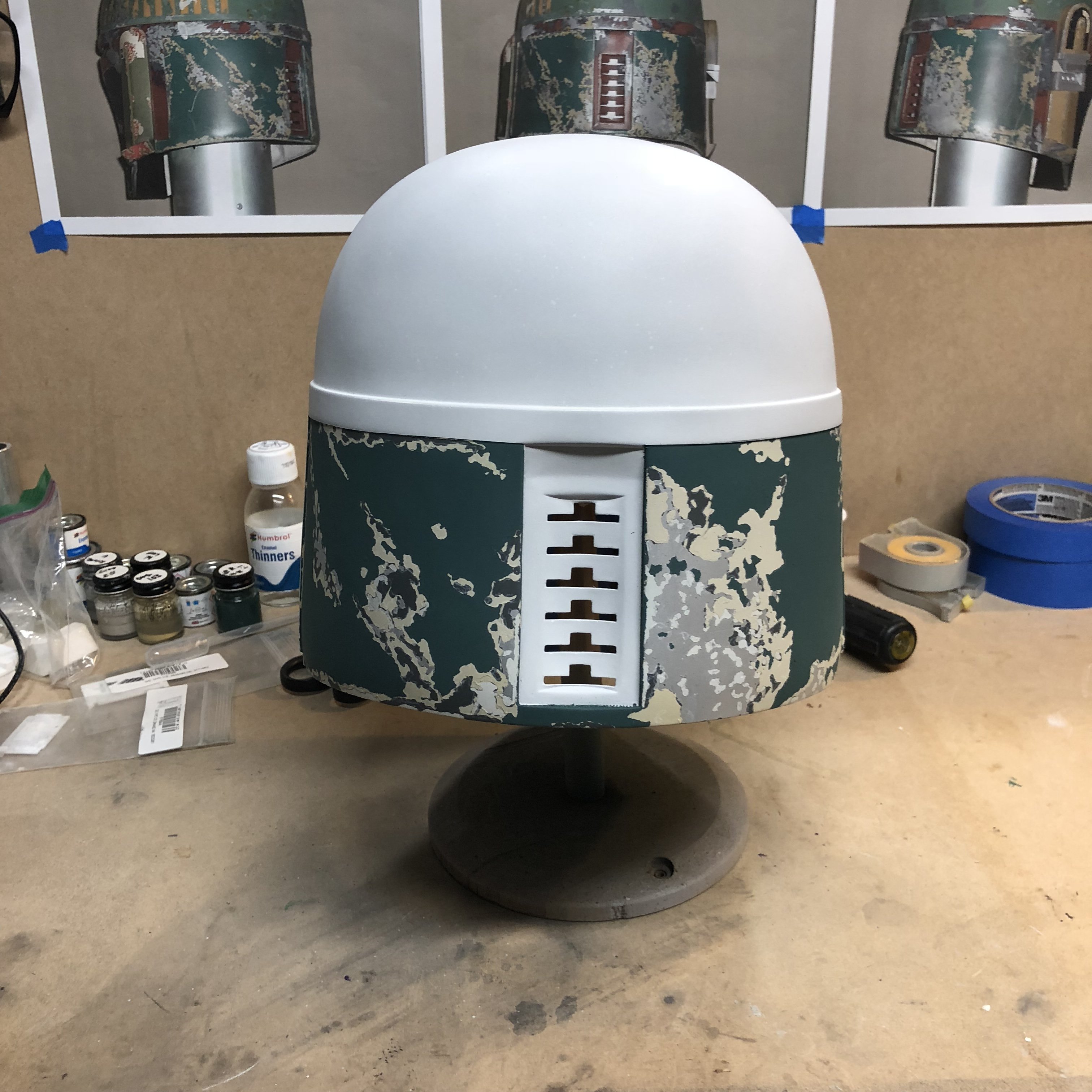

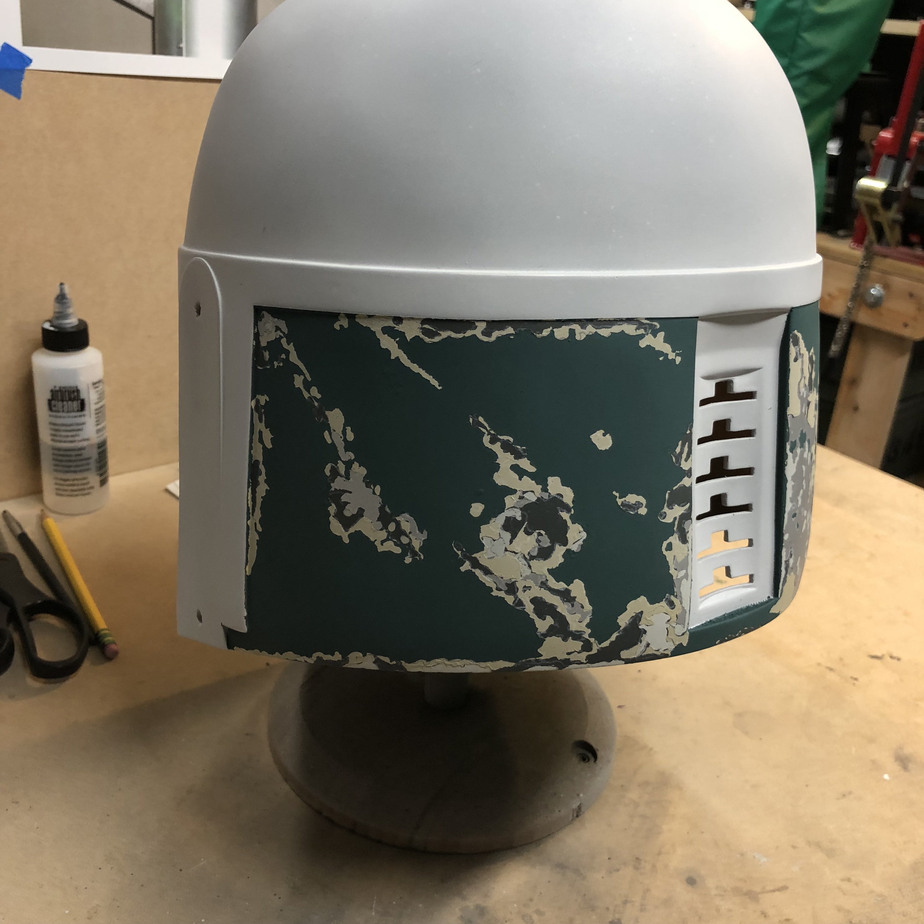

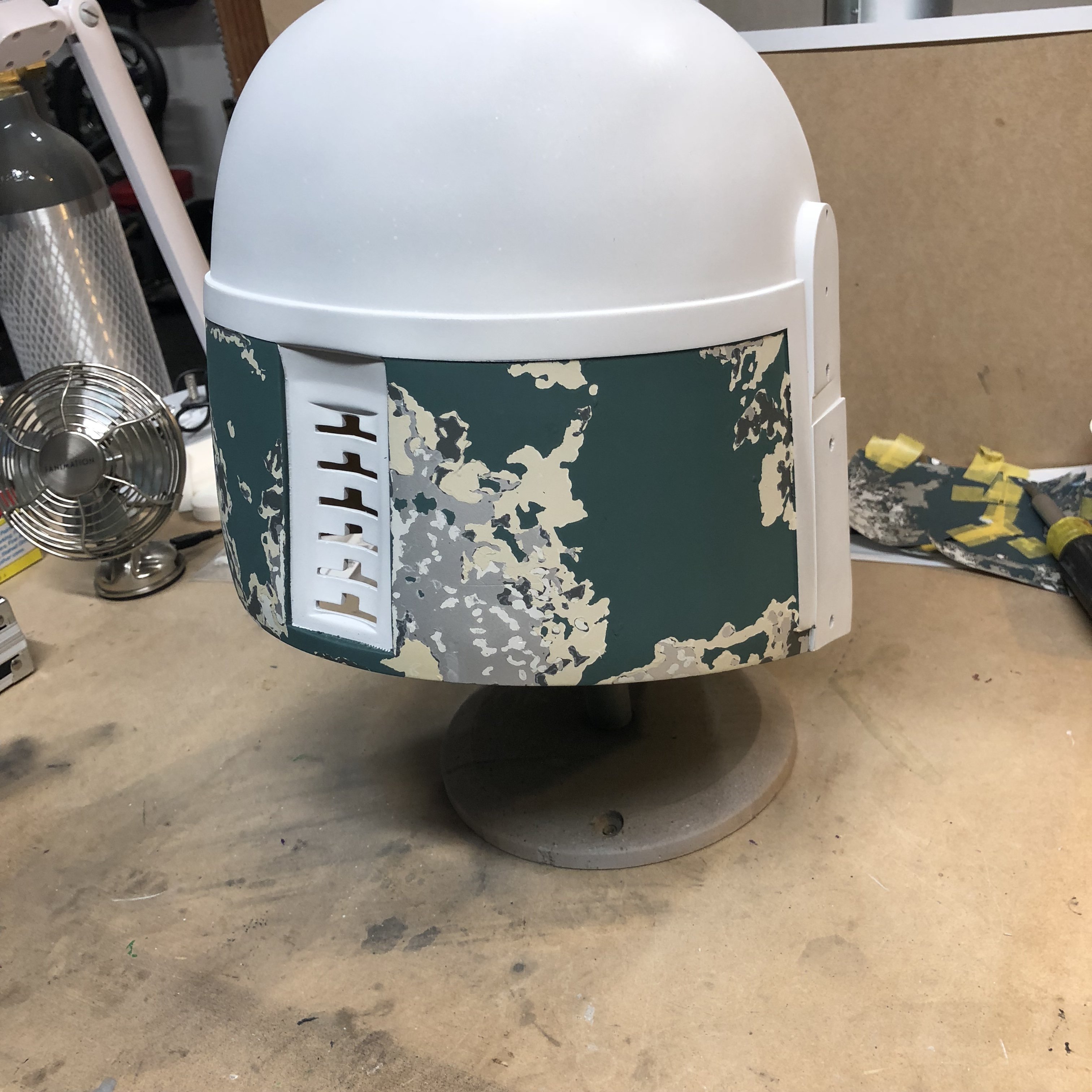

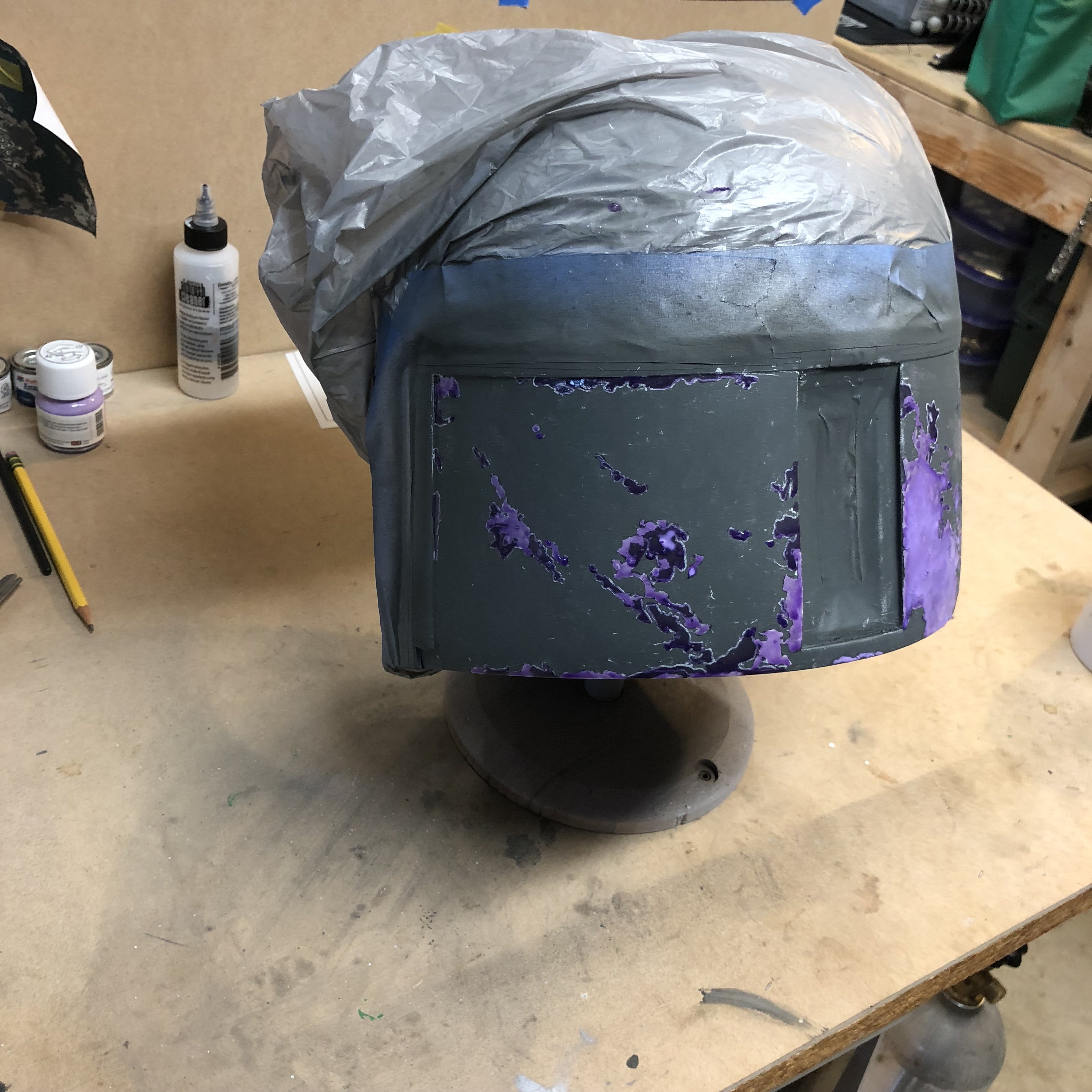

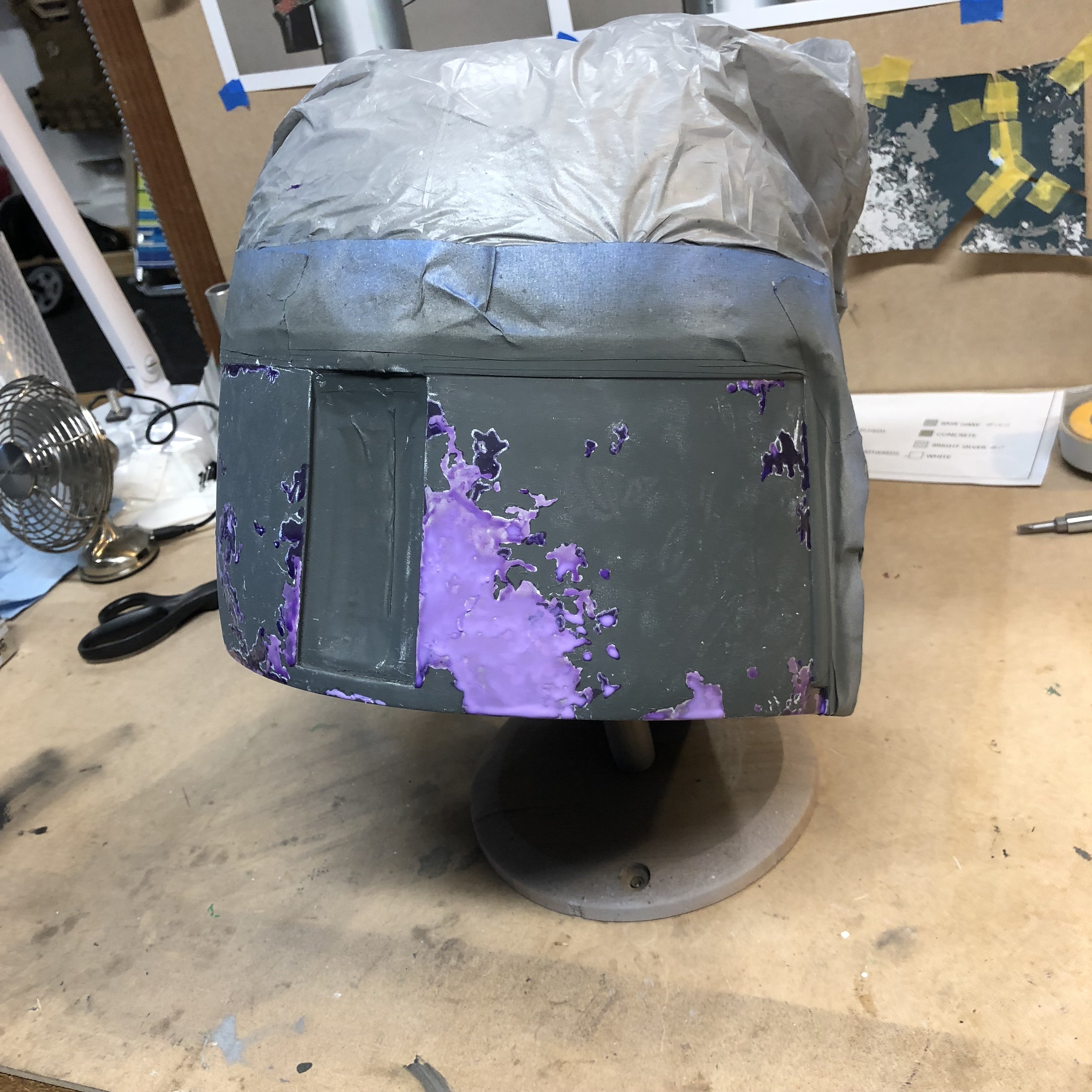

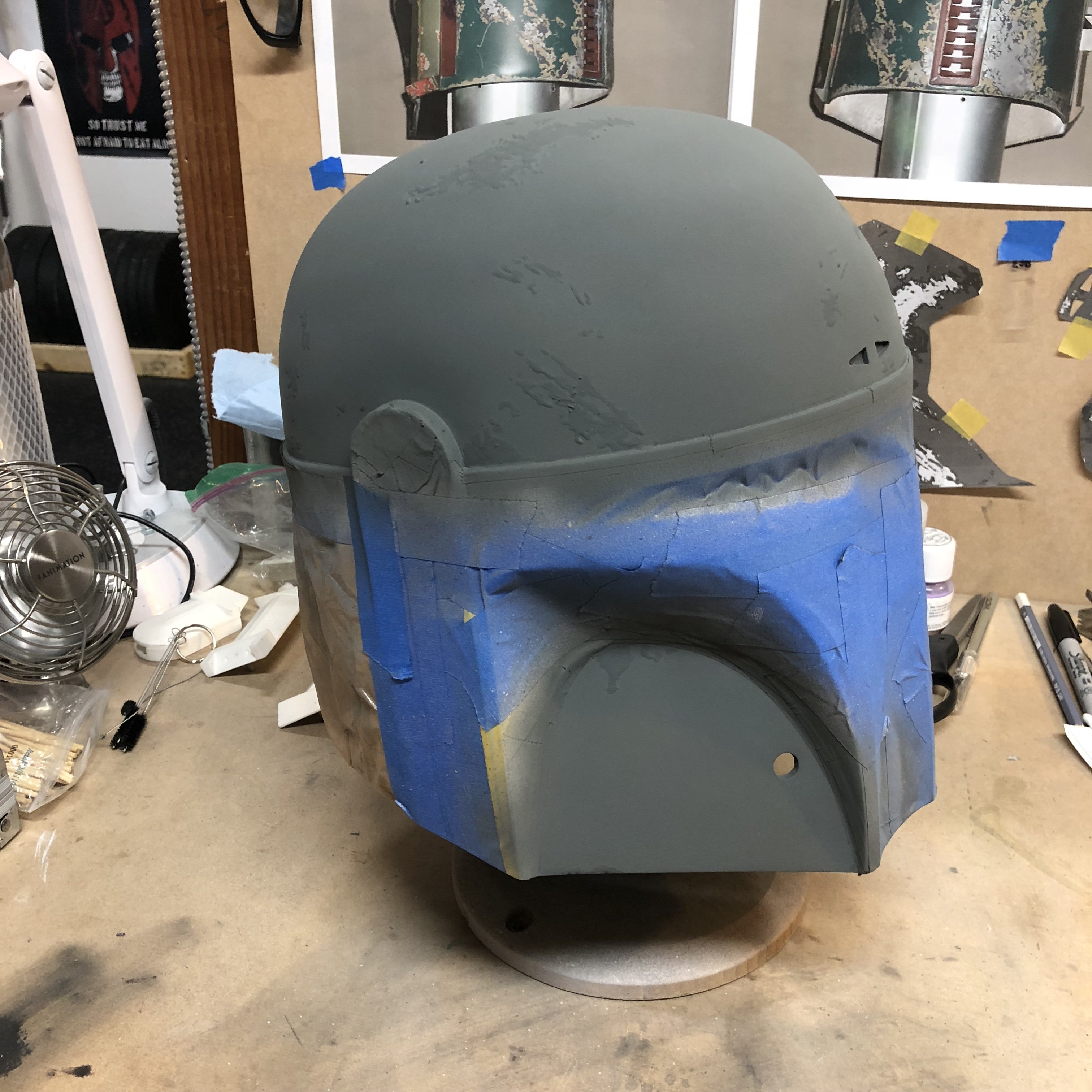

6EFEA1D0-669E-4231-A1EC-DE983D692CAA.jpeg 9F0BABEC-9D19-49DE-AD11-CF305E4201AD.jpeg 95768169-50CB-4D8A-9347-52AD0CBE2271.jpeg C8627FD1-B3A9-46C6-81F4-92DE8D807BAE.jpeg 61E835E9-BED6-4CE8-81F5-D8015D2E2551.jpeg 732888B1-BC3E-4AD8-83C8-DDECA98FDC51.jpeg My helmet is coming alive. Stencil and mask done for the next layer. Grey #28 and a mist of beige #103.

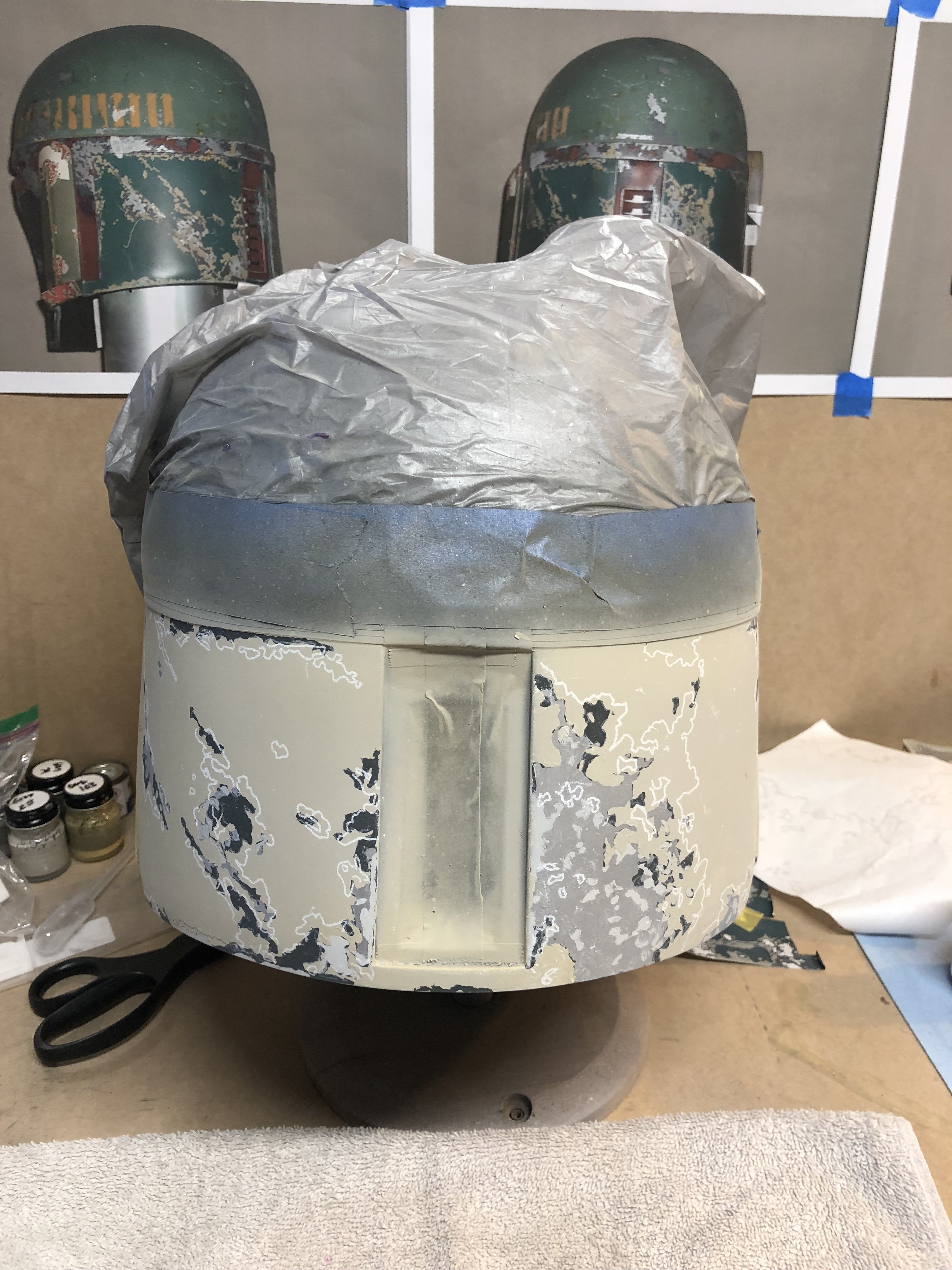

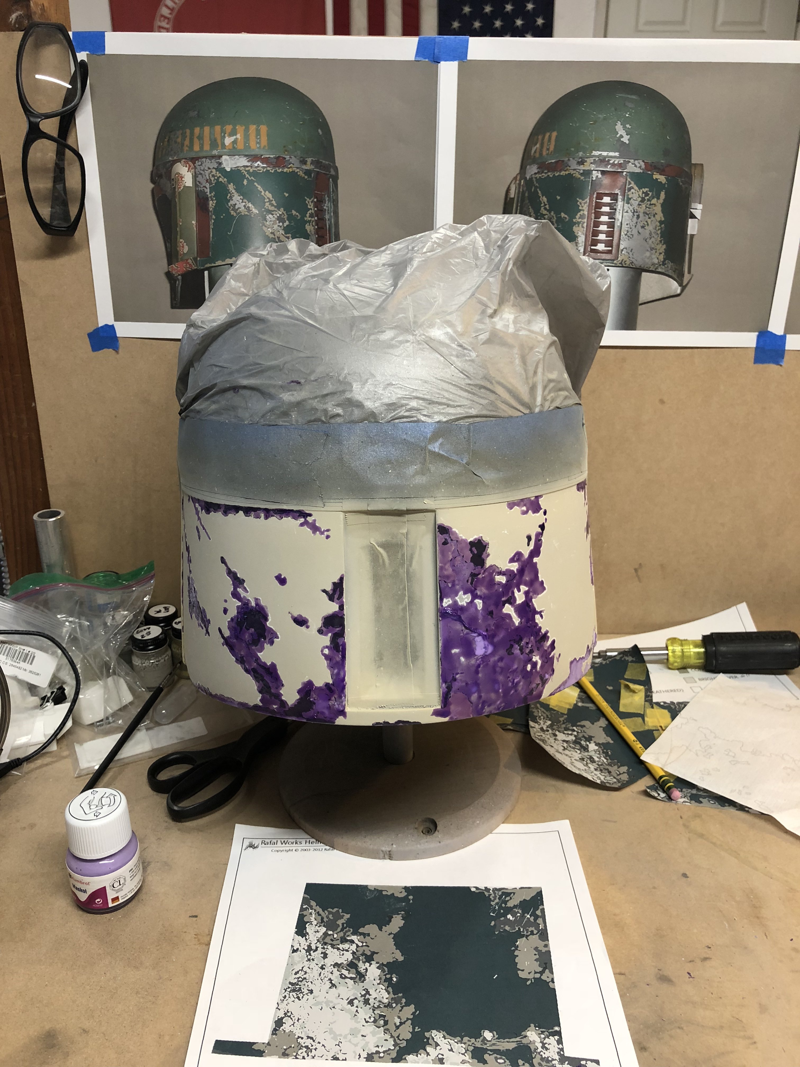

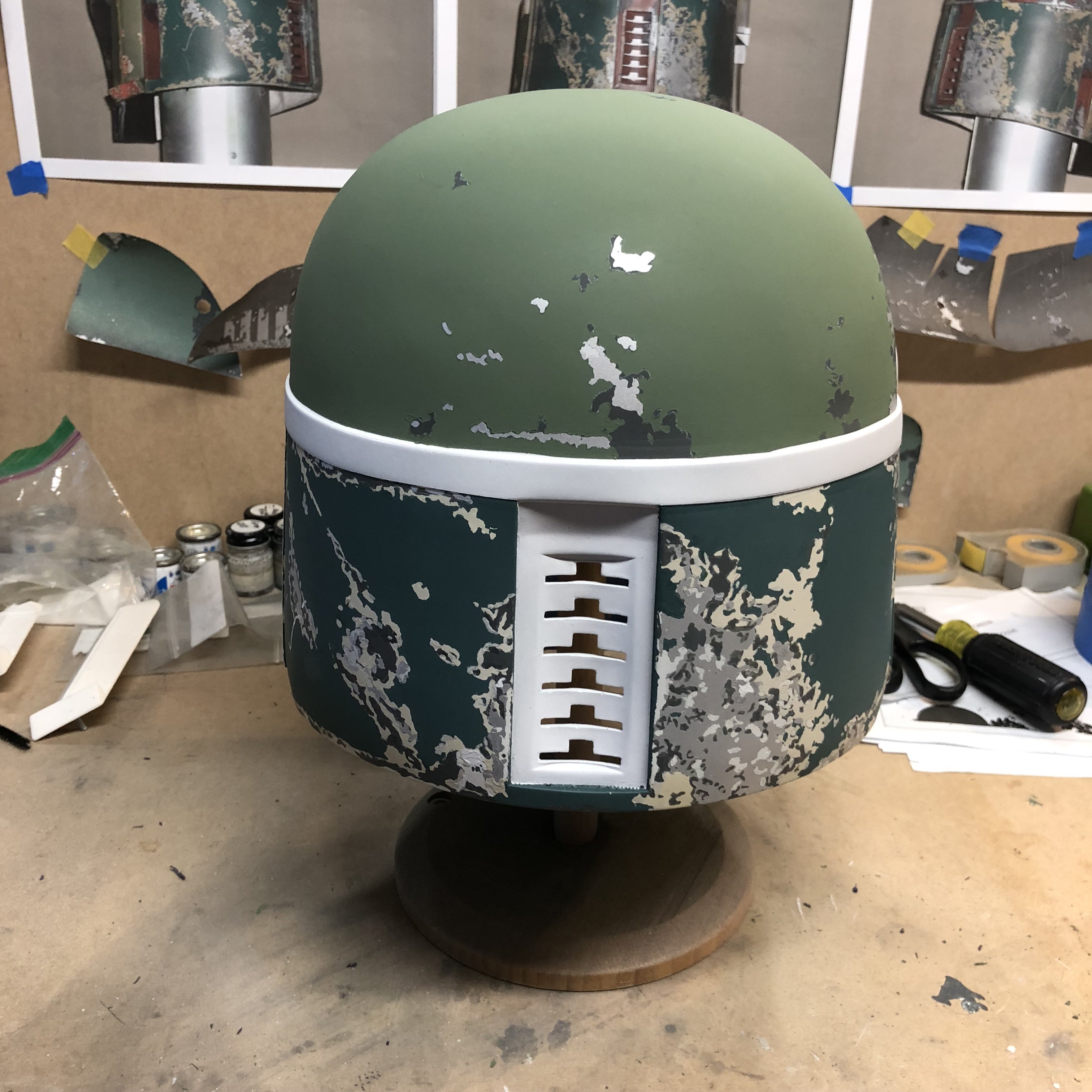

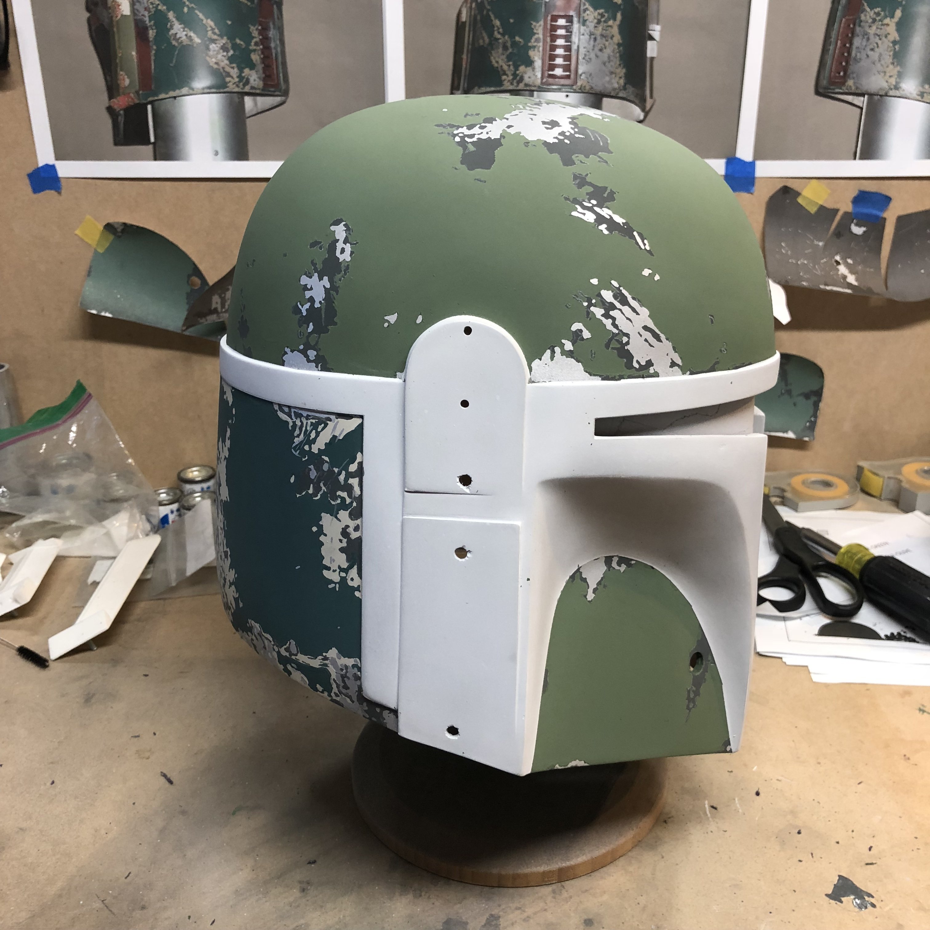

FD3BCC94-CEC7-43C6-9F16-3456AC6E5885.jpeg A89A4CF8-46DB-4B4F-9ED5-2C35523A2E90.jpeg 5B566A4A-9C76-45EA-9829-18278EF21034.jpeg 7ABADD0A-2D9C-4908-98E1-75B18FAA2CBE.jpeg Airbrushed the Grey #28 and misted beige #103. Stenciled the final layer and applied the liquid mask. Ready to airbrush the green layer. I will brush topically all the fine details missed and apply the scratches.

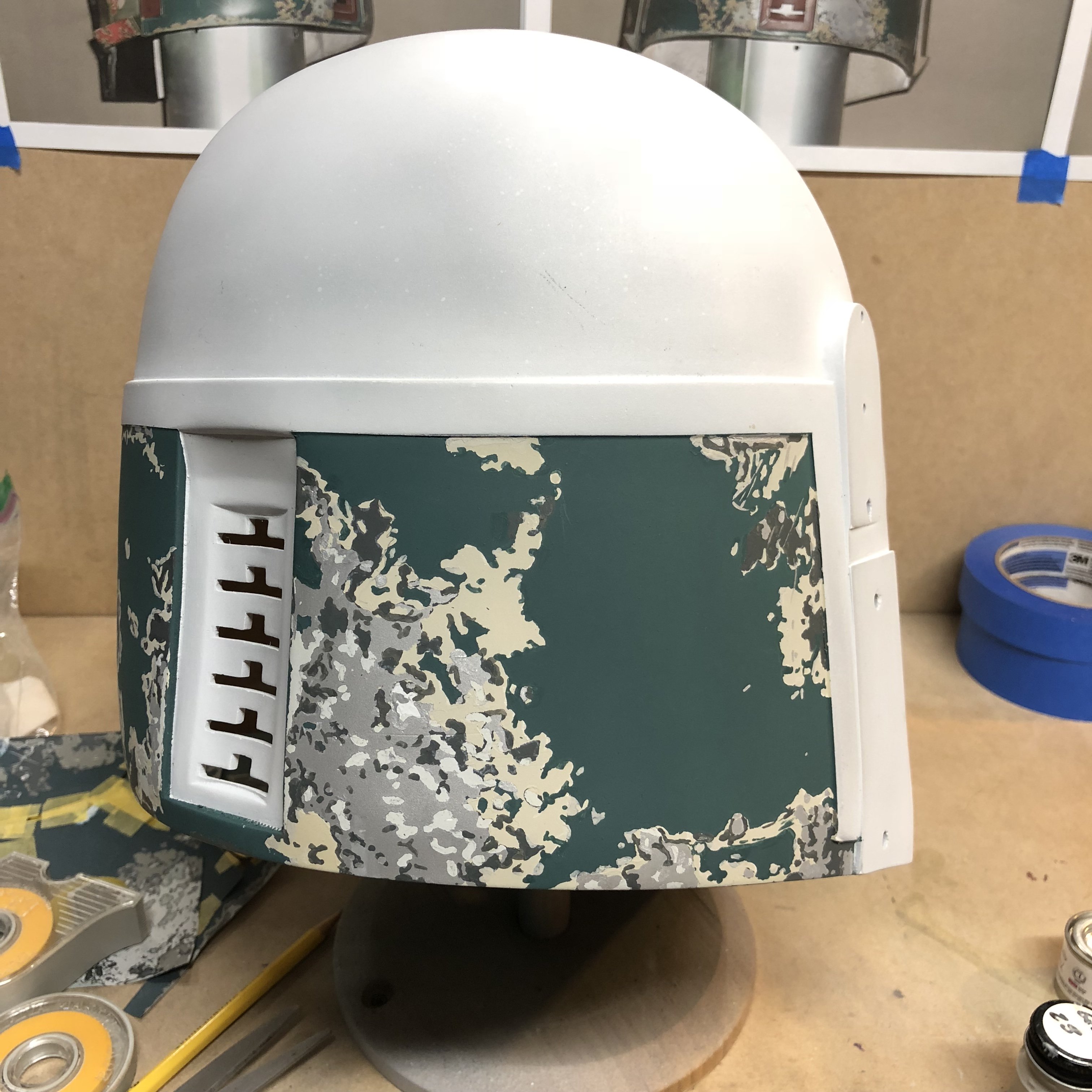

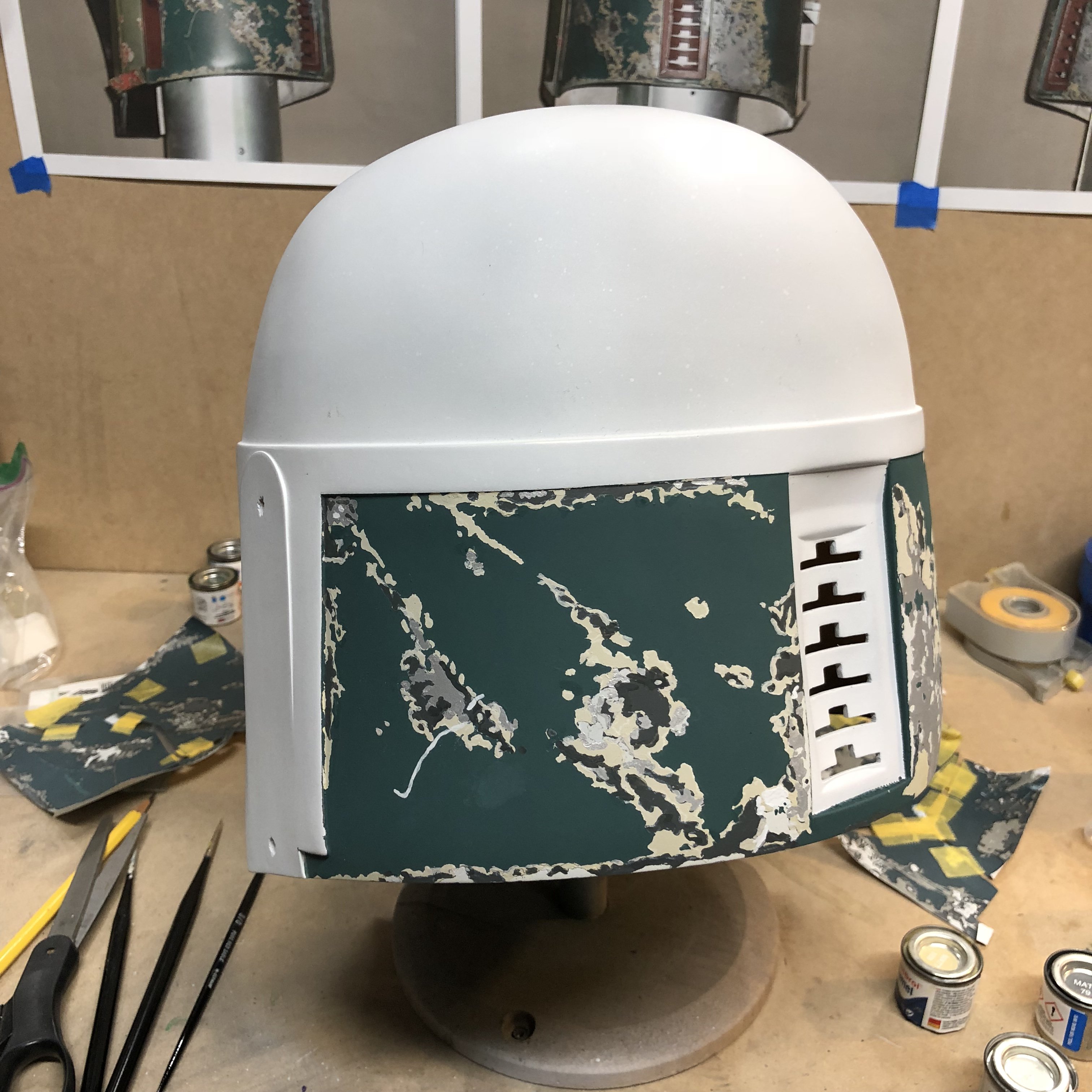

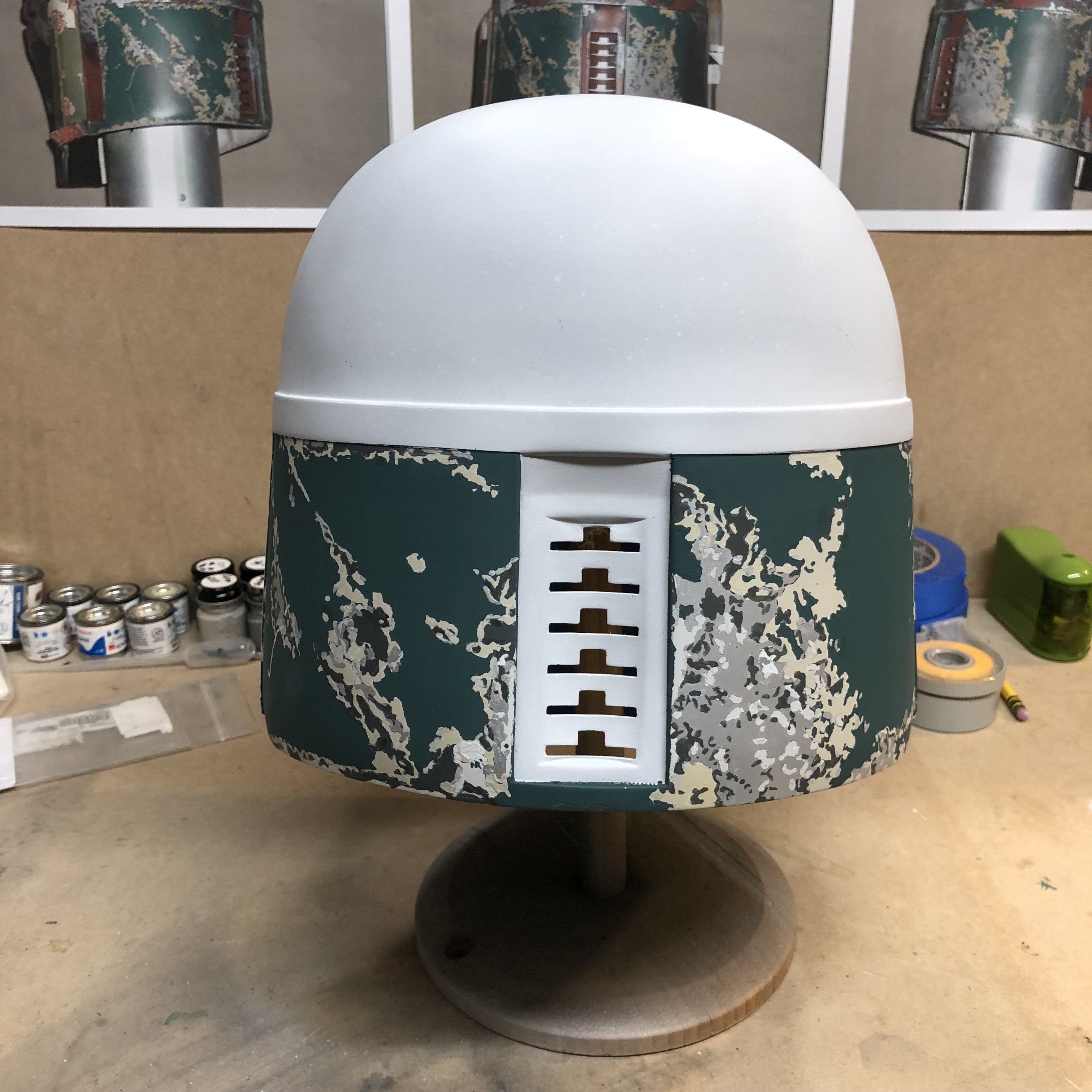

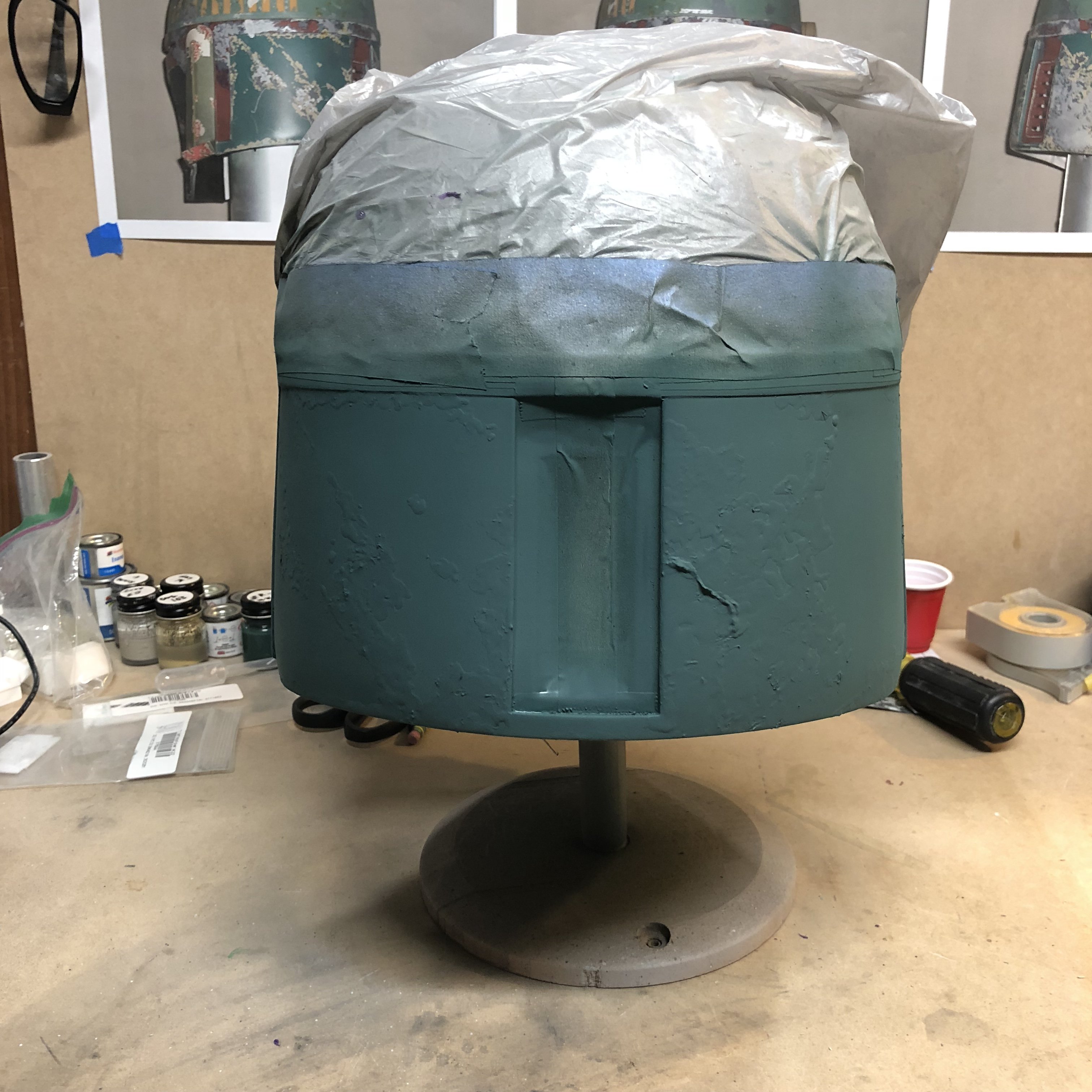

226EE046-6EFE-41E8-BEC8-66428262DD1F.jpeg 6C931CDB-89BC-4B68-92C6-F09FF3C21ABD.jpeg B63AD3A0-1033-447E-94F0-F1B0FAF010AF.jpeg E0C2B4B9-3D84-4F10-8A49-4FA167B3338E.jpeg Back panel airbrushing is done with the #86 and #96 mix. Still need to paint topically the missing damages and scratches. Do some weathering. But in all I am happy for my first time attempting a boba helmet paint up.

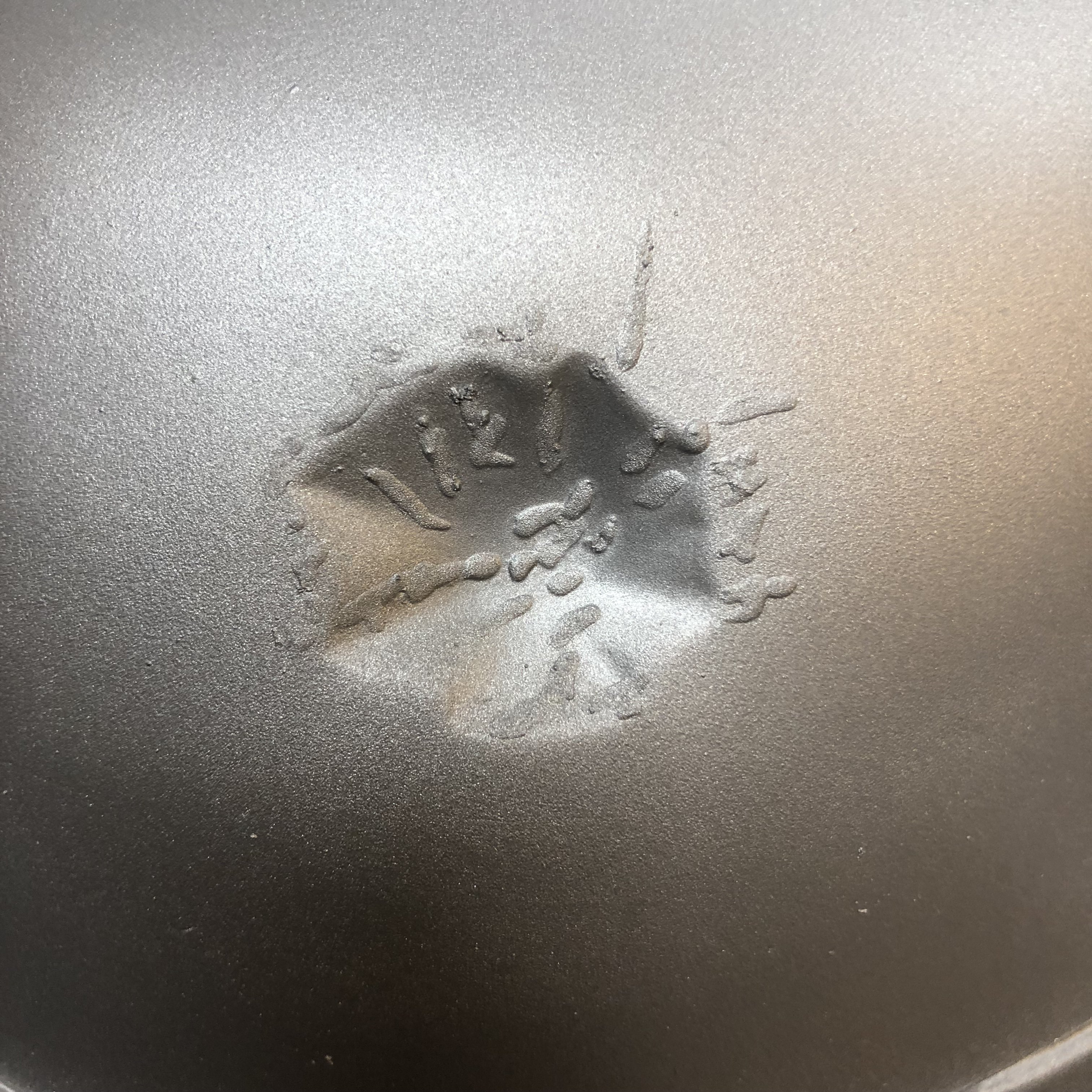

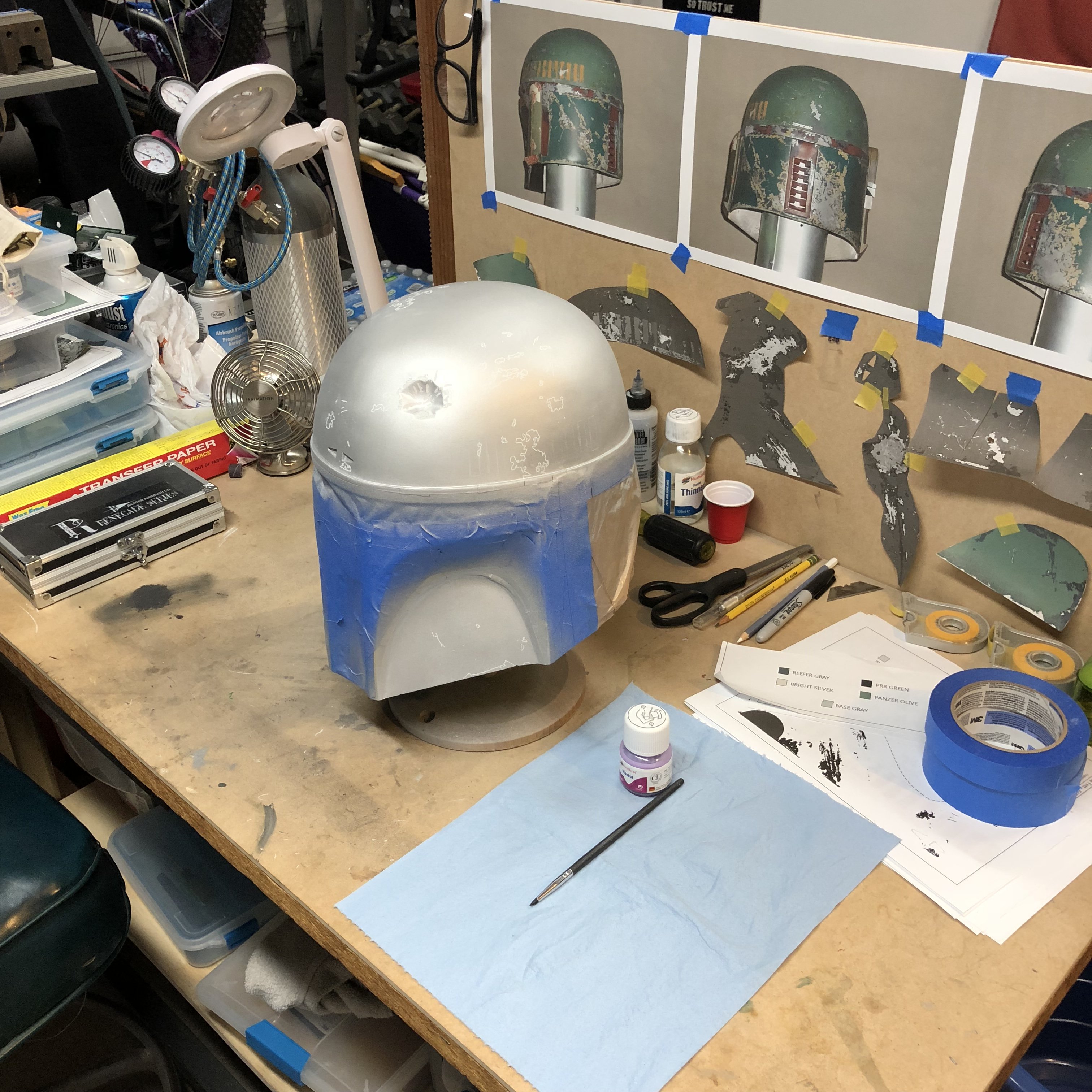

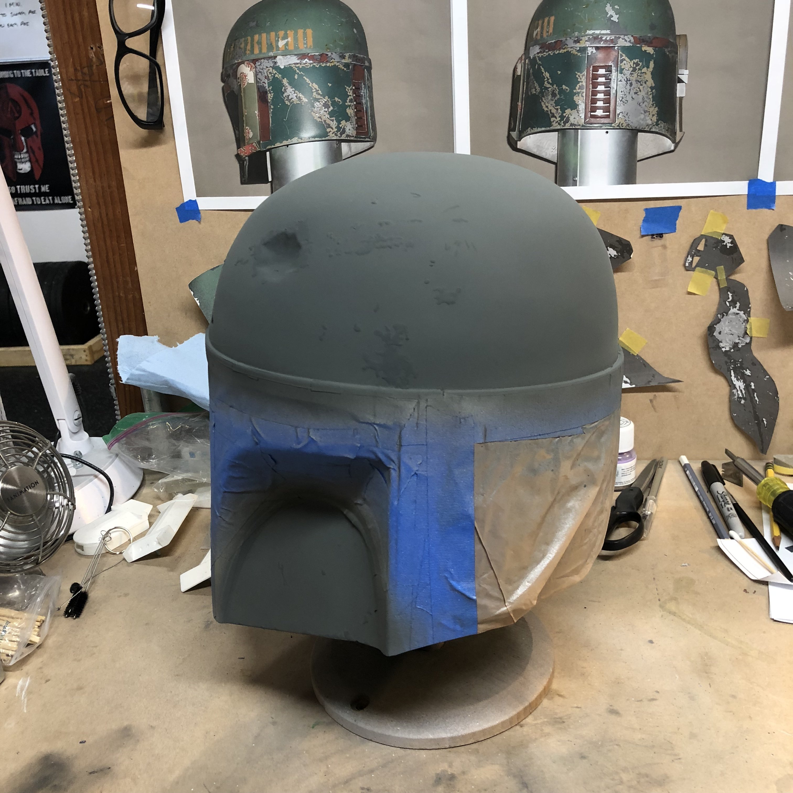

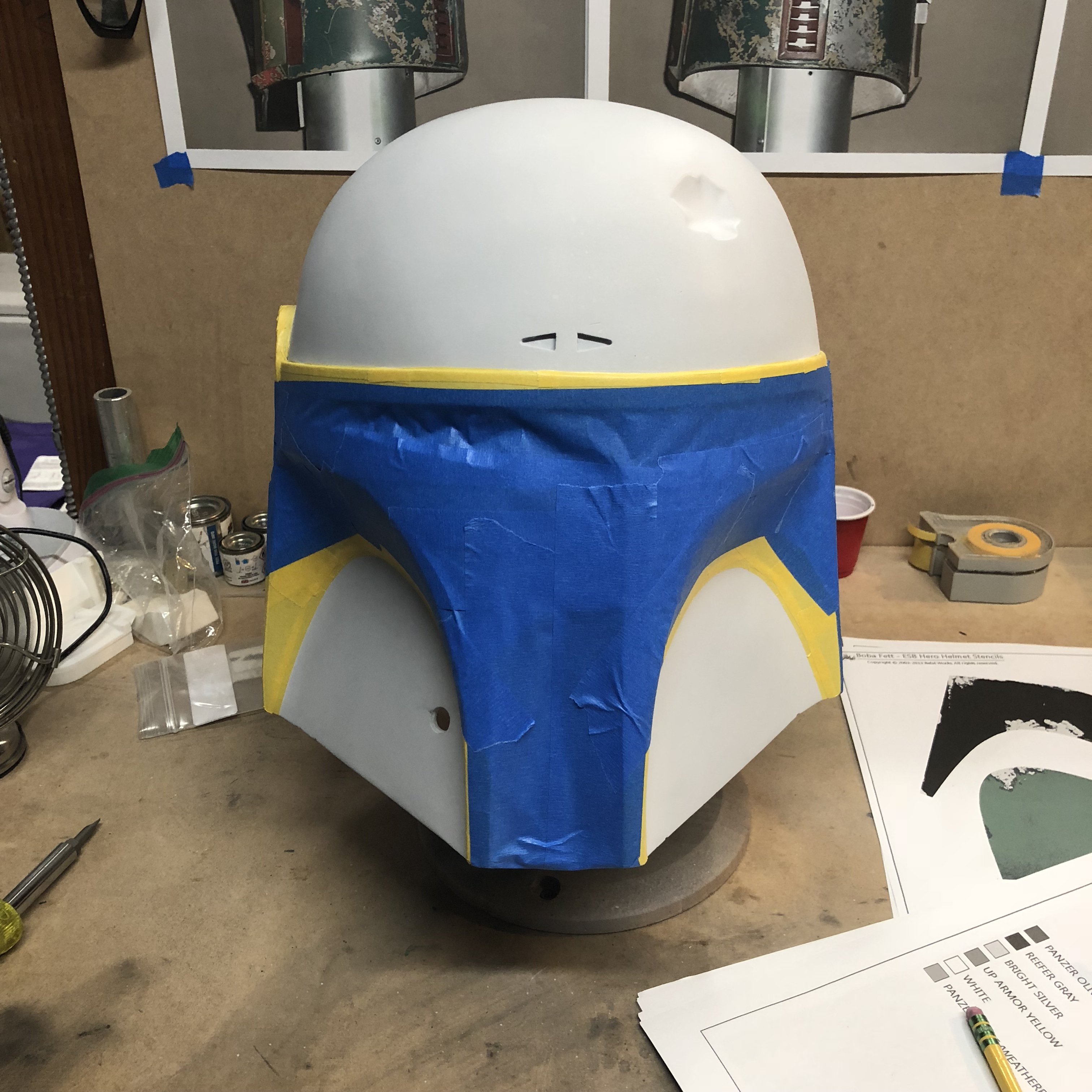

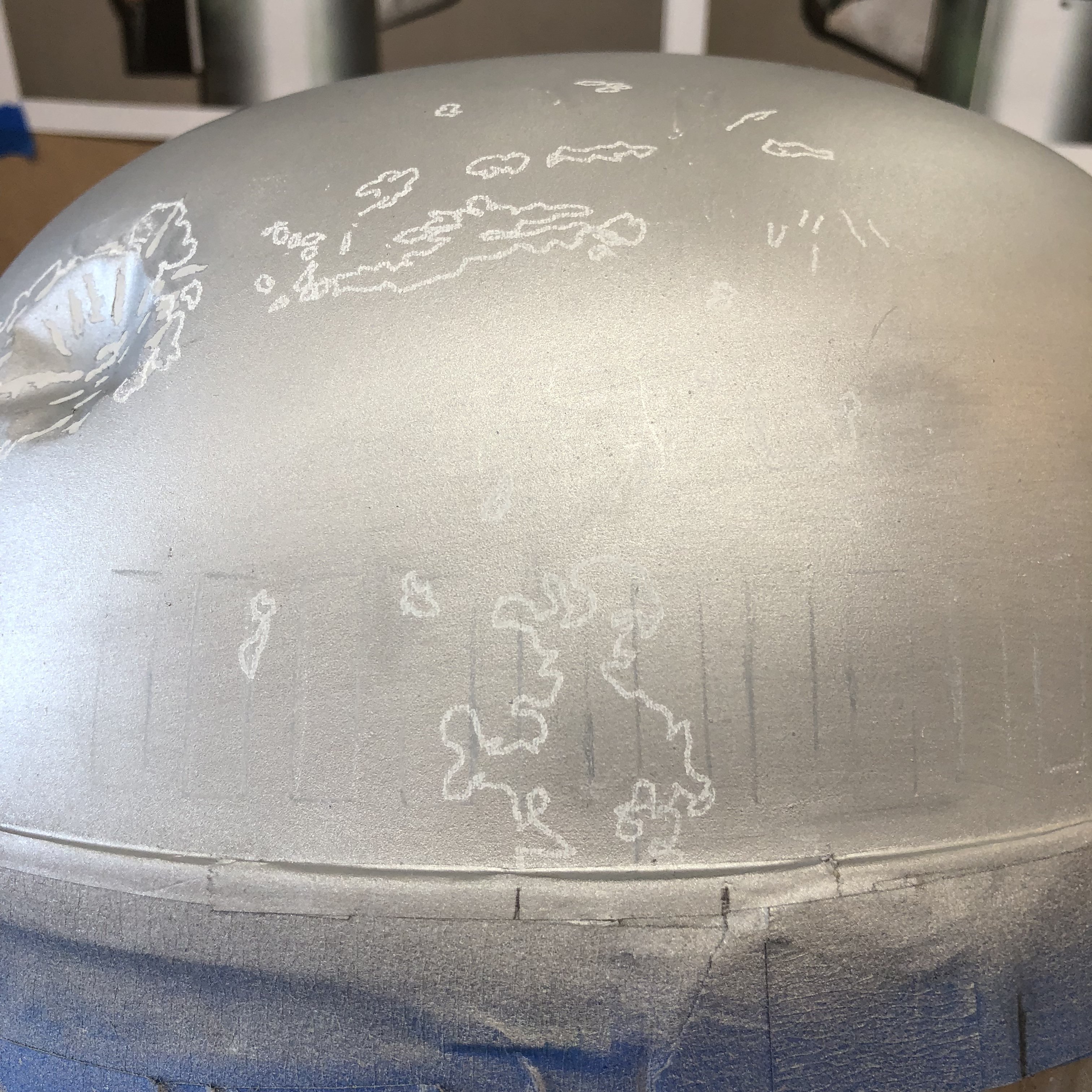

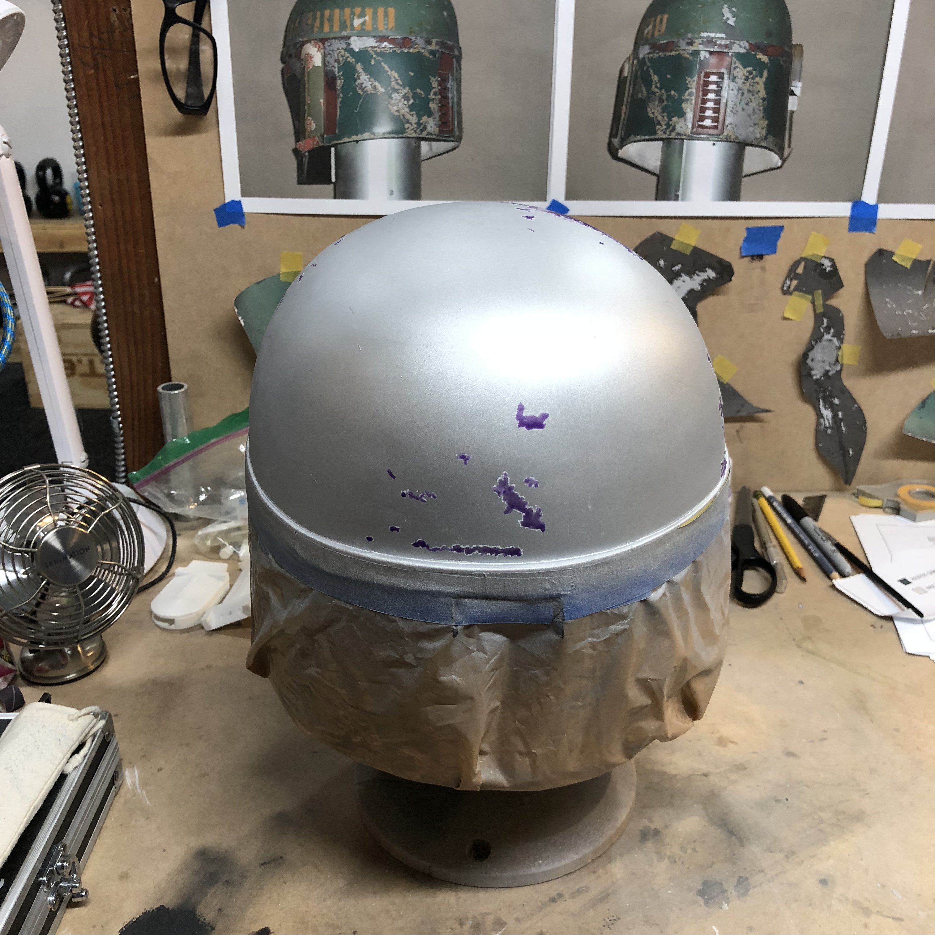

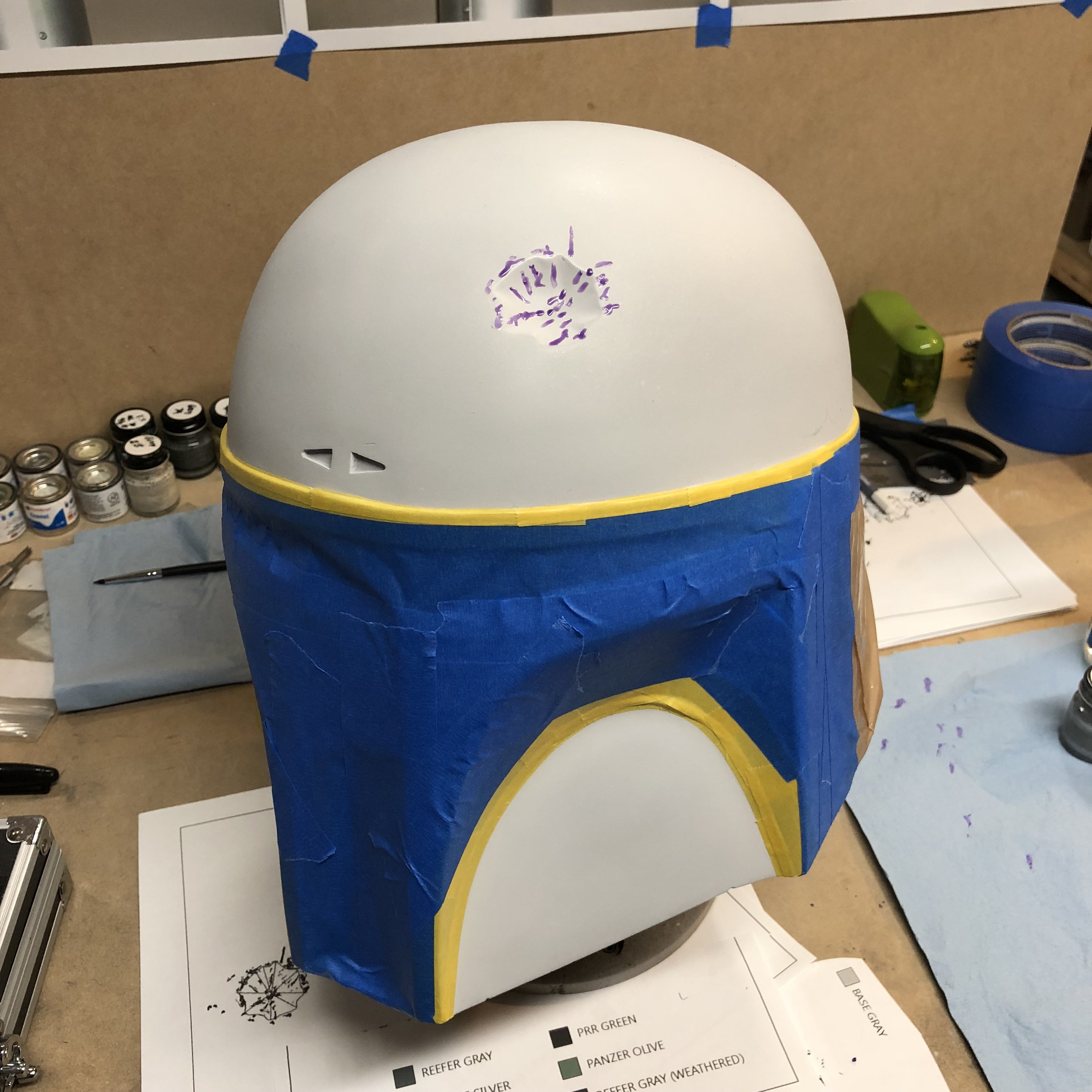

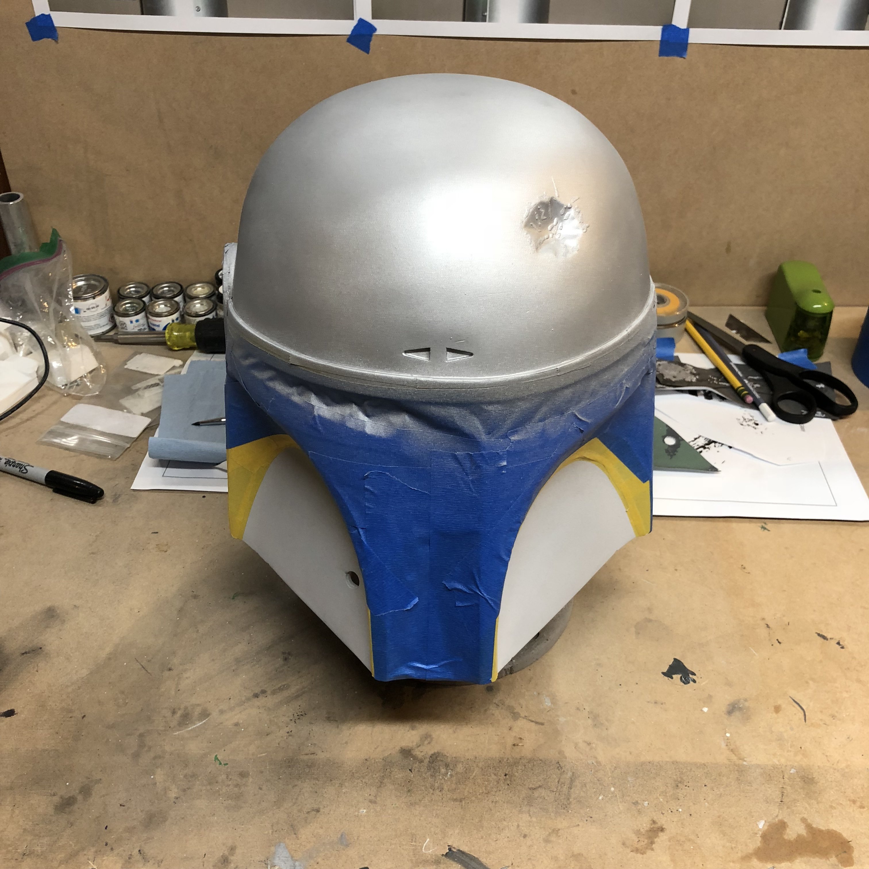

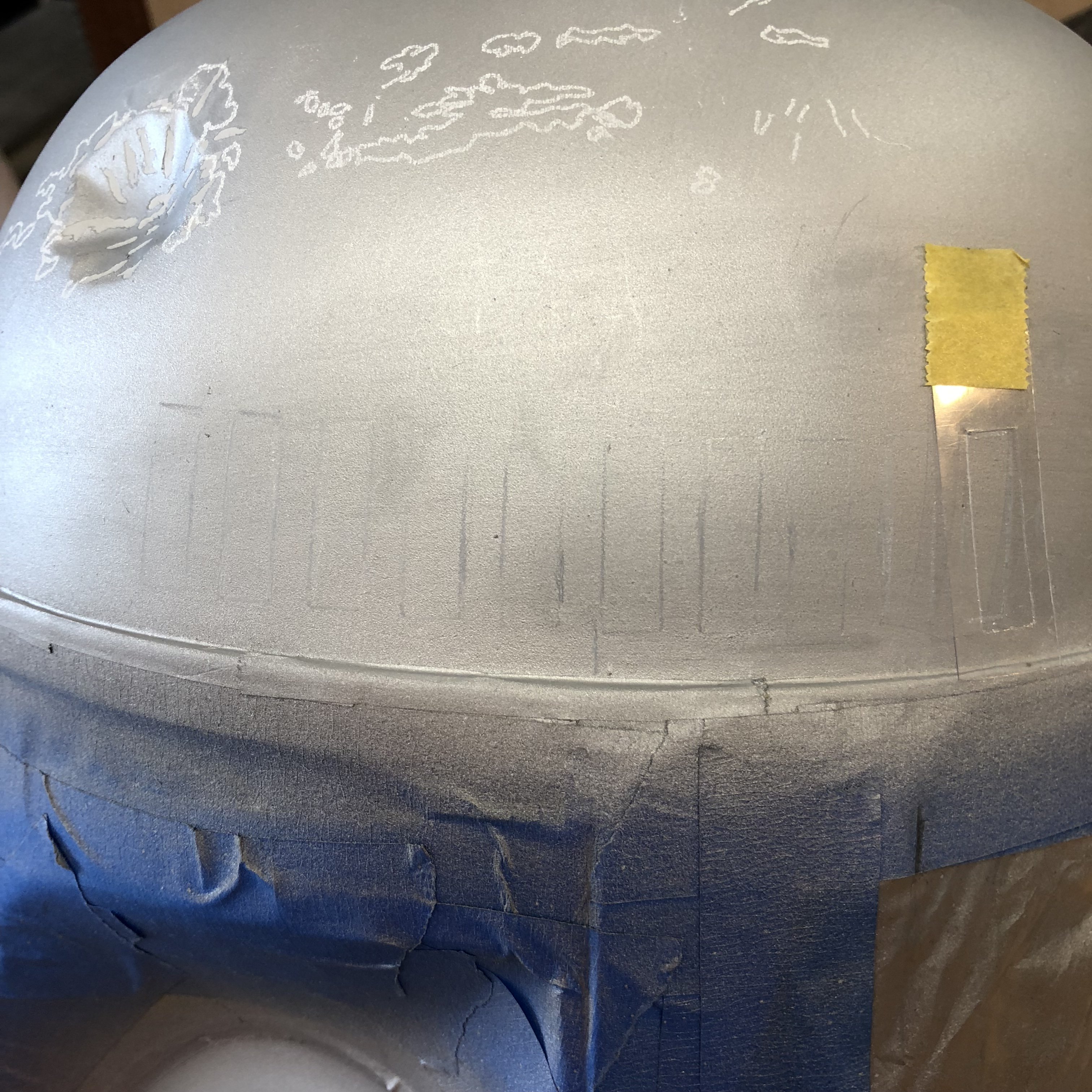

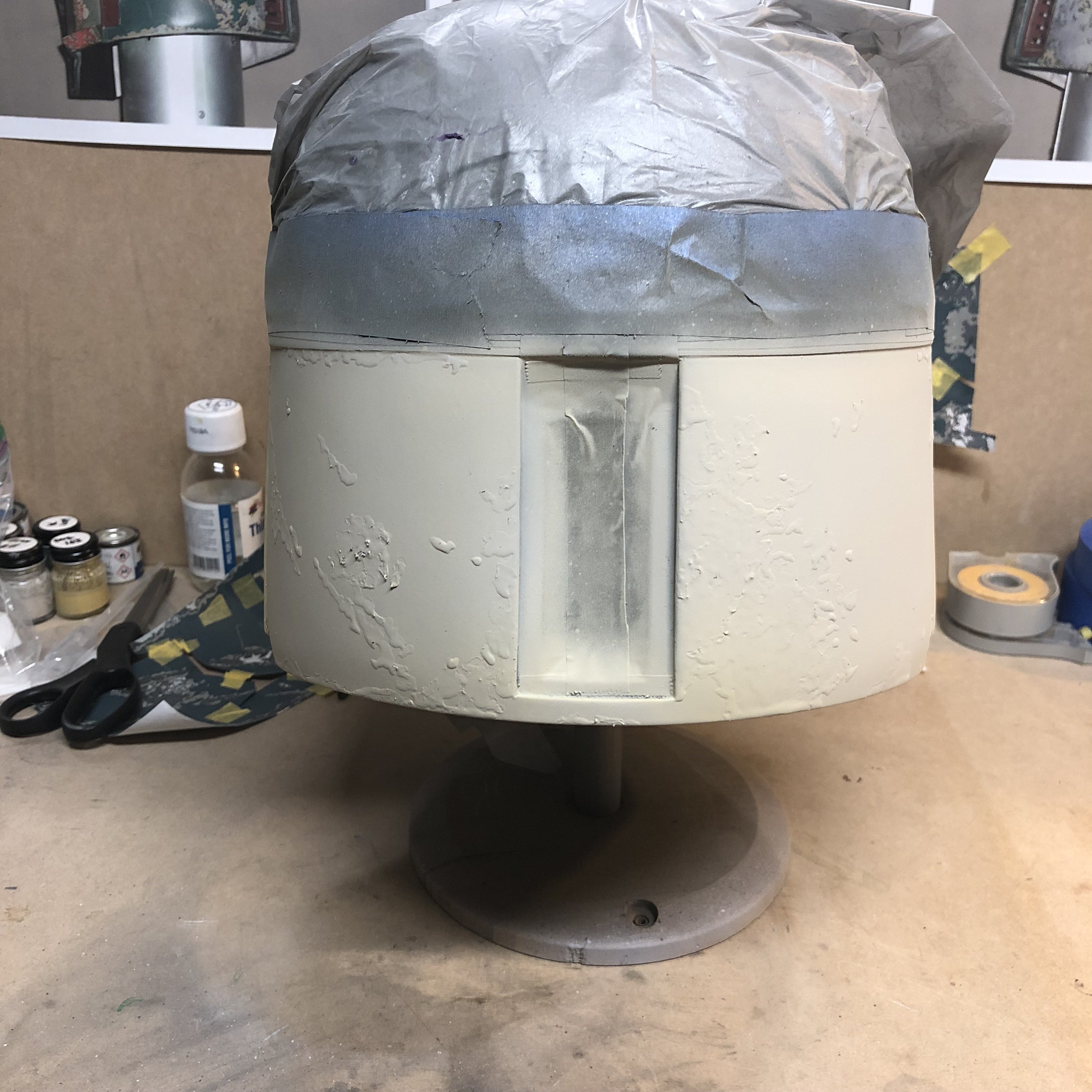

8199695A-1AFF-4ADC-B609-0C9DF1352A7C.jpeg Masked off everything except the dome and lower cheeks. Also sized the dome and lower cheek stencils. And applied the liquid mask to a spot above the key slots and on the dent. Ready for silver #11 on the dome.

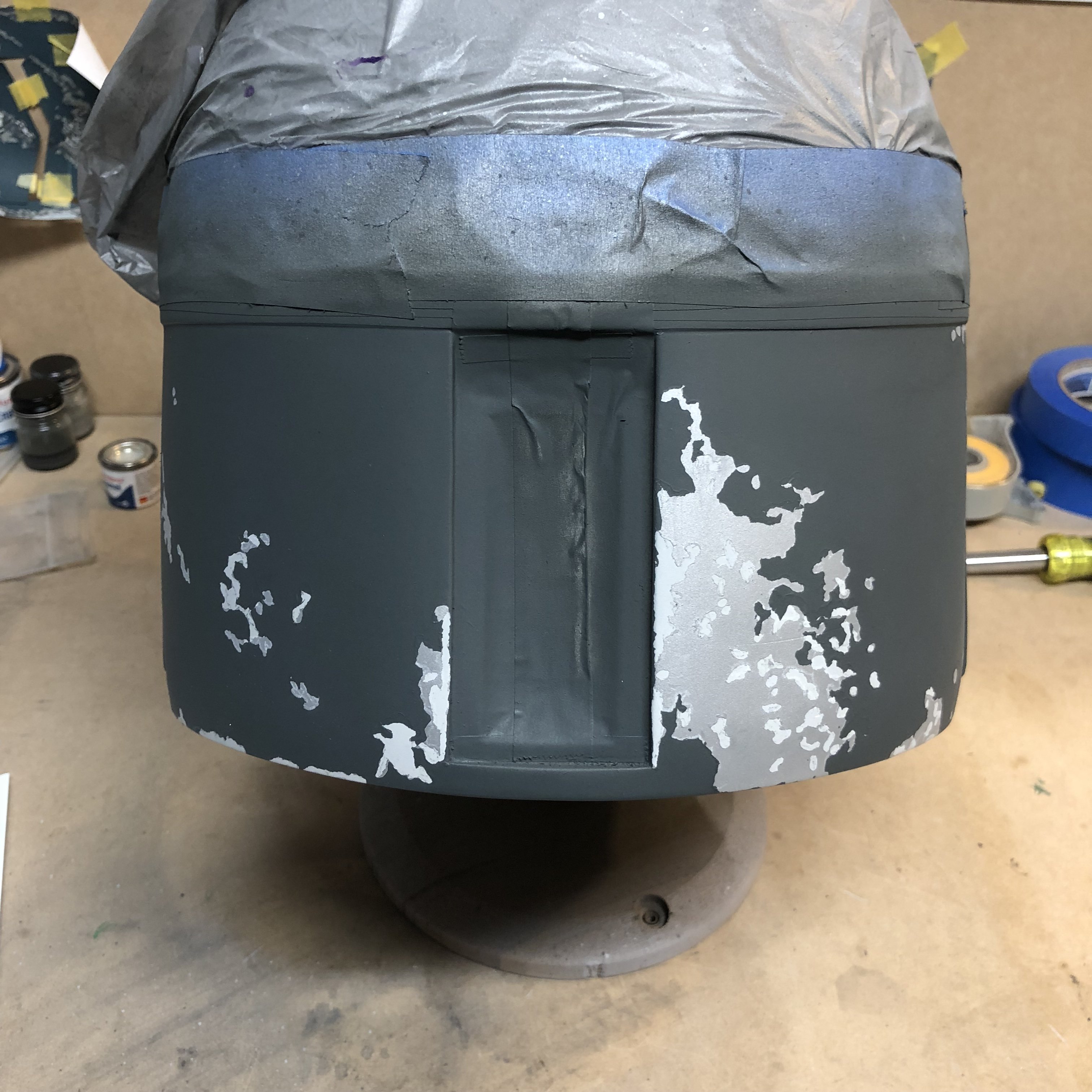

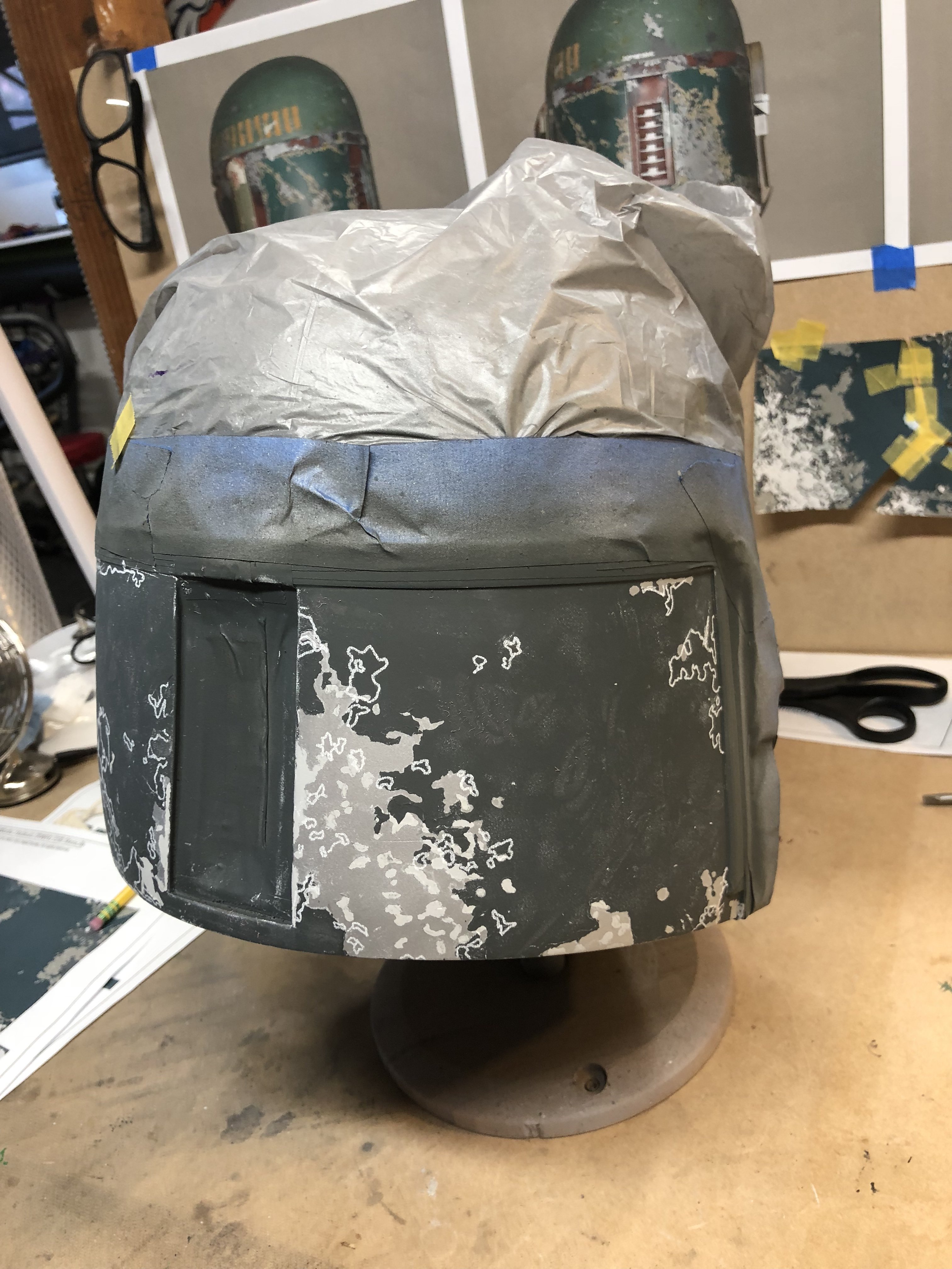

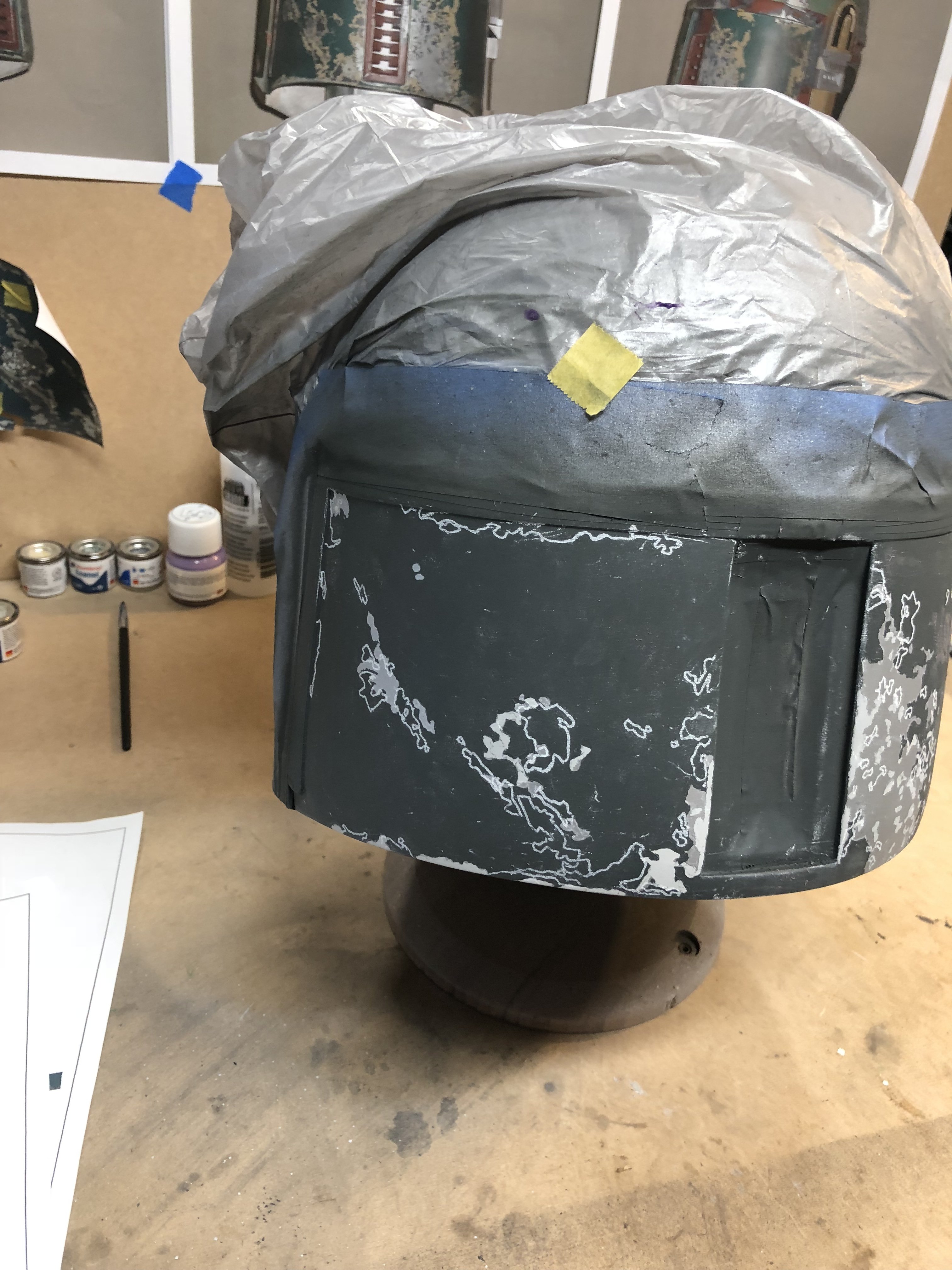

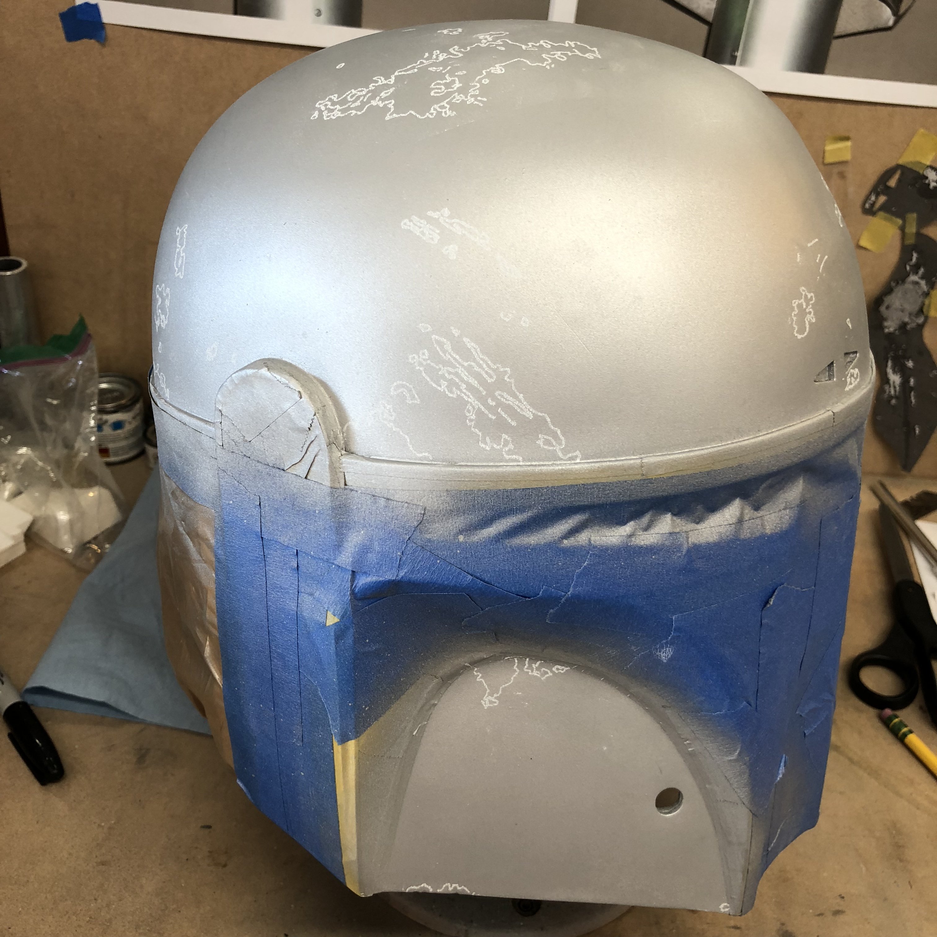

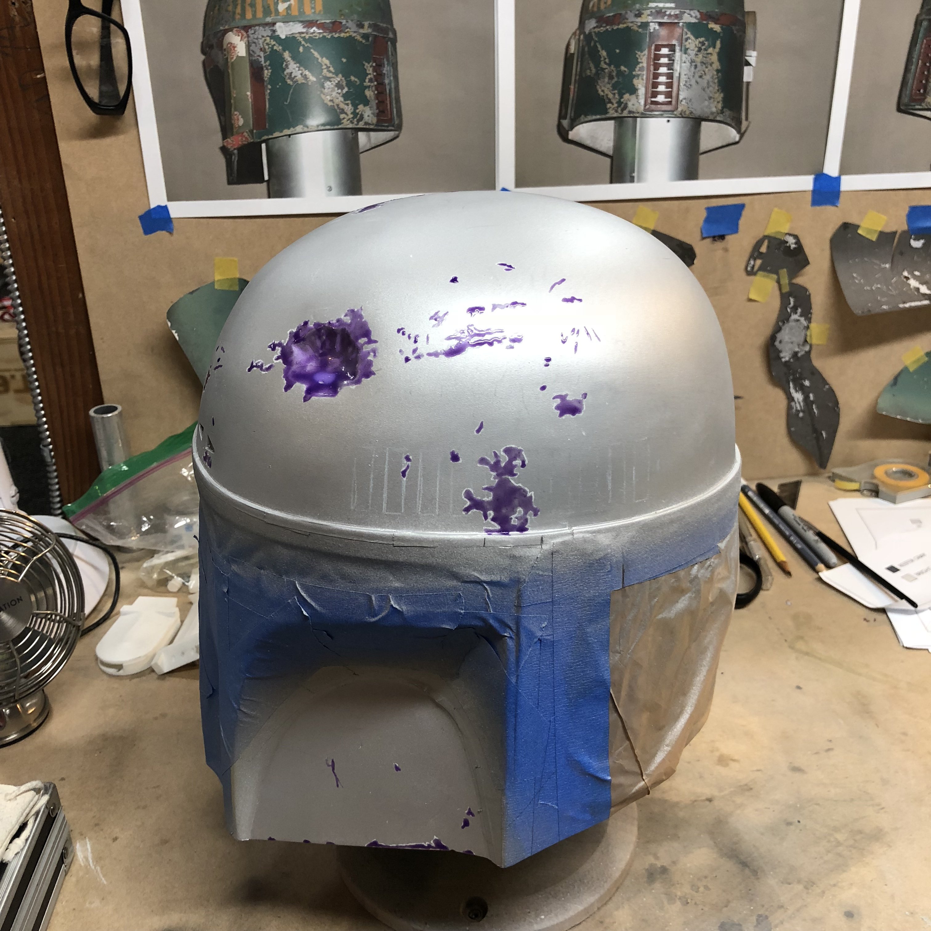

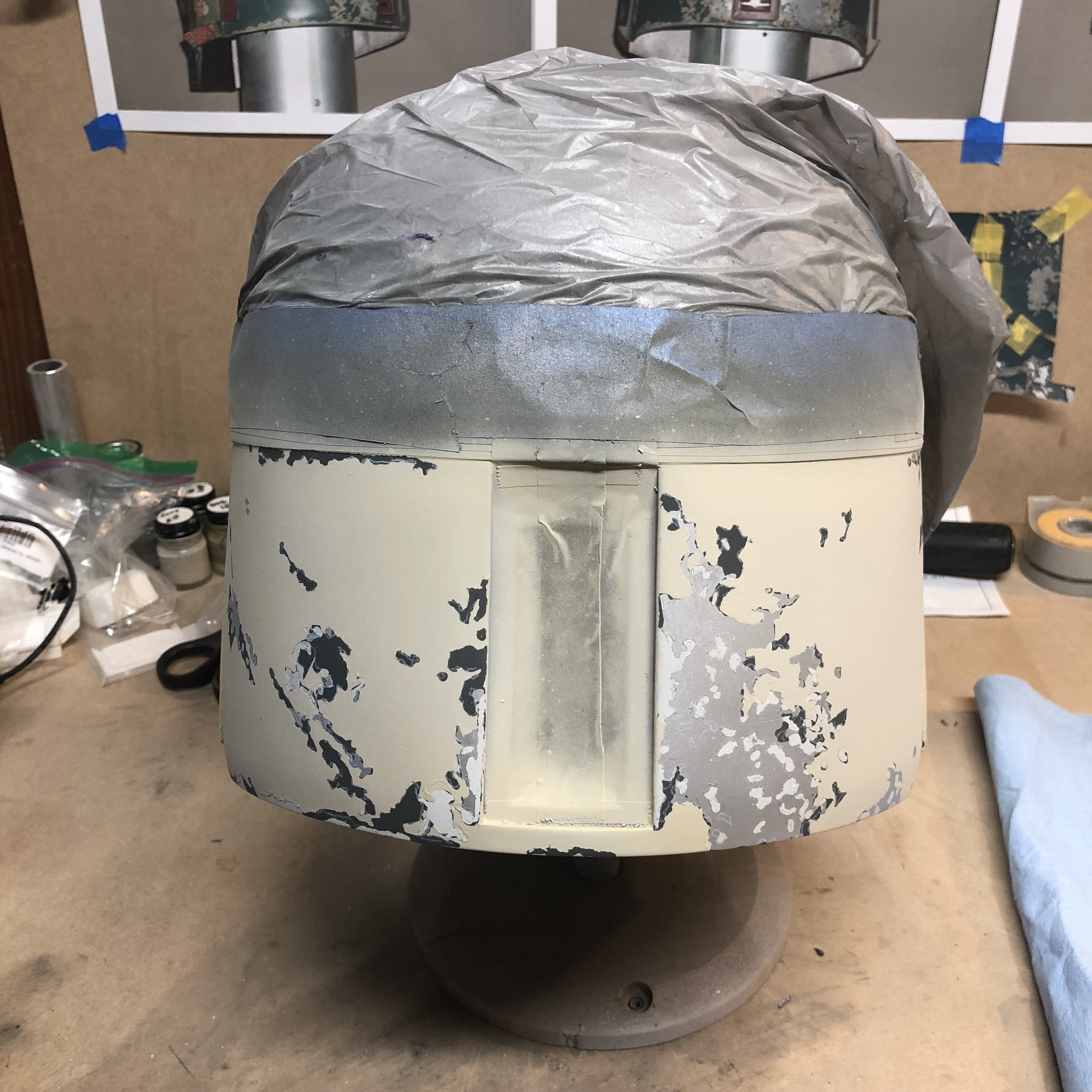

C3FAE08C-7ABE-45D4-8C94-E30E361677EF.jpeg 7D3C5F8C-2D57-4F71-BDCC-FD3BB1E08DC8.jpeg 5E01BD8D-6A3C-46F7-9D0A-CD894035466E.jpeg 89E616EE-D836-40F5-BC61-620AEA10CAD9.jpeg ED58AC43-5E09-4228-85F4-BF902F19657A.jpeg Applied the liquid mask to the silver damage and airbrushed they Grey 79 onto the dome and lower cheeks. When dry I will remove the liquid mask and stencil the grey damage mask and airbrush brush the green.

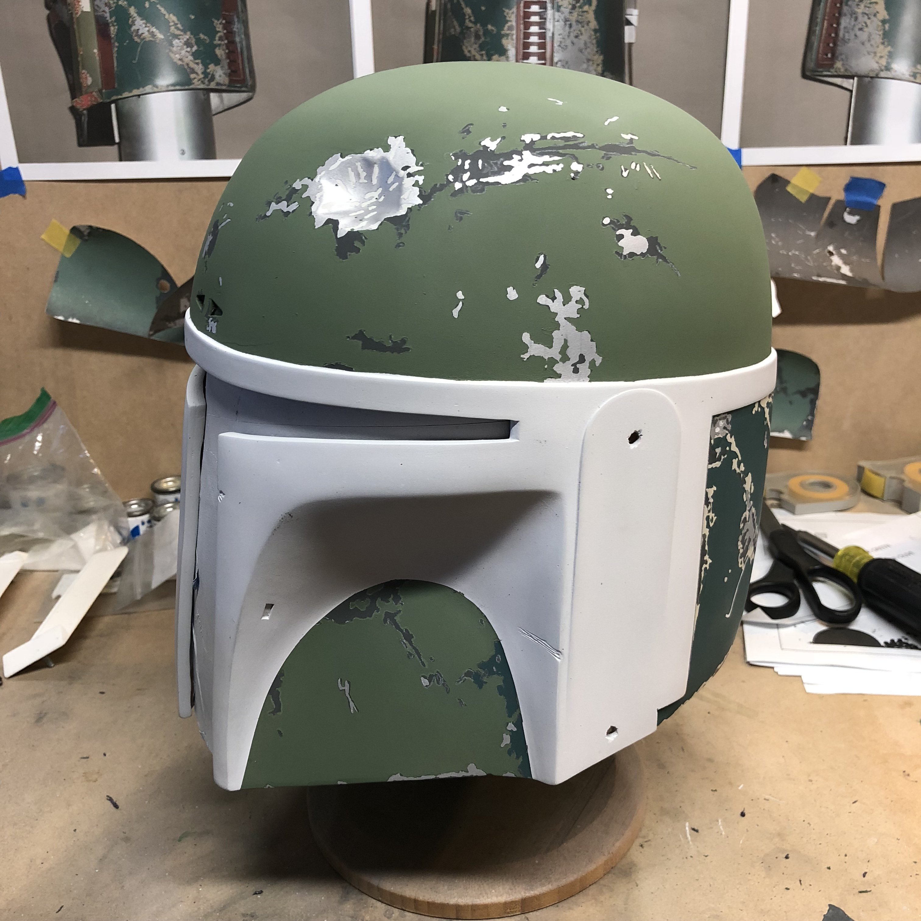

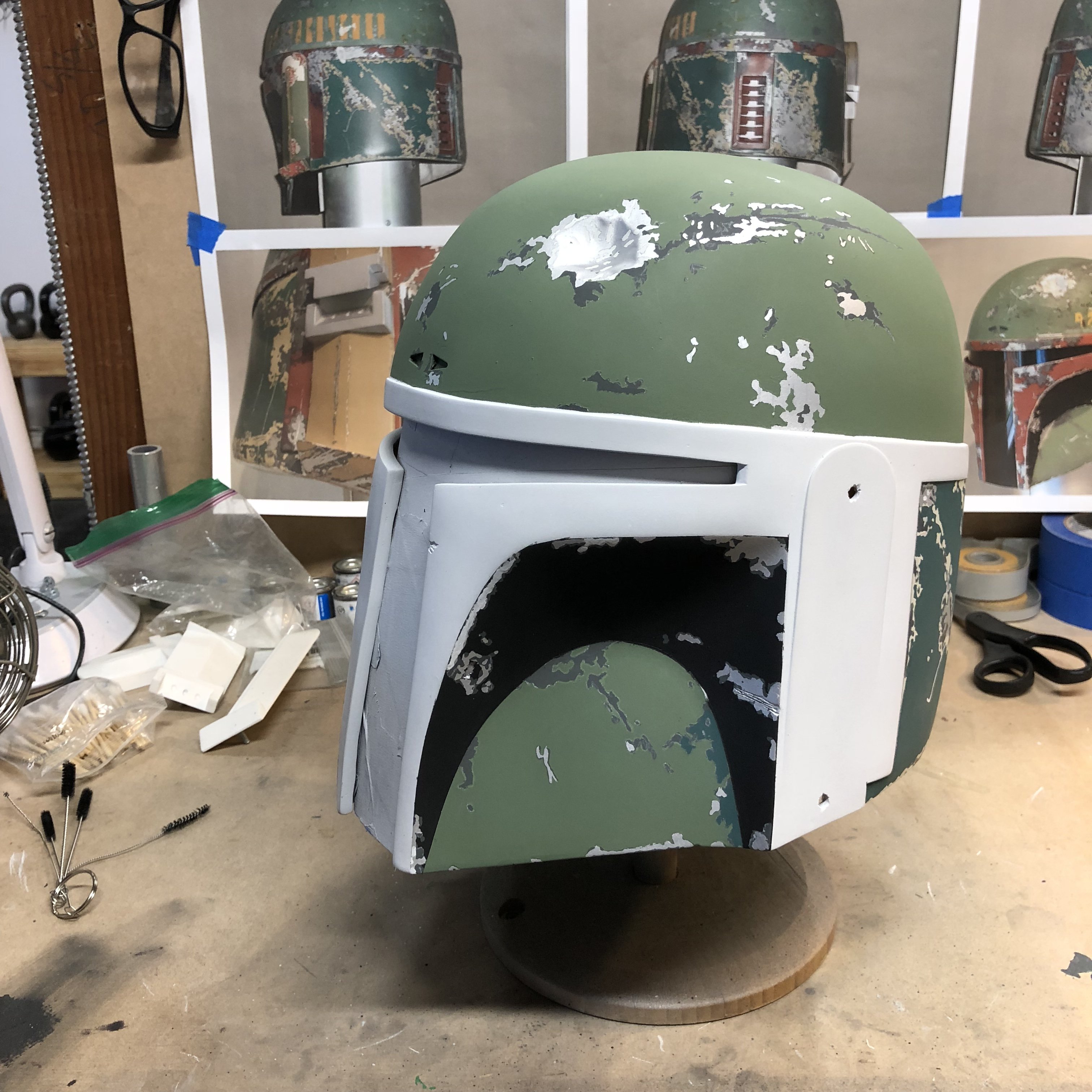

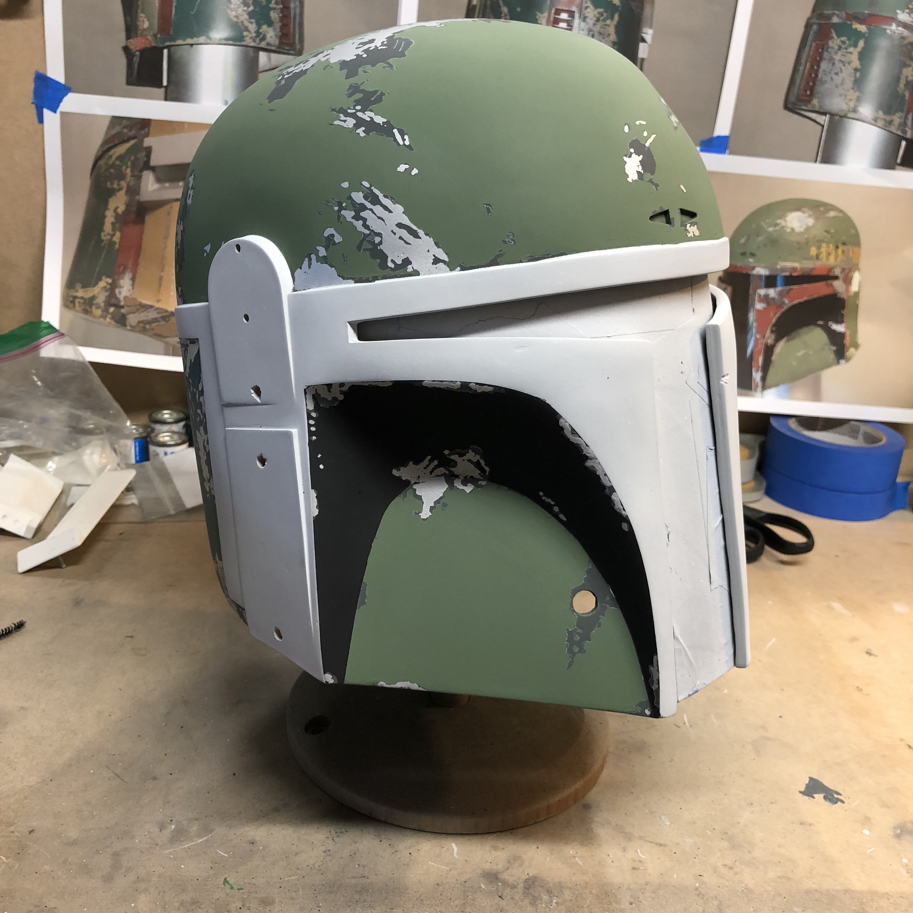

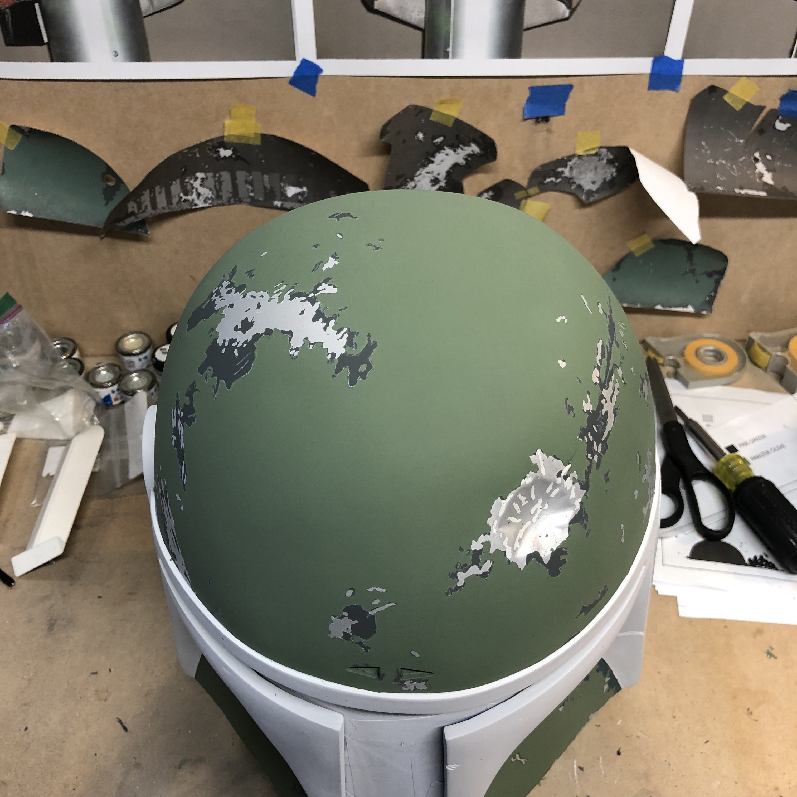

D6B04139-40AD-4414-AE06-FFC12A3CFFE4.jpeg 52FF5E25-AAD1-444E-9FCF-429464A6E9EE.jpeg 0D895C5F-A640-420C-89CA-975D66F6EA27.jpeg 0AA4DBD2-56C3-4DB8-9BE3-08B76B281238.jpeg 24F65A3F-B1A4-410A-AC3F-8E20FCB2FC3D.jpeg Made some good progress on my Helmet. Got the green done on the dome and lower cheeks. Need to do some fine details. Next the details and black on the upper cheeks.
