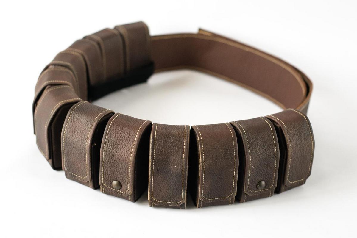

Moving along with my conversion, I am embarking on a mission to upgrade my ammo belt. Below is my SE belt.
This is what we see on screen.

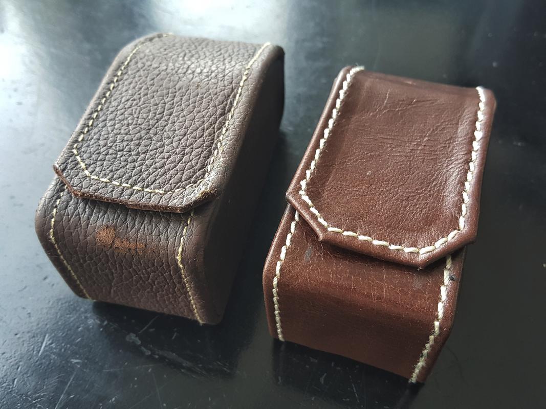

I think you can see where the problem is. The texture is wrong, the dimensions are off, and there are missing stitches at the bottom of the ammo boxes and on the belt. I am aware the original belt was derived from the white Supertrooper belt (constructed from white vinyl?) that was later dyed brown, but that's a route I may take another time. So I looked up the penultimate source of reference here and asked a friend, who owns a boot making factory in Bandung, Indonesia, to make a prototype of an ammo box. I briefed her on the color and texture of the leather to use and gave her as many reference photos as I could find in the Gallery. Here's what she came up with. (left is mine, right is prototype)
It's close, but the color needs to be darker and it's missing the stitching on the bottom. The dimensions of the wood block are perfectly faithful to the blueprint from StrumFett and RafalFett, so I'm pretty happy with that. When the correct leather is found, I will proceed with the rest of the belt.

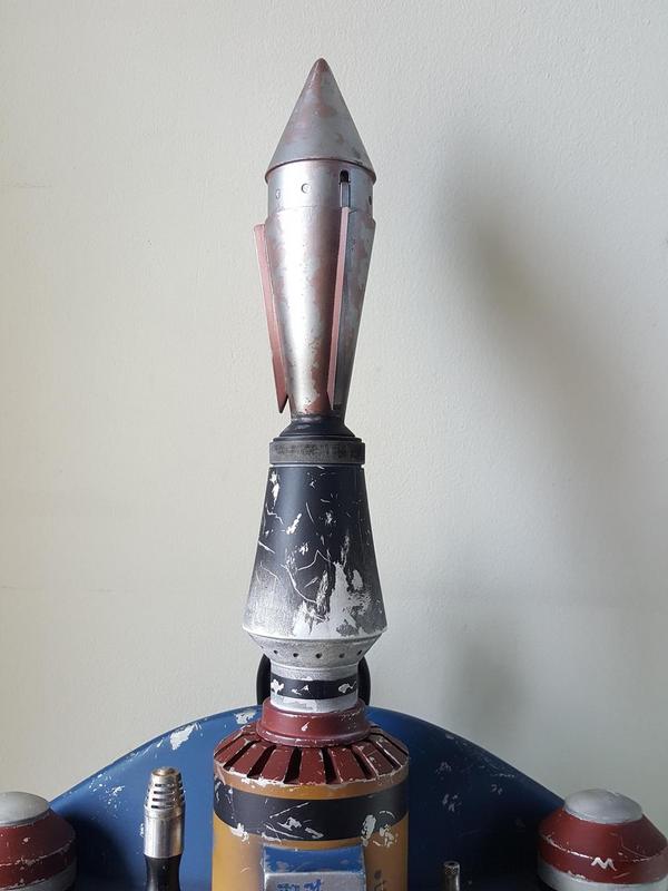

My GML sent me some feedback regarding my submission that included some issues spotted by the detachment; jetpack rocket is weathered in the wrong color, jetpack is missing some symbols, my left knee armor is wrong (can't believe I missed that!), and a couple of additional photos for some parts are required to clarify some details. I've ordered a set of ROTJ jetpack decals here that should hopefully be shipped soon. The left knee armor has been ordered and shipped from Daz.

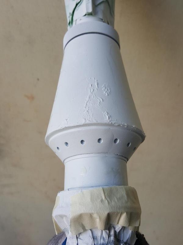

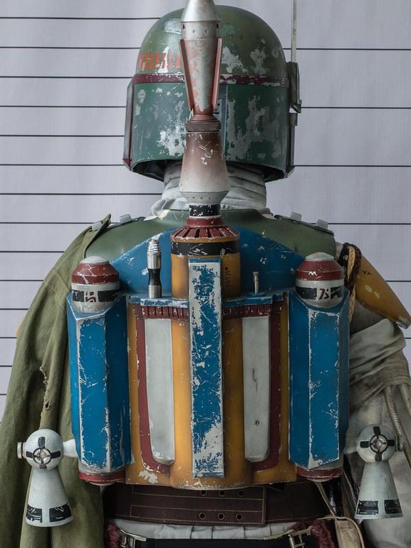

Thankfully the rocket is an easy fix. Here's mine. The central part of the rocket should be weathered in black and white.

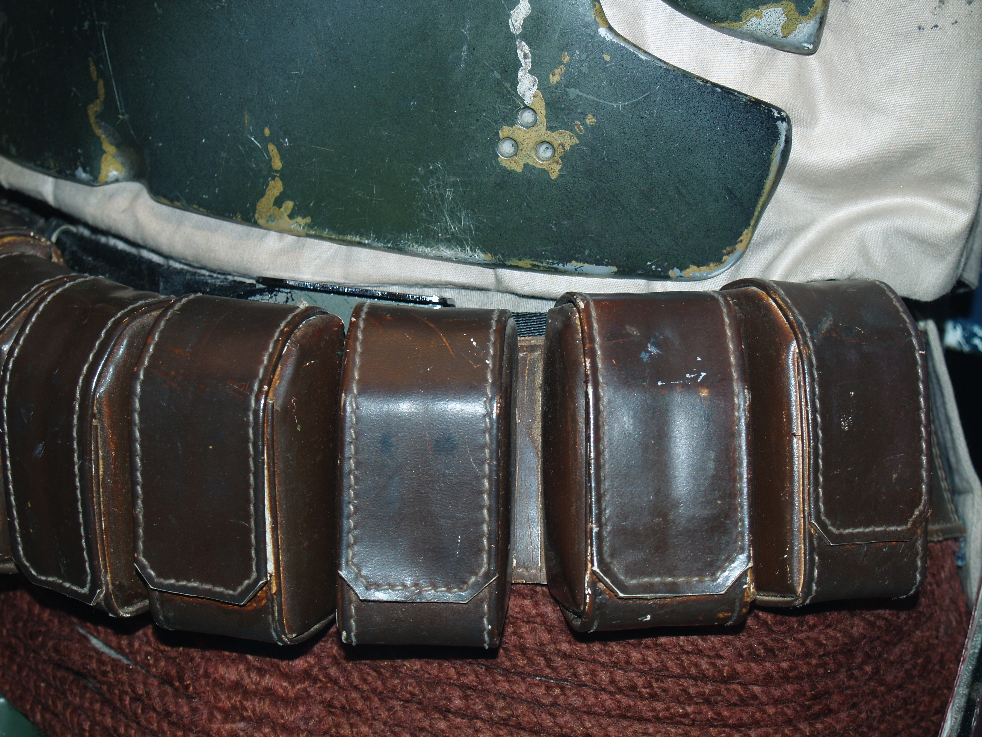

Reference of a screen used costume from the Gallery here.

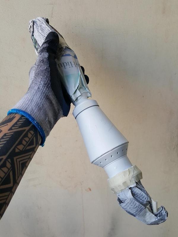

The ends are masked and the rocket is spray painted with white primer.
I used toothpaste to mask out the broad weathering.

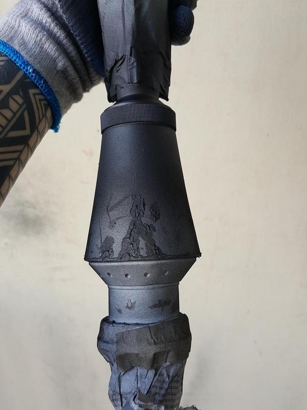

Spray painted flat black.
The toothpaste mask is removed with damp cloth. Fine scratches are added with a metal scribe.
Applied a clear coat and it's done!

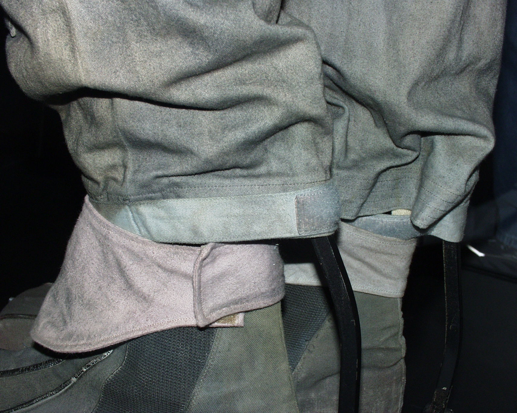

- install ankle ties.
